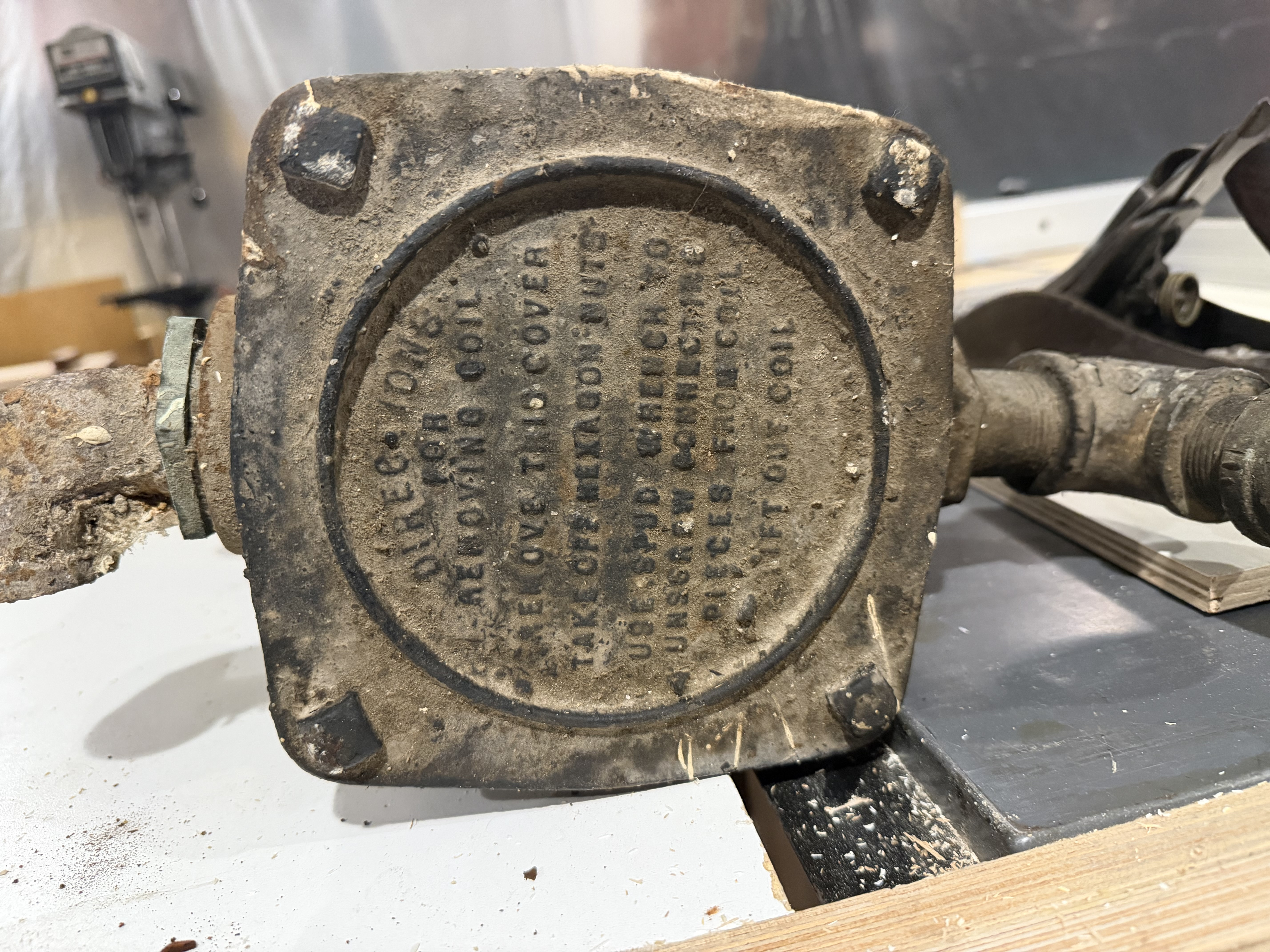

    AndythePlumber Member Posts: 111
    edited March 20
    I have no clue what it is yet. It’s a heat exchanger is all I’ve got…I know it’s killer though, some kind of dhw heating unit
    THINK
    mattmia2 Member Posts: 17,753
    probably a sidearm water heater, it was piped in to the boiler and heated the water by gravity circulation. ones similar to that were some of taco's early products in say the 30's and 40's
    bburd
    no but i have seen versions of this diagram. you can make this happen with a little thought and a number of fittings and nipples
    Steamhead Member Posts: 18,770
    That Excelso is just what you thought- a side-arm water heater. Looking forward to more pics.

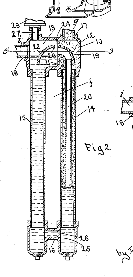

    The length of #20 is what makes the thing work. Its an internal brass tube that miraculously never clogs. The top tee has a tapped casting that connects it to the other side. There are also left handed threads involved. Those are never fun.
    Jamie Hall Member Posts: 27,644
    no — there are several versions of it. It is dead simple, as the patent drawing @mattmia2 posted shows. Another version has all the tubes concentric, instead of side by side.
