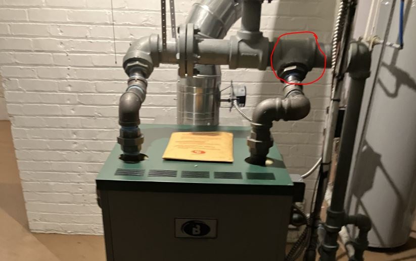

Can you please critique this boiler setup that was installed in my house two wks ago

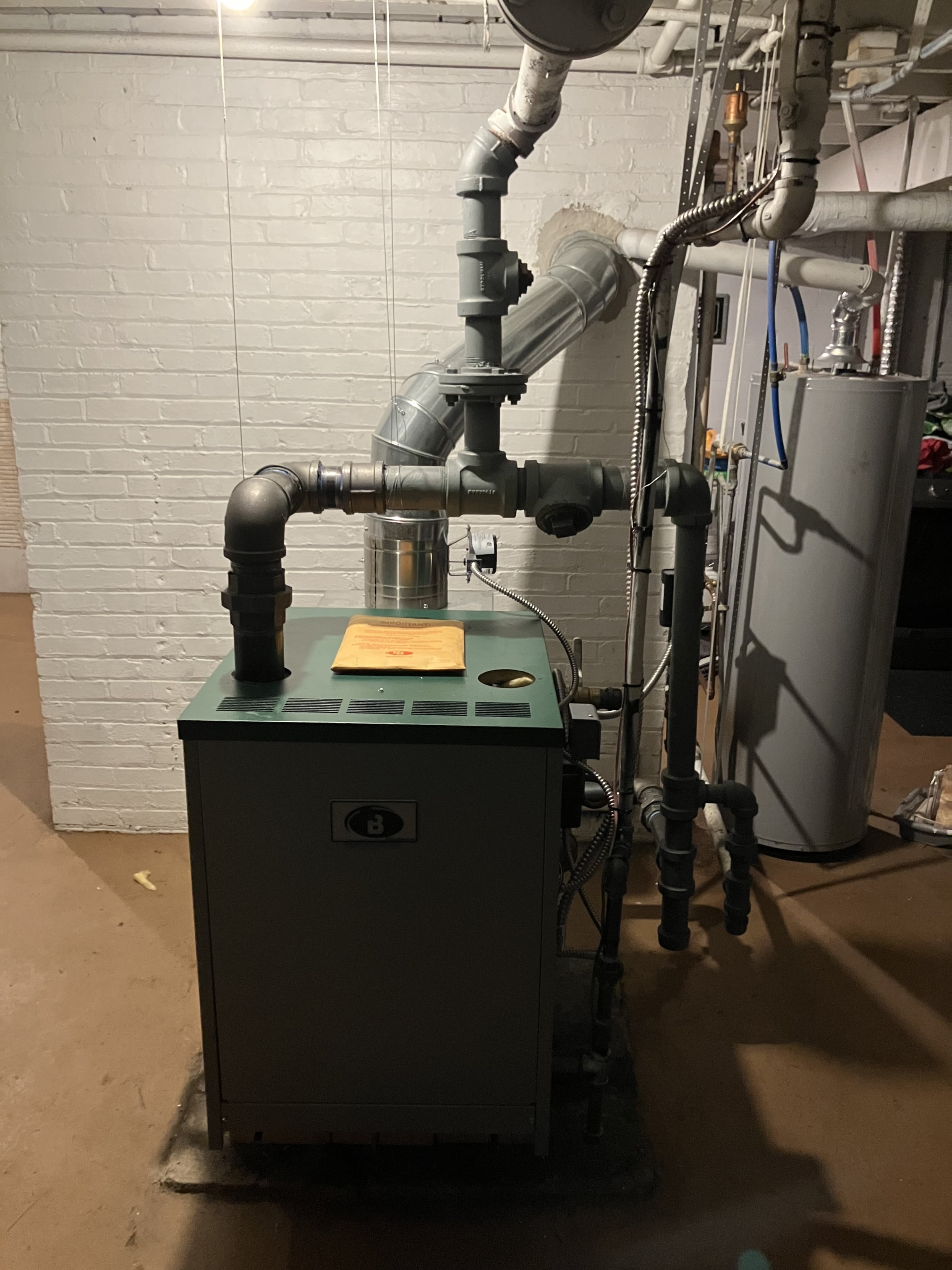

ok so here are the updates that were finally done on Monday
looking good now
will do thanks
Why wasn't the second riser tapping used?
They did the cheapest correction possible.
A better approach would have been to reverse the two connections to the Tees so that both risers were used.

It looks like they enlarged the single supply. It might even be as per manufacturer specification. But even if it's not, it's fine.
