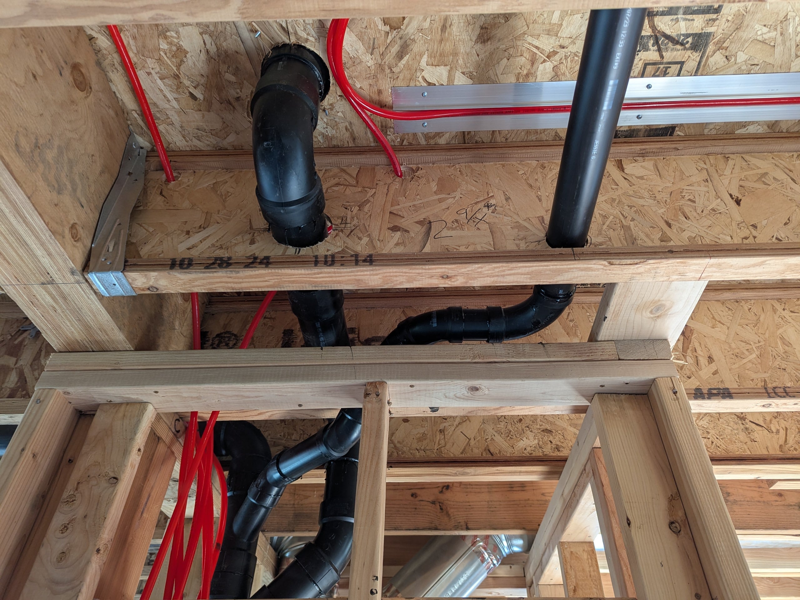

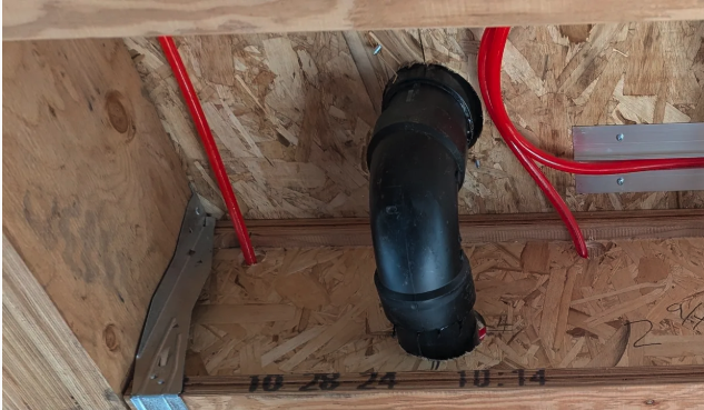

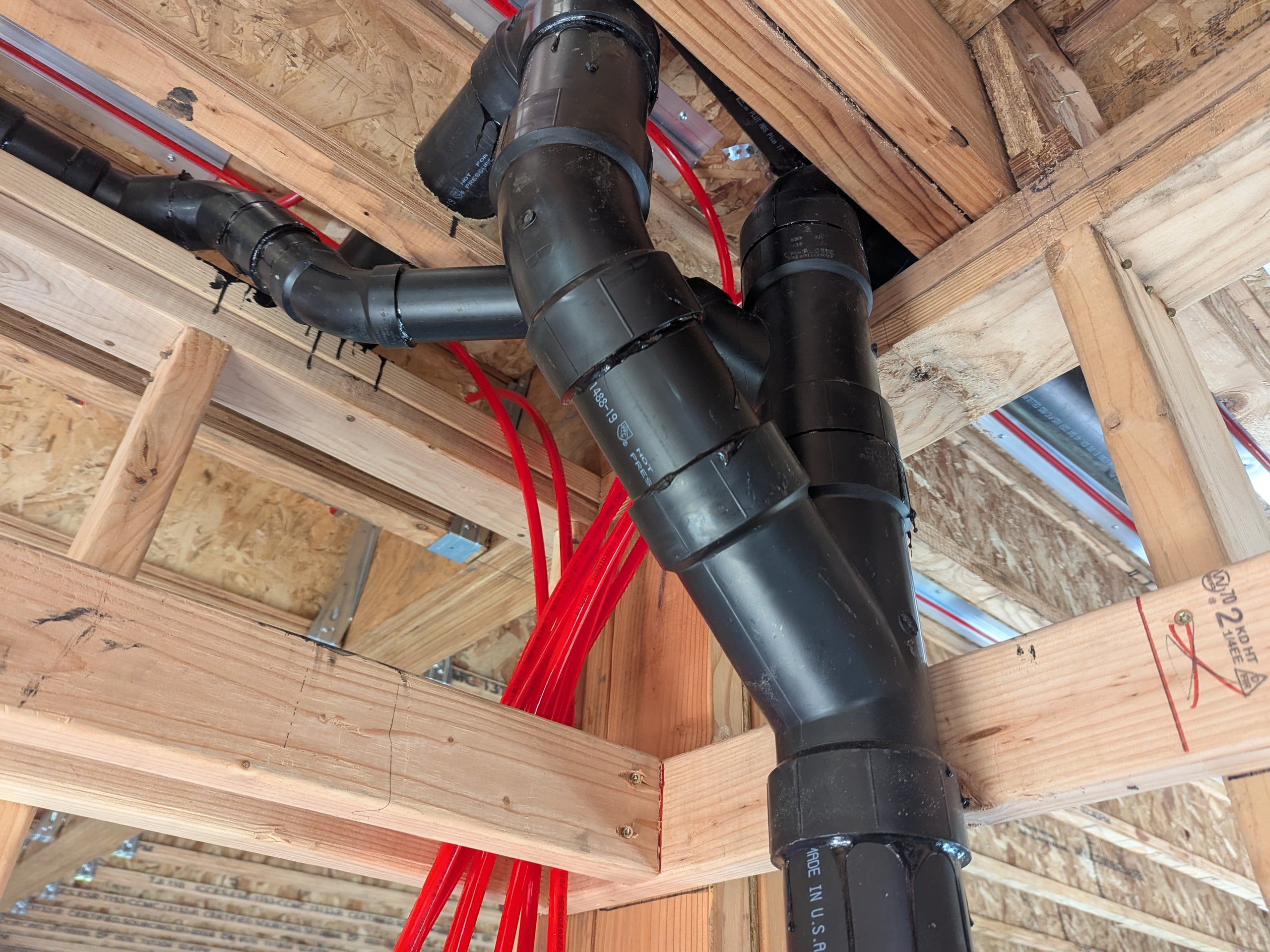

This is a black pipe piece of art, with a low heel vented up and into that 6" wall, the 3" goes to another bathroom group. The stack down and the vent up are in that single bay. It is a tight place, that 2x10 is the beginning of the dropped roll in shower.
I built a chase into the back of the closet for that and duct and the hydronics, and dropped the lid.
The lav had to move right for I-joist hole rules. Stacked beams on the left made venting difficult :) My only air admttance valves are for those double lavs. AHJ is fine with AAV's.
If I had waited to do the hydronic, that lav would be that much closer and I would not have him put a holesaw through one of my loops, LOL!
My brother and I hammered a replacement loop in. We brothers did it all.

It is PVC in the dirt and we transitioned to ABS because brother, there AIN'T no PVC sanitary fittings out here LOL!
I would have been dependent on a Monday once a week to Fergusons, or Keller. Fergusons just killed it on price for the ABS and stock it 10 minutes away.
I could have ordered a pickup bed full of PVC and I still would have come up short. You know those plumbers.
As the operator, I appreciated how much better the PVC was in the ditch. We do a lot of 1% grade and the ABS was banana bent all over the place. The PVC just tosses down on my ground guy's gradework. Glue it and go.
But the plumber did bring up a good point and this combo of PVC in the ground and ABS up was efficient, labor-wise.
And I could get all the parts :)

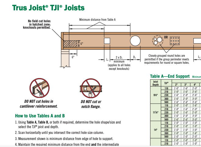

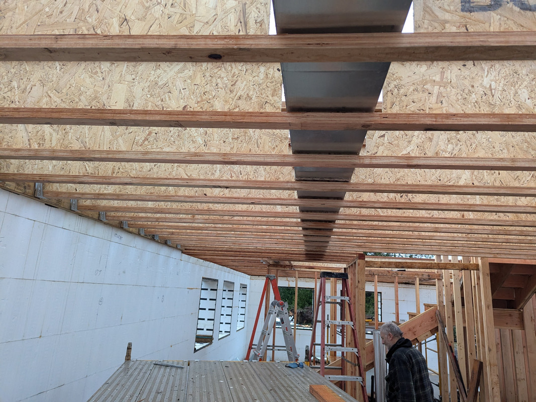

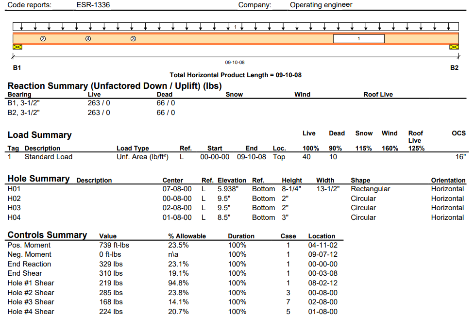

I suspect this 4" hole in the TJI is a bit close to the end? Although I doubt the floor will collapse. The inspector I worked with was a real stickler for holes in TJI, a lesson that has stayed with me for many years now :)
Living the hydronic dream2 -

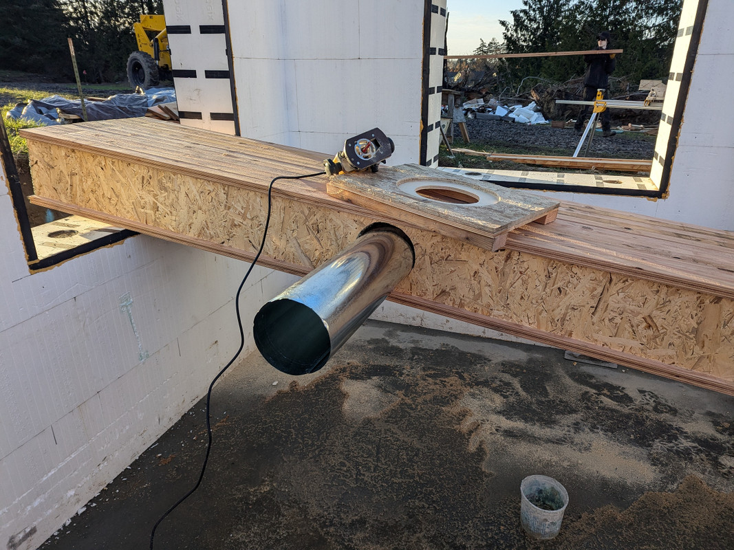

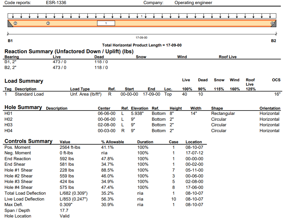

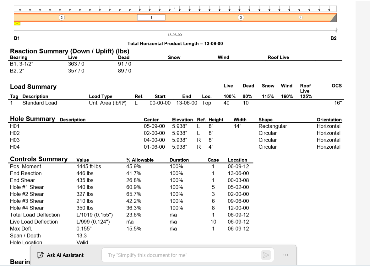

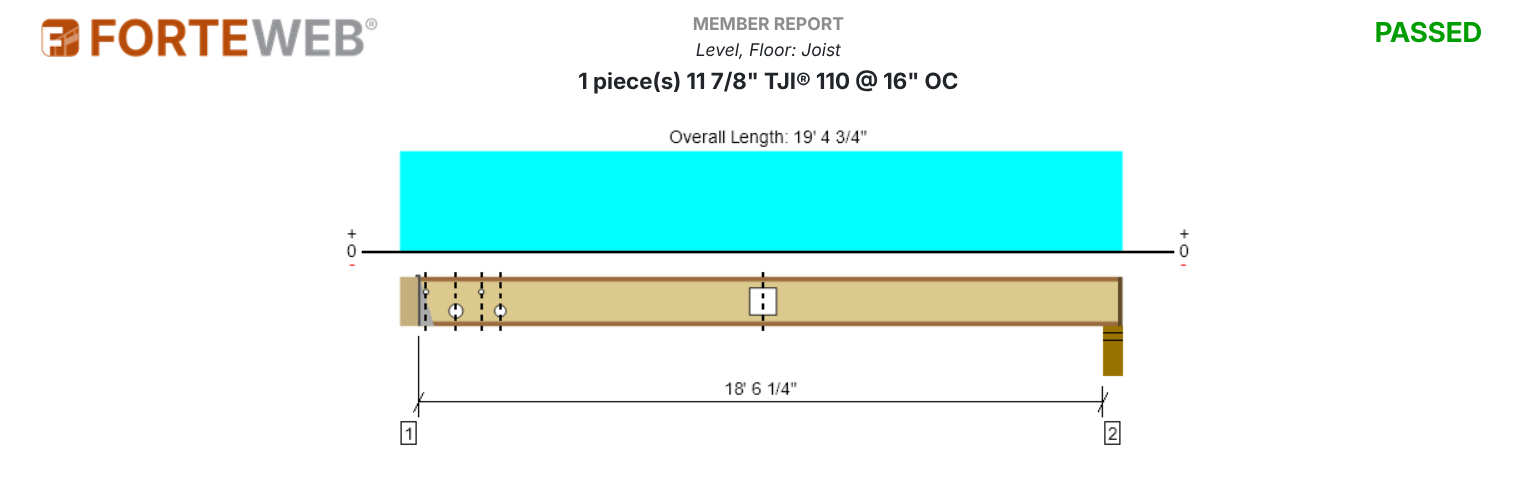

Bob, I became one with both the Weyerhauser (Forteweb) and the Boise Cascade (BcCalc) software programs, and each one of my joists with critical holes in it are modeled in that software. You can place holes larger and with better understanding than just chasing around the rules in those PDF's. I would be happy to share that experience here and get somebody started with it.
Here is a sample report with a big 8x14 duct hole in the middle. The PDF says you can do this, but the software models the resultant shear forces.
1 -
So what you do as the HVAC guy ( me ) is move ducts around until the software is happy.
Then you talk to the plumbing designer ( also me ) and find routes for pipe.
Then you both talk to the guy laying out the wire runs ( ME AGAIN ) and he just has to suck it up and behave.
Sometimes we are up late at night arguing. It is a mess. I hear the doctor has some pills for this.

. In my case the plumbing & mechanical inspectors carried the TGI chart on their clip board. If the hole(s) were outside that chart you had to get an engineer to sign off. And in some cases an engineered "fix"
The building inspector on my shop that I built last year, wanted to see web stiffeners on the bearing points also. But you have a better hanger that what I used. They are very seismic obsessed in this area, even my small 800 sq ft shop had to be engineered.

That joist was a Weyerhaeuser because I used their cantilever design on the 2nd floor. Here are some screen shots of that joist's report.
Note that it uses the overall length, including the beam on the left and the top plate of the wall and the rim board.
This can be a pain to get right. The Boise software is easier IMO.

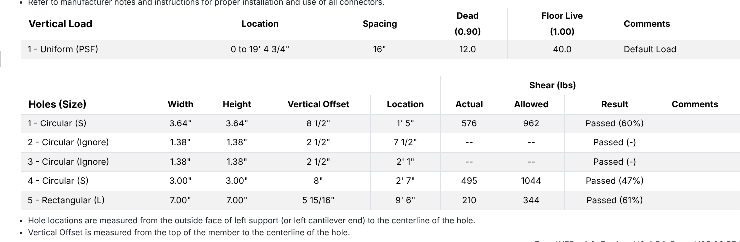

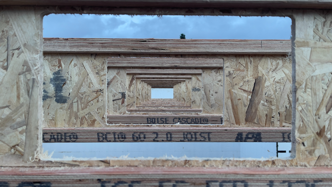

This perforated beauty is Boise Cascade.
If you keep holes less than 1.5" and spaced at least 6" OC, they fall into the prescriptive engineering criteria.
The closer to center you place a big duct hole, the lower the shear forces, as shown above.
I had to move a duct off center and that is where the software helps.
Note the shear is at 88.5%
This was the easy part. Then I had some short foyer joists in front of the elevator shaft wall that had the same hole, but now at the end.
Then the left end moved from a rim board inside a 13.5" thick ICF wall to a plate on top of it. This made it worse.
Shear value is now 94.8% of allowed, even though the span is much shorter.
This is the point where using the <free> software really pays off. I adjusted that duct run through all the joists until I had the sweetest spot for it.
Not having any bumps in my basement is priceless, to me.
I built router templates.
you can see where the joists went from the rim hangar to the plate on the dropped wall there.
I showed my inspector the softwares and reports, and he was down for that. I do have a good relationship with him.

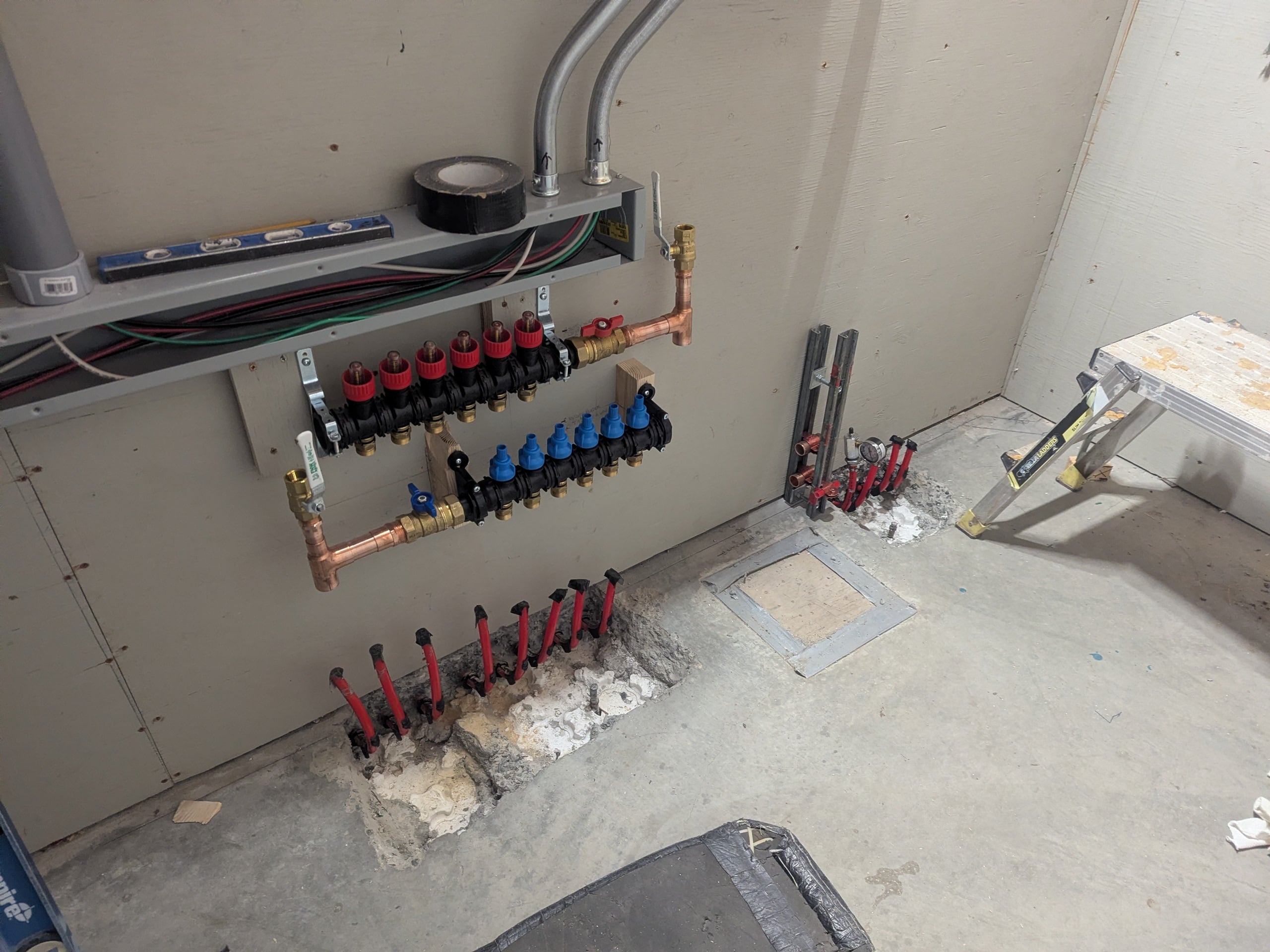

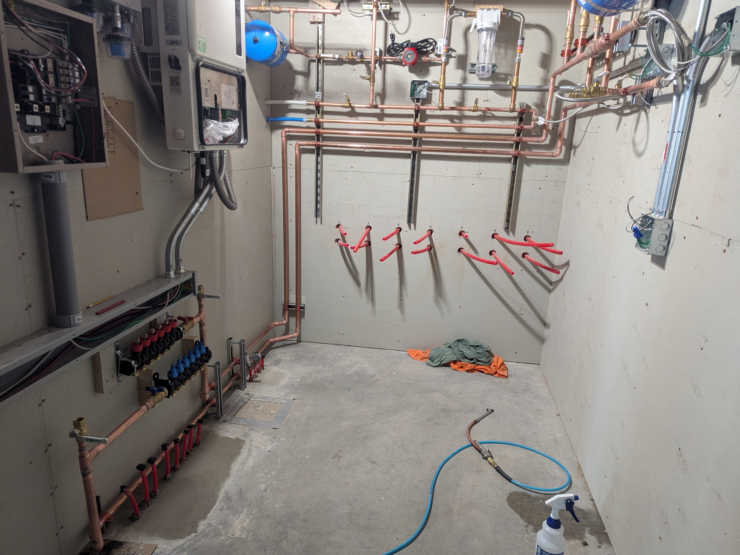

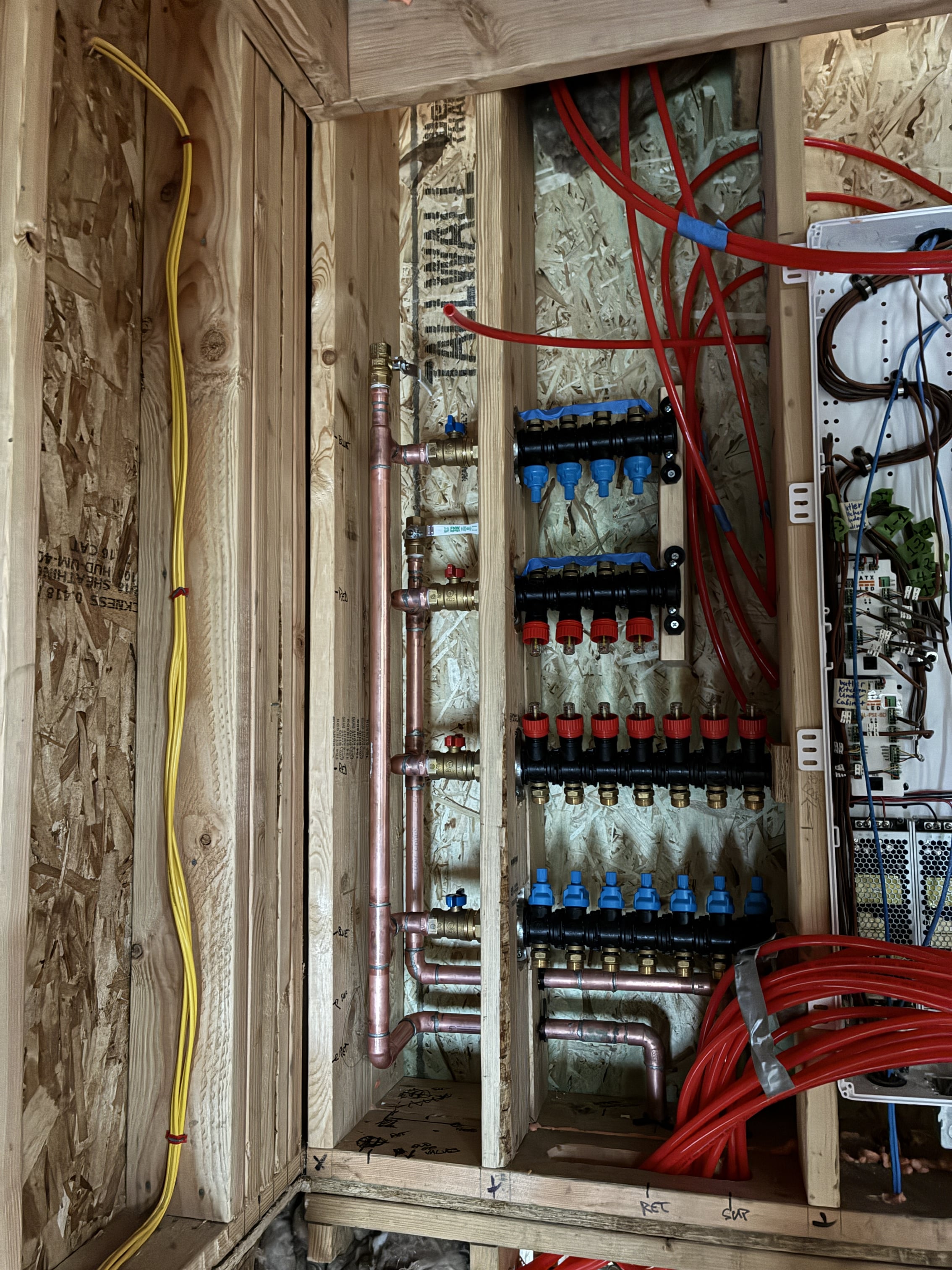

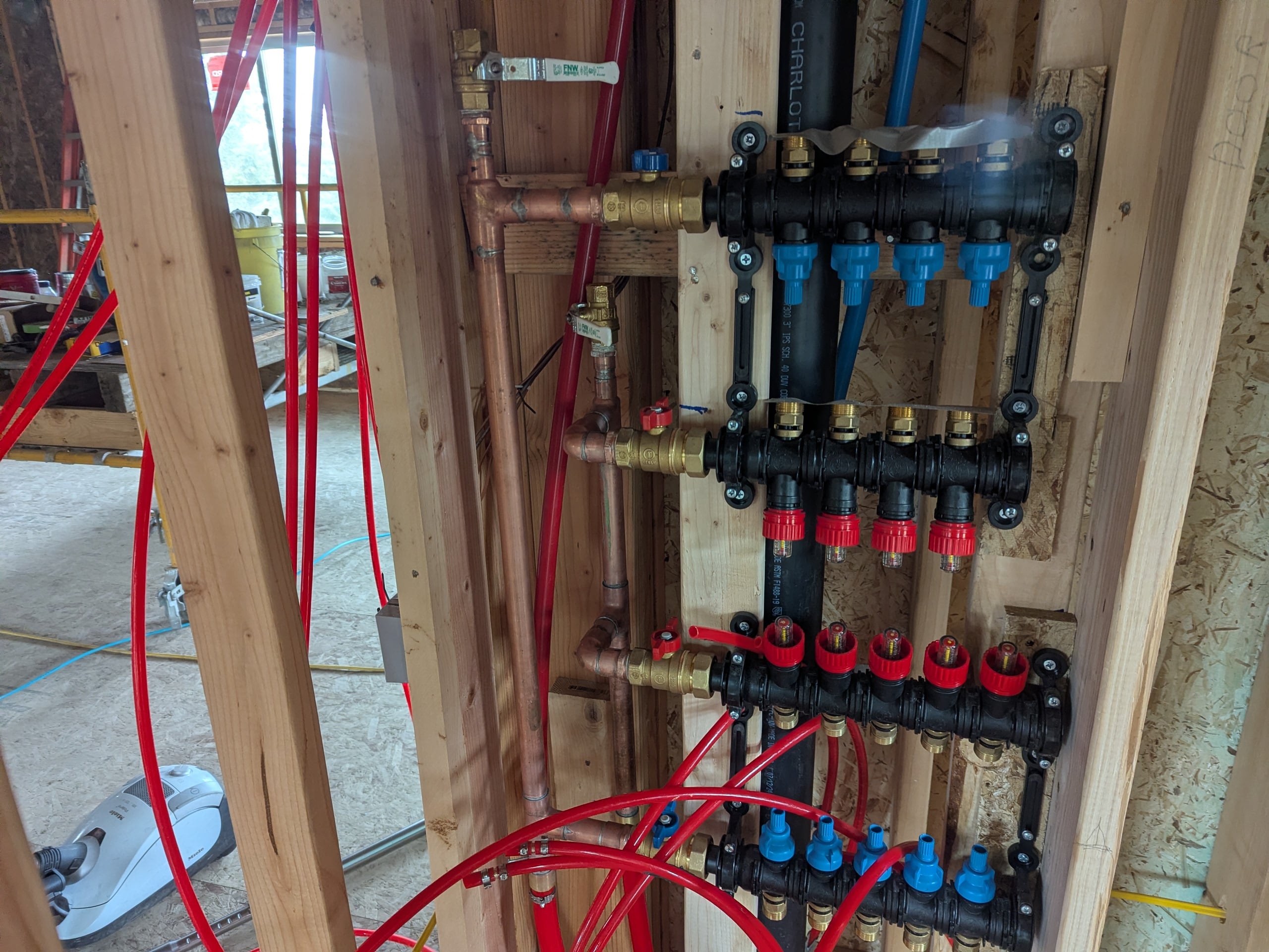

I cut the manifolds into my chase wall. When I designed the central core I had a dimensional bust in the elevator pit/shaft location that we corrected by adding a 2x6 non-bearing wall. doing so fixed the stairs. I did have a chase planned on the far side of the bearing wall so that was eliminated. It is all good as they say.
All headered up now. It gets the 24x30 metal door. Taco vents on order.
Same treatment at the east manifold location.
I put the basement floor manifolds on the wall where I was told. :)

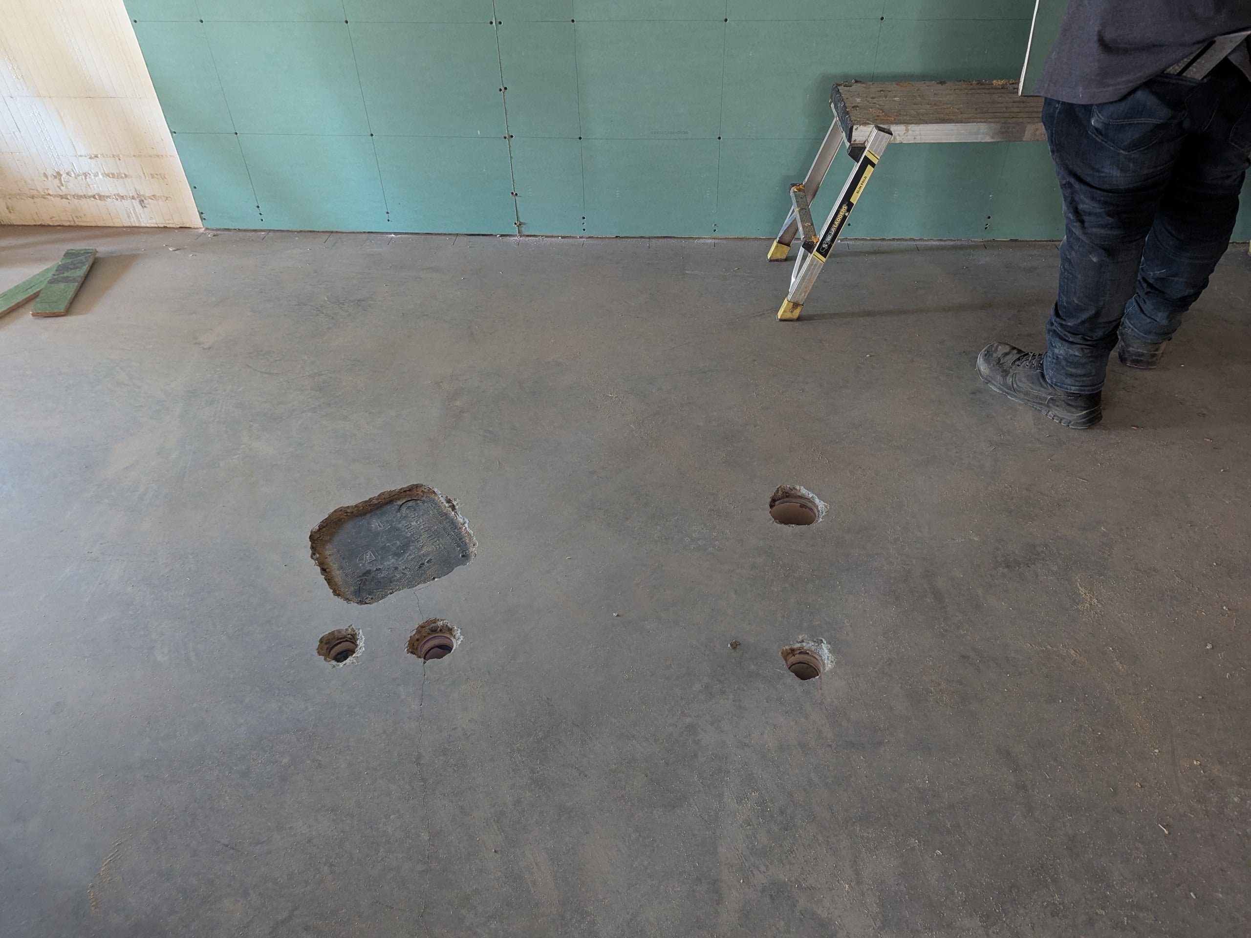

PEX is supported with those bend helpers and ready to pour back. Note the Zurn 12" floor sink hiding under the original plywood. The water heater goes in the corner just beyond it.
I worked around the commercial plumbers for years and concluded that a floor sink is a handy thing to have.

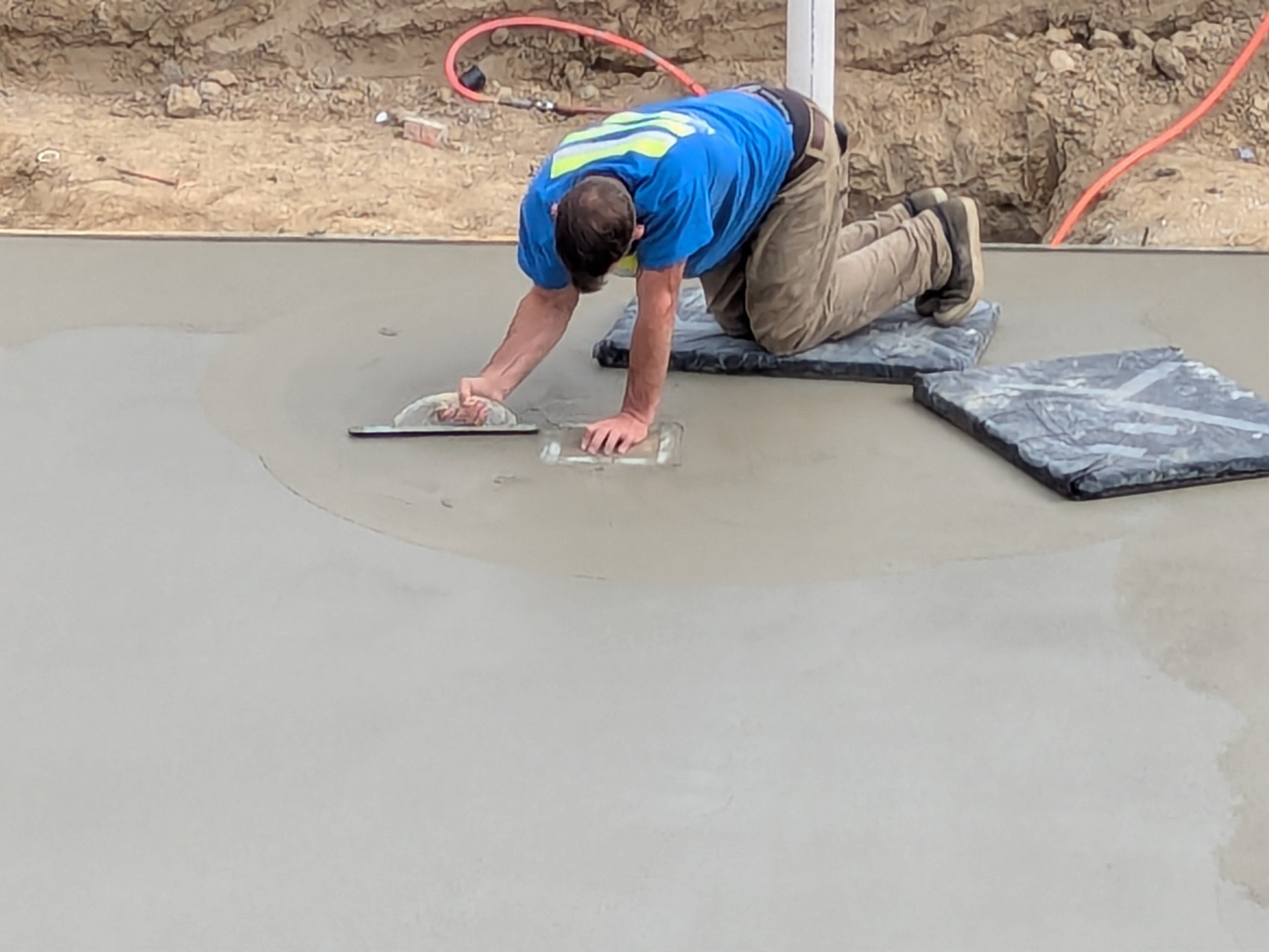

I had subgraded and marked everything so the finishers did not have any pipes to work around. He did a nice job putting a slight bevel into the sink for me, his hand is on that plywood lid.
I spot fixtures like floor sinks with blobs of concrete under them ahead of time, so the finishers cannot stomp them out of level.

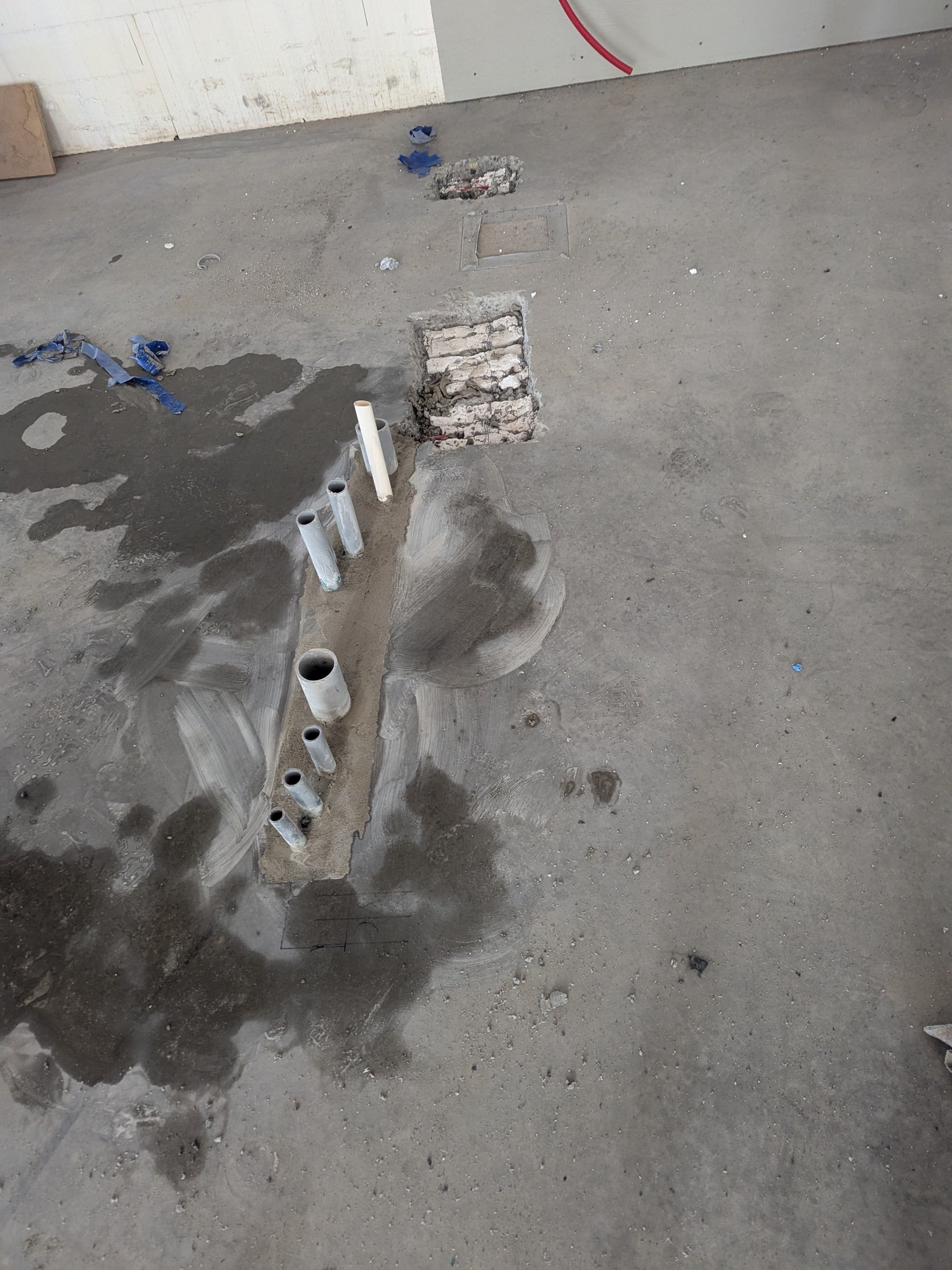

The equipment room wall stubs are all there waiting for the sledgehammer.
bring them up, do a pour back.
Adjacent bathroom group.

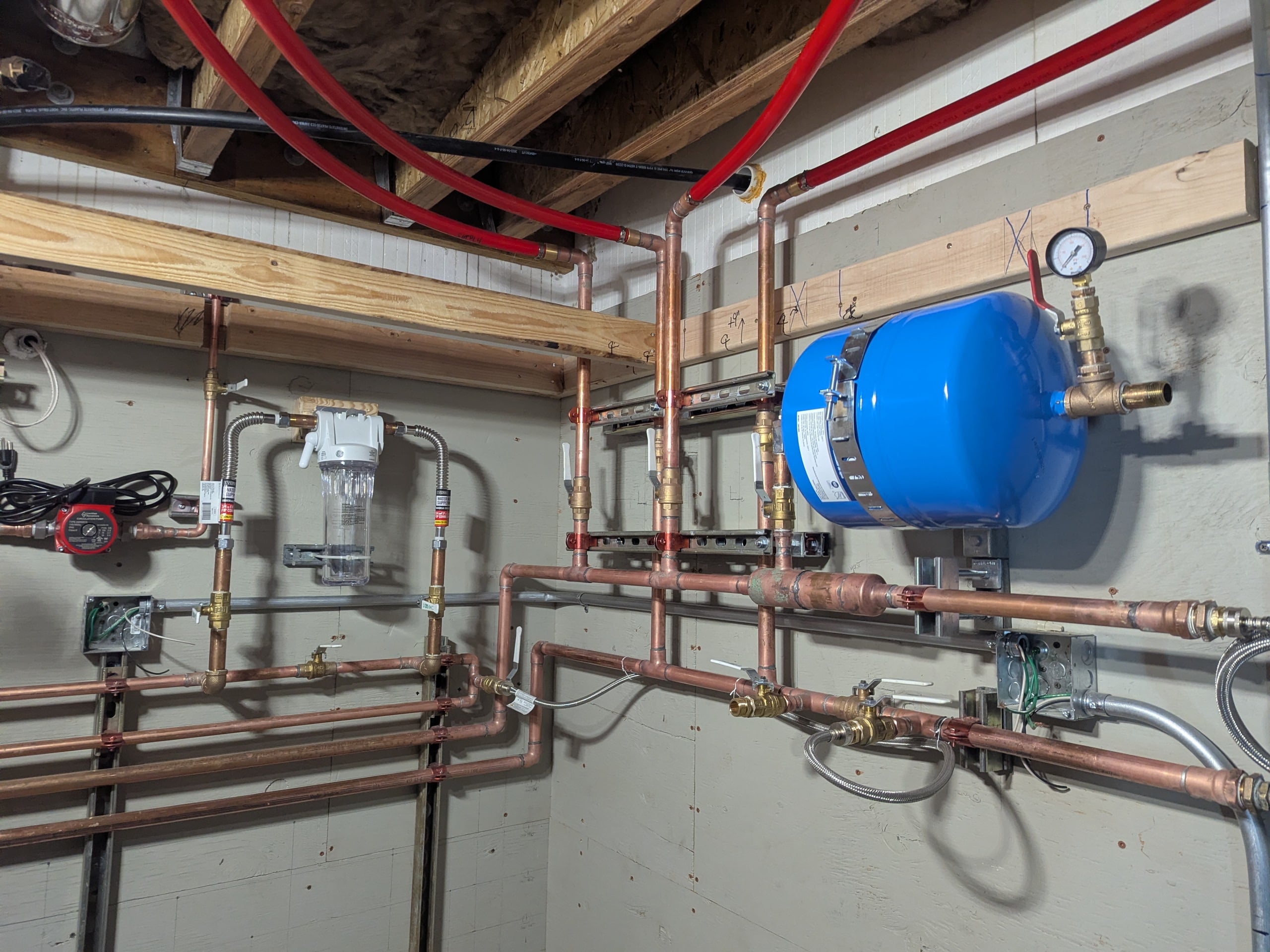

This is not my work, and I am so fortunate to know this guy. It is my dream and concept, but he draws and figures and makes copper beautaceous.
I got the pourbacks done, and we pulled, pushed and cursed that last 1" PEX through the joists. It is now all manifolded and under test to the shutoffs. I have to hook up all those little tubes now and get that tested.

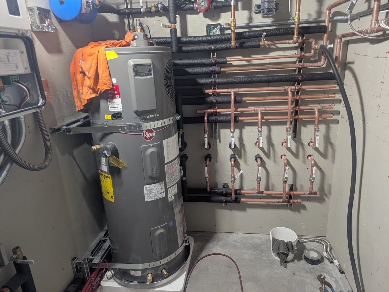

Hybrid Water heater goes left corner with pan and T&P and condensate into the floor sink. After he gets the ground loop manifolds in and around the corner, I will bring in that temporary water heater for hydronic testing.
He sweated up that big air separator from spare parts. I have a to-do list for all that loose and uninsulated PEX, so I can frame and close off the lid. It is all set for flush and fill after I land all the loops on the manifolds and give that an air test.
I looked at the municipal water report and it is excellent. Hardness is 108 ppbillion or .0063 grains. I have a carbon 5 micron cartridge for that filter housing. The rest of the water specs are similarly low.
I have the 21 3/8" house loops terminated, air tested, flushed and filled and under static water test now.
I need to get the 6 1/2"slab loops done and then we are ready to temp in that water heater.

you are right. The report had PPB in one area but further research has it as PPM and it is confirmed.

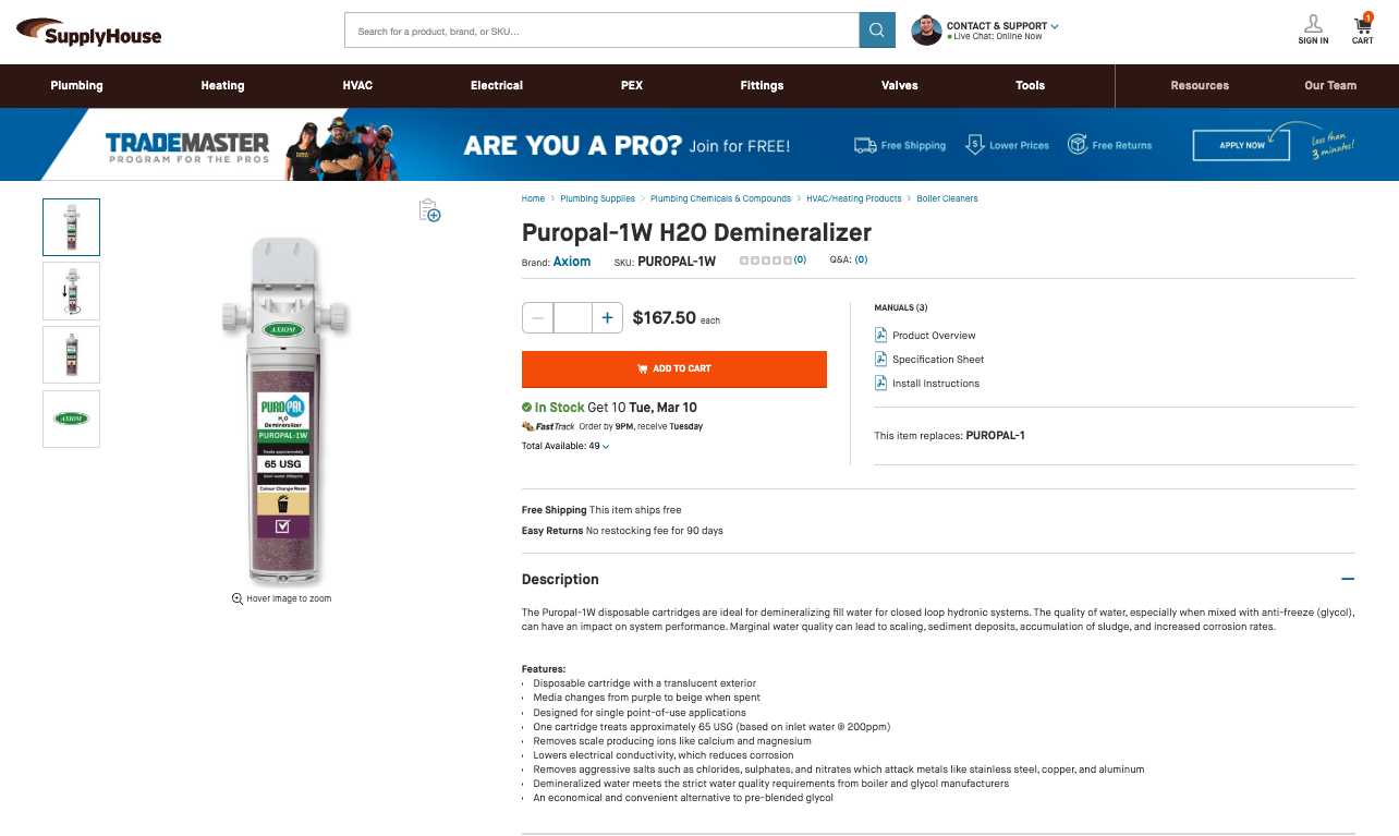

So do I want to flush those loops and get one of those high dollar filters?
You can fill and flush the system with that tap water, run some dishwasher soap if you want to save some bucks. Or a hydronic cleaner.
Flush and then the final fill through a cartridge like this. Other brands like Culligan around.
Seems like a small investment to protect a multi thousand dollar system?
thanks I added one to the cart I have perpetually running at supplyhouse. :)
It says 65 gallons based on 200 PPM, and I have a 5 micron filter in front of it and the hardness is a little over half that.
My 200' loops are about 2 gallons each. I will put the discharge hose in a bucket and flush a couple of gallons through each loop.
I got the basement floor loops terminated, filled and purged 1 at a time on the live system. I ran the pump at them at 1 GPM and let the Caleffi vents just eat it. I turned off the upstairs manifolds to do so, and only had to burp out the risers off the manifold to those valves. Now it is all purged out and running at 20 PSI.

14 hours later the ~1.2 ton equivalent water heater had it up to 64. I used the suggested Groundfos Alpha for the hydronic side. Ran it at 2.5 GPM slab only and when the SWT came up I added in one of the upstairs groups and run that combo at 4 GPM.
That is the air handler GSHP unit on the right in the permanent spot. The GSHP hydronic goes where that water heater is, and to the left into the corner closest to the ground loops.
