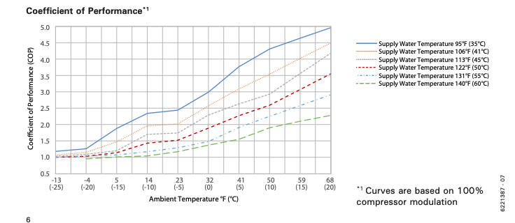

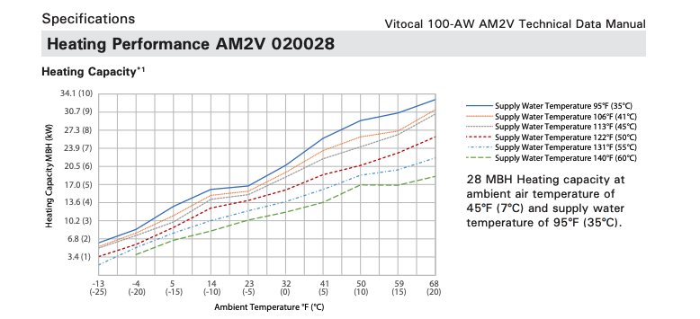

    Does the HP have an electrical element for boost? I have the Vitocal and the indoor module has a resistance element built in for some boost. Although the program allows you to lock it out, which i did.
    I do have a backup boiler and if the outdoor temperature drops the COP to 1 the control in the Vitocal calls on the boiler.
    The output curves for the HP should show you the cross over point that makes sense.

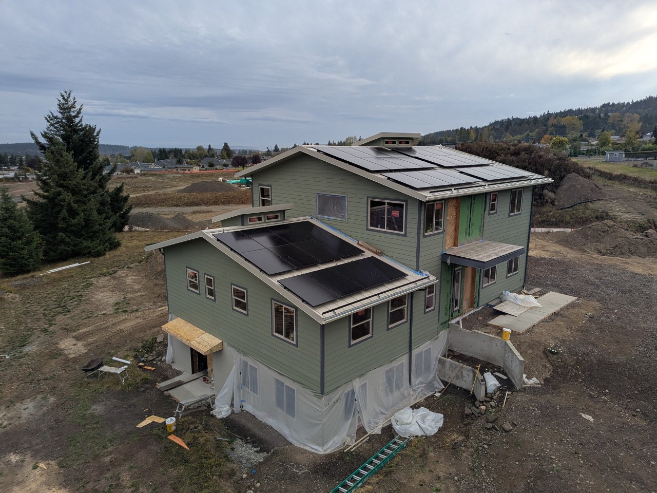

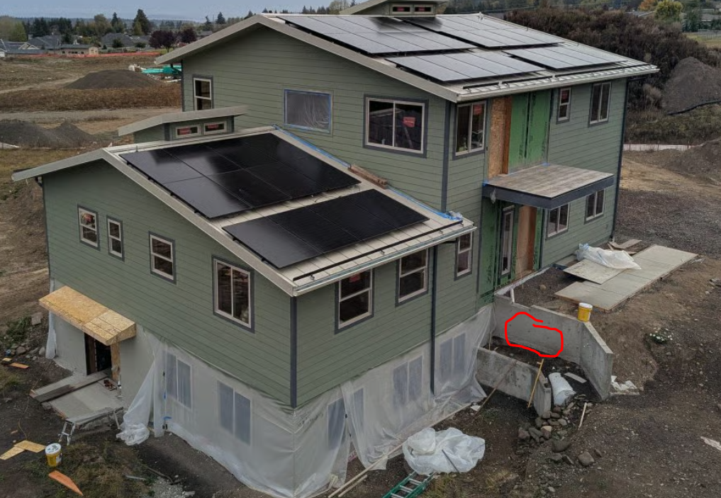

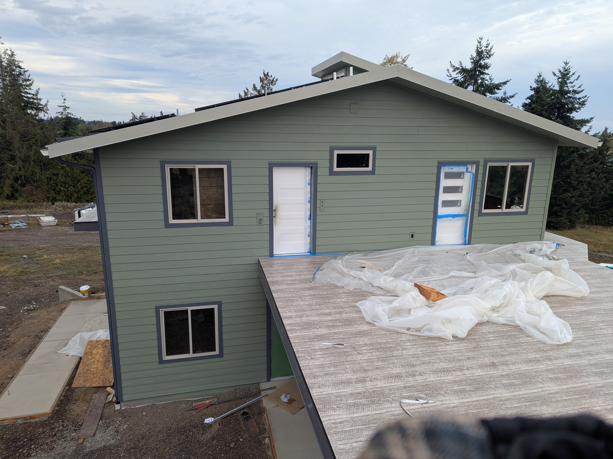

    Here is an updated view after paint and gutters, the carport and roof decks.

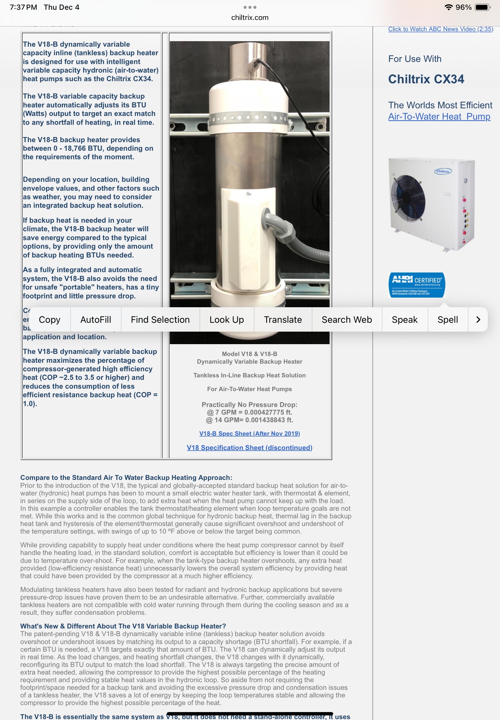

  • Chiltrix has an inline heater that is used in this way:
    https://www.chiltrix.com/hydronic-backup-heater/
    And it looks like it's really just a repurposed spa heater.
    The tricky part about this is going to be the control logic. You want it to run only enough to meet the part of the heating load that the heat pump isn't delivering. What you don't want to happen is the heat pump to see warm water coming back and think the load has been reduced and reduce its output. Then the backup coil produces even more and you fall into a cycle where eventually the heat pump is off and the backup coil is providing 100%.
    I don't know what kind of controls your heat pump has. The Chiltrix has a control output for the backup heat, if always minimizes the use of backup.

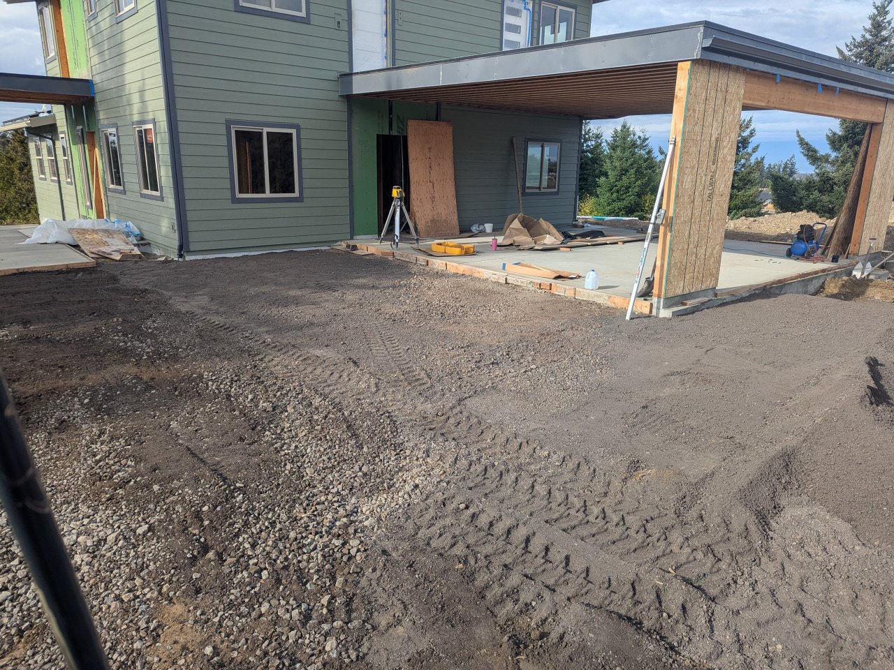

    You could put the unit here:
    Could even build the deck by the door to have an overhang and cover the outdoor unit. The new inverter based outdoor units are pretty much silent about the only time I can here mine outside the house is when it is running at full heat in the depth of winter.
    To me it is a lot easier to run a lineset than dealing with chilled water. The direct geo air handler is also a good option.
    skyking1
  • skyking1
    skyking1 Posts: 164
    notice the notch in the wall above your location? That is a waterfall feature.
    There is a similar location on the north I could use though.But my joists are already holed to the maximum extent possible so the lineset just does not compute for me. I worked really diligently to contain everything in the joists so there is no bump on the lid in the basement. I'd have to core drill the concrete, and then make a chase. Screw that! :D

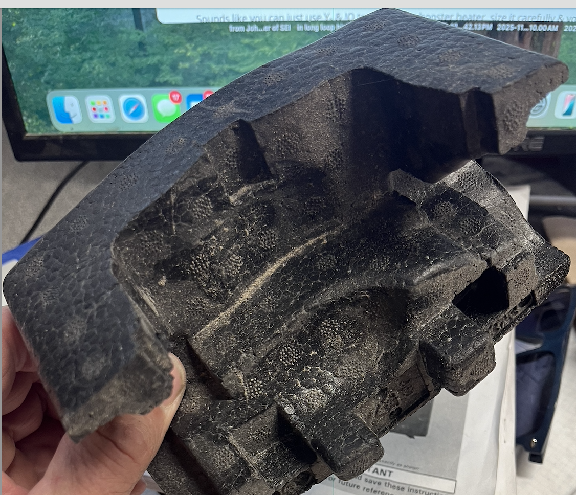

    Grundfos actually has pump insulation. I don't know if they are offered in the U.S. market however. Perhaps on some of the GEO specific pumps?
    This came on a sample Euro pump I received from Caleffi Italy.
    Is that insulation or packing material? 😅

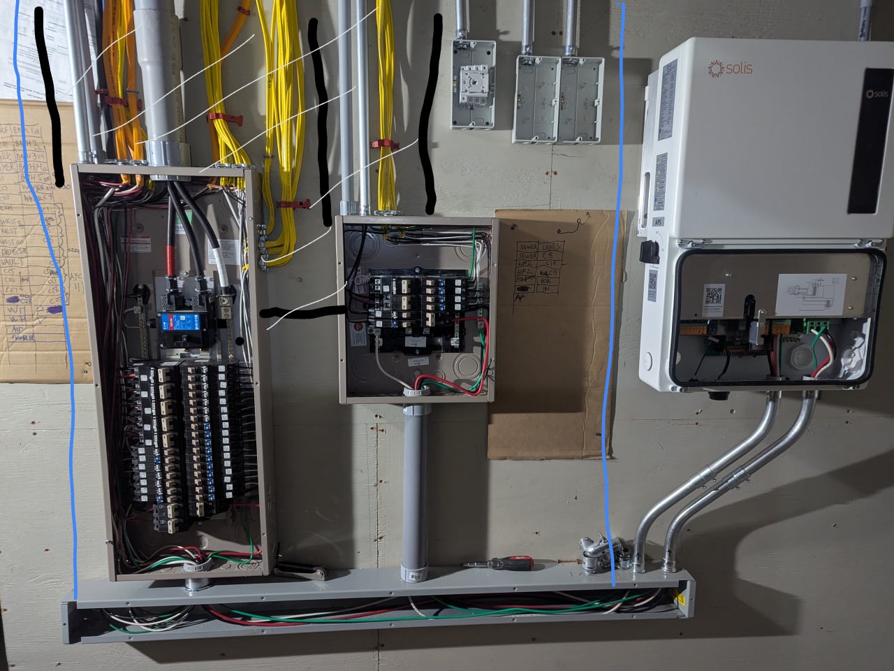

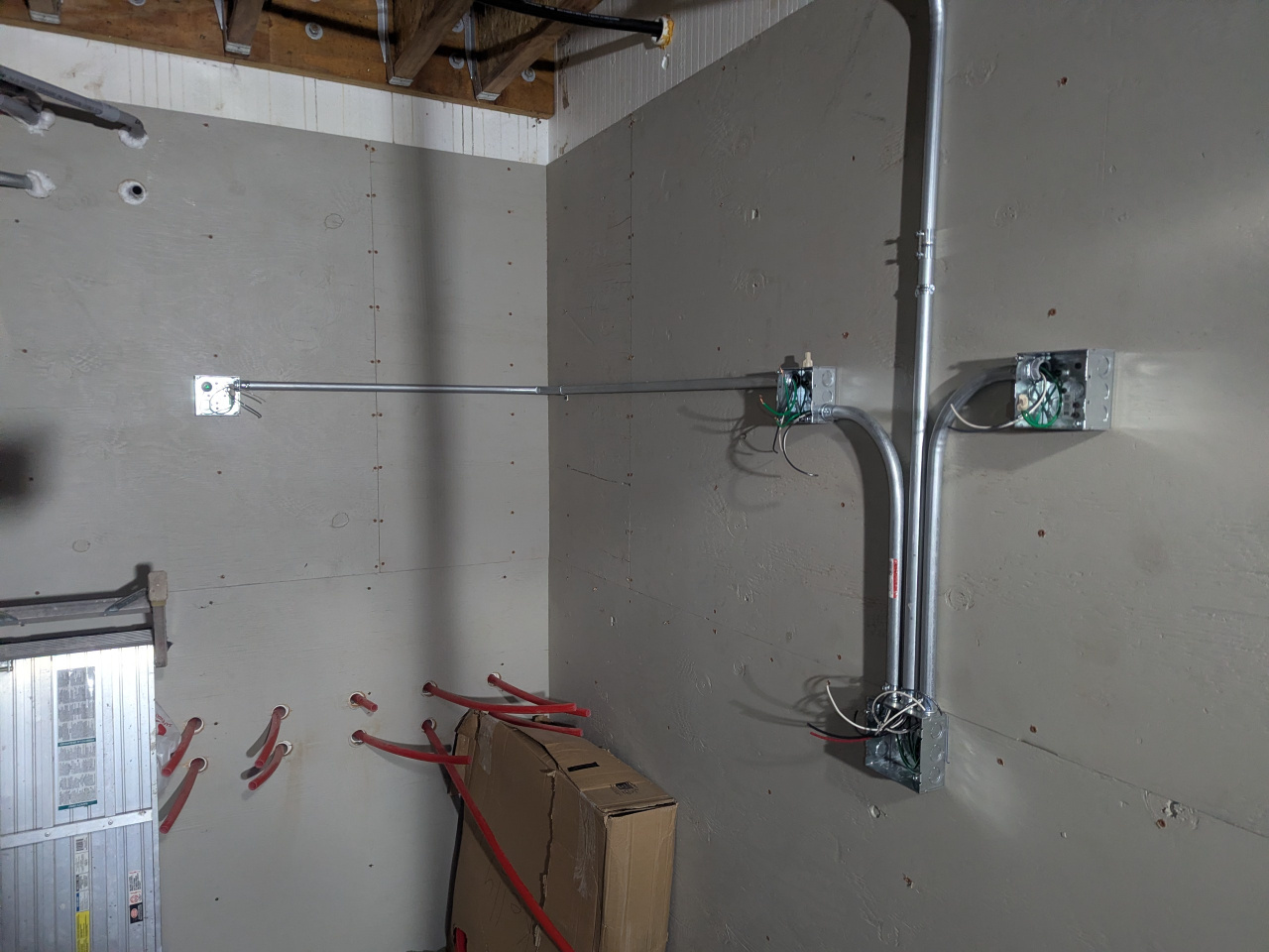

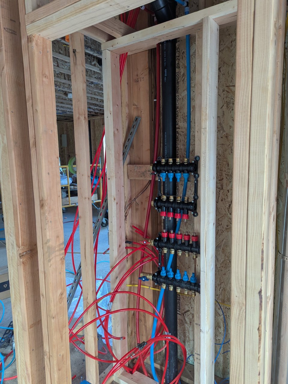

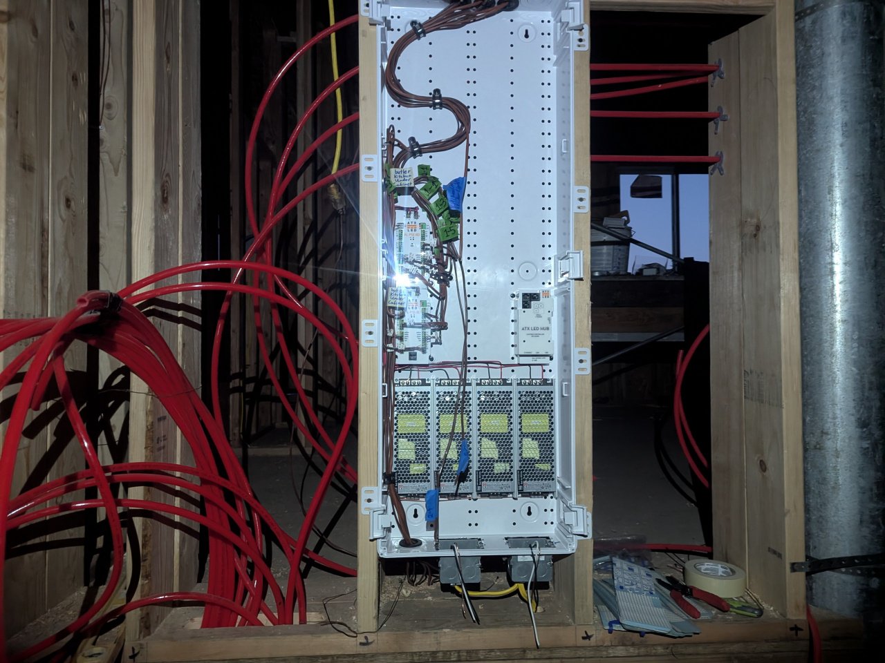

    things are moving along. I started framing in the chase and manifolds at the east end. We will land those 9 runs early next week and the other 11 later.
    I passed electrical inspection late last month and solar panels and inverter yesterday, it is on a separate permit.
    @240 V low for the HP and 120V high out of the way for circ pumps and stuff.
    All that is on the critical loads panel.
    Inverter with the green sticker. IMO first means of disconnect, blue Midnite Solar Surge Protection Devices.
    Remote battery vault outside on the 1" to the right. I don't trust those batteries under my house.
    I used a gutter for the back and forth. The diagonal lines are a cover over the exposed romex.
    Critical Loads panel fed through the Solis 11.4 KW hybrid inverter.
    All the lighting, ceiling fans and bathroom fans are 51VDC low volt out of this cabinet.
    There are the other 11 runs.

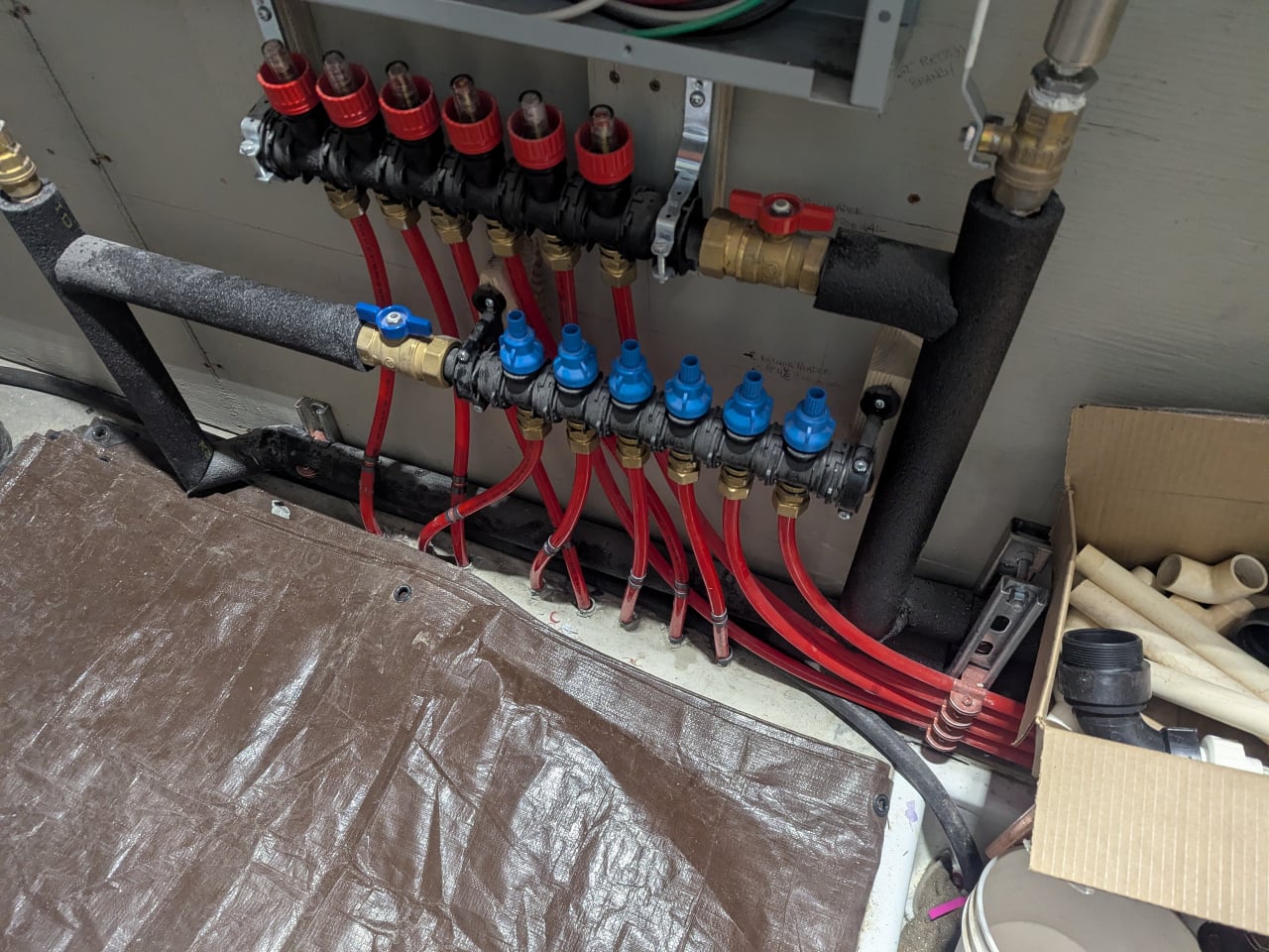

  • skyking1
    skyking1 Posts: 164
    so it begins, Hydronic headers getting started.
