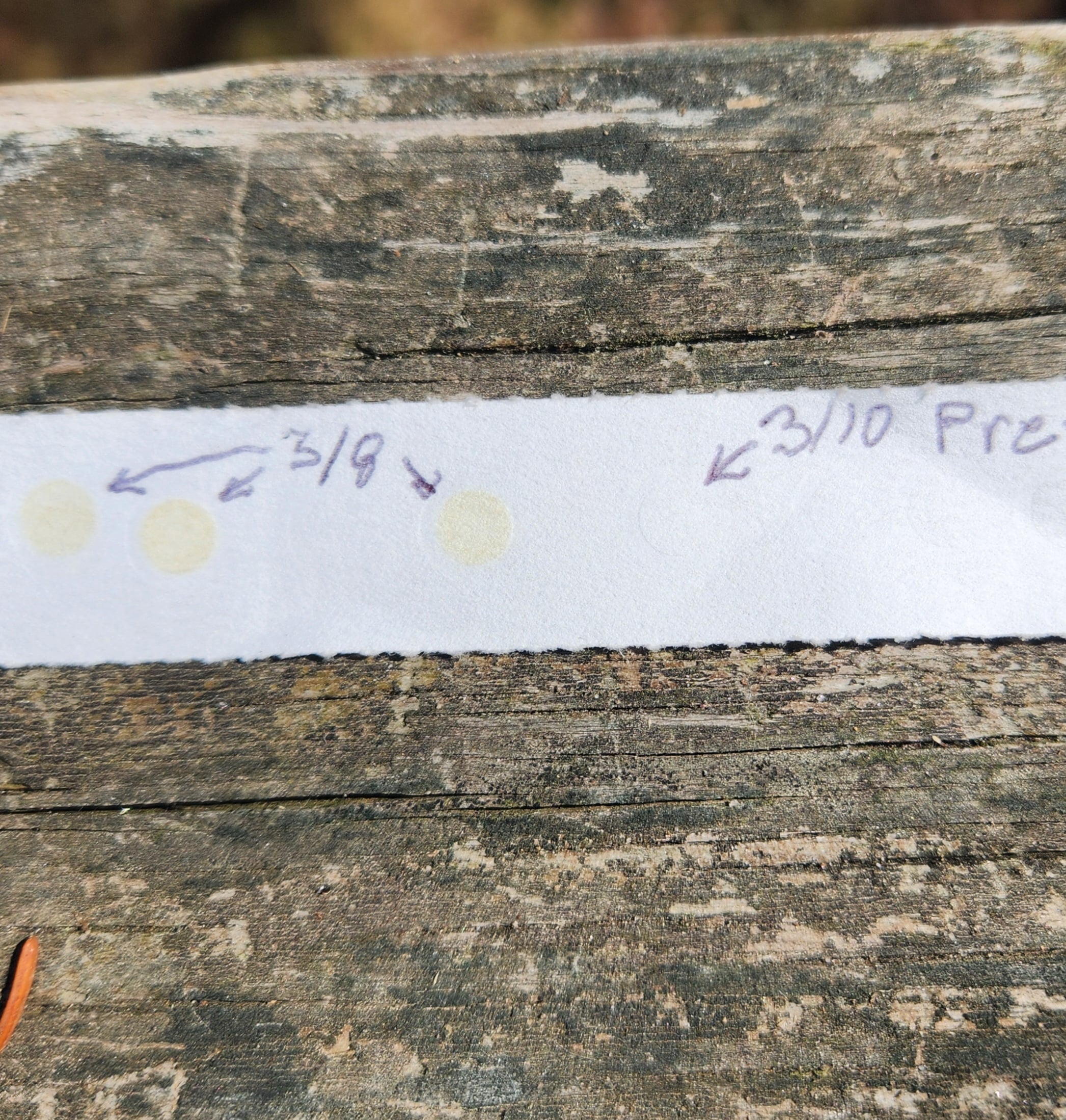

I pulled yellow spot on every smoke test I did, that and the High net stack temps tells me high excess air yet, Excess air is a little low for what I usually end up with at a final reading. O2 and CO2 are reasonable.
The head is clean and when I had the door open I pulled the gun and really cleaned the tube and especially the venturi area with a brush and rag. So I don't think there is an impingement issue.
I don't get yellow on the smoke test very often and the few times I have it was confirmed with high excess air. but not the case here.

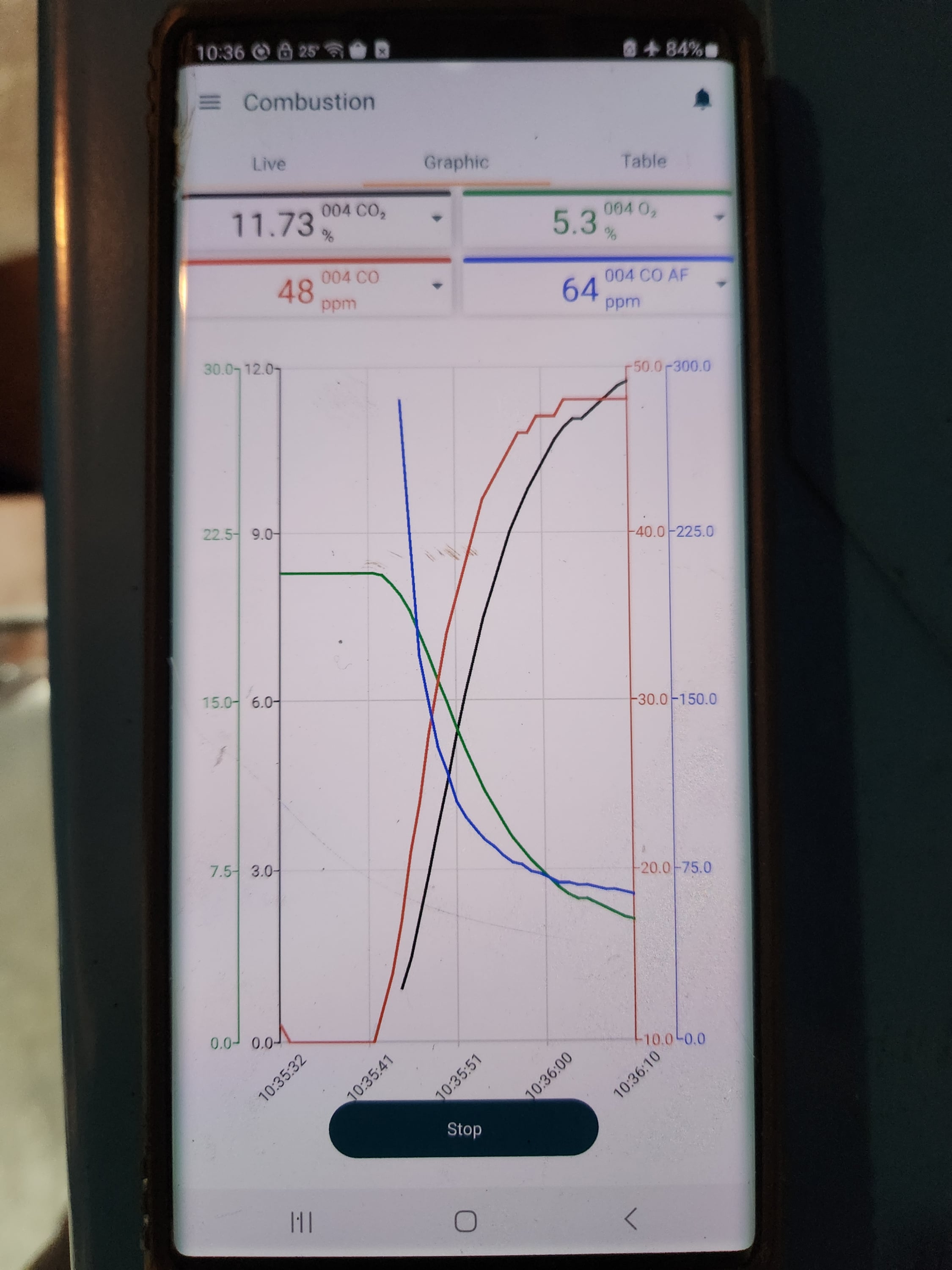

    Also CO numbers at light off, at steady state-rising, falling, stable, and at shut down.

    TOO MUCH AIR. Your flame is too lean. the residual soot that was not vacuumed out completely is making you have a #2 or higher smoke test from an otherwise clean flame. After a week, go back and reduce the air mixture. (probably from the #2 setting back to #1 setting) and see if you get a zero smoke with no yellow spot. That yellow spot is unburned oil vapor that is getting blown out by the excess air

    "That yellow spot is unburned oil vapor that is getting blown out by the excess air" that is a perfect explanation.

    Returned today to re-setup the burner. To start I pulled smoke and checked combustion the numbers were nearly identical and I was pleased to see that CO an CO/AF had improved. Also the yellow spot was clear which I didn't expect.
    I set the head back to position "2" and decreased air, getting a 1 smoke and back to a trace. Then adjusted the draft for .03 OF and readjusted to a trace, added air to get -1.5ish CO2 and check for a zero smoke.

    @HydronicMike Once the other readings were steady CO was flat as well.
    CO during burner start
    CO during burner shuts down
    I truly appreciate everyone's help and will appreciate any further comments
