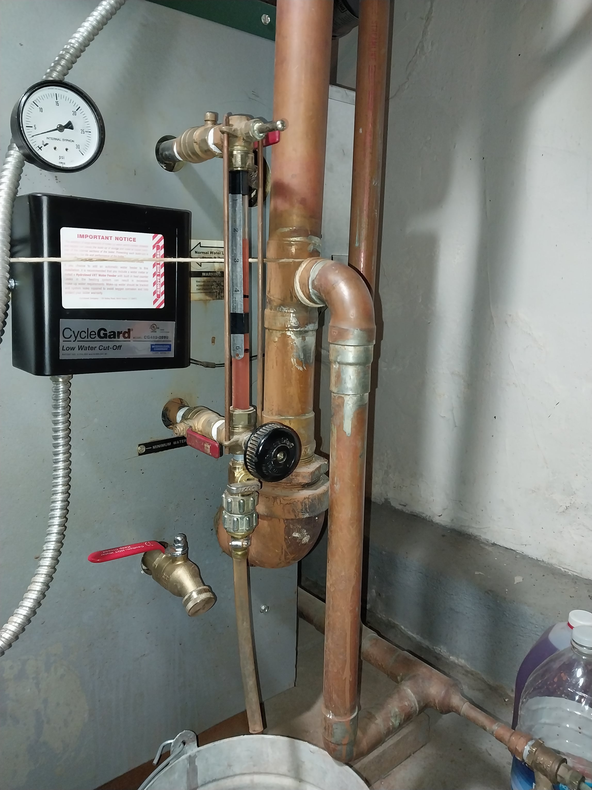

I’m in short cycling hell with my peerless single pipe system for a 7 door apt bldg. Boiler kicks on, within 45second vaporstat reads 15oz, water dancing in site glass, about a minute in, water drops below llwco and triggers off, 30-45 seconds later boiler kicks back on, and the process repeats. My building is not warming up as these cycles are every minute or two. I took a video and attached it here any help would be hugely appreciated. Everything is properly vented with mains and I’ve checked all the vents and all the radiators. I had the equalizer extended to spec about a month ago as it was too short as installed and not to manufacturer specifications. I thought this was the answer to keep the water in the boiler and it seemed to work for a few weeks but now back to the same old situation againMy head is going to explode.

    Please don't let your head explode: I just looked at the video and you do have a problem with pressure causing the water level to drop just enough to cause the LWCO to shut down the burner. I wonder how your return pipes are connected to the boiler? I wonder why the water in the boiler is so dirty?

    Is this a new installation? Was it skimmed after installation? You mention new pipe work, was the boiler skimmed after that? I see obvious signs of surging based on the bubbles coming down from the top of the sight glass. It looks like skimming is in your future to deal with the surging. Are you using any water treatment?
    What does the piping arrangement above the boiler look? It appears correct in the video, but it's hard to see. That wouldn't be my first thought on the issue, but it doesn't hurt to check it.

    sure sounds like it is surging because there is oil on the water in the boiler that needs to be skimmed off, or possibly priming because an additive is causing it to foam.

    Something is causing a fast buildup in pressure of the chest to push all the water down through the return, just can’t figure o out how or why.
    The two previous responses explained what is likely happening. It's surging/carryover which isn't so much pushing water down through the return, but is carrying water up into your main.
    There could also be a pressure issue that is causing some water to push out the back of your boiler if you have a two-pipe system, but take care of the carryover first.
    Drain and refill your boiler and watch it for a week to see if the behavior goes away. If it does then you can add a small amount of 8-way in there, but not a whole bottle probably. Put in 1/3 of what the bottle says to put in and then see if everything is OK.
    If your water has a lot of junk floating in it, then 8-way can cause surging and carryover so I always like to make sure the water is very clean before adding it….or be ready to drain and refill after it loosens up more gunk.

    do you have the nipple in the skim tapping pointed in a direction where it functions when you are actually skimming?

    Sounds much better but I'd prefer to hear that you are getting about 1/4 in. of bounce or less. See how it goes over the next month. You may have more cleaning to do and if you were getting a lot of carryover it will take a while to get that out of the mains radiators and dry returns if you have those.
    Have you verified that the height of the top of the close nipple of the Hartford Loop is 2 to 4 in. below the normal waterline? You may need to tie a string around the top of it and wrap the string around to the sight glass with a level to check it on each side of the boiler.
    The 8-Way instructions are a bit vague on dosing because they use a color indicator (which is also subject to being inexact) but they say 1 qt. bottle is for "up to 30 gals.".

    yes the nipple is exact as per the peerless install manual (6” nipple). We also marked it on the boiler and yes it’s approx 3” below the “normal water level” mark next to the site glass. After running for close to an hour my vaporstat finally cycled the boiler off at 16oz. Likely I will have to do some additional boiler system flushes because the water is back to being pink again. Though not as deeply pigmented as before but definitely pink meaning the chemical and other crap still lurk.

    it should not foam. that is called priming and is one of the ways water can leave the boiler as a liquid.

    I checked it out. You are foaming and/or tilting a bit as shown by how the water in the sight glass dropped down appreciably very shortly after the burner shut off on the vaporstat cutout.

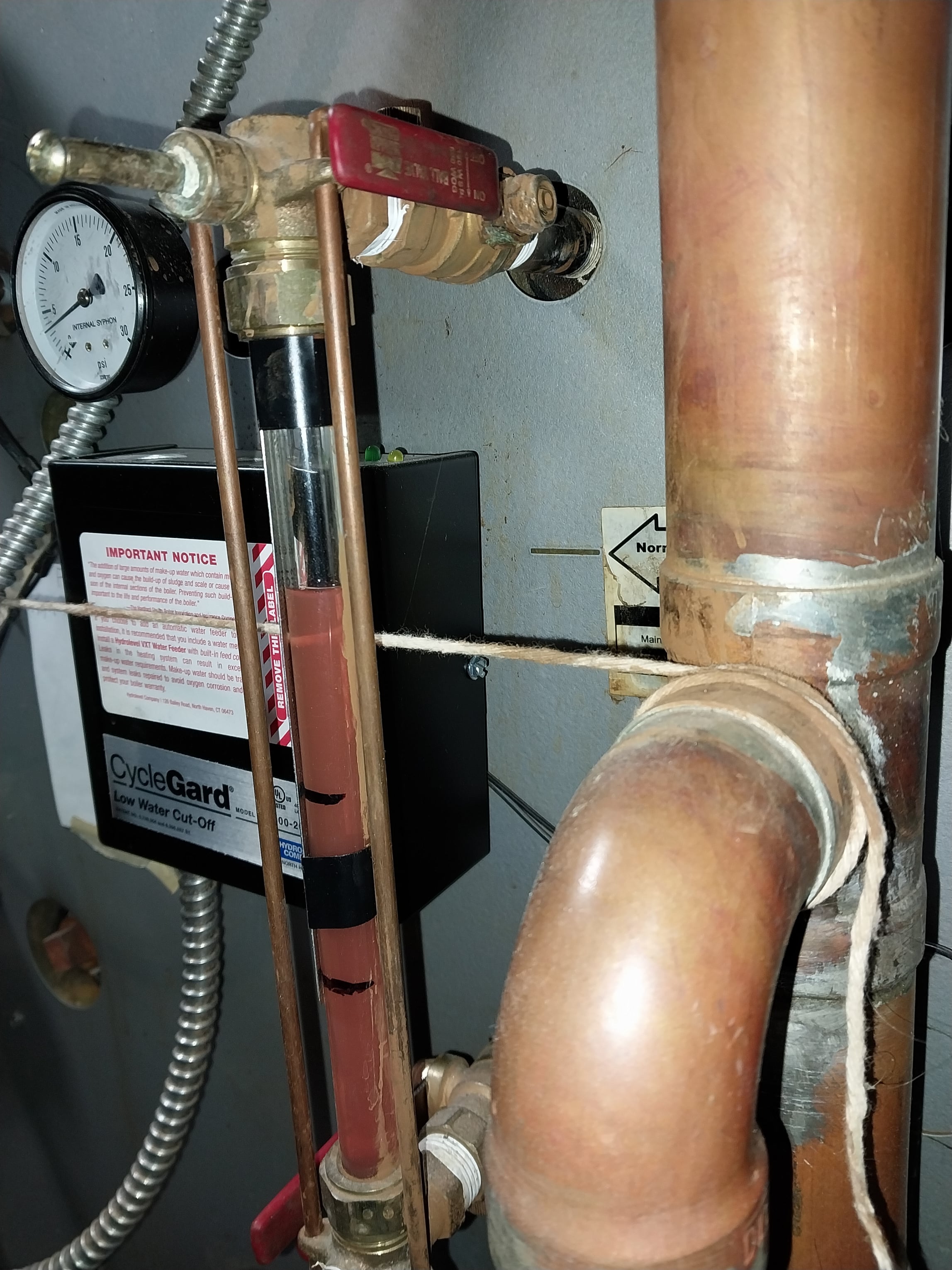

    How not to pipe a Hartford Loop when the installer doesn't read the Peerless installation manual. The shutoff valves have a drain so I can remove the cap and blow out with an air compressor ensuring no blockages.

    yea on my PB the loop is on the opposite side of the glass and controls

    And doesn't block off the skim port 😆 But I was also referring to the height on mine. The top of the close nipple is pretty much right at NWL.
