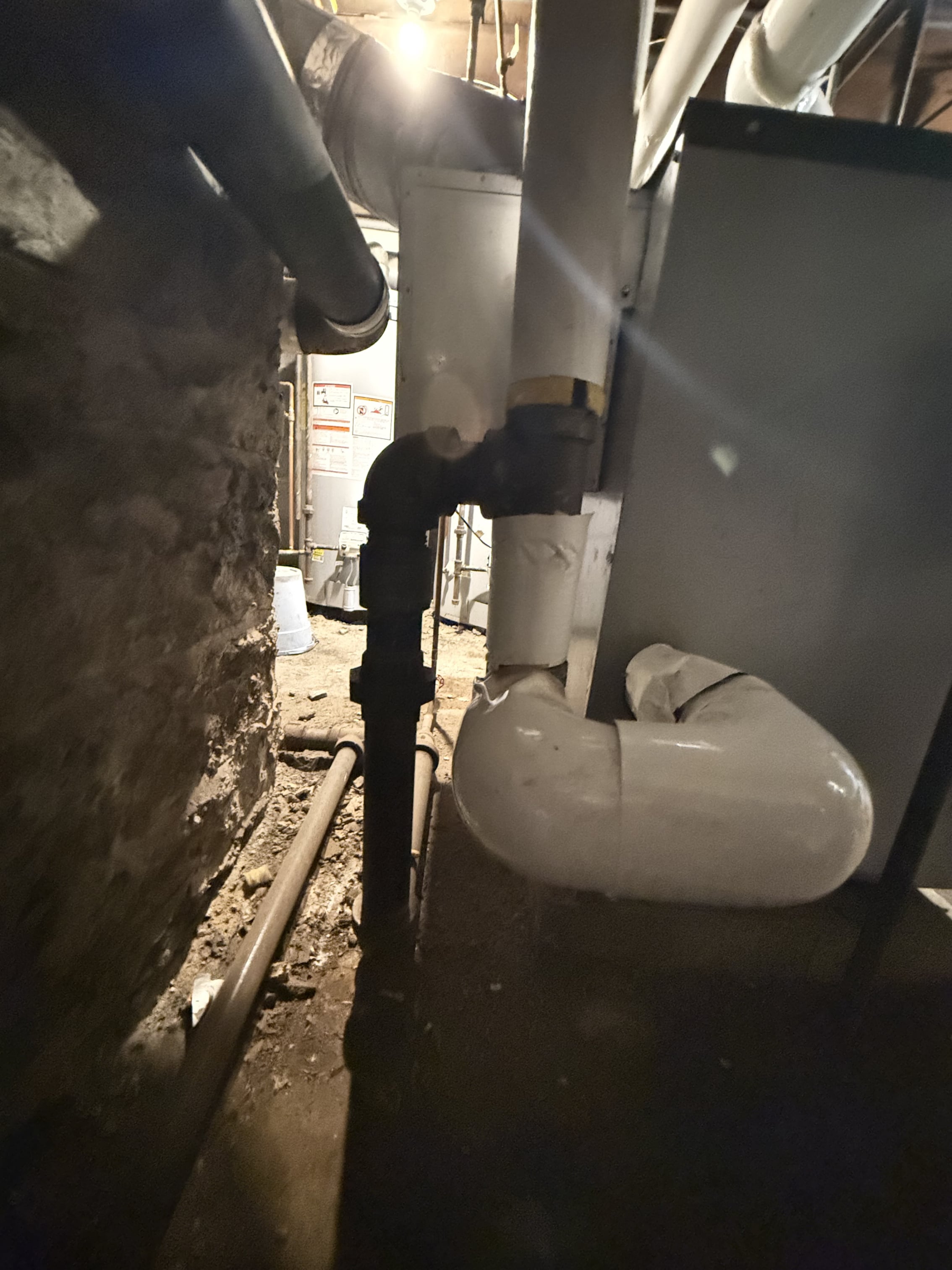

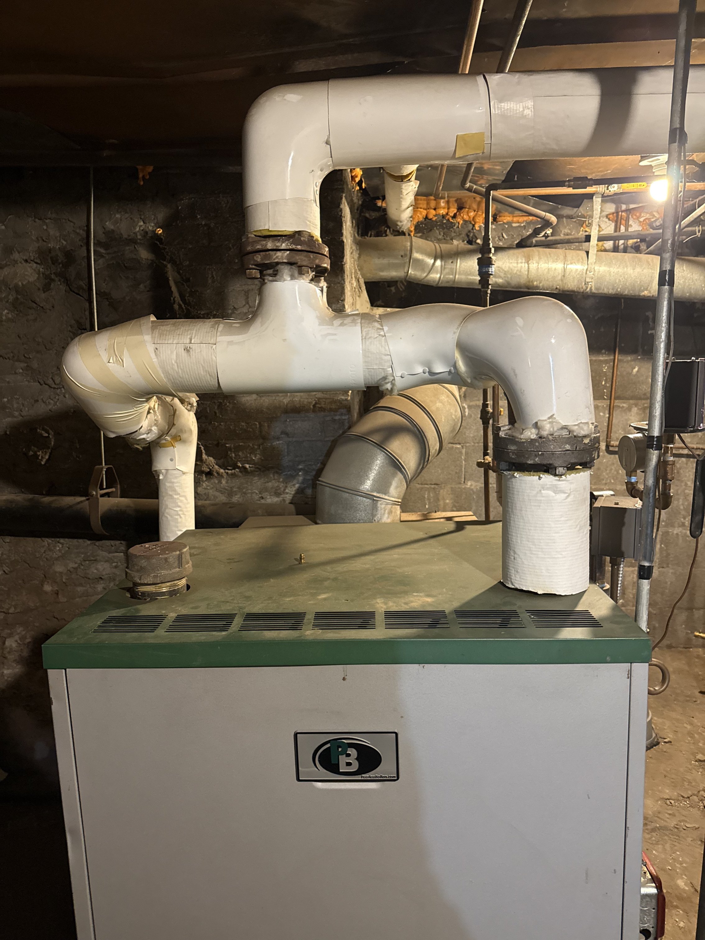

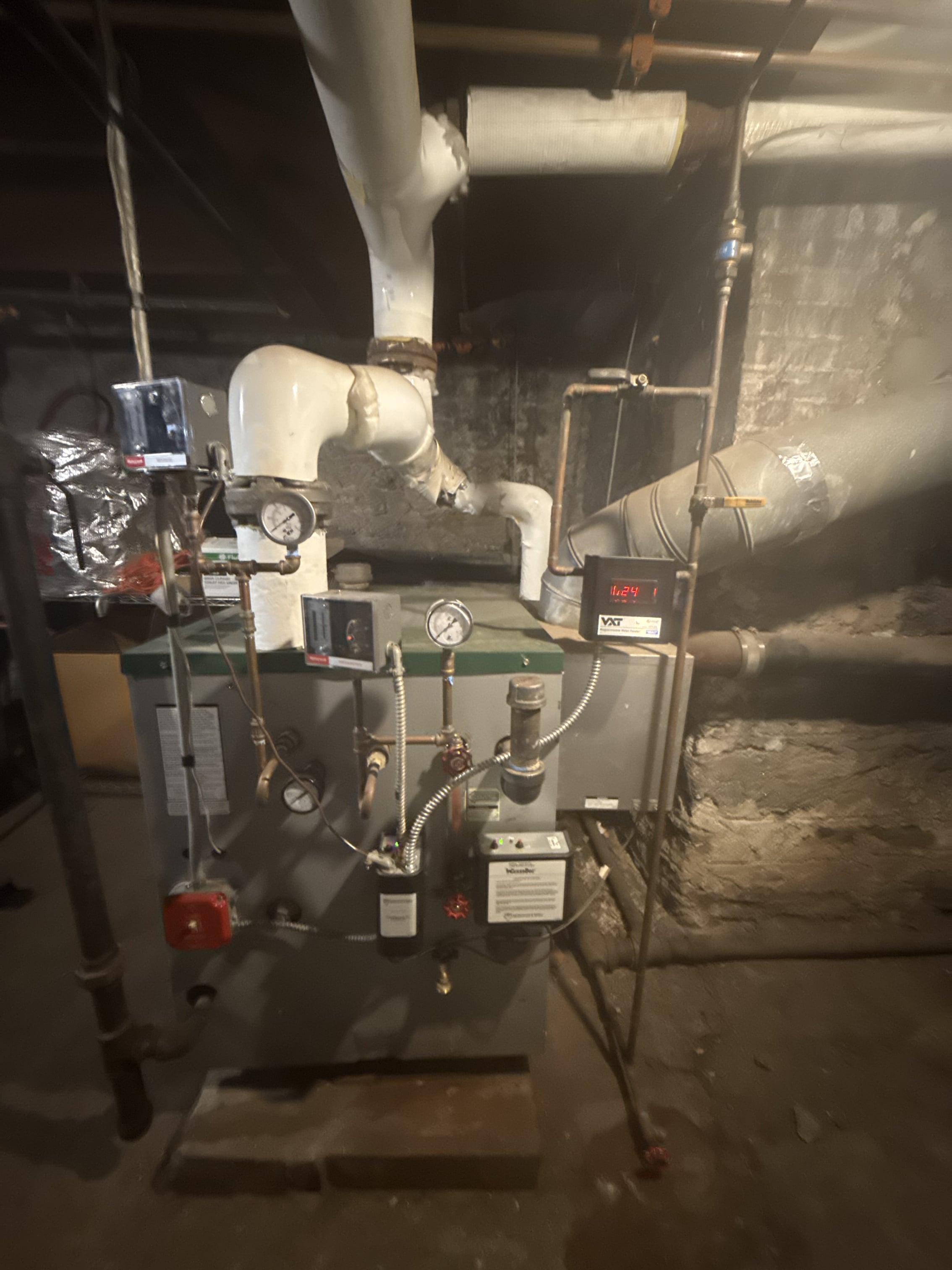

I’m in short cycling hell with my peerless single pipe system for a 7 door apt bldg. Boiler kicks on, within 45second vaporstat reads 15oz, water dancing in site glass, about a minute in, water drops below llwco and triggers off, 30-45 seconds later boiler kicks back on, and the process repeats. My building is not warming up as these cycles are every minute or two. I took a video and attached it here any help would be hugely appreciated. Everything is properly vented with mains and I’ve checked all the vents and all the radiators. I had the equalizer extended to spec about a month ago as it was too short as installed and not to manufacturer specifications. I thought this was the answer to keep the water in the boiler and it seemed to work for a few weeks but now back to the same old situation againMy head is going to explode.

    Is this a new installation? Was it skimmed after installation? You mention new pipe work, was the boiler skimmed after that? I see obvious signs of surging based on the bubbles coming down from the top of the sight glass. It looks like skimming is in your future to deal with the surging. Are you using any water treatment?
    What does the piping arrangement above the boiler look? It appears correct in the video, but it's hard to see. That wouldn't be my first thought on the issue, but it doesn't hurt to check it.

    hi thanks for the responses. This is in Brooklyn and no it’s not a new install. I replaced the block and some return piping about 3 years ago, added gorton #2 to all main lines and repiped the equalizer about a month ago as that was not to manufacturers specs. All basement mains are insulated too. Something is causing a fast buildup in pressure of the chest to push all the water down through the return, just can’t figure o out how or why. I did recently put a bottle of 8 way boiler treatment in which is why the water is pink.

    yes it was and the equalizer seemed to have fixed it for a few weeks. Not sure what has changed. Currently draining the entire system, going to flush fresh water through the returns and refill with water less the additive to see how that goes. I attached a few more pics of the near boiler piping as requested.
    IMG_6549.jpeg IMG_6548.jpeg There was an error displaying this embed. IMG_6551.jpeg

    Have you verified that the height of the top of the close nipple of the Hartford Loop is 2 to 4 in. below the normal waterline? You may need to tie a string around the top of it and wrap the string around to the sight glass with a level to check it on each side of the boiler.

    yes the nipple is exact as per the peerless install manual (6” nipple). We also marked it on the boiler and yes it’s approx 3” below the “normal water level” mark next to the site glass. After running for close to an hour my vaporstat finally cycled the boiler off at 16oz. Likely I will have to do some additional boiler system flushes because the water is back to being pink again. Though not as deeply pigmented as before but definitely pink meaning the chemical and other crap still lurk.

    How not to pipe a Hartford Loop when the installer doesn't read the Peerless installation manual. The shutoff valves have a drain so I can remove the cap and blow out with an air compressor ensuring no blockages.

    yea on my PB the loop is on the opposite side of the glass and controls
  • Captain Who
    Captain Who Member Posts: 883
    And doesn't block off the skim port 😆 But I was also referring to the height on mine. The top of the close nipple is pretty much right at NWL.
