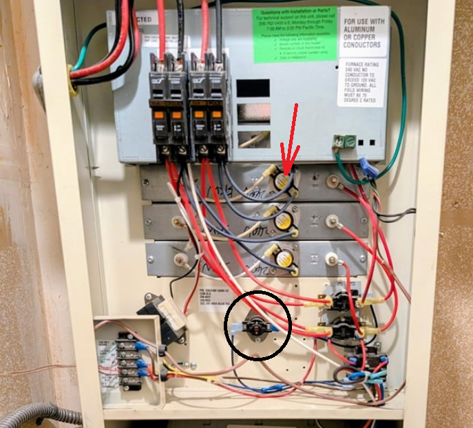

The sequencer, I'll try to find some specifications, I suspect there is a delay for the second stage. How long have you run the furnace for ?

It looks like the 'sequencer' is just a time delay relay with with two sections (that are the same) and 2 switches per section. The second switch may close some random time after the first contact in each section closes. The switch pins 1 & 2 also power the blower in heat mode. Since both sections seem to have the same specifications. Looks like the unit you found is a reasonable replacement. Just make sure you really need it.

I ordered the sequencer. Even though my in family expert blew the wiring I trust him that 2 of the heating elements aren't getting power from the sequencer. I watched him take those measurements. And even with this new part the total cost of parts including motor, mount bracket, capacitor and sequencer is less than just the hello we're here service charge from the company that didn't do anything.

If it was just a failed blower, I would expect some heat would be noticeable and the heating elements would be cycling on and off with their High Temp Limits (Red arrow) until the whole unit heat soaked and the Manual reset High Temp Limit tripped (Black circle) and locked out the control signal calling for heat.
Since (if I remember correctly) you simply had no heat related activity of any sort, if you activated the "Summer Fan" switch the blower would come on. This tells me there is 240 VAC power to the unit and the 24 VAC control voltage is also present. So my first guess at this point is there was no control voltage (24 VAC) getting to the sequencer relay. I don't think you had the opportunity to research that hypothesis.

It's been more than a week now since I replaced the sequencer. The new motor works silently and the furnace has functioned perfectly since the new sequencer was installed. Good timing too since we are getting snow today!
So the sequencer may have been the original problem but the motor needed refreshed also.
Thanks for all the help!
Well I wish you all the luck in the world. Going in and moving everything like it would take to change the sequencer relay may mask an intermittent problem, only for it to return later. Crimp connections are notorious for subtle intermittent issues.
With the information previously given I don't believe the symptom(s) define a sequencer relay issue.
