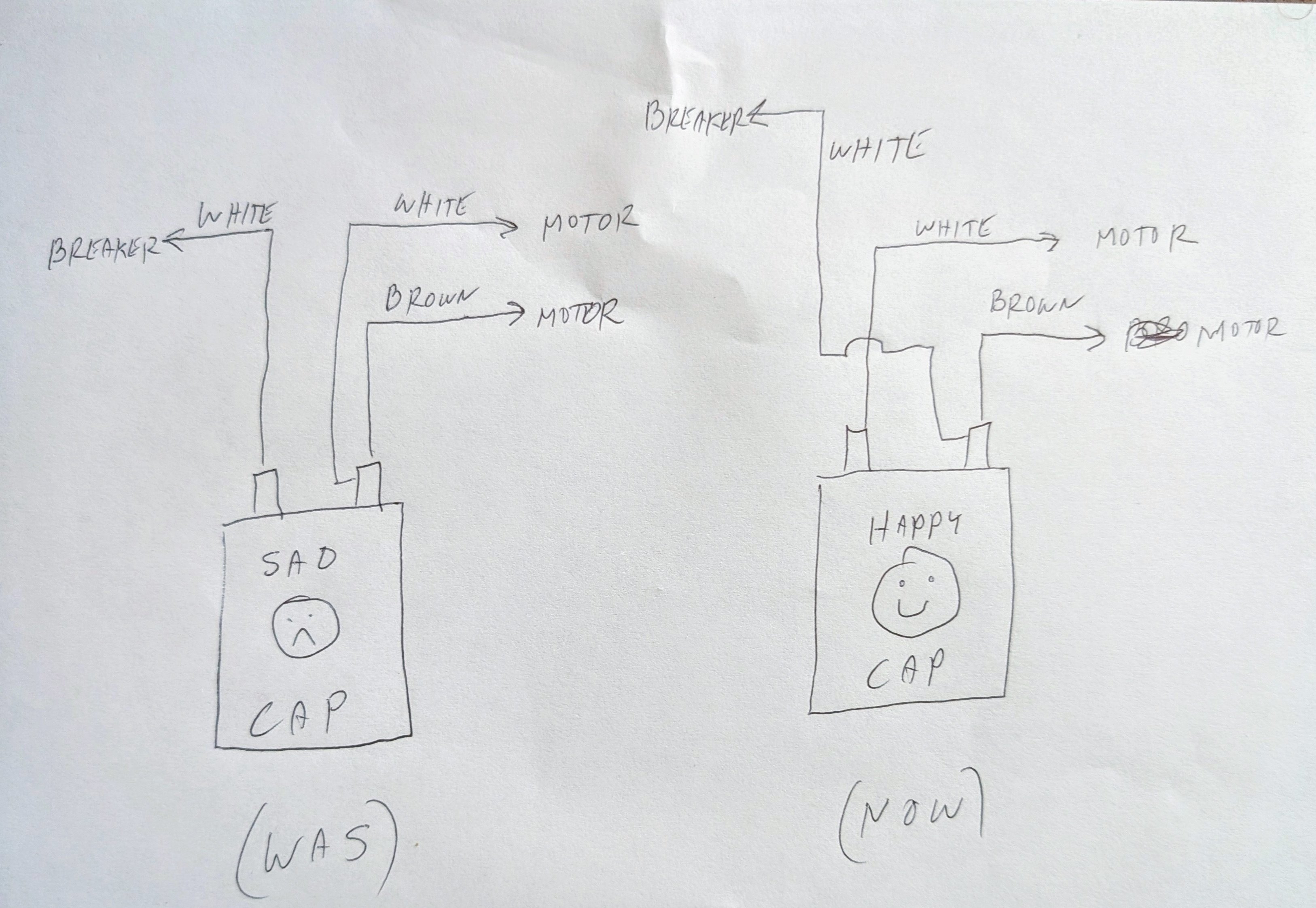

  • kadini
    kadini Member Posts: 38
    OK, my daughter in law's father is a retired electrician. Not a furnace repair person but he has knowledge, experience and tools that I am lacking.
    He found out we didn't have heat so he drove 2 hours to look at the furnace. He made the following change.
    Now the motor turns and the furnace appears to be working. Not only is it working but it's so quite at first I thought it still wasn't working. Previously with the old motor you could tell when the heat was on anywhere in the house from the noise.
    So hoping me having it hooked up wrong didn't hurt anything. But I could swear I matched the old wiring and still don't understand the wiring diagram and the CAP connections but hard to argue with success.

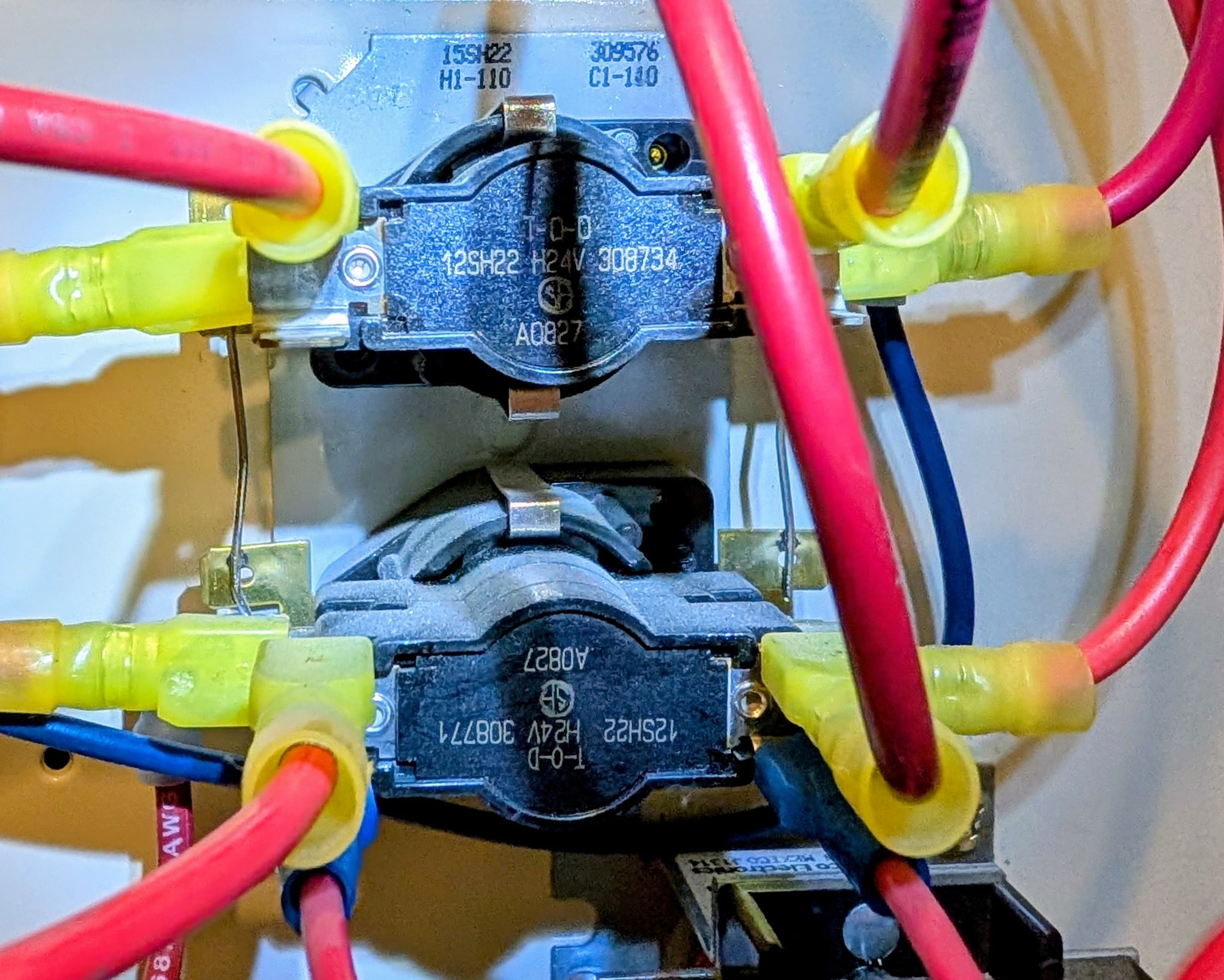

    My daughter in law's father also told me the sequencer has 2 bad switches.
    Based on the 15SH22 number on the unit I found this:
    https://www.supplyhouse.com/White-Rodgers-24A34-6-Electric-Heat-Sequencer-4-Switches-On-Timings-1-110-Sec-Off-Timings-1-110Sec
    Is this the correct replacement sequencer?
    My daughter in law's father said he thought I could replace the unit myself. Just take the old unit loose, swap wires to the new unit one by one, attach new unit.
    Again thanks for all your help past and present.
