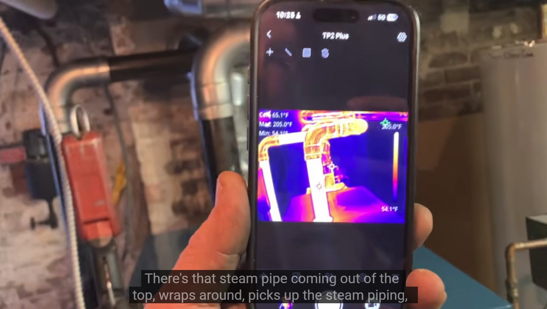

    Captain Who Member Posts: 783
    Does a thermal imaging camera lie or is this equalizer darn near steam hot down to the Hartford Loop? courtesy Mikey Pipes

    steam is 212f at sea level

    LOL. The header was a bit cooler than the equalizer. OK the elbows were. The equalizer was 203.4 F max and the takeoff 205 F
    ethicalpaul Member Posts: 8,633
    the elbows are probably misreading due to reflectiveness

    It's emissivity which is different from reflectivity (perfect black body has the most emissivity but lowest reflectivity). But yeah, for opaque material they are pretty much opposites. Very much not so for non opaque bodies. These infrared thermal imaging cameras have to be calibrated to a particular emissivity assumption and the emissivity of that MegaPress elbow is actually way less (probably 0.23 to 0.28) than the emissivity of that black painted black iron pipe (probably 0.88 to 0.98), so the camera is under reporting the temperature of the elbow because it wasn't properly calibrated for that material's emissivity.
    If you wanted an accurate comparison reading between the two you would have to coat them with the same black coating, but the point I was trying to make is that the takeoff and the equalizer are the same pipe and the comparison between them is very valid.
