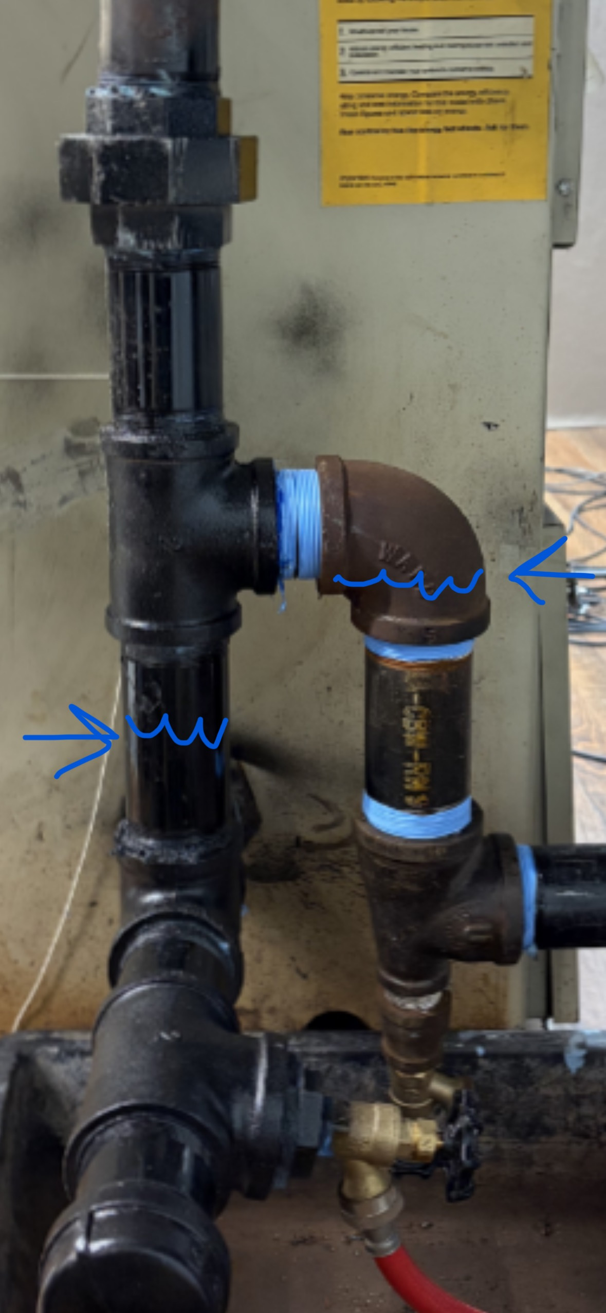

    Just to close this out (I think), the existing piping (L) is now rearranged (R). So far so good as far as no water hammer. Thanks to all for your assistance.
    bburdCaptain Who4GenPlumberttekushan_3
    109A_5 Member Posts: 4,227
    Looks like they used the same pipes and just rearranged them, easy. Maybe the blue tape helped too.

    mattmia2 Member Posts: 17,563
    i doubt that is where whatever they were trying to fix was…
  • Captain Who
    Captain Who Member Posts: 883
    edited February 17
    Why? Because you still believe that steam doesn't enter the equalizer due to air being there?
    @stevesorenson Please report again in a week or two, on whether the water hammer was solved for sure by this rework. Nice job.
    PS: Keep an eye on your sight glass levels relative to the height of the close nipple. Amazed that your Dunkirk manual says a whopping 6 in. from CL of close nipple to NWL. That's the most I've ever seen a mfg. say to do it.

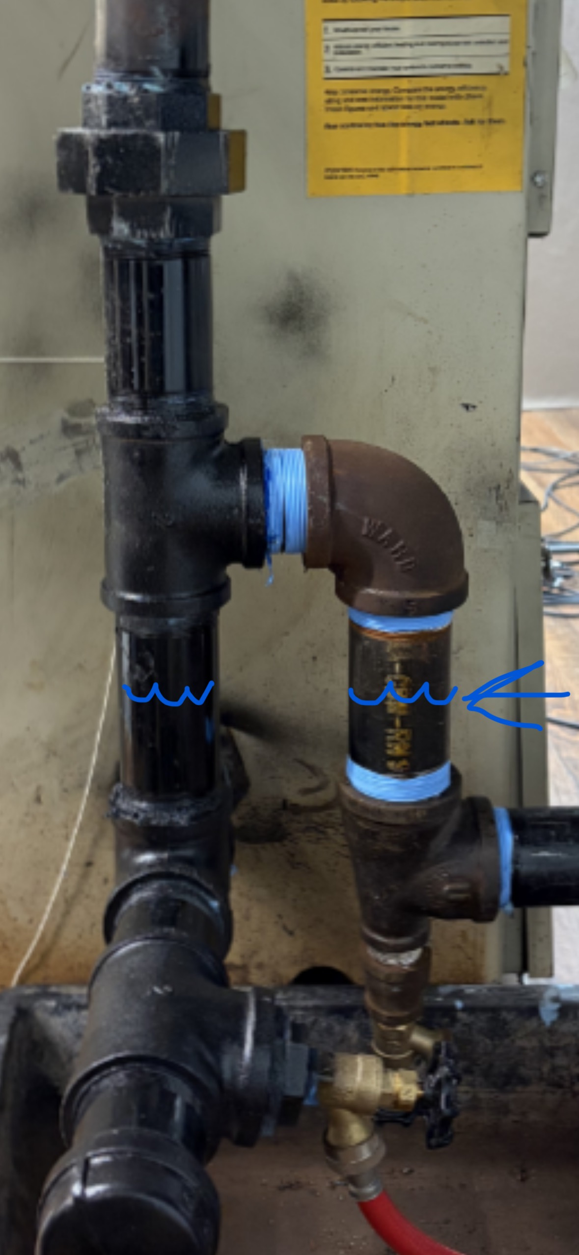

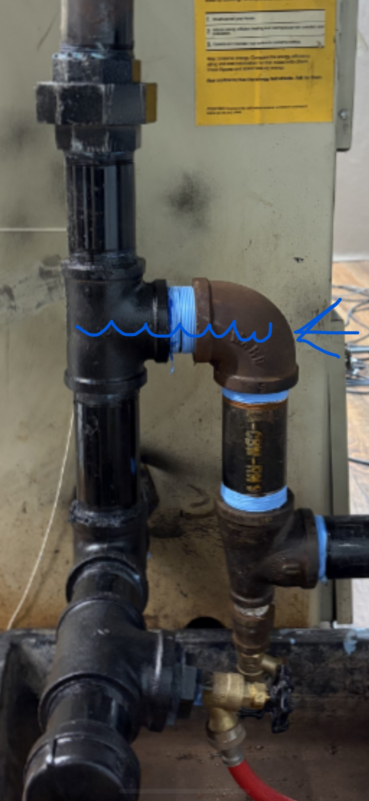

    ethicalpaul Member Posts: 8,933
    edited February 17
    As seems to happen quite a bit when I ask a question that is difficult to answer and still believe in various long-accepted but apparently never-proven ideas in this industry, a question I asked about this before was ignored, so I’ll try again.
    Let’s assume steam does manage to fill the equalizer despite Dan telling us that steam and air don’t mix and that air must escape for steam to take its place. We know that condensate return water does not create steam, right?
    But with steam in the equalizer after the above assumption, what exactly would the difference in system behavior be in these three scenarios below of three different water lines? I can’t think of any.

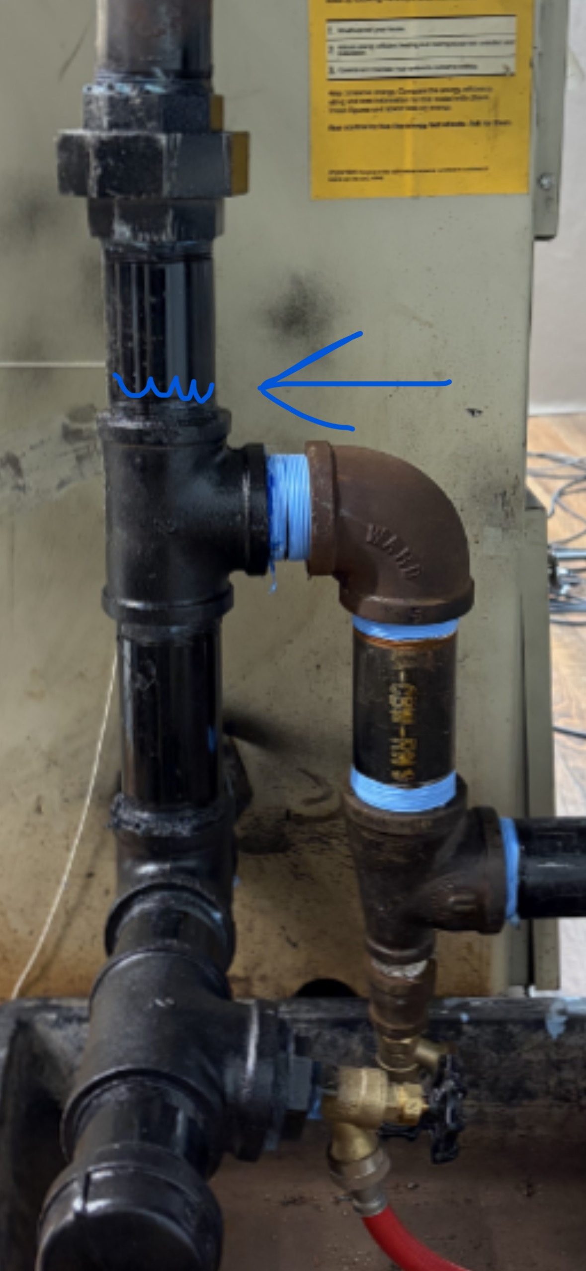

    actually, the above water level would usually be more like below, but the question remains:
    Steamhead Member Posts: 18,735
    Gentlemen, this isn't theoretical. I have seen Hartford Loops bang when they are improperly installed. The cure was either to shorten the nipple between the tee and the elbow, or lower the tee, or both. Maybe someone can build a Loop from Pyrex piping at some point so we can see what's happening, but it doesn't change the fact that an improperly-installed Loop can bang.
    Listen to the Dead Men, via @DanHolohan .
    edited February 17
    was it on a 1 pipe system? i can see it on 2 pipe under just all the wrong circumstances coming together just the right way.
    if it can happen there then on 1 pipe it could also happen on a drip.
    ethicalpaulCaptain Who
  • Captain Who
    edited February 17
    No, because what is lacking in the drip is a horizontal section of pipe where steam can get trapped between waves and condense/implode and also Dan's statement @DanHolohan that steam bubbles are rising up from below, through the water towards the steam/water interface.
    steam will just as happily collapse when it contacts a circle of water as it will when it contacts an oval of water.
  • Captain Who
    But will it make a bang? There is a reason why the manufacturers prefer a Wye instead of a close nipple or a street Ell, but apparently the latter two suffice.
  • patrykrebisz
    patrykrebisz Member Posts: 137
    edited February 17
    in the equalizer pipe you have a bunch of powerful forces fighting with one another: steam, warm/hot air, hot water, coldish pipes etc. as those forces comingle intersting things start to happen that define simplified explanation: steam doesnt mix with air. i belive at some point the hot air finds its way out of the equalizer (despite lack of air vents) thtough all sort of currents and vortexes. as such what you have left in there are steam and hot water.
    i believe, in reference to Paul's question, in the second picture if the nipple is long enough there is possibility of water hammer. on my system slightly badly pitche 1ft horizontal pipe is enough to cause water hammer from time to time.
    (notice my use of the word "believe" rather than "know")
    yes because water gets trapped there, then cools off, then steam comes into contact with it at the next call for heat.
