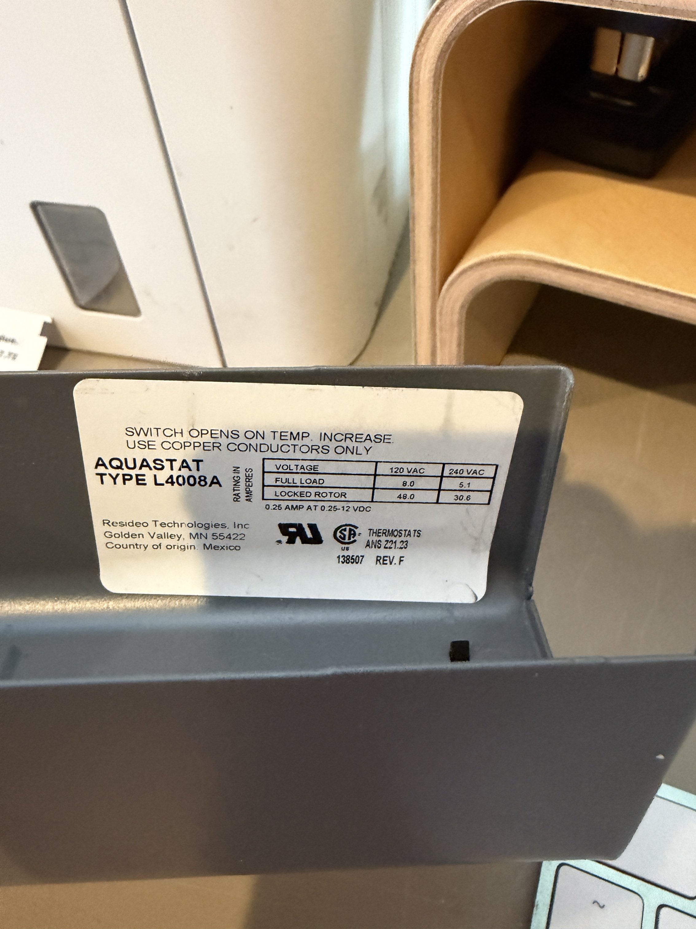

I recently purchased a building with a 250,000 btu Slat Fin Galaxy cast iron gas fired boiler installed in 1994. during demolition of the building the low level aquastat was accidentally removed (it was located outside the mechanical room). When we went to fire up the boiler this winter it was apparent something was missing and a new Resideo model L4008A was installed along with a new temp/pressure gauge. Because the previous immersion probe was seized in the well tube and we didnt have a new one on hand, we installed the immersion probe to the side of the hot water supply line and wrapped with insulating tape. I have the high limit aquastat set to 180 and the low level set to 160 with a 20 degree differential. The boiler has never reached 180 and the low level aquastat never seems to call for heat when the water temp dips down, sometimes nesr 120 degrees.
THE BOILER ONLY FIRES WHEN THE THERMOSTAT CALLS FOR HEAT, NEVER WHEN LOW LEVEL TEMP DIPS BELOW DESIRED TEMP.
Im hoping the issue is becuase i have an immersion style aquastat probe not properly installed inside the well. however i still feel like the low level shouuld be calling for heat, even if its not accurate.

    The reverse setting on a dual aquastat is used to maintain temperature if the boiler has a coil inside to supply domestic hot water. The low side also shuts off the heat circulator from robbing the supply of hot water ..

    do you have a picture of how the aquastat itself is wired? If it’s wired to the bottom & top terminals then it’s shutting off at 160 and isn’t wired as a low limit, it’s wired as a high limit

    What is the B aquastat wired to ? What happens if you jump out the B ?
    The B makes on temperature rise . It is not a low limit …

    EdTheHeaterMan Member Posts: 12,150
    This photo is a picture of a Reverse Aquastat also known as a B aquastat. It appears to be new by the date code in the red box H2542. That indicates the 42nd week of 2025. So sometime in October that control was manufactured.
    On the other side of the metal chassis (indicated by red arrows) is printed a model number that might be L4006BXXXX (with four numbers after it.). Is there a way to post those numbers so we can look up and know what that control is capable of
    From that photo I can tell you that it is connected by wires to a 24v. control circuit, but I can not tell you what it is connected to. That same metal chassis can be used for other Aquastat controls with very long probes that can measure the temperature from outside the building or from a room that is several feet away or from a pipe that is somewhere behind that wall the control is attached to. The probe might look like this:
    By the dial setting and the wire terminal designation I can tell you that the control pictured will turn on something when the temperature probe is at or above 160° and that the control will turn off that device when the temperature is at or below 155° if the control has a fixed differential of 5°. If you are expecting that control to turn on a boiler when the boilere temperature is below 160°, You selected the incorrect control.
    Here is the terminal designation of the L4006 and L6006 controls. W at the top R in the middle and B at the bottom.

    ok the "B" aquastat (pictured) is mounted outside the mechanical room with the temp probe passing through the wall and connected to the hot water supply pipe.
    edited February 25
    OK that control os a operation control that will power on a control if the temperature at the probe is lower than the set point of the dial. That means that you should be able to use that to turn on a burner the burner should stop when the temperature exceeds the 160° set point and then the burner should start once the temperature drops to 155° if the differentia is set to 5°. That control has an adjustable differential from 5° to 30°
    To determine what is going wrong, can you show me where the other end of the red and white wire on that control are connected to?

    if you scroll up you can see the photo i posted where the stat wires are labeled. "stat" being the thermostat and "Aqual L" being the low limit. that photo shows the high limit aquastat mounted behind the access panel on the boiler.
    HVACNUT Member Posts: 7,434
    What does it say on the inside of the cover? There's only 2 terminals, so its SPST. If it says "R-B opens on temperature rise" then you've got another High (A) Limit. You need a B Limit. An L6008B might work. You could also get an L6006C strap on if its feasible.
    This is your wiring diagram to the best I can see from the pictures:
    You've got 2 High limit controls.

    I can feel the current low level aquastat click when i move the dial and it hits what it thinks the boiler temp is at. it also clicks accordingly to how i set the variation dial. currently the low level was set to 160 and the temp gauge was showing 120. I increased the low level up to 200 and the flame kicks on heating the boiler temp to 145-150 then shuts off.
    I believe that is proper usage of that L4008A to be an operator. So you have an operator and a high limit. That is no problem. (Yes @HVACNUT he has 2 high limits).
    There is no better Aquastat control for operating the circulator. If you don't want to have your circulator operate all the time, then you need a circulator relay. Are there any other controls that you have not posted a picture?
    There are relays that the thermostat can operate to turn on the circulator and the burner. That way the circulator only operates when there is a call for heat from the thermostat. Do you want me to send you the info for the control you need, and the wiring diagram that will work for you?
    EBEBRATT-Ed Member Posts: 20,164
    if you are using the Honeywell control to start the circulator it will not work for that. The control you have is a L4008A is a direct acting high limit. It opens the circuit on a temp rise.
    You need a reverse acting control that closes the circuit on a temp rise if you are controlling the circulator with it as @HVACNUT said

    The Low limit need to be in Parallel with the thermostat NOT in series. So each device, the Low limit (160 degrees) OR the thermostat (for the desired room temperature) can call for heat independently.
    The way it is wired in the picture above BOTH the Low limit AND the thermostat have to call for heat to fire the Boiler's burner. Once either is satisfied the burner shuts off regardless of what the other one wants.

    Low limit and the Thermostat connected in parallel.
    ericthor
  • ericthor
    ericthor Member Posts: 28
    THIS FIXED IT! Even the circulator doesn't kick on when low limit calls for heat.
