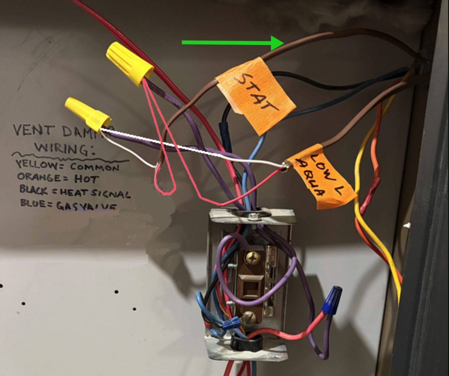

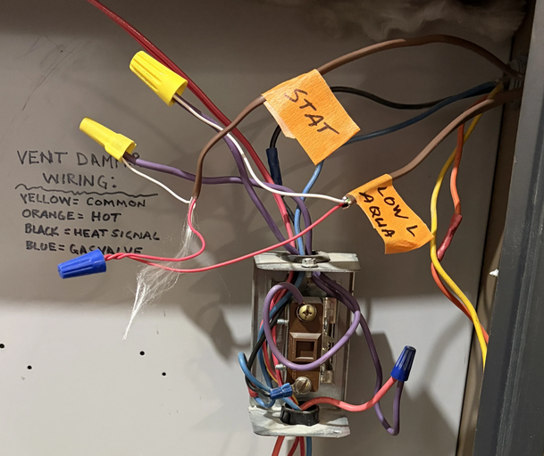

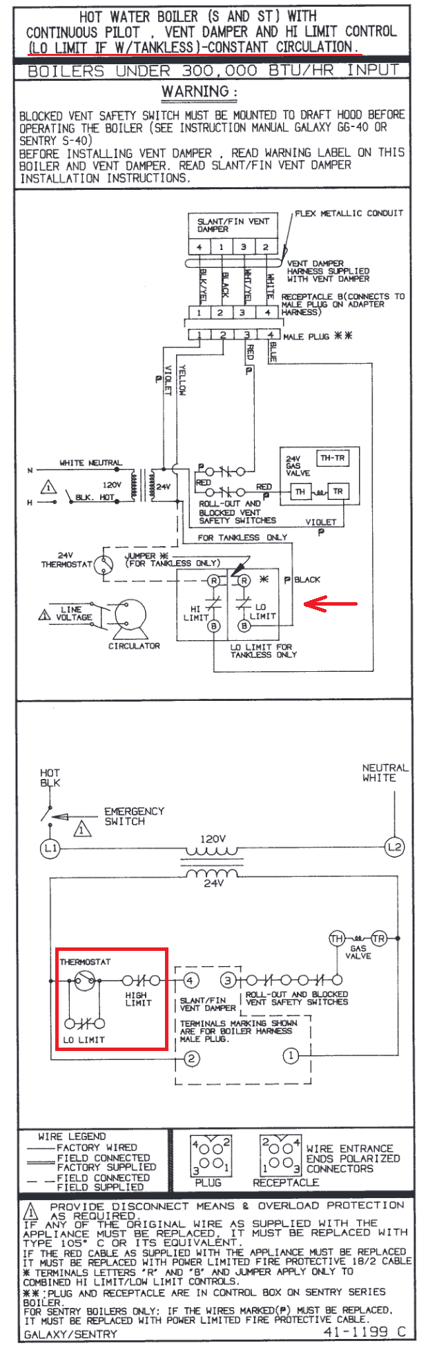

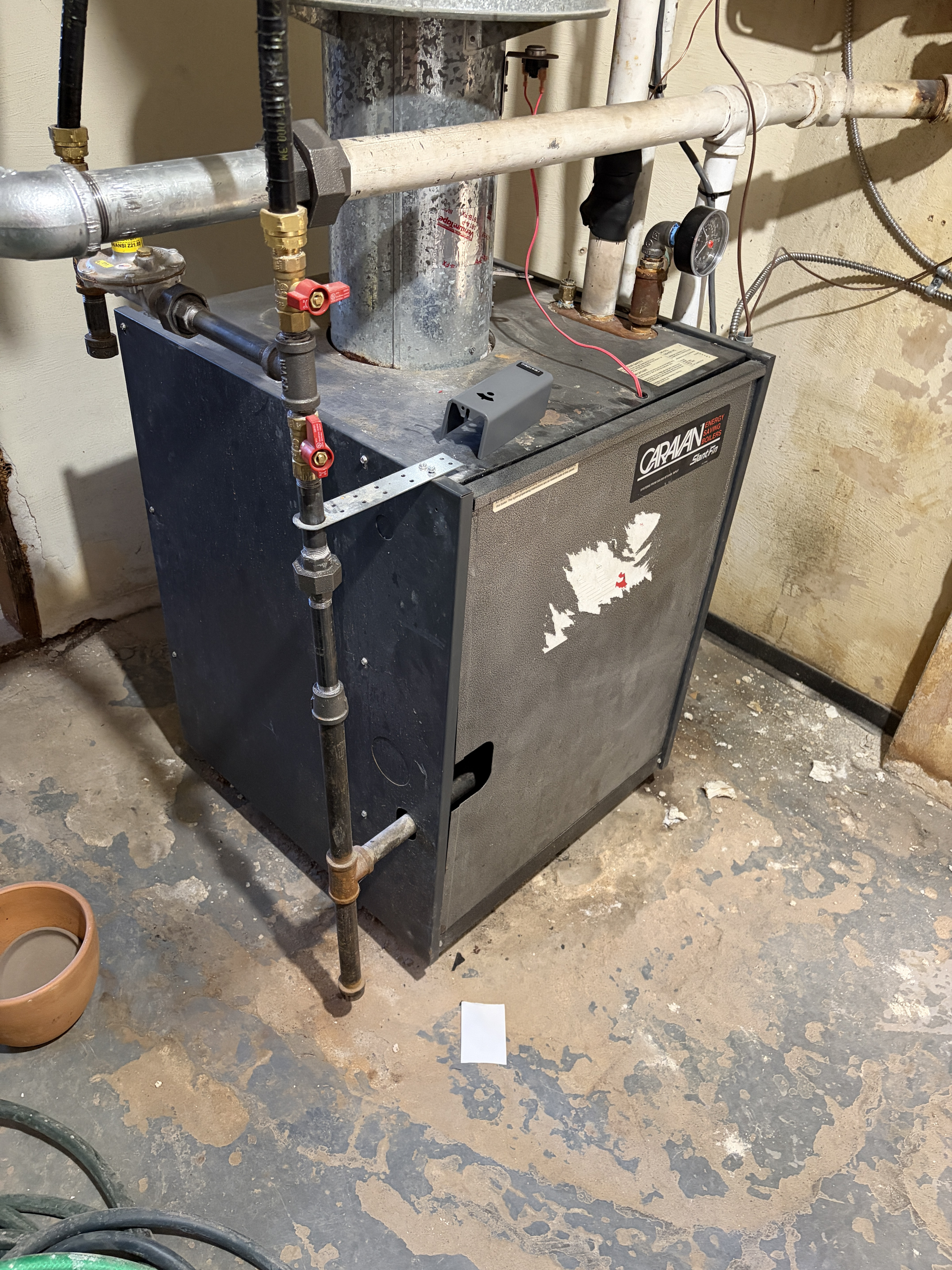

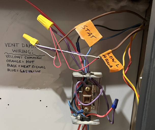

I recently purchased a building with a 250,000 btu Slat Fin Galaxy cast iron gas fired boiler installed in 1994. during demolition of the building the low level aquastat was accidentally removed (it was located outside the mechanical room). When we went to fire up the boiler this winter it was apparent something was missing and a new Resideo model L4008A was installed along with a new temp/pressure gauge. Because the previous immersion probe was seized in the well tube and we didnt have a new one on hand, we installed the immersion probe to the side of the hot water supply line and wrapped with insulating tape. I have the high limit aquastat set to 180 and the low level set to 160 with a 20 degree differential. The boiler has never reached 180 and the low level aquastat never seems to call for heat when the water temp dips down, sometimes nesr 120 degrees.
THE BOILER ONLY FIRES WHEN THE THERMOSTAT CALLS FOR HEAT, NEVER WHEN LOW LEVEL TEMP DIPS BELOW DESIRED TEMP.
Im hoping the issue is becuase i have an immersion style aquastat probe not properly installed inside the well. however i still feel like the low level shouuld be calling for heat, even if its not accurate.

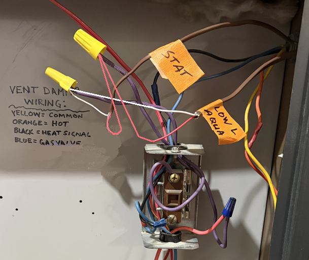

    do you have a picture of how the aquastat itself is wired? If it’s wired to the bottom & top terminals then it’s shutting off at 160 and isn’t wired as a low limit, it’s wired as a high limit

    What is the B aquastat wired to ? What happens if you jump out the B ?
    The B makes on temperature rise . It is not a low limit …

    Im not following you, Im also not a mechanical guy so you have to speak in dummy terms… what do you mean by B? Are you referring to the external mount resideo?

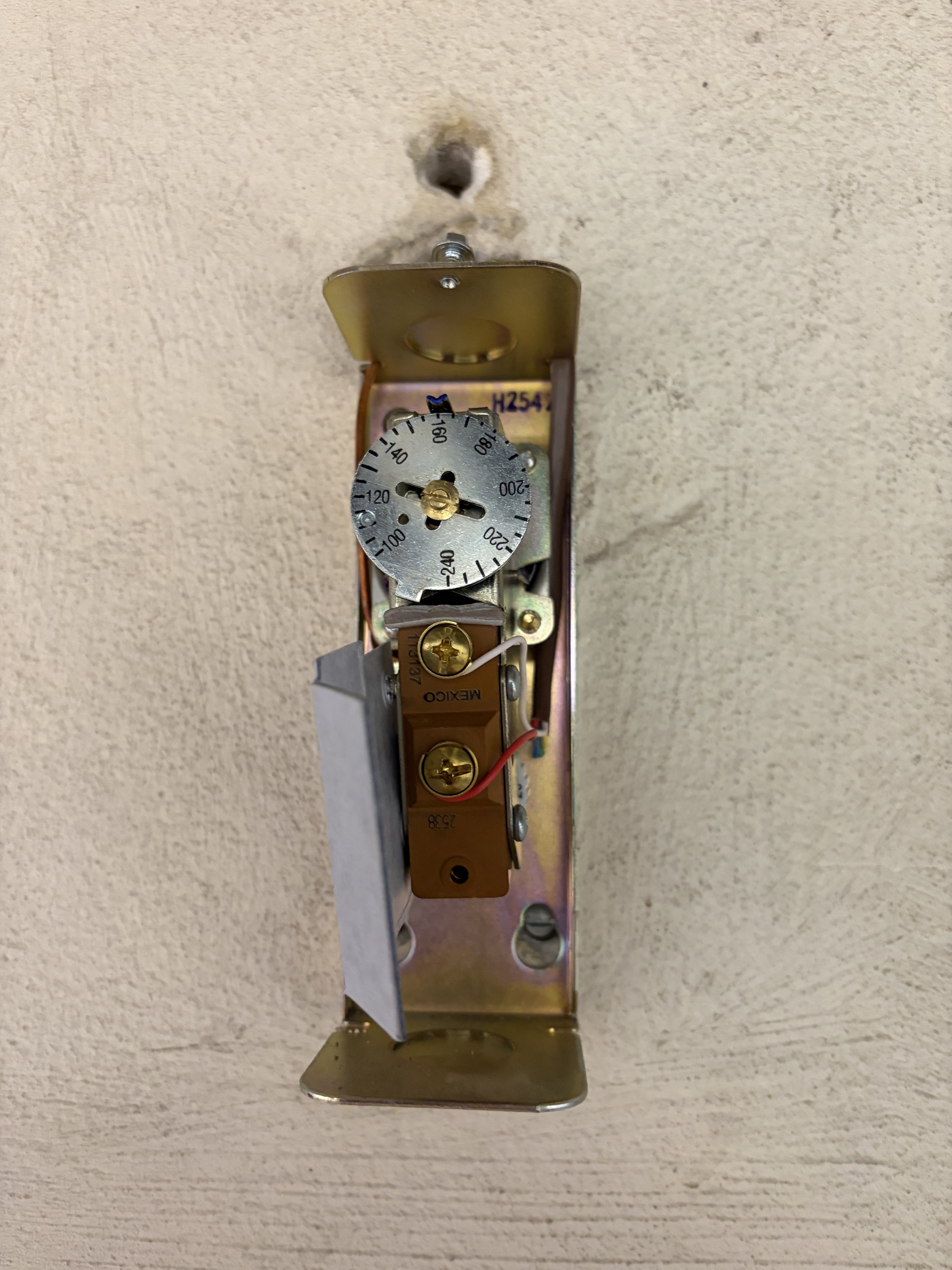

    EdTheHeaterMan Posts: 13,030

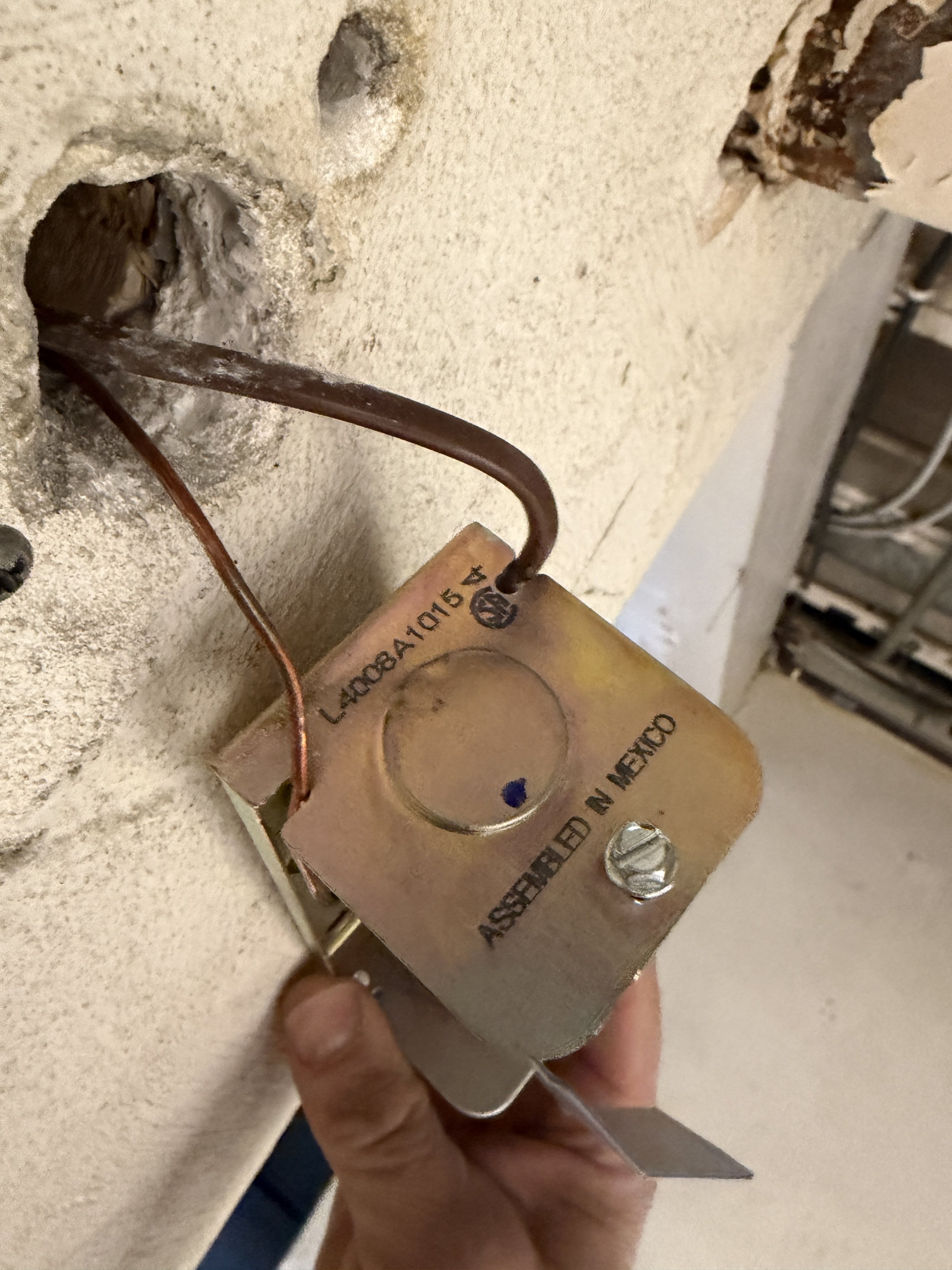

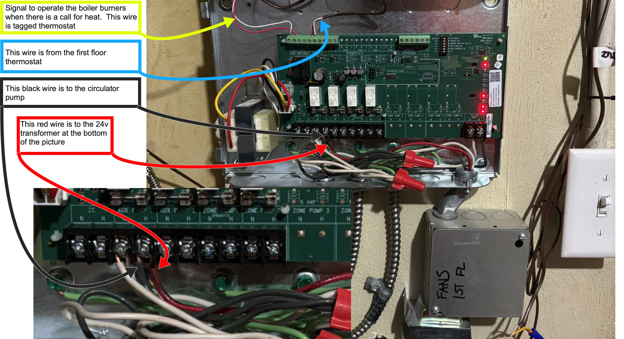

    This photo is a picture of a Reverse Aquastat also known as a B aquastat. It appears to be new by the date code in the red box H2542. That indicates the 42nd week of 2025. So sometime in October that control was manufactured.
    On the other side of the metal chassis (indicated by red arrows) is printed a model number that might be L4006BXXXX (with four numbers after it.). Is there a way to post those numbers so we can look up and know what that control is capable of
    From that photo I can tell you that it is connected by wires to a 24v. control circuit, but I can not tell you what it is connected to. That same metal chassis can be used for other Aquastat controls with very long probes that can measure the temperature from outside the building or from a room that is several feet away or from a pipe that is somewhere behind that wall the control is attached to. The probe might look like this:
    By the dial setting and the wire terminal designation I can tell you that the control pictured will turn on something when the temperature probe is at or above 160° and that the control will turn off that device when the temperature is at or below 155° if the control has a fixed differential of 5°. If you are expecting that control to turn on a boiler when the boilere temperature is below 160°, You selected the incorrect control.

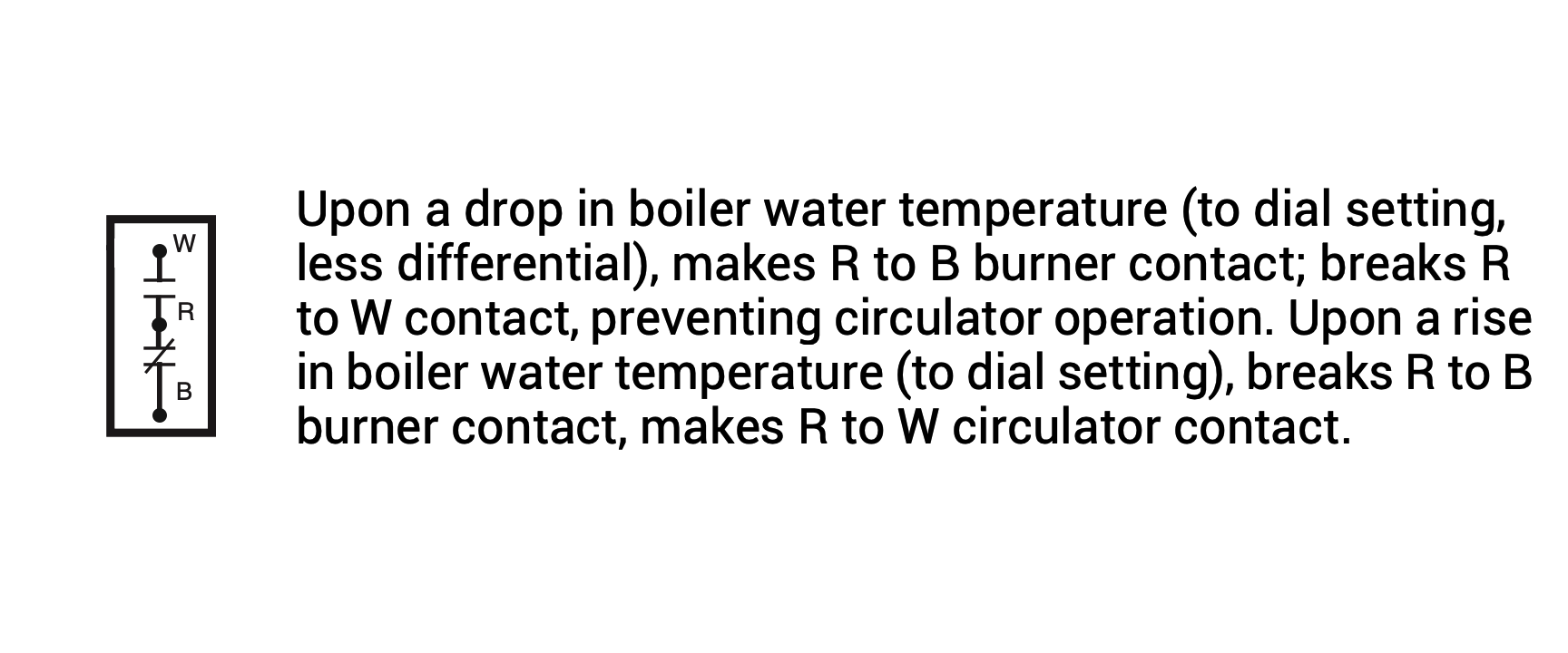

    Here is the terminal designation of the L4006 and L6006 controls. W at the top R in the middle and B at the bottom.

    ok the "B" aquastat (pictured) is mounted outside the mechanical room with the temp probe passing through the wall and connected to the hot water supply pipe.
    edited February 25
    OK that control os a operation control that will power on a control if the temperature at the probe is lower than the set point of the dial. That means that you should be able to use that to turn on a burner the burner should stop when the temperature exceeds the 160° set point and then the burner should start once the temperature drops to 155° if the differentia is set to 5°. That control has an adjustable differential from 5° to 30°
    To determine what is going wrong, can you show me where the other end of the red and white wire on that control are connected to?

    if you scroll up you can see the photo i posted where the stat wires are labeled. "stat" being the thermostat and "Aqual L" being the low limit. that photo shows the high limit aquastat mounted behind the access panel on the boiler.

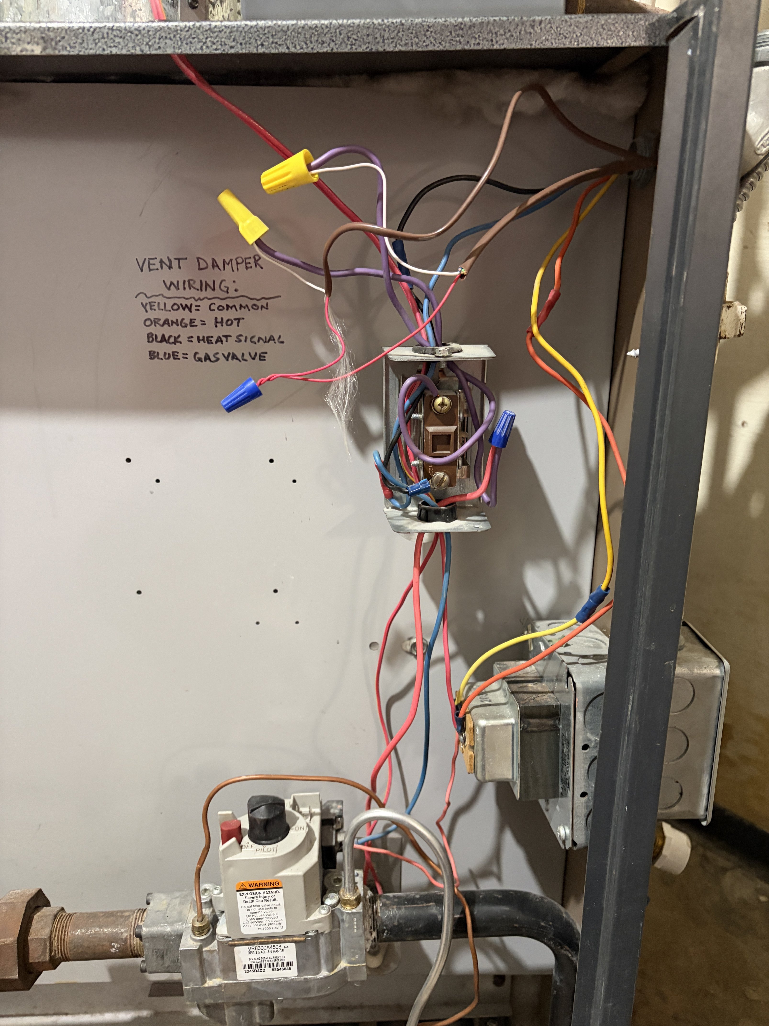

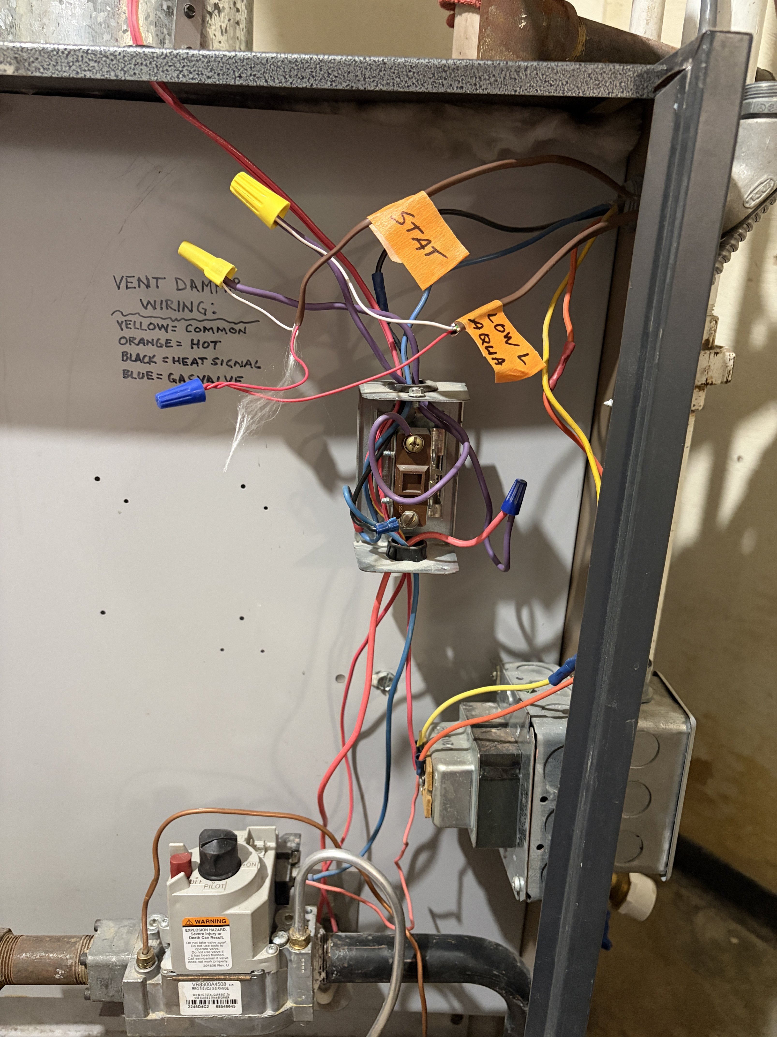

    HVACNUT Posts: 7,815
    What does it say on the inside of the cover? There's only 2 terminals, so its SPST. If it says "R-B opens on temperature rise" then you've got another High (A) Limit. You need a B Limit. An L6008B might work. You could also get an L6006C strap on if its feasible.

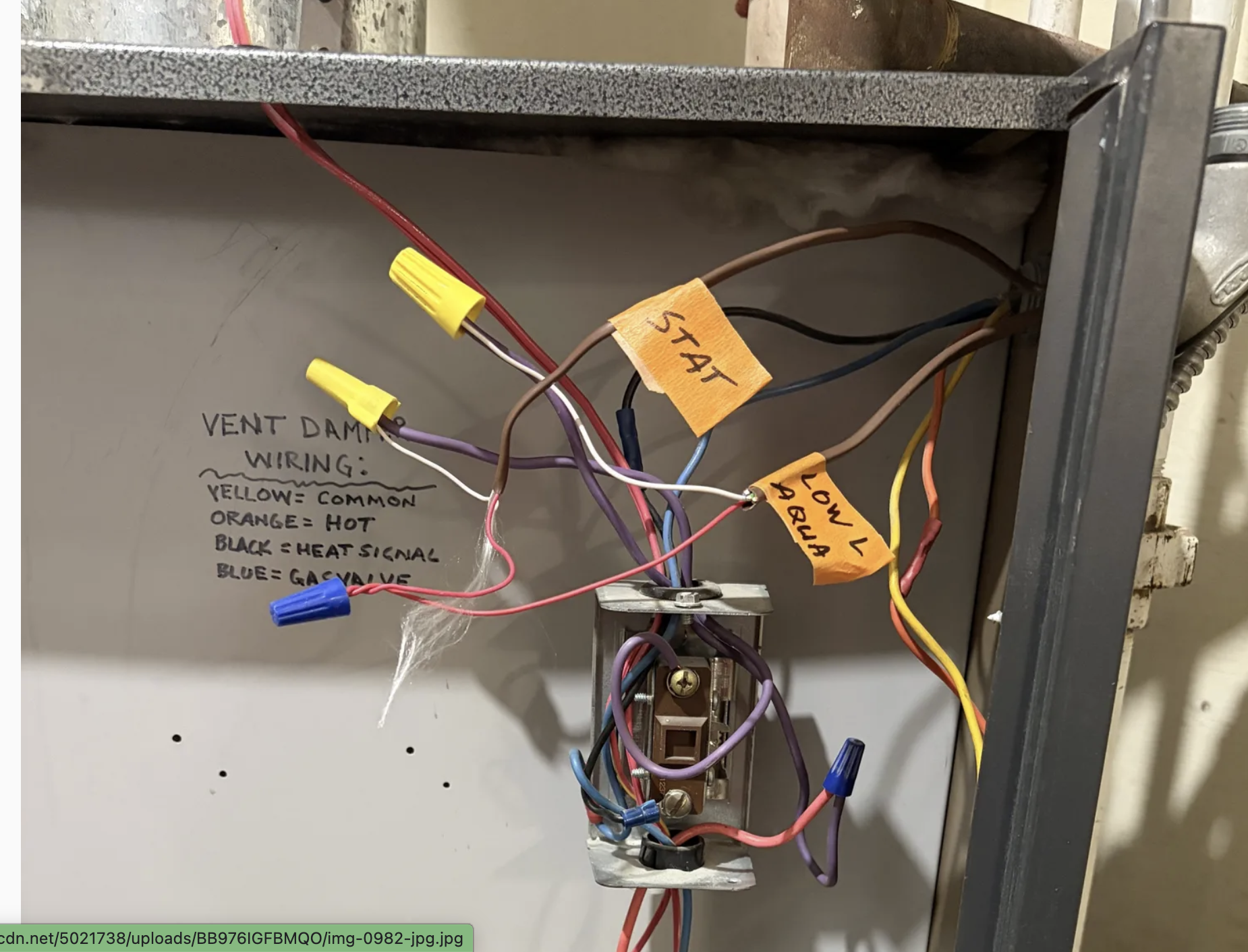

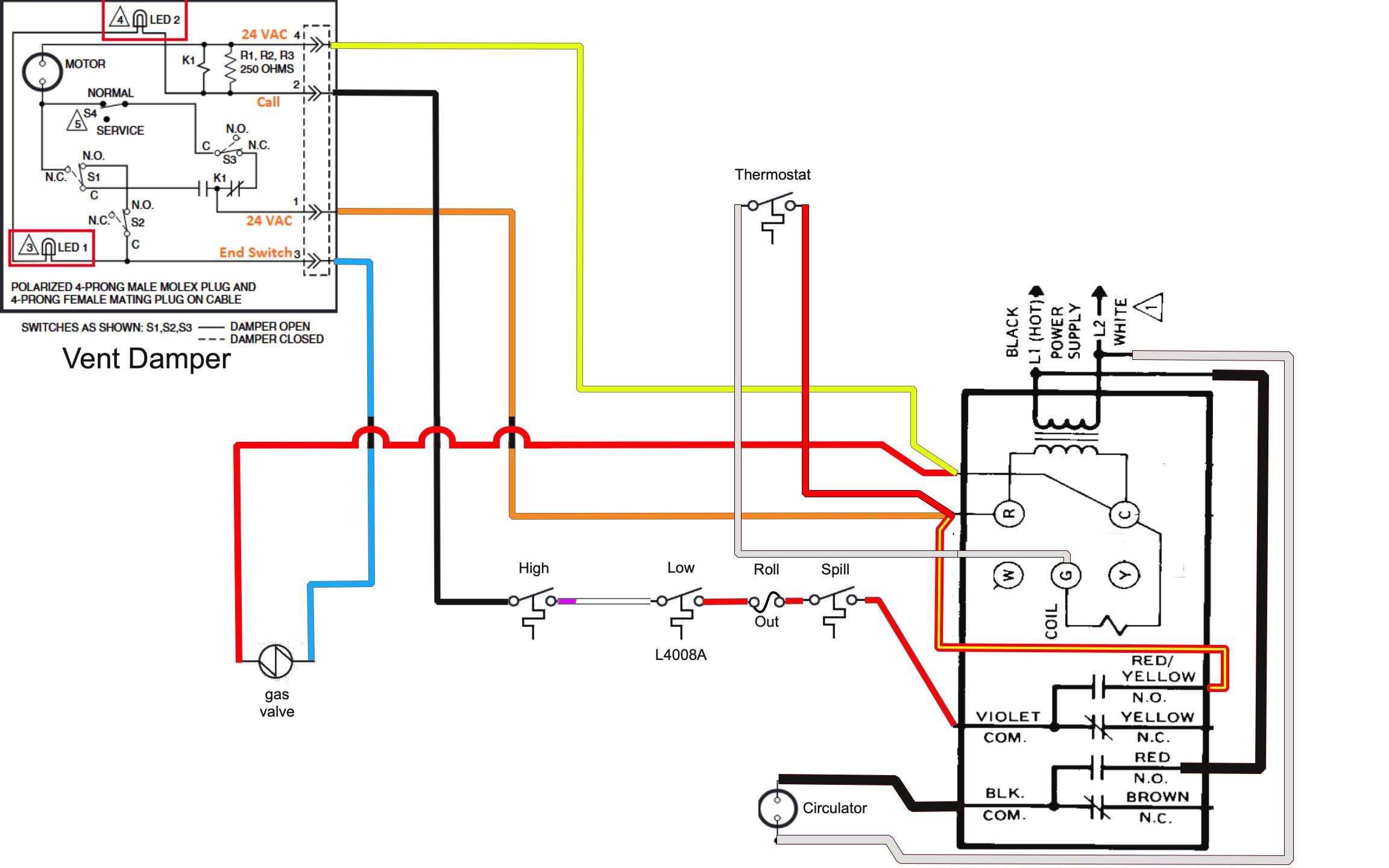

    This is your wiring diagram to the best I can see from the pictures:
    There is no control that will operate a circulator. So I guess that is constant operation.   The operator or low limit, the high limit, all the other safety switches,  and the thermostat need to be closed (turned on) for the vent damper to operate.   Any one of them opening will keep the vent damper closed.   Once the vent damper is open and the end switch inside the vent damper closes to indicate the damper is open, then the gas valve will get power to operate the burner.

    You've got 2 High limit controls.

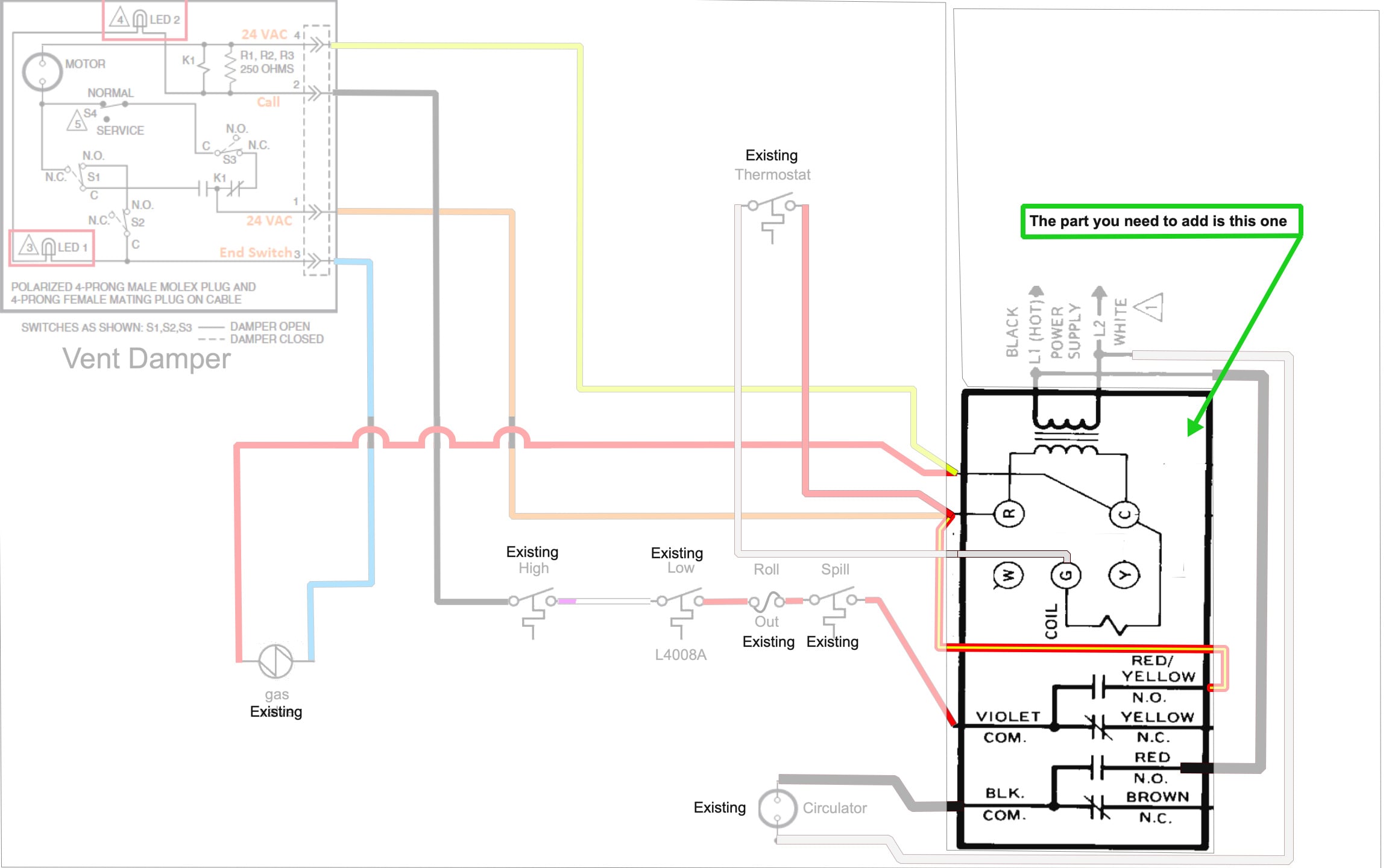

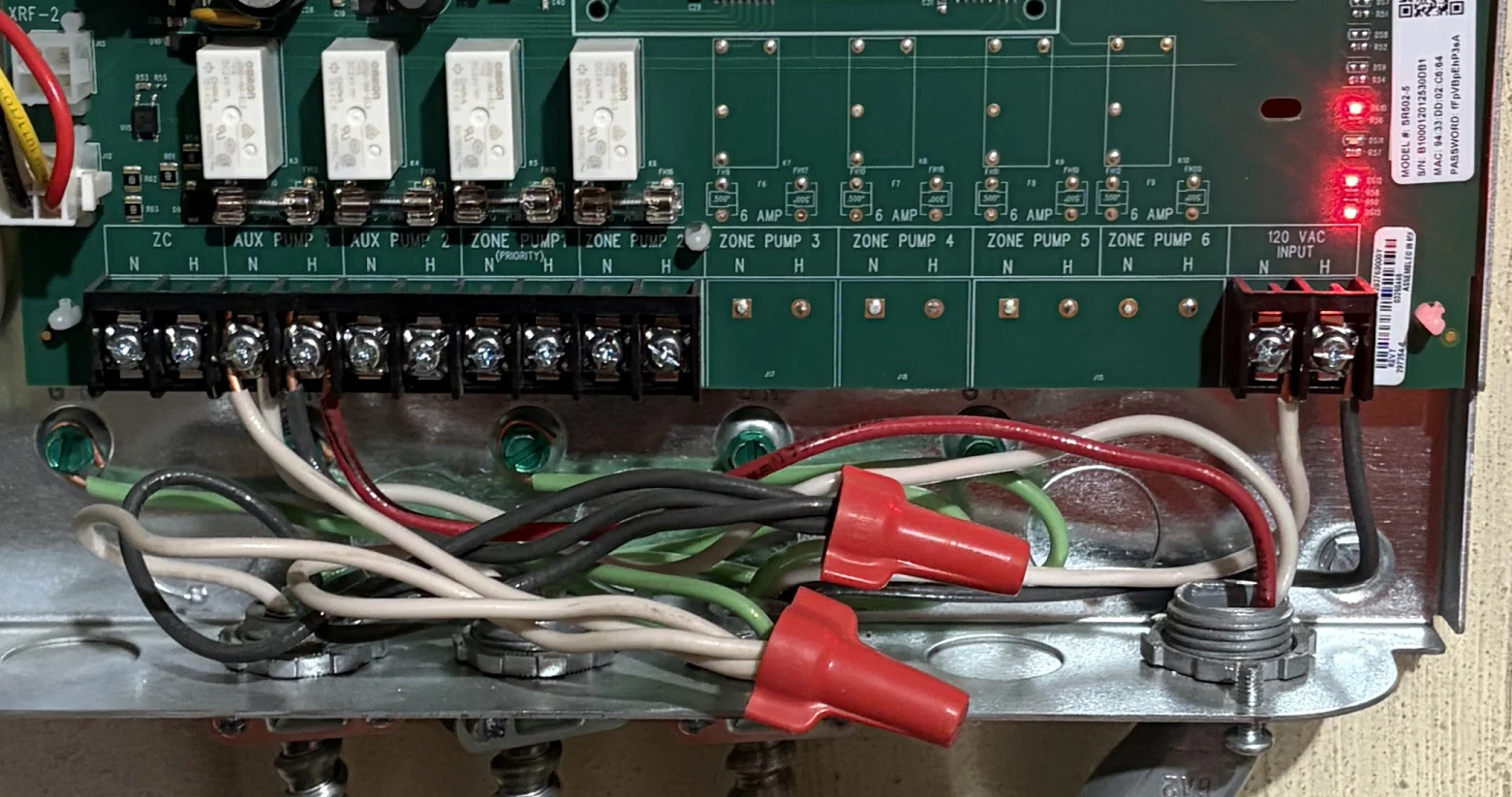

    This is the diagram that will get you operating the circulator with the thermostat.

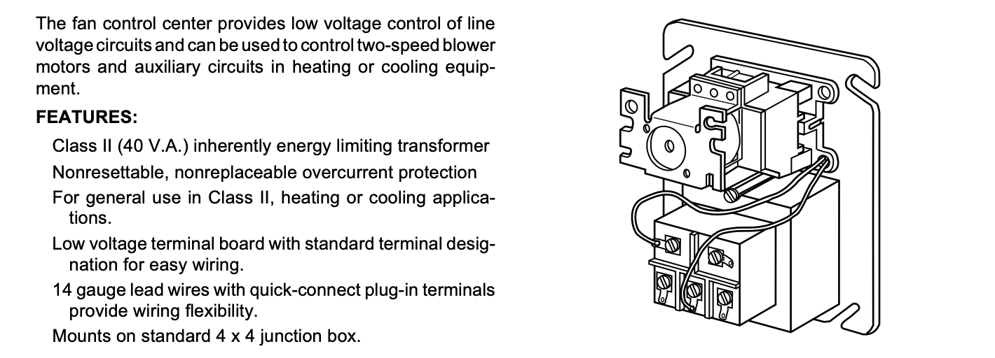

    This is the same diagram as before with a General Purpose relay added. WR 90-130 Fan Center is a little less expensive than the Honeywell in the diagram and the wire colors may be different, but the diagram is identical.
    First: Turn off power
    There are 2 sets of relay contacts including a transformer on the same electric box plate, so you can remove the existing transformer and replace it with the new combination transformer/relay. The C terminal and the R terminal will stay the same. Just take all the wires from the C and put them back on the C and take all the wires off of the R and place them back on the R. Then connect the Black and White 120 VAC wires in the same way, and you should have exactly the same set up. Test that this works for you as it did with the old transformer and verify that the system operates the same as it did before.
    Now turn off the power again and remove the thermostat from the system and just put the wires from the wires from the Low limit and the High limit that are left behind and connect them together.
    Connect the R wire from the thermostat to the R on the transformer
    Connect the W from the thermostat to the G on the transformer. Now when the thermostat calls for heat the relay will pull in and close the relay switch contacts closed (turned on). See how that completes a circuit from R on the transformer to R on the thermostat to W on the thermostat the G on the transformer to the Relay coil on the transformer to C on the transformer to make a complete circuit?
    Remove the R wire from the transformer that goes to the spill switch should be connected to the violet wire on the relay and the red/yel wire on the relay should be connected to R on the transformer.
    Once you have all those wires connected you can take the 120 v. Black wire from the circulator motor and connect it to the Black wire on the relay. Take the Red wire on the relay and connect it to the place you removed the black wire of the circulator from.
    That should complete the rewiring.
    Power up and test. Make sure all the limits stop the burner when there is a call for heat. You don't want to have the flame continue to burn if there is a problem with flue gas spilling, or the water getting too hot.
    If this sounds too involved, then get a professional to do this for you.

    109A_5 Posts: 4,790
    edited February 26

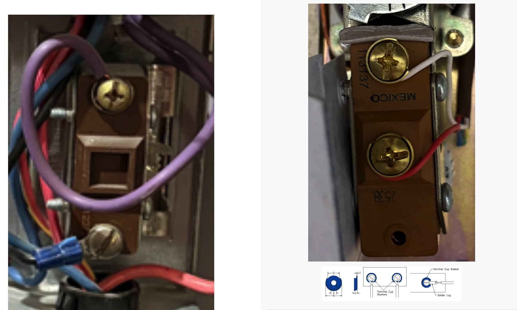

    I'm going to ask what I hope is a really stupid question.
    Did they strip the insulation off the copper wire before putting the wire under the screws and the washers ???
    Even if they are stripped, they are installed wrong. The bare copper wire should be between the screw head and the cupped washer with the wire exiting the cup through the edge part of the cup that is cut away. Not placed underneath the washer.

    The L4008A1015 is a good aquastat for this system and the aquastat that is connected inside the boiler is also a good one to use. Both are acceptable. In this diagram you see that all of the parts in the siring diagram are already existing, therefore you do not need to purchase any different "aquastats" for your boiler.
    And that should answer your question as you asked it.
    However I believe that you are asking what new control you need to purchase?
    That has a different answer: the control is a White Rodgers 90-130 Fan Center that I linked in my previous post and I will also link it here:  WR 90-130 Fan Center. That is the control that has a transformer and a relay in one box that is attached to a plate that will cover that same electric box your existing transformer is covering now.
    That should be enough information to get the job done. If you are still having questions then I STRONGLY recommend that a professional do this work for you.

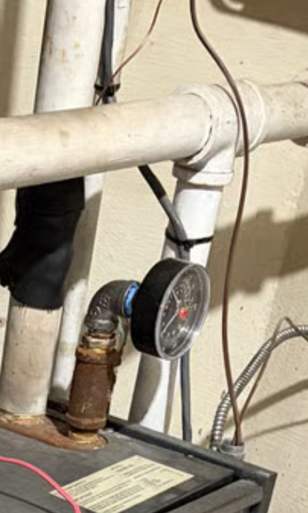

    ok I checked the temp on my hot water supply pipe and it does match the brand new thermometer. I am still curious why my boiler will not heat up to the 180 on the high limit aquastat, and why the low limit is not being maintained. today I recorded 110 degrees where the probe is strapped to and i have the low limit aquastat set to 220 (which i know is way too high). Is this something the updated wiring youve provided will correct? also would a different low level aquastat with 3 terminals instead of 2 allow the circulator to not run on low level call for heat? perhaps the correct model designed for the probe to be strapped rather than immersed? I can probable return and get the correct aquastat.

    " THE BOILER ONLY FIRES WHEN THE THERMOSTAT CALLS FOR HEAT, NEVER WHEN LOW LEVEL TEMP DIPS BELOW DESIRED TEMP. "
    Well the way the wiring looks with the Low limit in series with the thermostat the low limit does not have the ability to call for heat independently. So the low limit and the thermostat both have to be calling for heat to start the burner.
    If the low limit is for a warm start boiler (for Domestic Hot Water (DHW)) the Low limit and the thermostat would have to be in wired effectively parallel not in series. So a call for heat from either will start the boiler. And the circulator would probably run in both cases. The information you provided is too limited. If not for DHW why do you want a warm start boiler ?

    @ericthor said: "ok I checked the temp on my hot water supply pipe and it does match the brand new thermometer."
    This statement is ambiguous and needs clarification.
    What pipe and what thermometer? How was it "checked". Describe the procedure and what "Known Good" device was the test instrument?
    What were the test results? What temperature was the pipe and what temperature did the new thermometer say the pipe was? The numbers please.

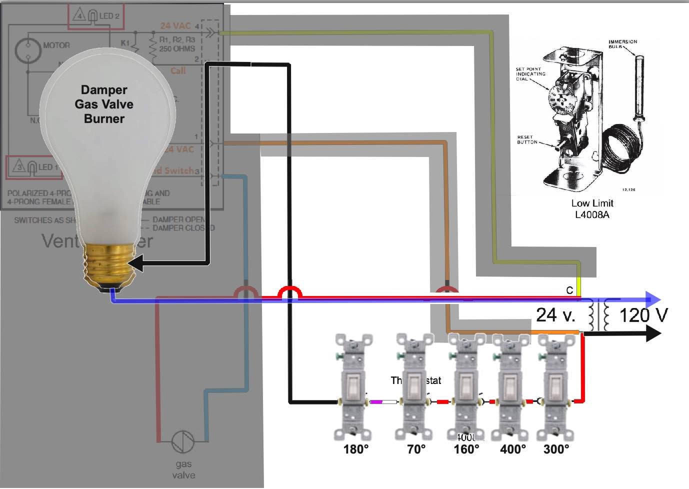

    Here is an illustration you may be able to see a little more clear. the light bulb represents the vent damper , gas valve and the flame in the burner. all that stuff is covered over with Gray.
    All the limits, aquastats and safety devices are represented by light switches connected to 120 v. (like a wall outlet).
    That first switch is a safety that will open if the temperature of the exhaust gasses over 300° reaches that switch. You are not asking for the flue gasses to get to 300° by putting that switch there. In fact You DO NOT want the gasses to get to 300°. But if that happens it would be better to have no heat than to let exhaust gasses into your home. But it is there set at 300°
    Next is the roll out safety fuse that is set at 400°. You are not asking for the flue gasses to get to 400° by putting that switch there. In fact You DO NOT want the gasses to get to 400°. But if that happens it would be better to have no heat than to let exhaust gasses into your home. But it is there set at 400°
    the next is the L4008A limit control set at 160°. You are not asking for the water temperature to get to 160° by putting that switch there. In fact You DO NOT want the water temperature to get above 160°. But if that happens it would be better to have the burner stop and get free heat into your home without using any more gas. But it is there set at 160°
    The next one is the room thermostat set at 70°. You are asking for the water temperature from the boiler to get to the radiators by putting that switch there. In fact You DO want the water temperature to getthere to heat the rooms. But if the temperature goes above 70° it would be a good idea to have the burner stop and not burn any more gas that would cause the room to over heat. So it is there set at 70°
    The next one is the boiler limit control set at 180°. You are not asking for the water temperature to get to 180° by putting that switch there. In fact You DO NOT want the water temperature to get above 180°. But if that happens it would be better to have the burner stop and get free heat into your home without using any more gas. But it is there set at 180°
    Be careful what you ask for. You may not want the results.

    I am using a Klein Tools IR5 Dual Laser Infrared Thermometer. I checked the temp on the hot water supply pipe that the prope is attached to. the temp read 110 on both the tool and the new thermometer/prerssure gauge.

    " ok I checked the temp on my hot water supply pipe and it does match the brand new thermometer. I am still curious why my boiler will not heat up to the 180 on the high limit aquastat, and why the low limit is not being maintained. "
    These are two easy questions to answer;
    Because you connected the Low limit up incorrectly (it is in series with the other limits including the thermostat), so it limits the boiler to 160 degrees or whatever you set the Low limit to.
    AND
    Because you connected the Low limit up incorrectly (it is in series with the other limits including the thermostat), so it limits the boiler to 160 degrees or whatever you set it to.
    The Low limit need to be in Parallel with the thermostat NOT in series. So each device, the Low limit (160 degrees) OR the thermostat (for the desired room temperature) can call for heat independently.
    The way it is wired in the picture above BOTH the Low limit AND the thermostat have to call for heat to fire the Boiler's burner. Once either is satisfied the burner shuts off regardless of what the other one wants.
    109A_5 Posts: 4,790
    edited February 27
    Low limit and the Thermostat connected in parallel.

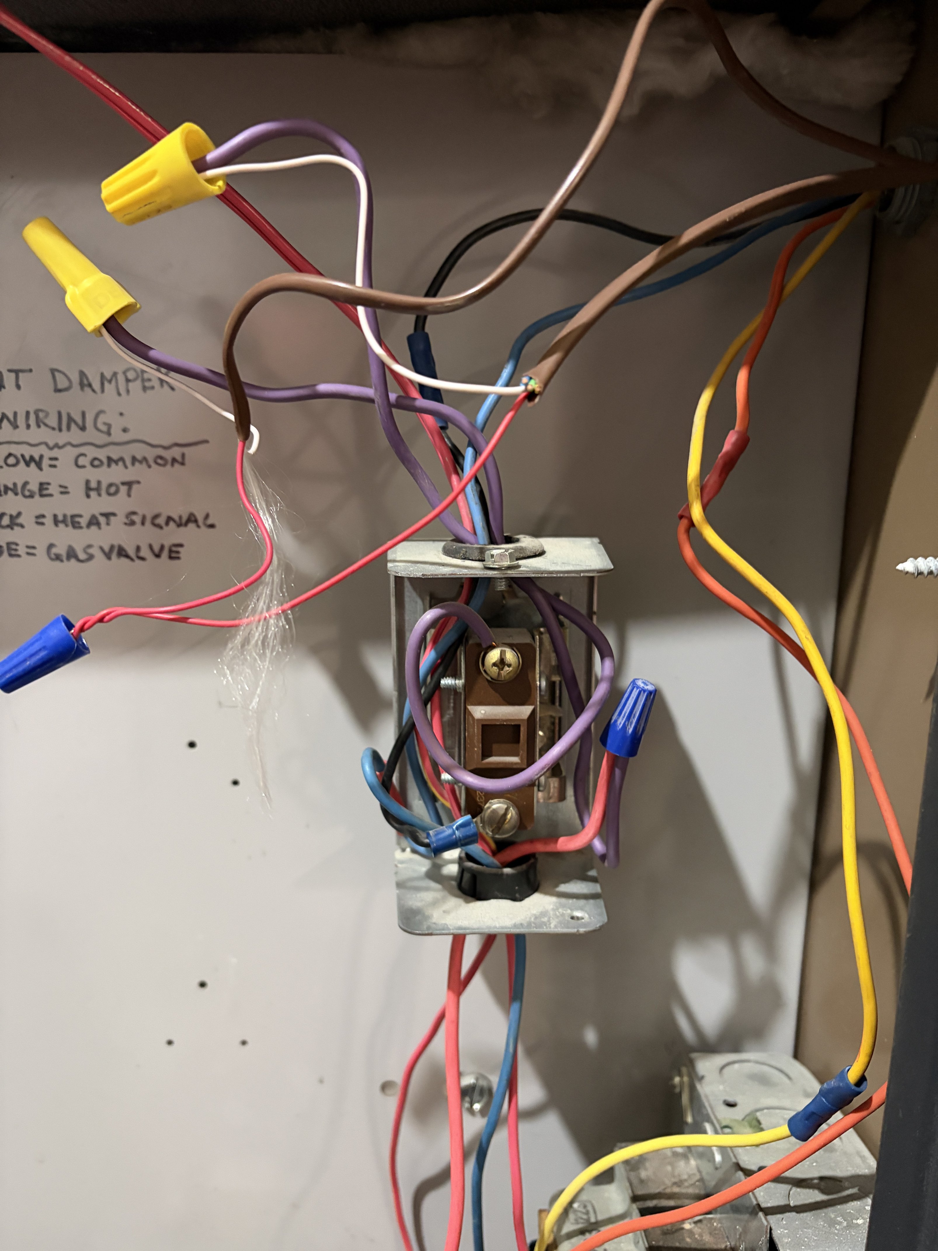

  • ericthor
    ericthor Posts: 28
    THIS FIXED IT! Even the circulator doesn't kick on when low limit calls for heat.
    109A_5 Posts: 4,790
    I'm glad it works as you want.
    I think there must be more to the overall story. I would think with either call Thermostat or Low limit the circulator would run. Since it does not, which is probably good in this case, I suspect there may be additional control for the circulator between the actual thermostat and the thermostat wires pictured above.
  • ericthor
    ericthor Posts: 28
    when the thermostat stops calling for heat and the circ pumps shut off, should it continue to heat until it hits the low limit setting of 160? mine is shutting down at 140, which is where the 20 degree differential is set at.
