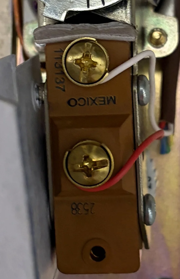

    EdTheHeaterMan Member Posts: 11,998
    This photo is a picture of a Reverse Aquastat also known as a B aquastat. It appears to be new by the date code in the red box H2542. That indicates the 42nd week of 2025. So sometime in October that control was manufactured.
    On the other side of the metal chassis (indicated by red arrows) is printed a model number that might be L4006BXXXX (with four numbers after it.). Is there a way to post those numbers so we can look up and know what that control is capable of
    From that photo I can tell you that it is connected by wires to a 24v. control circuit, but I can not tell you what it is connected to. That same metal chassis can be used for other Aquastat controls with very long probes that can measure the temperature from outside the building or from a room that is several feet away or from a pipe that is somewhere behind that wall the control is attached to. The probe might look like this:
    By the dial setting and the wire terminal designation I can tell you that the control pictured will turn on something when the temperature probe is at or above 160° and that the control will turn off that device when the temperature is at or below 155° if the control has a fixed differential of 5°. If you are expecting that control to turn on a boiler when the boilere temperature is below 160°, You selected the incorrect control.
    Here is the terminal designation of the L4006 and L6006 controls. W at the top R in the middle and B at the bottom.

    ok the "B" aquastat (pictured) is mounted outside the mechanical room with the temp probe passing through the wall and connected to the hot water supply pipe.
    edited February 25
    OK that control os a operation control that will power on a control if the temperature at the probe is lower than the set point of the dial. That means that you should be able to use that to turn on a burner the burner should stop when the temperature exceeds the 160° set point and then the burner should start once the temperature drops to 155° if the differentia is set to 5°. That control has an adjustable differential from 5° to 30°
    To determine what is going wrong, can you show me where the other end of the red and white wire on that control are connected to?

    HVACNUT Member Posts: 7,393
    What does it say on the inside of the cover? There's only 2 terminals, so its SPST. If it says "R-B opens on temperature rise" then you've got another High (A) Limit. You need a B Limit. An L6008B might work. You could also get an L6006C strap on if its feasible.

    There is no control that will operate a circulator. So I guess that is constant operation.   The operator or low limit, the high limit, all the other safety switches,  and the thermostat need to be closed (turned on) for the vent damper to operate.   Any one of them opening will keep the vent damper closed.   Once the vent damper is open and the end switch inside the vent damper closes to indicate the damper is open, then the gas valve will get power to operate the burner.
    You've got 2 High limit controls.

    I can feel the current low level aquastat click when i move the dial and it hits what it thinks the boiler temp is at. it also clicks accordingly to how i set the variation dial. currently the low level was set to 160 and the temp gauge was showing 120. I increased the low level up to 200 and the flame kicks on heating the boiler temp to 145-150 then shuts off.
    I believe that is proper usage of that L4008A to be an operator. So you have an operator and a high limit. That is no problem. (Yes @HVACNUT he has 2 high limits).
    There is no better Aquastat control for operating the circulator. If you don't want to have your circulator operate all the time, then you need a circulator relay. Are there any other controls that you have not posted a picture?

    EBEBRATT-Ed Member Posts: 20,063
    if you are using the Honeywell control to start the circulator it will not work for that. The control you have is a L4008A is a direct acting high limit. It opens the circuit on a temp rise.
    You need a reverse acting control that closes the circuit on a temp rise if you are controlling the circulator with it as @HVACNUT said

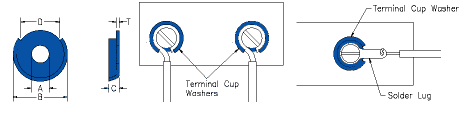

    109A_5 Member Posts: 3,839
    edited 4:56AM
    I'm going to ask what I hope is a really stupid question.
    Did they strip the insulation off the copper wire before putting the wire under the screws and the washers ???
    Even if they are stripped, they are installed wrong. The bare copper wire should be between the screw head and the cupped washer with the wire exiting the cup through the edge part of the cup that is cut away. Not placed underneath the washer.
