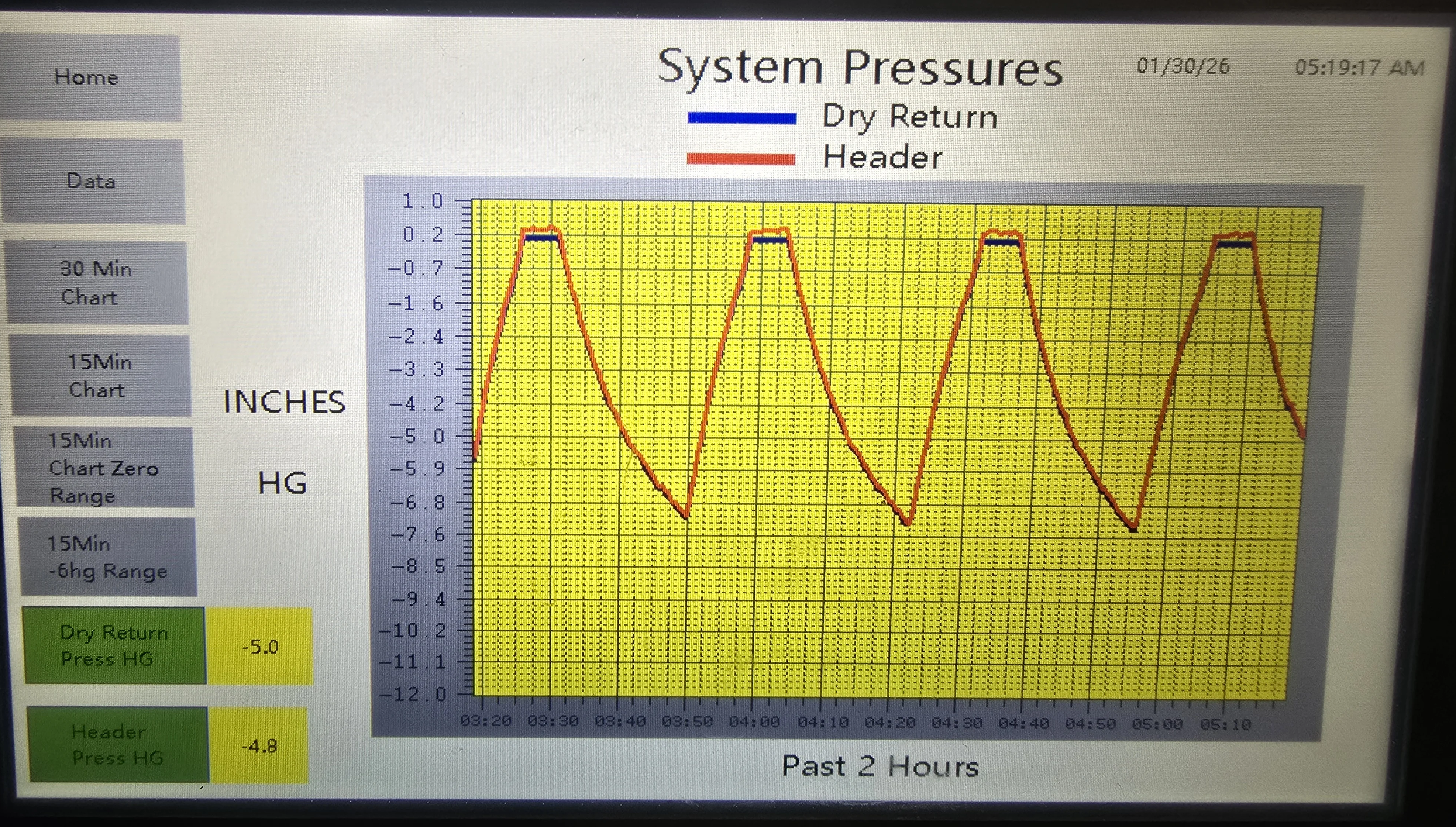

    109A_5 Member Posts: 3,851
    With system pressures like @PMJ documented, the boiler iron and all the water in the boiler has to drop below 200 degrees Fahrenheit before the steam flow stops completely and the steam flow starts at a lower temperature than your typical boilers. So I can see the radiators maintaining a more uniform temperature enhancing comfort. I'd like to see this graph with the boiler water temperature also. Maybe with this cycle rate shown it never truly stops steaming.

    @ethicalpaul Look ^^^ at how the pressure at the end of the dry return is lower than the pressure at the header. It looks like it is "measurable" doesn't it?
    One division on that chart is 0.8/5 = 0.16 in. Hg = 2.2 in. H2O
    @PMJ If you have the capability, it would be very interesting to see a radiator temperature overlayed on the above chart.
    Also, where is the cursor located in that chart where Header press. = -4.8 in. Hg and Dry Return press. = -5.0 in. Hg.? Obviously steam was still flowing or else there wouldn't be that pressure drop.
  • PMJ
    PMJ Member Posts: 1,319
    Finally someone is giving this chart some real thought. When new burns start you can see that even 18 minutes after the boiler has been off steam is still condensing and dropping the pressure at a rate not so different than it was when the boiler first went off. So there is still significant steam coming from somewhere. Where is it condensing? Mostly in the radiators. Yes it is increasingly less dense steam and yes the latent heat it is giving up is less, but not that much. Besides, what this really needs to be compared to is if those 18 minutes were spent filling the radiators (and mains) with air instead. The result isn't close.

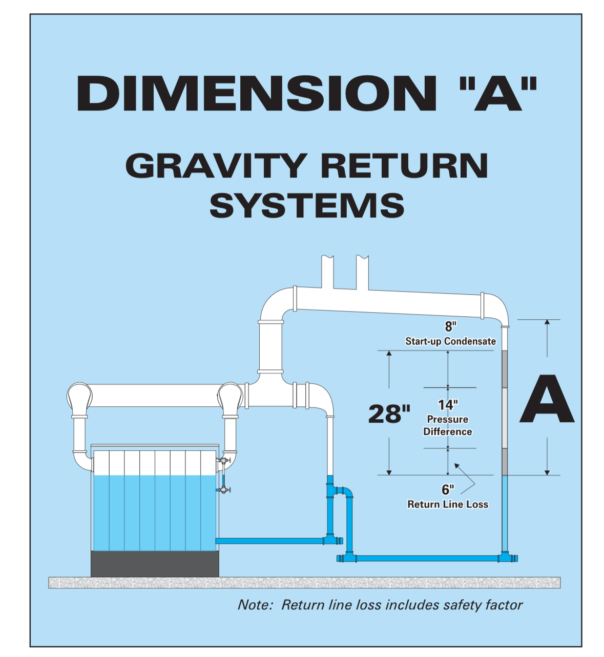

    ethicalpaul Member Posts: 8,630
    His is a very large two pipe system that has a lot in it that I’m not familiar with. I can’t remember if he has a crossover trap or what he has between his main and wet return. I was speaking of one pipe when I correctly said that Dimension A is a myth.
    His transducers have an accuracy tolerance of +-.5% which across their large range is 0.447 psi
    But if you’re willing to admit that Dimension A should be 2” instead of 28” I’ll allow it. I would then say it’s “measurable but insignificant” and not worthy of consideration or concern.
    When I’m trying to help people I try to keep things relevant and simple rather than overwhelm them with terms and values that have no effect on their systems or lives.
    This grossly inaccurate chart that you have posted from the folks at Peerless whose work I respect and admire, makes professionals and homeowners have to worry about something that isn’t a concern:
    And I don’t care if the guy who drew it is dead, and I don’t use appeals to authority to try to determine the facts.
  • PMJ
    Seems to me pretty obvious that if there is flow there is pressure drop so there is an A dimension. It is also clear that it is quite small. My transducers confirm this, though I have never felt the need to increase the resolution to see it more precisely, or even spend lots of time on calibration. The reading is very close to the dial vacuum gage on the header and I did switch the transducers once to see if the difference remained the same which it did. But then I already knew the pressure in the dry return remains lower always just by feeling radiator feed pipes.
    But while the subject is up, the more important thing about pressure differences is actually the unmeasurable ones radiator to radiator due to sun, wind etc. which causes different condensation rates on different sides of the house and upstairs vs downstairs. An amazing amount of balancing occurs because of this that again does not if you fill with air. I admit, I would have said the improvement I have seen in balance was not possible until I experienced it myself.

  • Captain Who
    Captain Who Member Posts: 779
    Not to muck up the thread ethicalpaul but the pressure drop in single pipe steam in the main is greater than two pipe steam because of the extra condensate load. You have a teeny boiler at 56MBH steam. Peerless recommends a super generous A dimension of 14 in. in single pipe steam for less than 100MBH. You are neglecting the stack up required for the condensate to get back to the boiler for overcoming the friction effects in the wet return piping as well.
    Their chart is a little discombobulated I admit but between the two columns an understanding can be arrived at.
