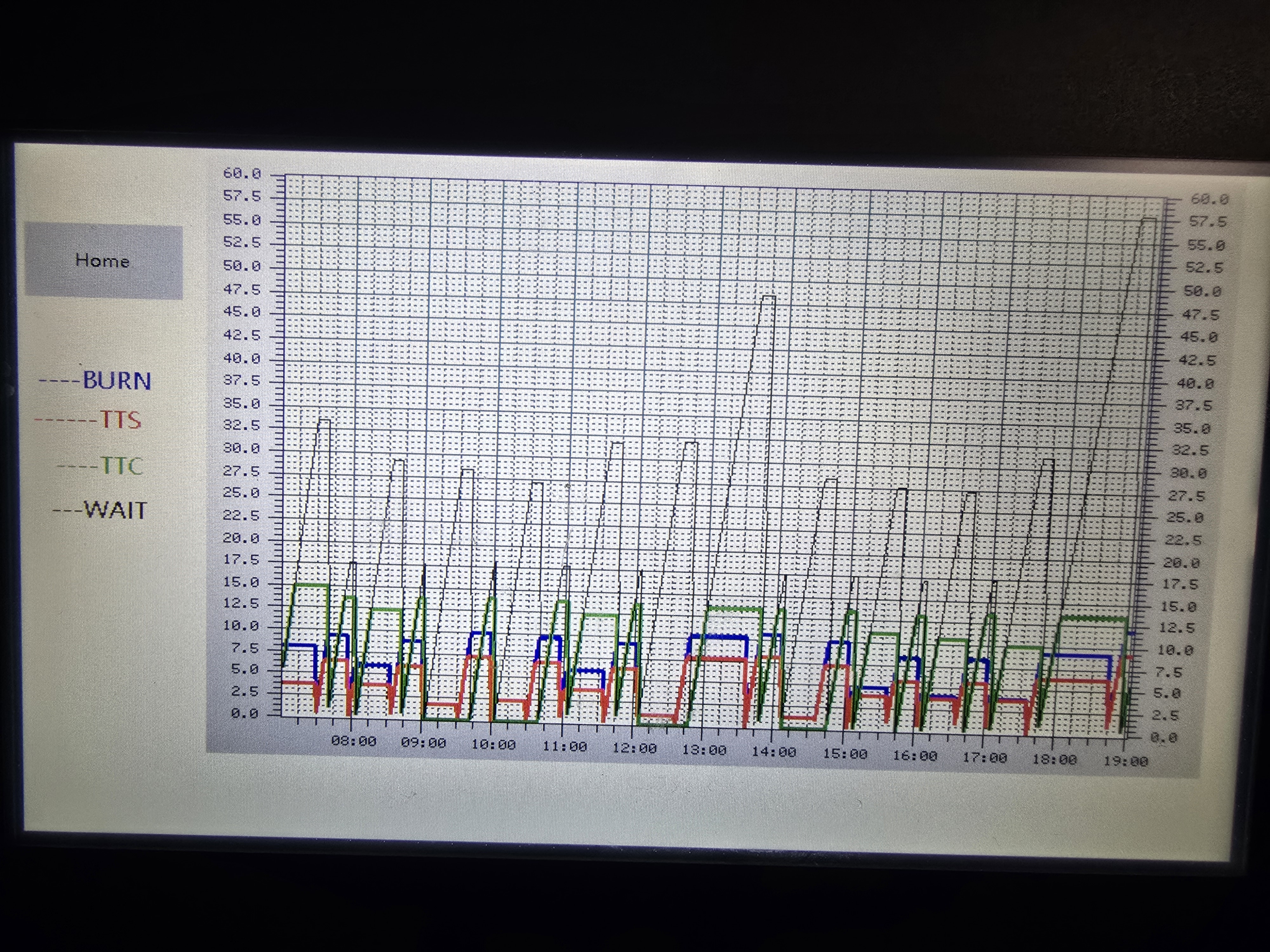

  • PMJ
    PMJ Posts: 1,325
    Attached is a 12 hour plot from 2-8-26 when the outside temperature was in the low single digits.
    There is a lot of information here about how my system works. It takes some getting used to but anyone interested please give it a study and a chance. Sorry about the quality.
    Red trace is TTS(time to steam at the remote feed pipe from fire), Blue is total burn time, Green is the time to cool - that is how long it took for the remote heat sensor to open again after the fire went out, the thin black trace is the total burner off time wait.
    The red and blue traces start at zero together. Their times end when they go flat at the top. The green and black traces start together when the blue burn ends(first goes flat).
    I have circled the 6 times that the call was satisfied and marked a time estimate of how long it was satisfied. The system was calling for heat 88.5% of the time. The longest call satisfaction was about 20 minutes. The heat is the most even when the call % time is high and the satisfied % low.
    The time from fire to new steam arriving at my most remote radiator is just over 3.5 minutes except when there was a longer off time wait for a call satisfaction when it is 5-7.5 minutes. The boiler was firing 34.5% of the total time.
    Attached also is a plot of system pressures. Not the same day but just to give the idea. Just want everyone to see that vacuum is still increasing rapidly even after the boiler has been off 17 minutes. There is still a lot of steam in the system at that point. Lower temperature steam yes, but still steam obviously since it is condensing and still dropping the pressure. Peak vacuum will generally occur after 90 minutes to 2 hours if the boiler isn't fired.
    More comments to follow.

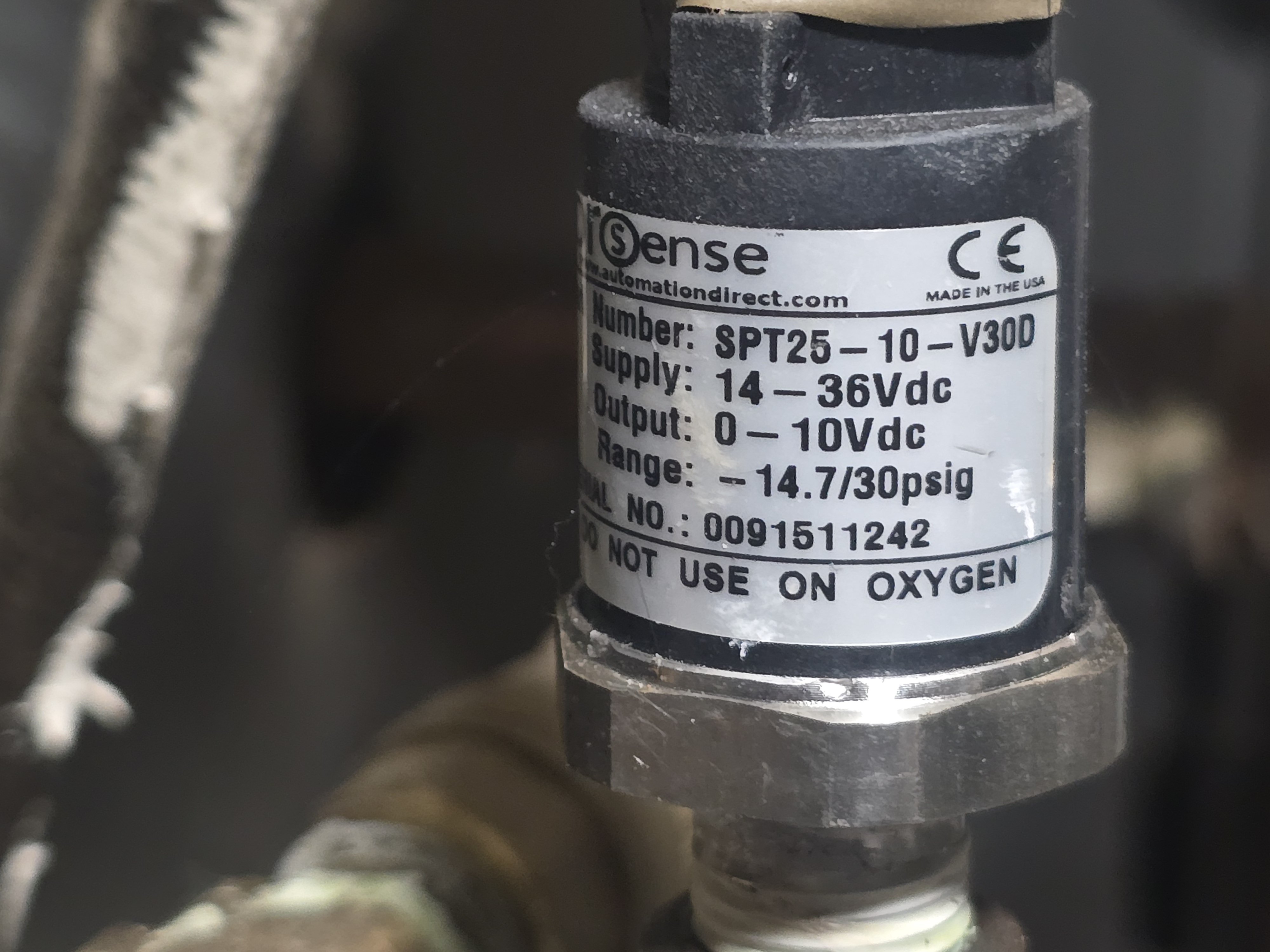

    @PMJ My present curiosity is the compound pressure transducer used to measure the system pressure. Not finding one in the range I would expect for best performance.
    Any custom interfacing to match the pressure transducer's range to the PLC's A to D input range & resolution ?
  • PMJ
    PMJ Posts: 1,325
    I'm using 2 ProSense SPT25-10-V30D. One on the boiler header and one on the dry return. You need to calibrate with gain and offset settings. This is where the PLC platform makes it easy. You need to figure out the equation yourself from 2 points of actual readings to get slope(gain) and offset numbers to put in. This model has a wide range but resolution was good enough for what I needed to see.
    photo attached.

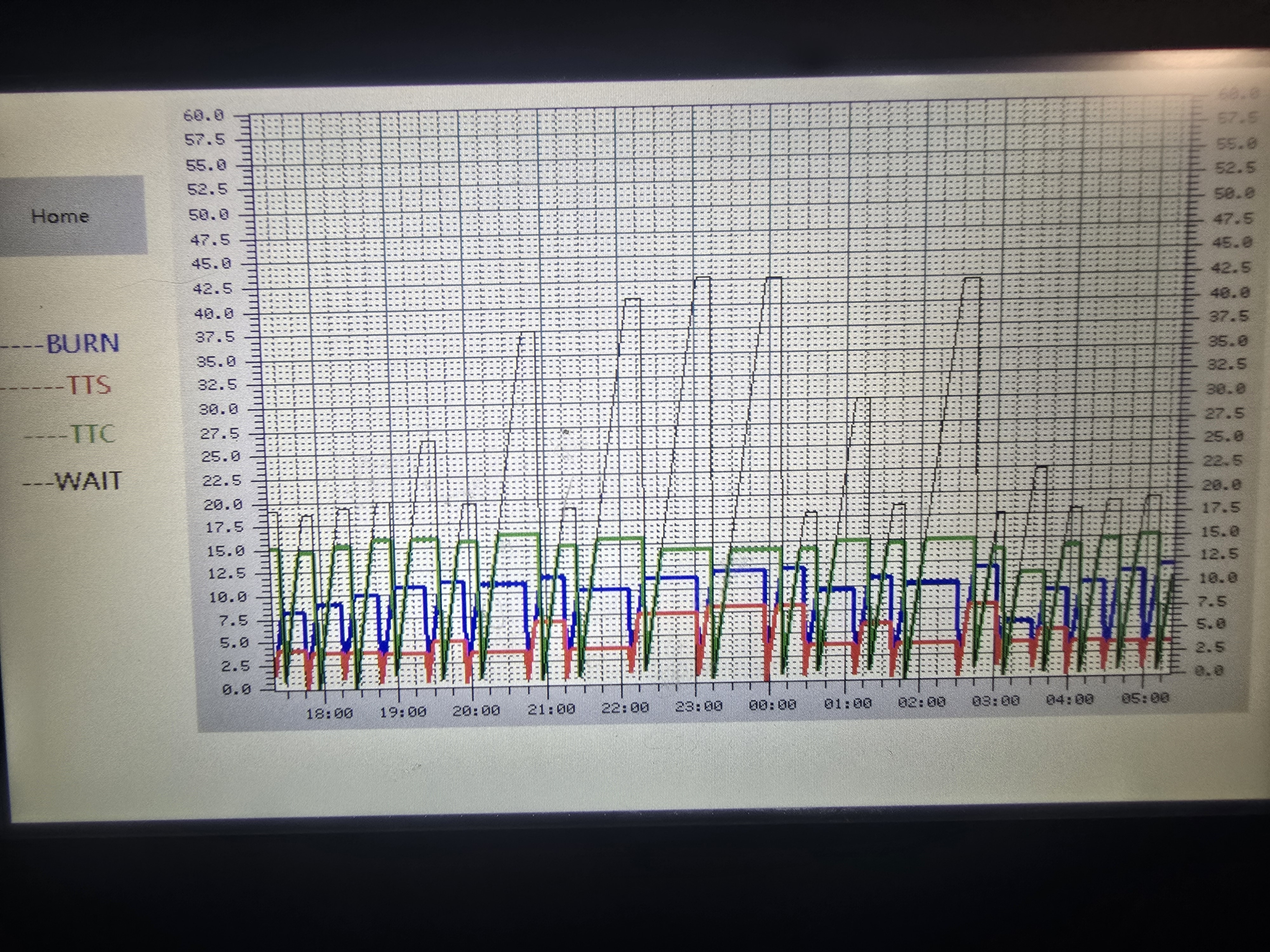

  • PMJ
    PMJ Posts: 1,325
    @ChrisJ , Attached is a chart from today when it was 35 degrees. The call was satisfied 12 times or basically once and hour. The waits of around 30 minutes are when the tstat had been satisfied and for about 15 minutes each time. Following these longer satisfied waits the boiler fired and did a full burn of 8 minutes or so followed by normal 17 minute waits with the call still in progress. Notice then that several times the boiler fired for a second time in the same call but that the call was satisfied very early during the second burn. The red burn line will go flat either when steam reaches the remote radiator or the the burn stops because the call was satisfied. If the burn was only 2.5 minutes no new steam had yet reached the radiators. The reason I am pointing this out is that at those times then the calls were satisfied some 20 minutes after the boiler had been off. That is because in a vacuum system a lot of steam is still in the mains when the boiler goes off and still keeps travelling into the radiators. So all that time the temp in the room is still rising slowly even though the boiler had been off the whole time. This is the same phenomenon that everyone accepts as valid logic as a coal fire burns down but don't accept it when the fire goes out suddenly. Actually the two situations are very much the same. And when you consider it happening many times in a single day I think it adds up to more total benefit than one time per day with a coal fire. The plain fact is that a lot of steam that you already produced actually gets delivered to the radiators that never would be without the vacuum.

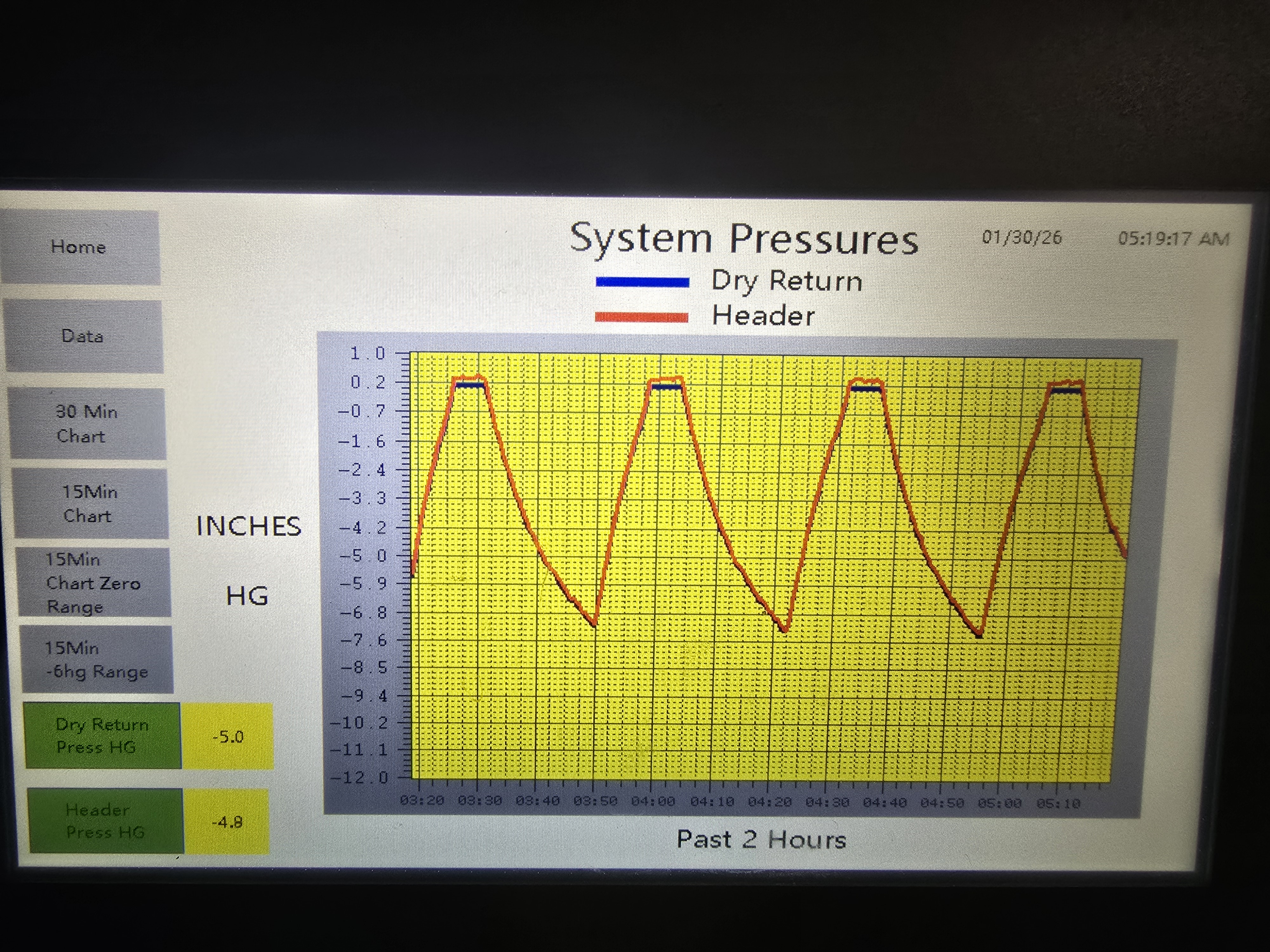

    109A_5 Posts: 4,759
    With system pressures like @PMJ documented, the boiler iron and all the water in the boiler has to drop below 200 degrees Fahrenheit before the steam flow stops completely and the steam flow starts at a lower temperature than your typical boilers. So I can see the radiators maintaining a more uniform temperature enhancing comfort. I'd like to see this graph with the boiler water temperature also. Maybe with this cycle rate shown it never truly stops steaming.
    SteamCoffee
  • Captain Who
    Captain Who Posts: 883
    edited February 25
    @ethicalpaul Look ^^^ at how the pressure at the end of the dry return is lower than the pressure at the header. It looks like it is "measurable" doesn't it?
    One division on that chart is 0.8/5 = 0.16 in. Hg = 2.2 in. H2O
    @PMJ If you have the capability, it would be very interesting to see a radiator temperature overlayed on the above chart.
    Also, where is the cursor located in that chart where Header press. = -4.8 in. Hg and Dry Return press. = -5.0 in. Hg.? Obviously steam was still flowing or else there wouldn't be that pressure drop.
  • PMJ
    PMJ Posts: 1,325
    Finally someone is giving this chart some real thought. When new burns start you can see that even 18 minutes after the boiler has been off steam is still condensing and dropping the pressure at a rate not so different than it was when the boiler first went off. So there is still significant steam coming from somewhere. Where is it condensing? Mostly in the radiators. Yes it is increasingly less dense steam and yes the latent heat it is giving up is less, but not that much. Besides, what this really needs to be compared to is if those 18 minutes were spent filling the radiators (and mains) with air instead. The result isn't close.
    I'm adding new steam for 12 minutes every 30 minutes and in the living space it is very difficult to tell anything is happening at all because nothing is changing. Radiators are always about the same.
