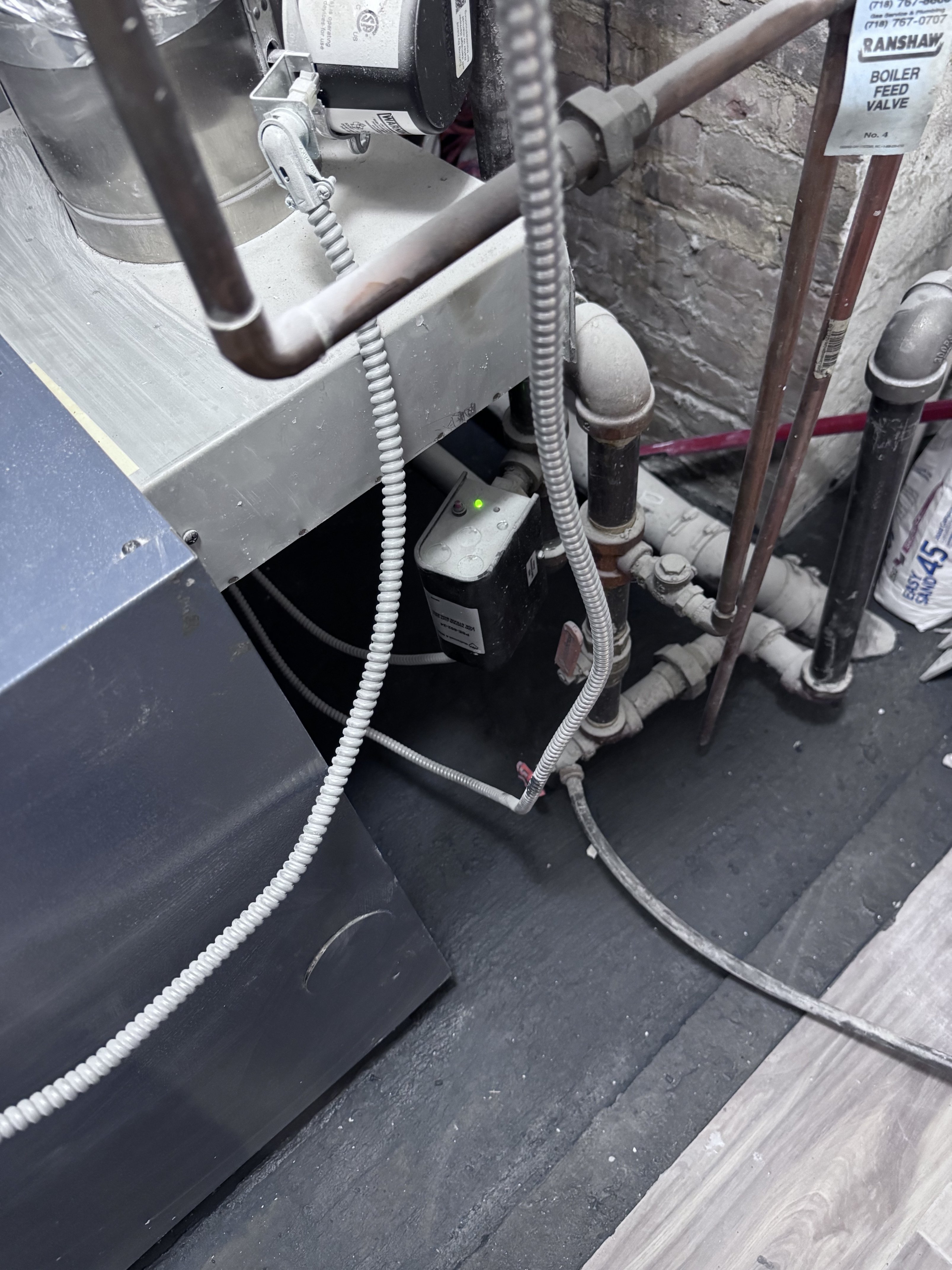

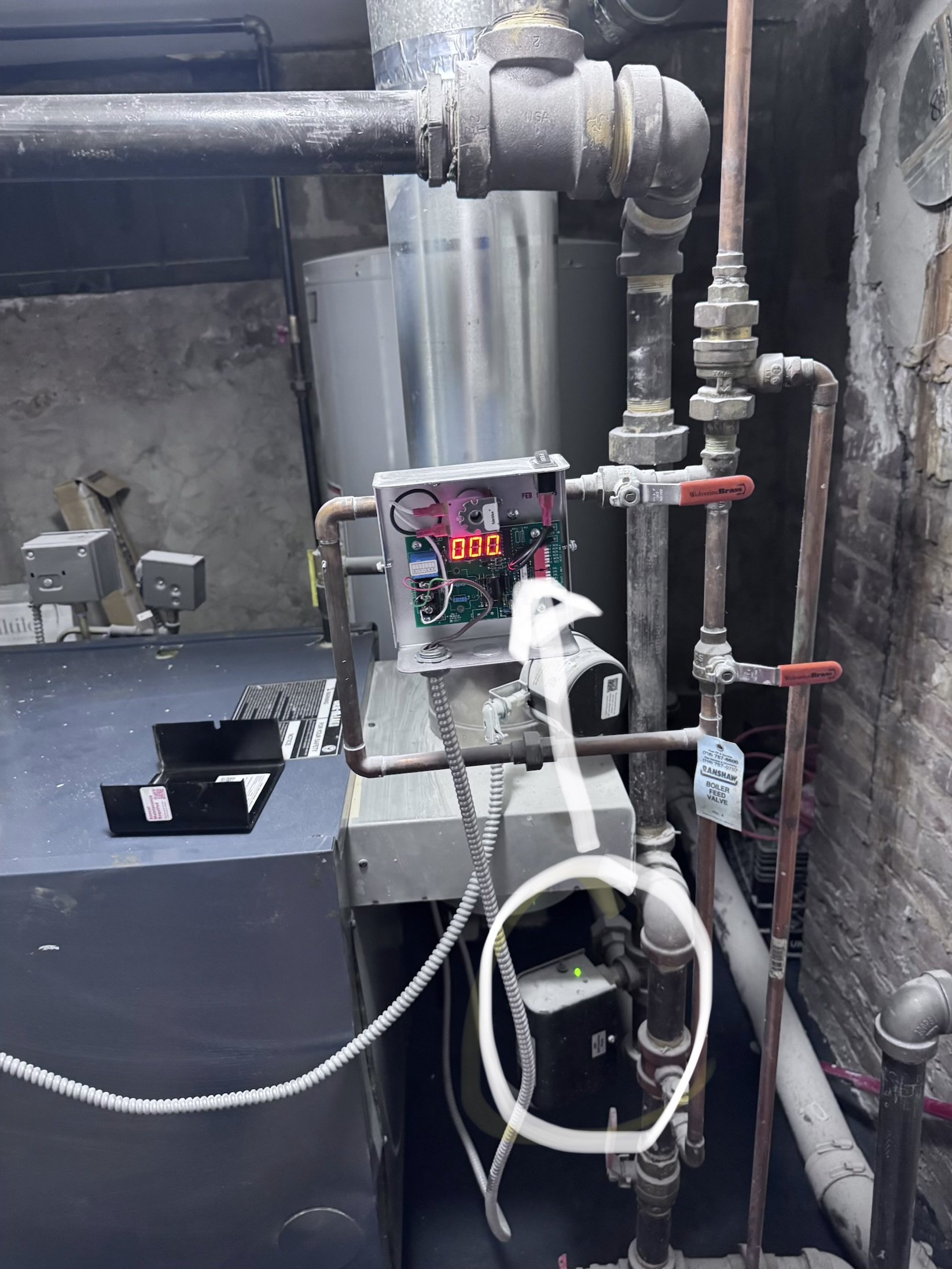

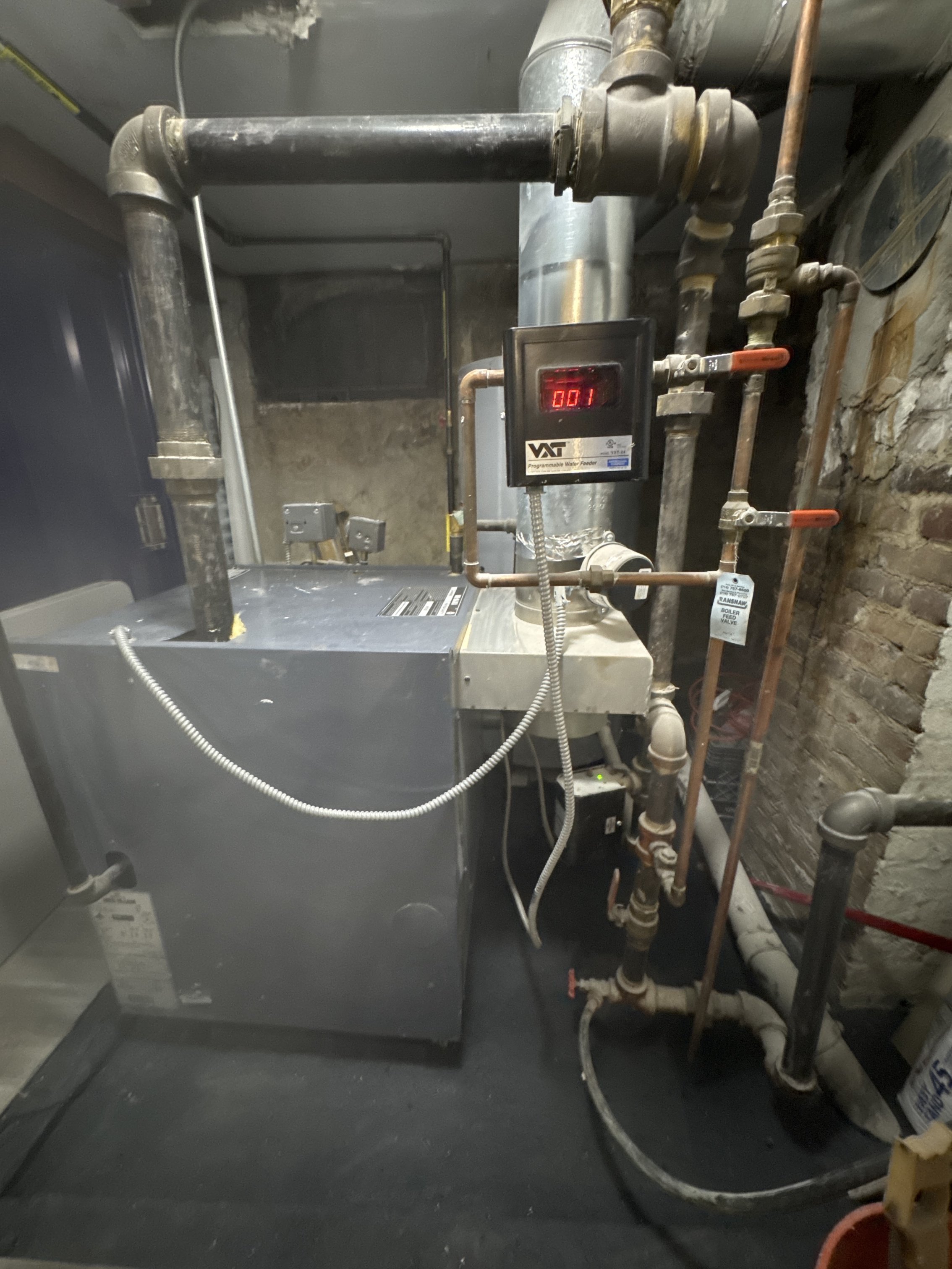

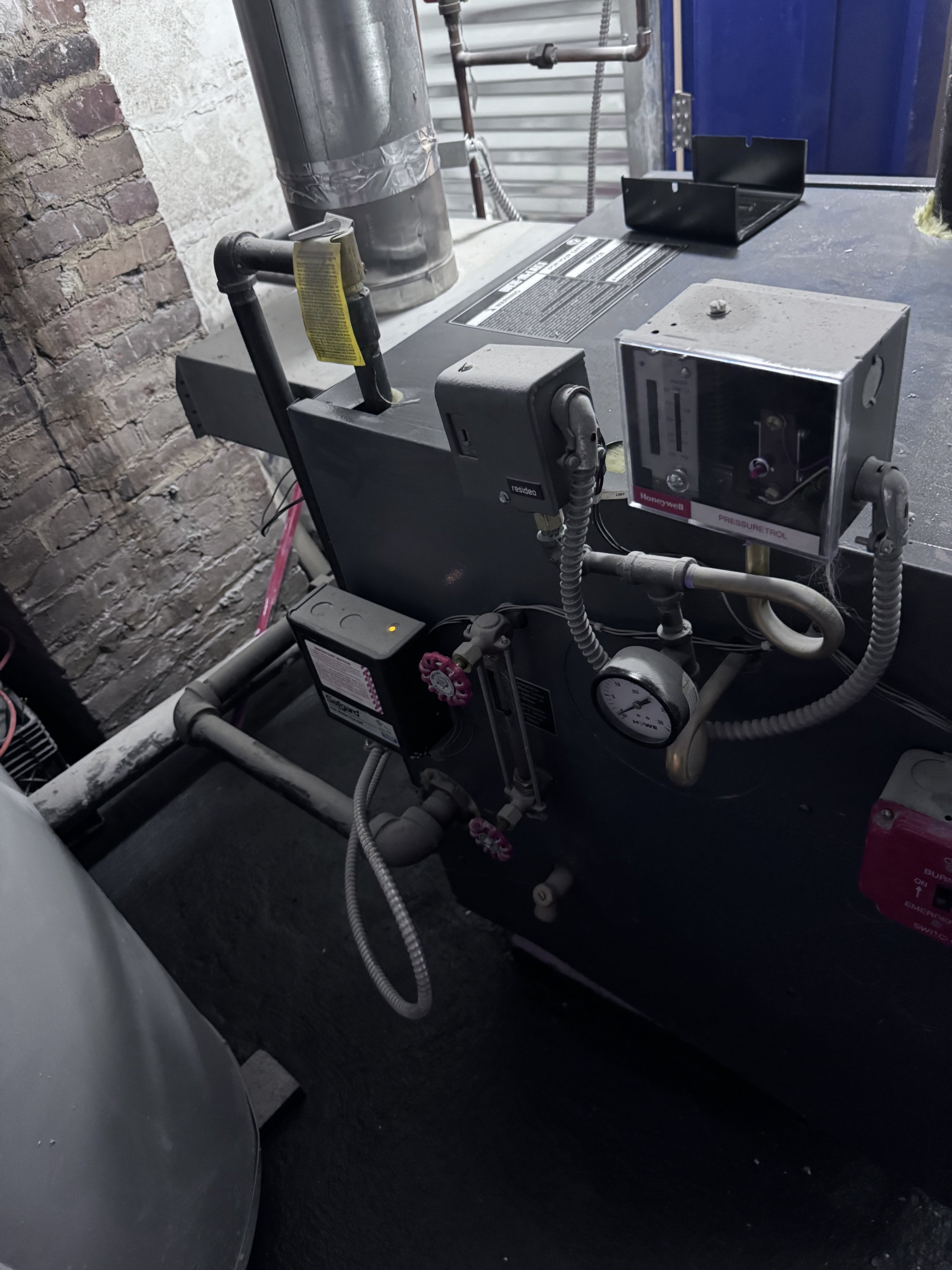

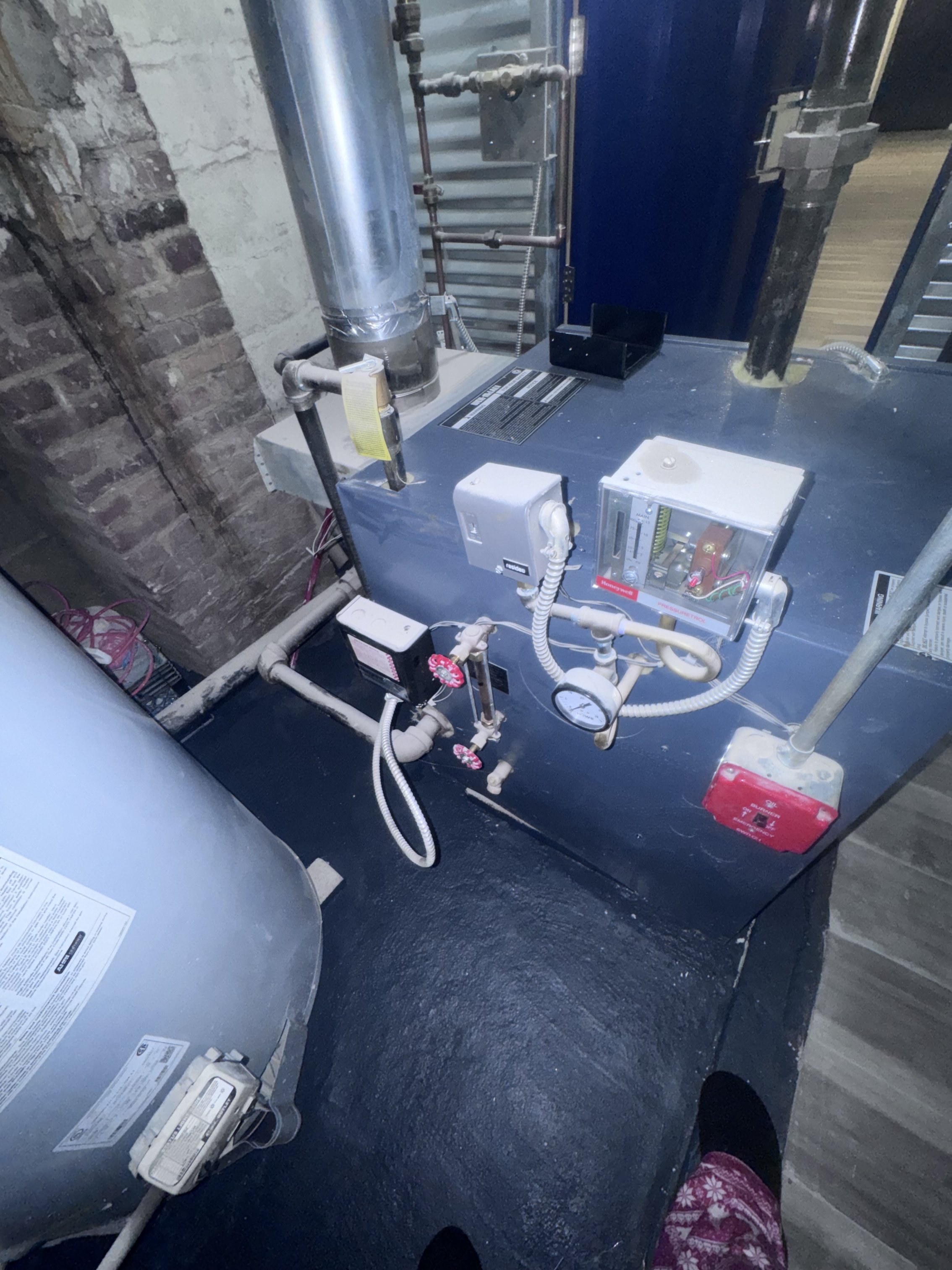

Hello,
I have a brand new Weil McLain gas boiler with a Steam heating system. When asking for heat, the LCOW is constantly going off and water would be added to the system. Is this normal? I am not sure where I am losing water at. There is no leak unless at the radiator air vent that I hear hissing at times. What could be some potential causes for this. If the boiler is off, the water maintains its level and it does not overflow.
Update
I had added pictures of the slight glass with the boiler on ( right before LWCO is triggered) and after the boiler turns off and water returns. The Waterfeed is never triggered because it is set to a 2min delay and water returns past the LCOW level before that. I added a bit more of water using the bypass to increase the level and same result. Timed at 2minutes of heating before water level dropping and LWCO trigger.

    " I have a brand new Weil McLain gas boiler with a Steam heating system. "
    New Boiler !!! Was it ever Skimmed ?
    Has this been going on since the the install ?
    I'd say the boiler needs Skimming to get the manufacturing oil out of the system.
    The oil coating the top of the boiler's water causes eruptions sending the water out of the boiler tripping the LWCO, possibly eventually flooding the boiler due to water being added when the system as a whole (behaving normally) really does not need more water.

    Thank you! I think this might be the cause as well. Looking at the VXT-24 auto feeder it has only had 4 gallons since its installation ( June 2025) and has been 4 gallons since October it might not be an actual water loss- unless that is not registering it correctly which it is also new. I will have to ask the contractor who installed it to skim it.
    109A_5 Member Posts: 3,836
    edited February 22
    20 gallons removed Vs. 4 recorded makes no sense. Maybe you have multiple issues.
    If it was never skimmed it probably needs it. And it may need multiple attempts since the oil was possibly blasted into the system by the eruptions and returns slowly.

    @mb23 You need to post pictures. How does the sight glass look? Clean or dirty? Does the water level bounce when the boiler is steaming" Does it move more than an inch?

    sight glass looks dirty (brown) but the water itself is clean( now). The water level bounces a lot while steaming until it finally goes to the level where the LWCO is triggered.
    ethicalpaul Member Posts: 8,604
    it’s carrying over and needs skimming as @109A_5 said

    I have updated the post with pictures. What would be more beneficial, skimming or just a system flush?
    follow up question, is the pressure trol suppose to be set at 15psi? The cut in is at 2 psi for residential home.

    Weil McLain but what model and size? Does Weil McLain have a different policy on which side a single takeoff can be? AFAIK all the others say it must be on the side with the controls so that you don't get nuisance triggers of the LWCO due to the probe seeing a false low waterline due to waterline tilt.
    That second pressuretrol on the right is probably a manual reset high level cutout in the event that the primary pressuretrol set lower (1.5 to 2 psi) fails. I wouldn't set it at 15 psi though because that is where the 3rd backup which is the pressure relief valve is supposed to trip, making a mess possibly. Better to set it at maybe 5 to 10 psi.

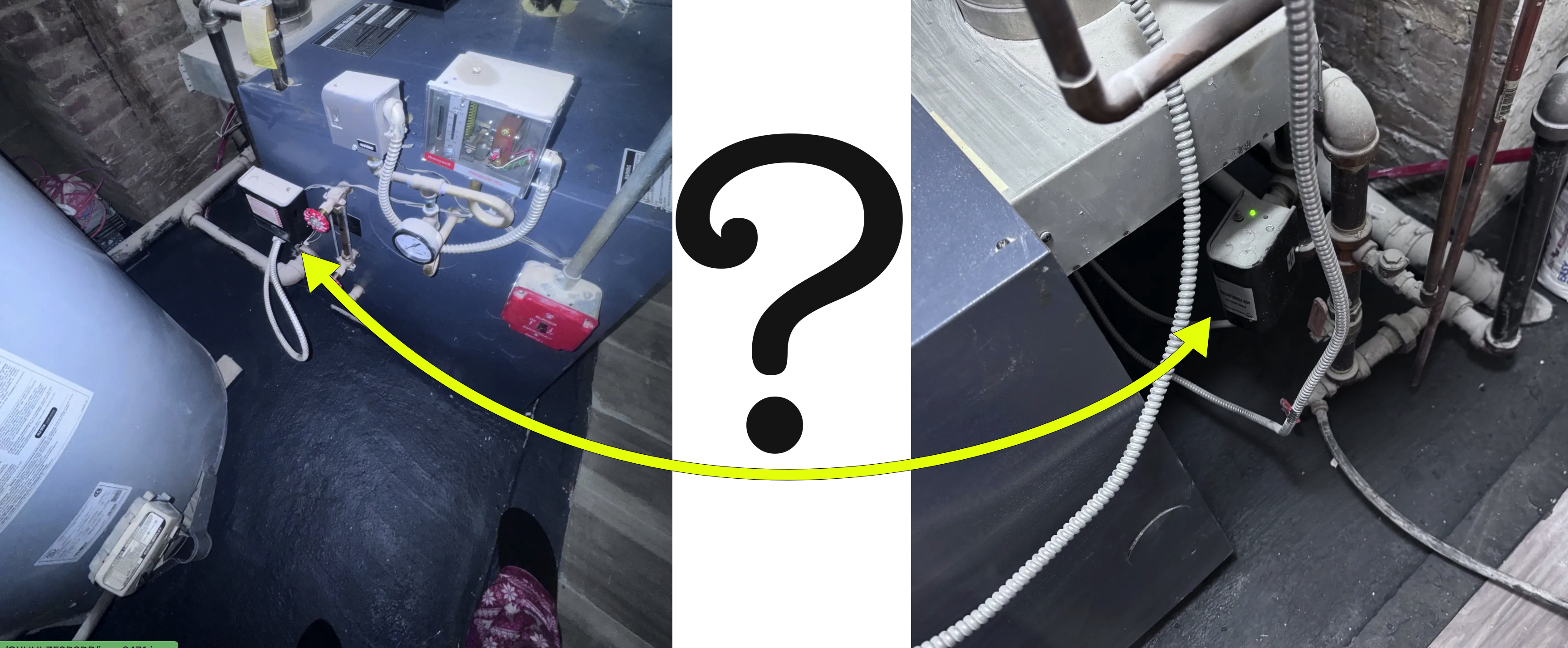

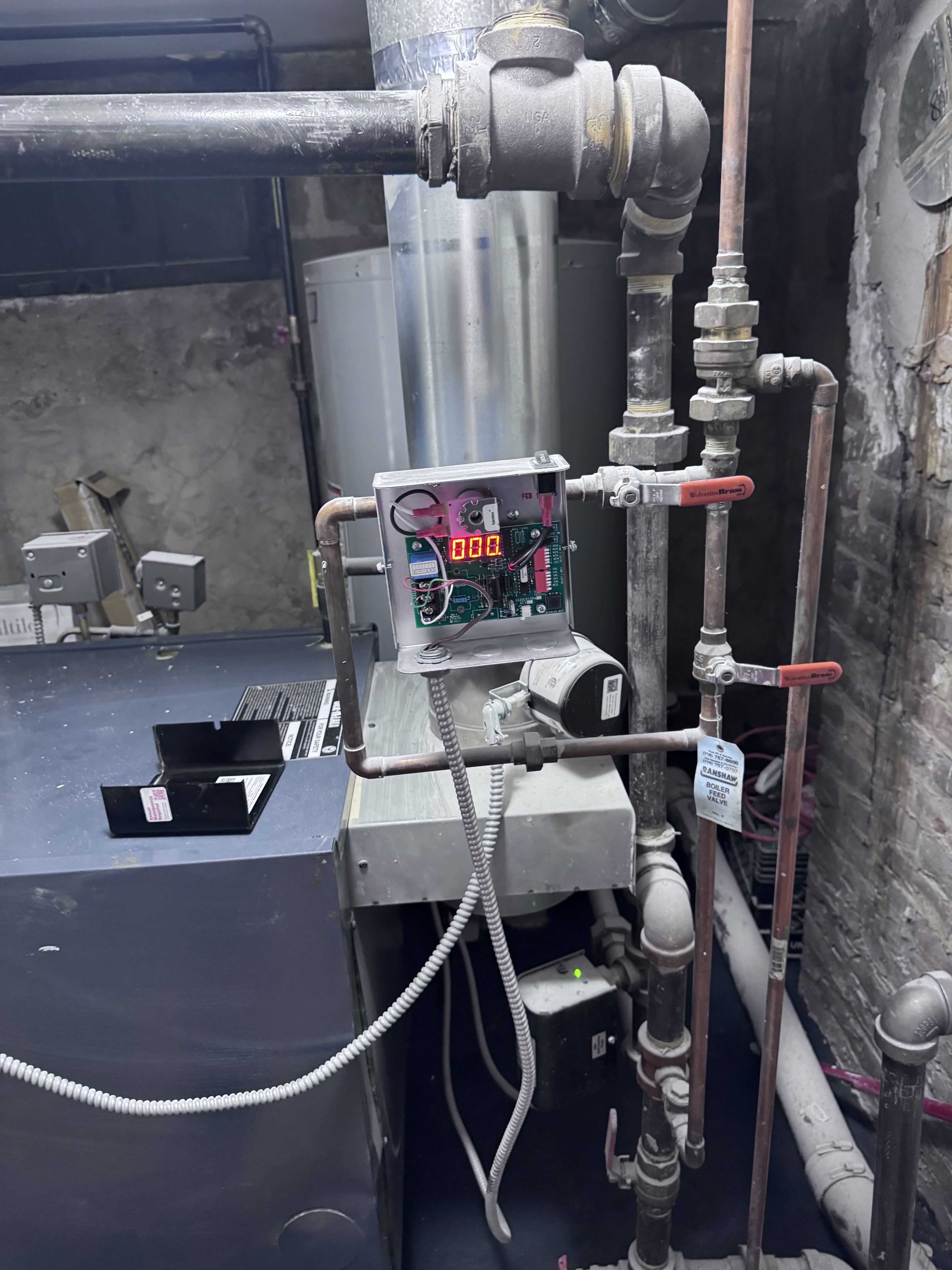

    Are there 2 LWCOs on this system? which one operates the water feed? Why is the one on the right located on a pipe outside the boiler? I can see all kinds of problems that can happen with this setup
  • mb23
    mb23 Member Posts: 18
    edited February 22
    Not sure why the contractor put in two LWCO. The one that controls the feeder is the one on the left of the pressure trols. Not sure if redundant system? But the one on the boiler is the one that triggers the feeder, which it never actually is activated because the water is returned back into the boiler before the 2min delay. I have also tested and all the water returns to the level it was set to. It definitely has to do with surging. I added a bit more water 100% of the sight glass and I am timing how it takes to trip the LWCO ( 3 mins and trips) and water returns to its level in 45 seconds.
    EdTheHeaterMan Member Posts: 11,982
    Does the LWCO just below the draft hood ever cause the burner to shut down due to a low water condition in that pipe?
  • mb23
    No just the LWCO at the left of the pressure trol within the boiler. It is definitely due to surging water levels. I timed it to 3 minutes and pressure doesn’t get pass 0.50psi. It is physically seeing a lower water level and as soon as it shuts off water returns quickly. However the surging water level within the sight glass is the problem. Is there a difference between system flush and skimming?

    Flushing means opening a valve or plug at the bottom of the boiler to force out any sediment that has built up on the bottom. A standard boiler drain valve cannot truly flush a boiler. It only allows water to dribble out through a small 3/8" opening inside the valve. To properly flush a boiler, you need a full-port 1-1/4" valve or larger so debris can be carried out effectively.
    Skimming is done at the top of the boiler after it has been operated for several hours. You open a 1-1/4" (or larger) skim tapping and install a short nipple or pipe, typically 6 to 12 inches long. The purpose is to remove oils introduced during installation from cutting and threading pipe nipples and fittings.
    When the boiler heats up, those oils end up on the surface because oil floats on water. This creates a thin film on top of the boiler water. That film interferes with proper boiling because oil has a higher boiling temperature than water. As steam bubbles form, they must push through the oil layer, which causes the surging you observe in the sight glass.
    To remove that oil film, you need to create a gentle “waterfall” effect so that surface water flows slowly out through the wide opening of the 1-1/4" (or larger) skim port. The key is slow flow — just enough for the surface water to spill over and carry the oil with it. This process can take several hours the first time and may need to be repeated.
    You cannot properly skim a boiler from a bottom drain. If you drain from the bottom, the oil on the surface will cling to the internal cast iron sections, similar to a bathtub ring. The goal of skimming is to prevent that residue from coating the inside of the boiler by allowing only the surface water to flow out gently through the skim port.
    I hope this explanation helps.

    Thank you Ed for the great explanation. This definitely means that the contractor did not skim the boiler after installation. I don’t think I even have a skim port.

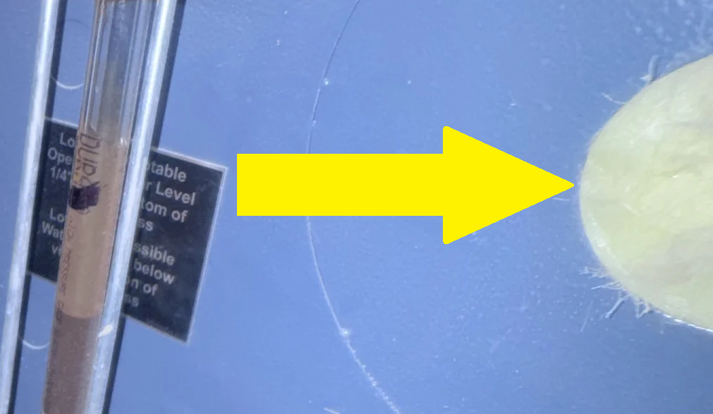

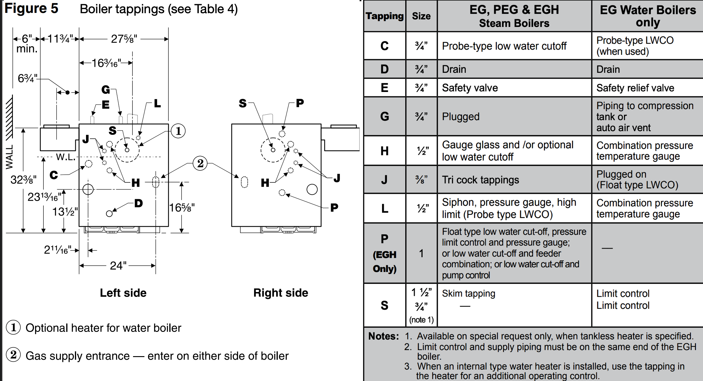

  • neilc
    neilc Member Posts: 3,157
    you can see the skim hole in the boiler jacket to the right of the upper site glass valve, it still has jacket insulation there, which strongly suggests the nipple(valve) and cap were never installed, and no skim has occurred, your installer owes you,
    or if you're handy, and with proper tools, , , , you'll need to skim more than once, do you have your manual?

    The hole in the side with the letter S is the skim tapping. it is 1-1/2" pipe thread with a plug in it. (behind the insulation that @neilc mentioned. )

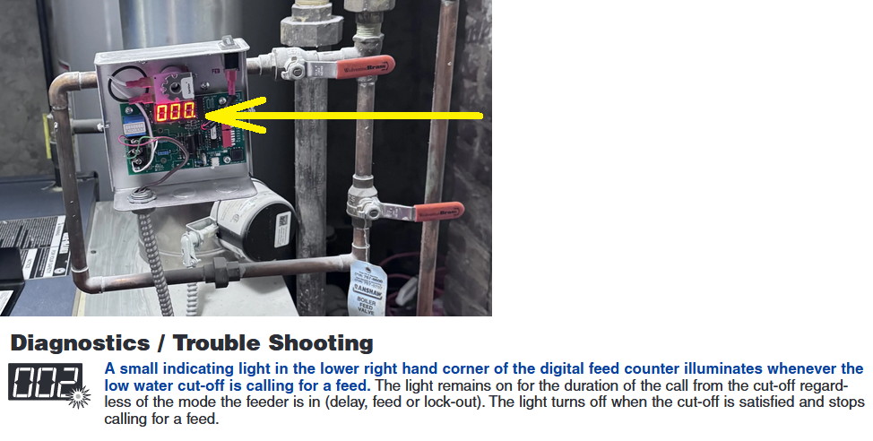

    When this picture was taken the VXT was being commanded to feed water, was this expected at this time ?
  • mb23
    Yes, the LWCO was triggered ( please see picture with the yellow light) and a command was issued to the VXT. However, it never actually feed the boiler since the water returned before the delay (2 min) and the LWCO was satisfied and signal was reset.
    also to @EdTheHeaterMan point, the second LWCO, the one on the pipe outside the boiler, did not ask for water as it is green in the picture with the VXT receiving the command from the LWCO at the boiler.
    So the LWCO on the pipe outside the boiler is a secondary Safety while the one actually in the boiler LWCO Tapping on the other side is the “operating” control. That makes sense.
    So your boiler's burner goes off as a result of low water then the burner comes back on before the feeder adds water, and you want to know if this is normal. That depends on how your system is piped and operating. It appears that the LWCO is working. It appears that the delay on the water feed is set properly so your boiler does not get flooded. The only other question is, does the heat work? If the rooms are at or close to the thermostat set point, and you don't have banging, and/or you don't have hot and cold unbalanced room temperatures, then I might be inclined to say that for your system that is normal.
