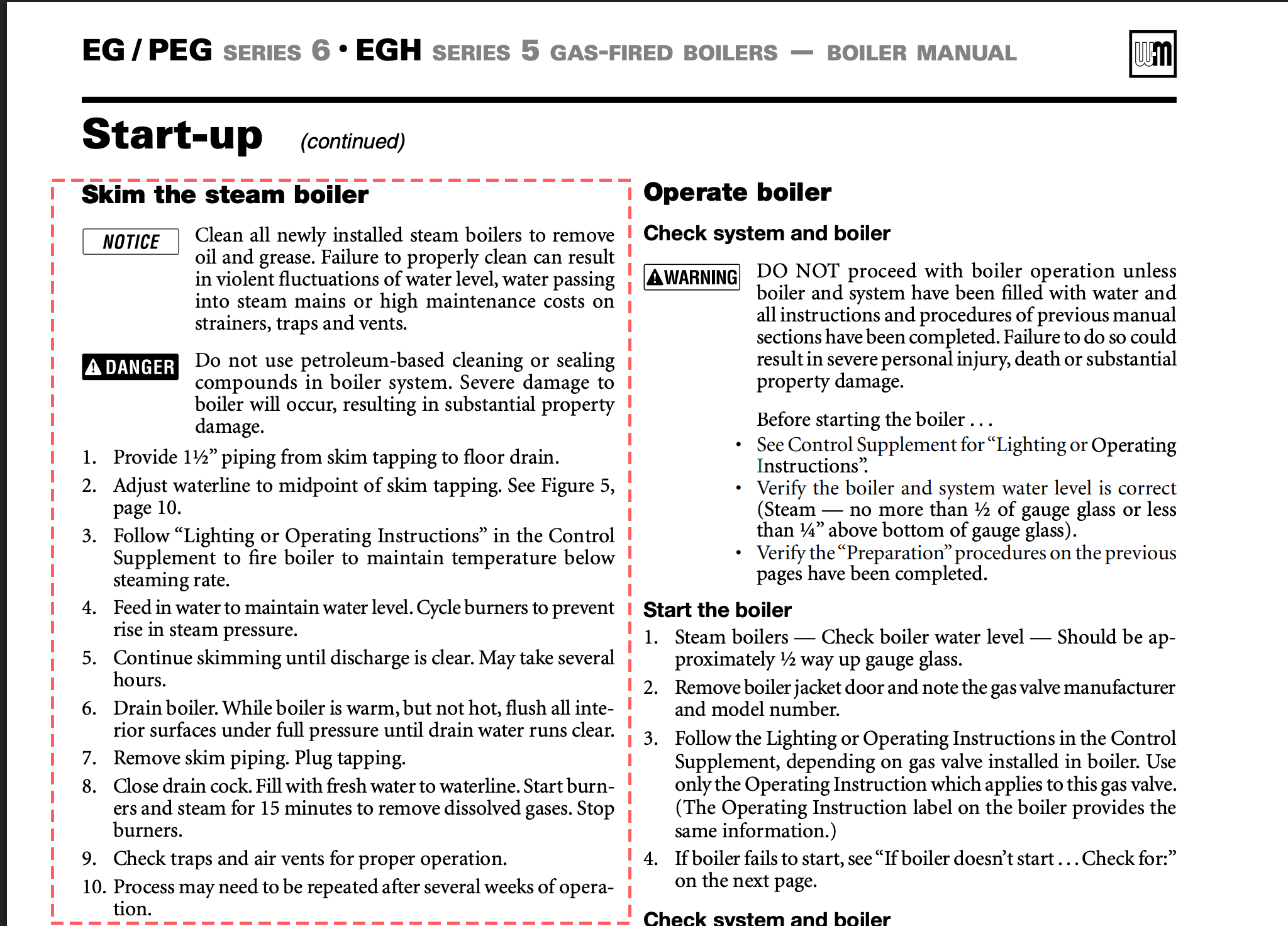

    Flushing means opening a valve or plug at the bottom of the boiler to force out any sediment that has built up on the bottom. A standard boiler drain valve cannot truly flush a boiler. It only allows water to dribble out through a small 3/8" opening inside the valve. To properly flush a boiler, you need a full-port 1-1/4" valve or larger so debris can be carried out effectively.
    Skimming is done at the top of the boiler after it has been operated for several hours. You open a 1-1/4" (or larger) skim tapping and install a short nipple or pipe, typically 6 to 12 inches long. The purpose is to remove oils introduced during installation from cutting and threading pipe nipples and fittings.
    When the boiler heats up, those oils end up on the surface because oil floats on water. This creates a thin film on top of the boiler water. That film interferes with proper boiling because oil has a higher boiling temperature than water. As steam bubbles form, they must push through the oil layer, which causes the surging you observe in the sight glass.
    To remove that oil film, you need to create a gentle “waterfall” effect so that surface water flows slowly out through the wide opening of the 1-1/4" (or larger) skim port. The key is slow flow — just enough for the surface water to spill over and carry the oil with it. This process can take several hours the first time and may need to be repeated.
    You cannot properly skim a boiler from a bottom drain. If you drain from the bottom, the oil on the surface will cling to the internal cast iron sections, similar to a bathtub ring. The goal of skimming is to prevent that residue from coating the inside of the boiler by allowing only the surface water to flow out gently through the skim port.
    I hope this explanation helps.

    The installer should have done the initial skimming, so I would think they owe you that. The change to the return may have added additional oil to the system (depending on the pipe type used) so skimming may have needed to be done after that also.
    109A_5 Posts: 4,759
    edited February 23
    Skimming is not that big of a deal to do, but it takes time and usually needs to be done at least once, sometimes multiple times.
    Some examples.
    https://www.youtube.com/shorts/RX369TXJHNc?feature=share
    https://www.youtube.com/shorts/1Qf8l95fLMI?feature=share
    mb23
    109A_5 Posts: 4,759
    Since your boiler has probably been puking oil up into the rest of the system for some time now it would not surprise me if your boiler will need skimming multiple times as the oil slowly returns to the boiler over time.

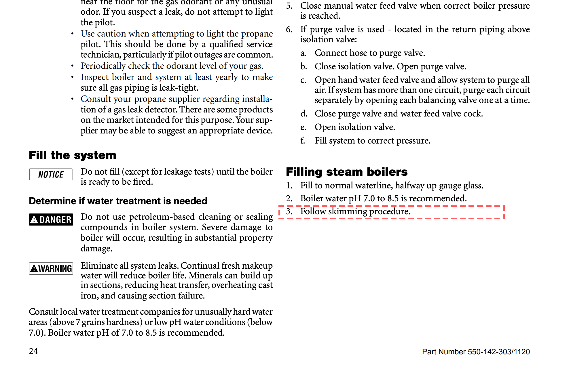

    I'd get the skim pipe installed, a full port ball valve would be nice too. And learn how to do the skimming so you are not paying for return trips of a contractor.
    109A_5 Posts: 4,759
    A skimming procedure is in just about every boiler install manual. Sadly many installers think reading and understanding the install manual is optional.
