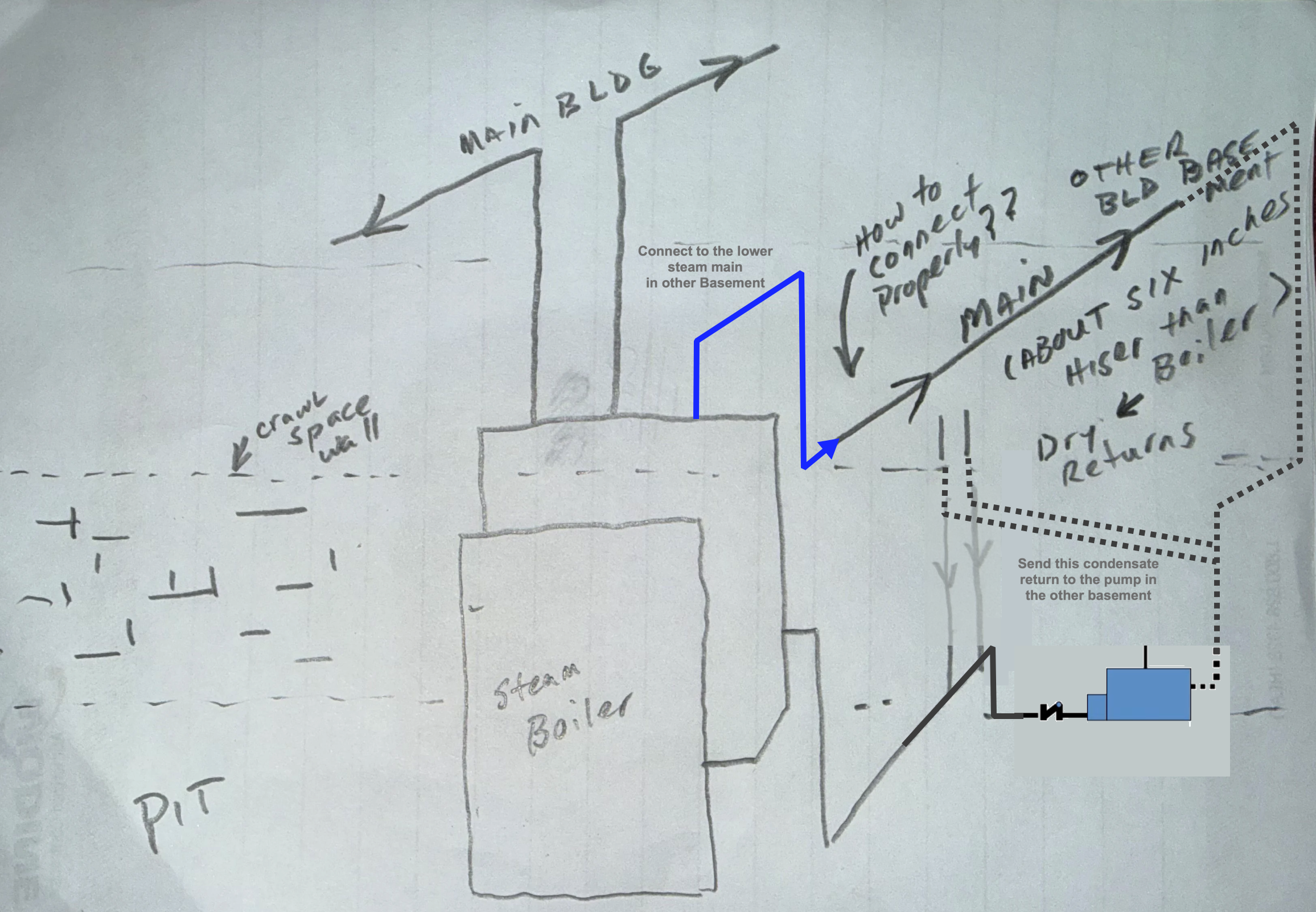

Good morning, I am a Contractor trying to help friend of mine that is semi-retired in the industry. He was asked to solve a problem of a steam boiler that was only replaced four months ago and is not properly heating the building. The old boiler that was replaced is no longer there and so has disappeared the man that installed the one in the photo……
The building is one on the outside, but has two separate basements. It appears that one basement is about 150 years old and the other is about a 100. In the one basement is an abandoned steam boiler from the 1960's. That steam main and dry return were extended into the other basement (the photo attached) many years ago and is about 6" higher than the boiler in the photo. Those mains are basically sitting on the crawl space floor……
I have made a drawing to eliminate the bullhead tee in the boiler room but do not have knowledge on the proper way (if there is a way) to tie in the lower steam main that goes to the other basement.
I thought one of you guys might have an idea and be able to mockup my drawing.
Thanks
Keith.

    S long as that low main and its associated dry return are above the water line of the new boiler, it's really not a problem. Other guys may have — will have! — other ideas, but I'd take your drawing — which is MUCH better than what is there now!! — and add a third T with the leg up, go up about six inches or so, elbow horizontal and go about six inches or as needed, then elbow down and pick up that low main with a T (main on the leg) and continue on down to a wet return. I'd tie the dry returns together and just drop them down to a wet return as well — with a generous vent where they tie together (at least one Goroton #2, maybe 2).
    Now that is absolutely dependent on the whole show being well above the water line of the new boiler. If the dry return isn't well above ("well above" depends on the operating pressure — at least 14 inches, if you can operate at half a pound) you will need to drop the dry returns into a condensate receiver and have a boiler feed pump.

    Jamie thanks for your insight. I have mockup my original to what I believe how you would pipe it. Please let me know that I interpret your suggestion correctly.
    Thanks
    Keith.

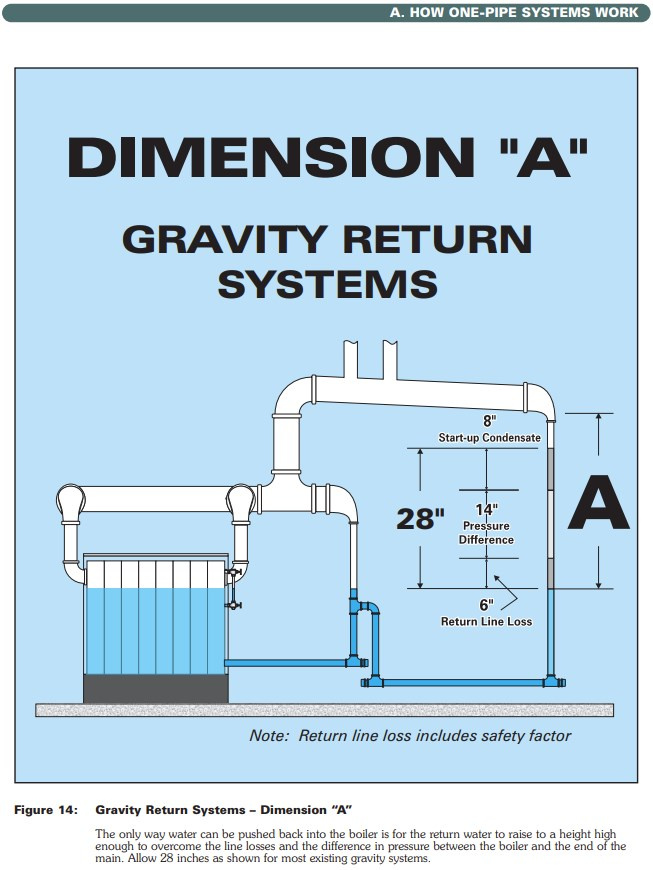

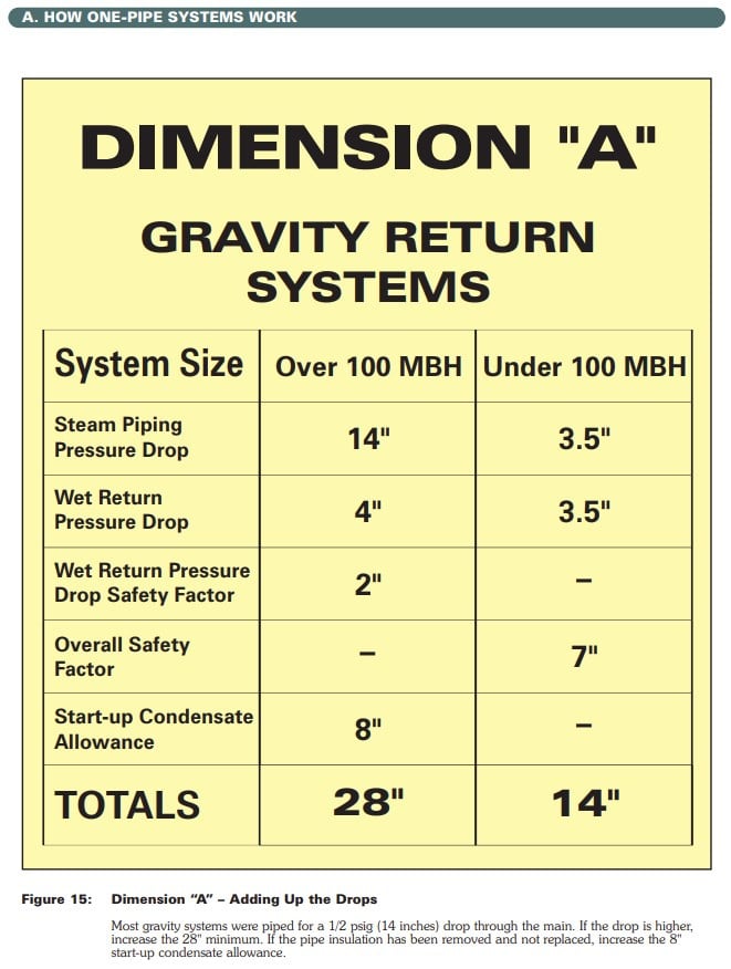

    @ethicalpaul So this is wrong, from the Peerless One Pipe info.?

    ethicalpaul Member Posts: 8,598
    edited February 18
    Yes. If you'd like to talk about it more I will make a new discussion post so as not to distract from this gentleman's topic. Click "agree" below if you'd like me to do that.

    EdTheHeaterMan Member Posts: 11,948
    If your dimension A from the other basement is not enough for the boiler water line then you could try this idea.
    Screenshot 2026-02-19 at 11.25.53 AM.png Screenshot 2026-02-18 at 10.16.09 AM.jpg
    By adding a condensate return pump in the lower basement and sending a the condensate from both systems to the tank in the lower basement you will be able to use the pump to feed the boiler and still maintain the lower system's operation and function. You will need to add traps at the ends of all the dry returns before piping the condensate to the Tank
