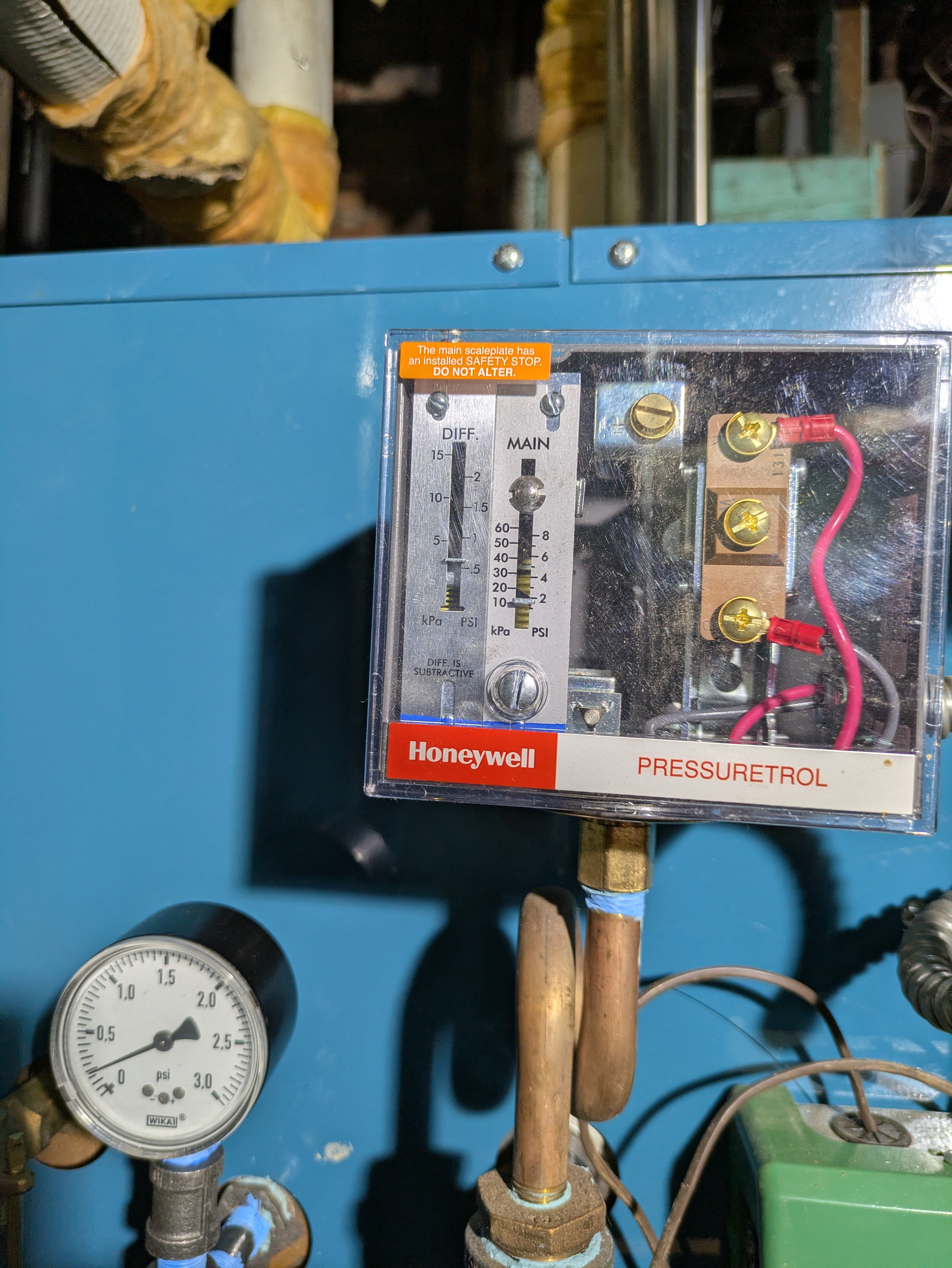

While I was finishing up the skimming, I added my old 0-3psi pressure gauge to the boiler, on a tee fitting. I don't know if I have a small leak or not, but the pressure during the full cycle never exceeded 0.2 psi. It heated the house fine, although it took a while due to the fact I had turned off the heat for 3 hours while doing the skimming. It was quiet, there was no hissing, no noise, save for pipes occasionally expanding. So the pressuretrol didn't seem to be involved at all. Before you ask, no it's not been calibrated by me. I did see it cycle (I think) but since there was no decent pressure gauge installed at that time, I don't know what it really cycled on. Now that I have a good gauge on it, it's quite instructive. You can even see the boiler go into vacuum when it shuts off and the vents are closed. It stays in vacuum a while, so I guess my handiwork isn't leaking that bad.

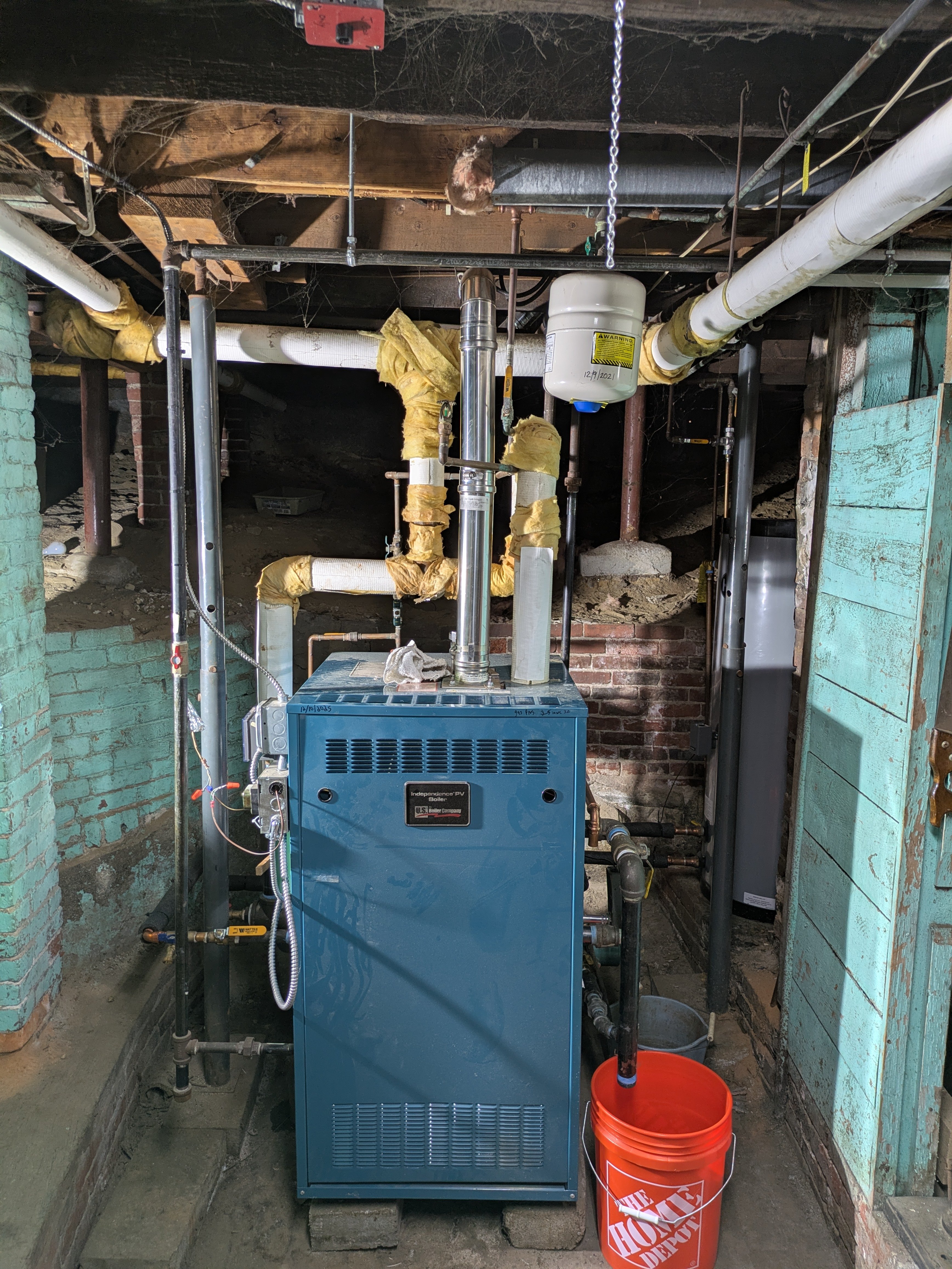

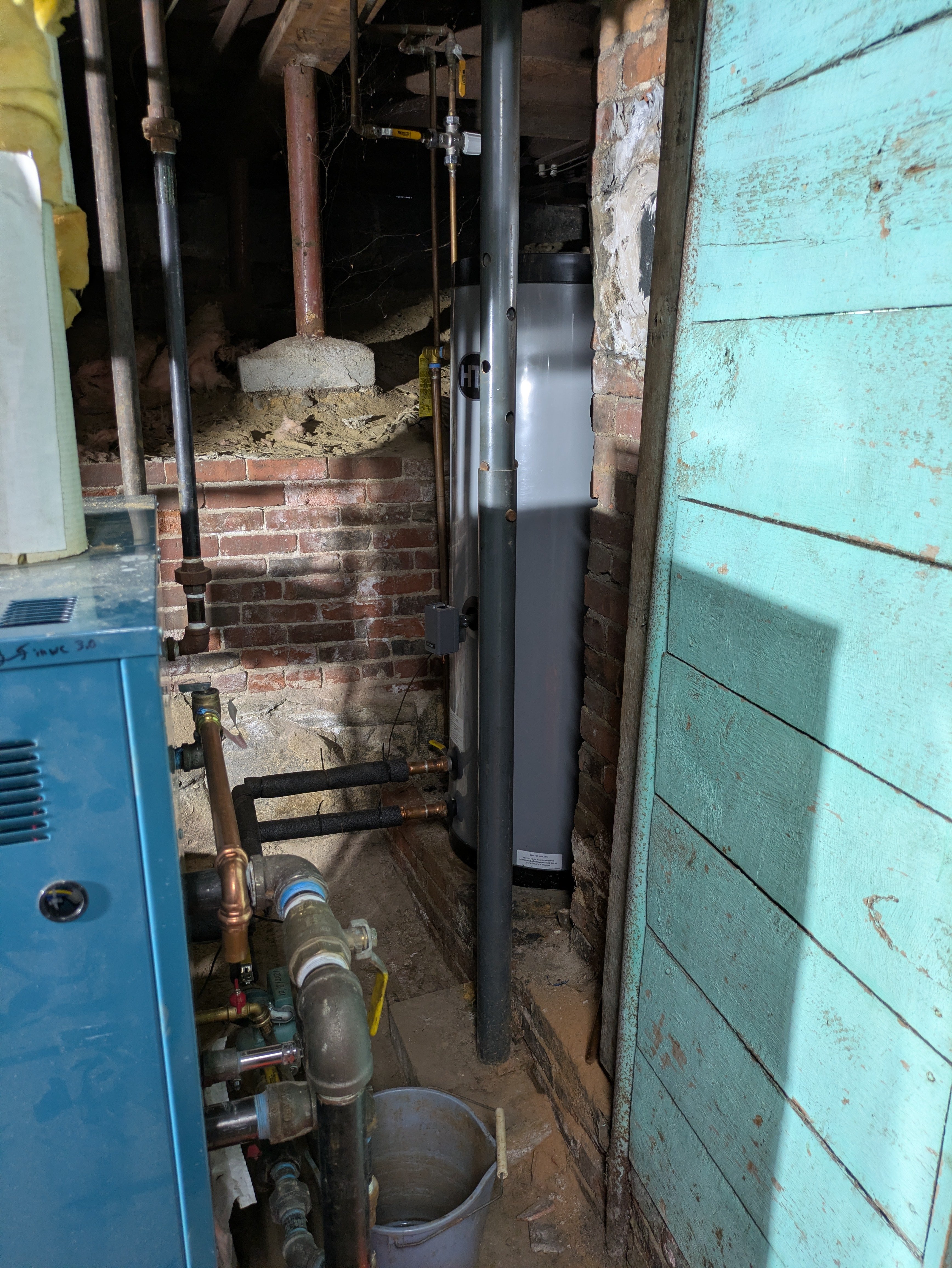

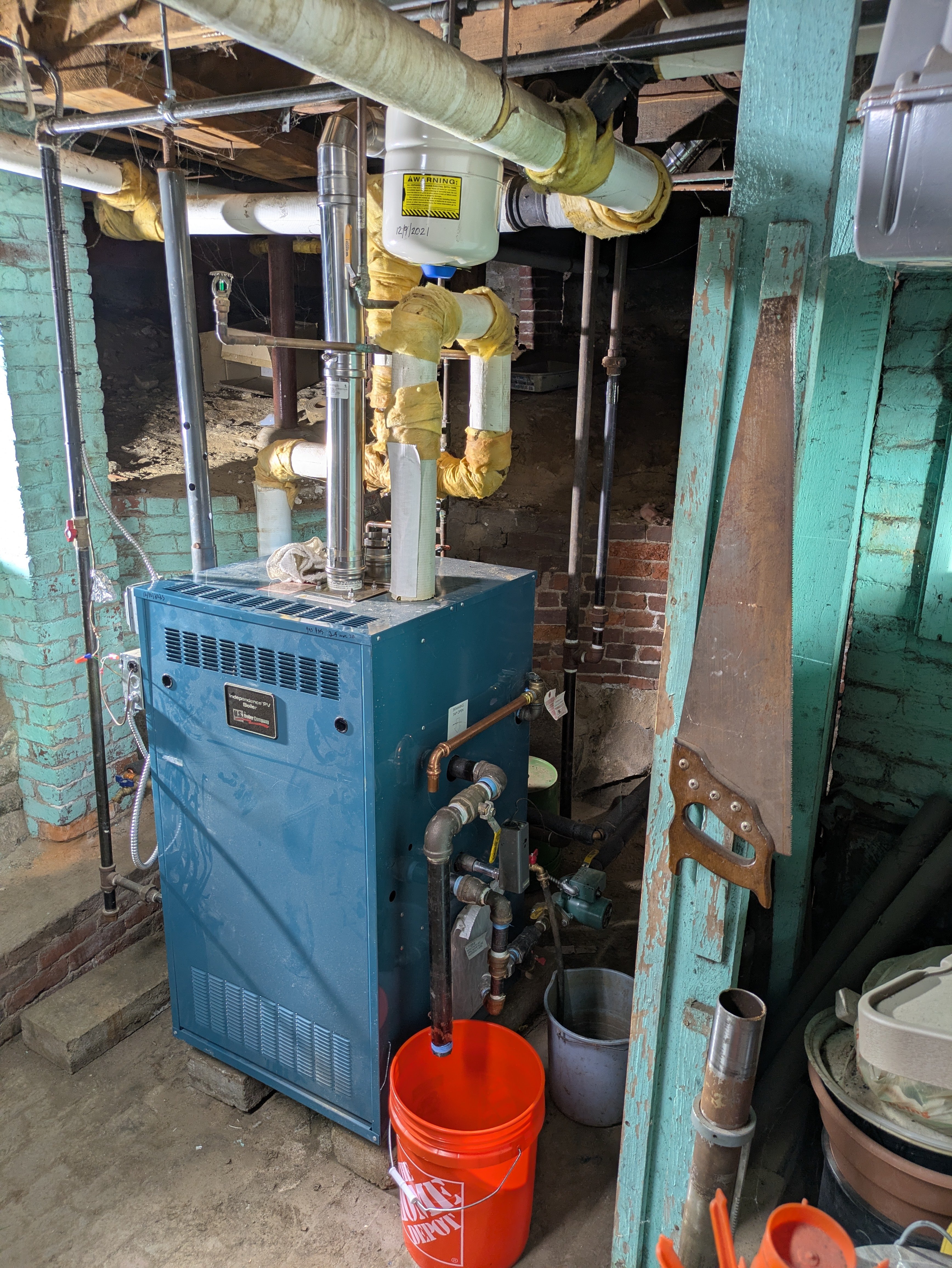

Oh, here's some pictures of the boiler and stuff near by.
While I was firing this boiler, the sight glass started leaking at the bottom gasket. The brass fitting that compresses the gasket was loose. So I tightened it. Then I noticed the bottom brass fitting was installed crooked (not vertical). I'll have to fix that since that will annoy me forever. It also makes for an asymmetrical seal on the glass tube. There's really no excuse for that, in my opinion. If you look at the first picture, you will see it needs a few more degrees of tightening.
Looks pretty good, but your low pressure gauge is going to be exposed to steam which could damage it so you might consider relocating it above the pigtail with the pressuretrol.
And on your skim piping I would remove that vertical long nipple and the elbow and just let the water drop out of the horizontal nipple into a bucket. You can see the water and flow rate better that way. Have the horizontal part going slightly uphill so the water flows over the edge.
Thanks for the critique. I probably have another pigtail in my stash of plumbing junk, I'll check and install it.
When skimming, I rotate the vertical pipe to about 15 degrees, so it comes out in a well defined pencil like stream. When vertical it was all over the place. With the angle it makes a stream, and more importantly, it clears the bucket!🙂

Found and Installed the second pigtail. That's a little better, the gauge is now a lot cooler.
As for a main vent on the other side, I haven't been able to find it. It sure isn't obvious, at least peering down the pipe run, even with a really bright light shining down there. Could be at the very end, but I'd need to crawl on my hands and knees in dirt to get there. At least that's a space that would be pretty easy to extract myself from. If something is there, it's not working. If nothing is there, installing one would be beyond my abilities or tooling. I'll try to take a look.

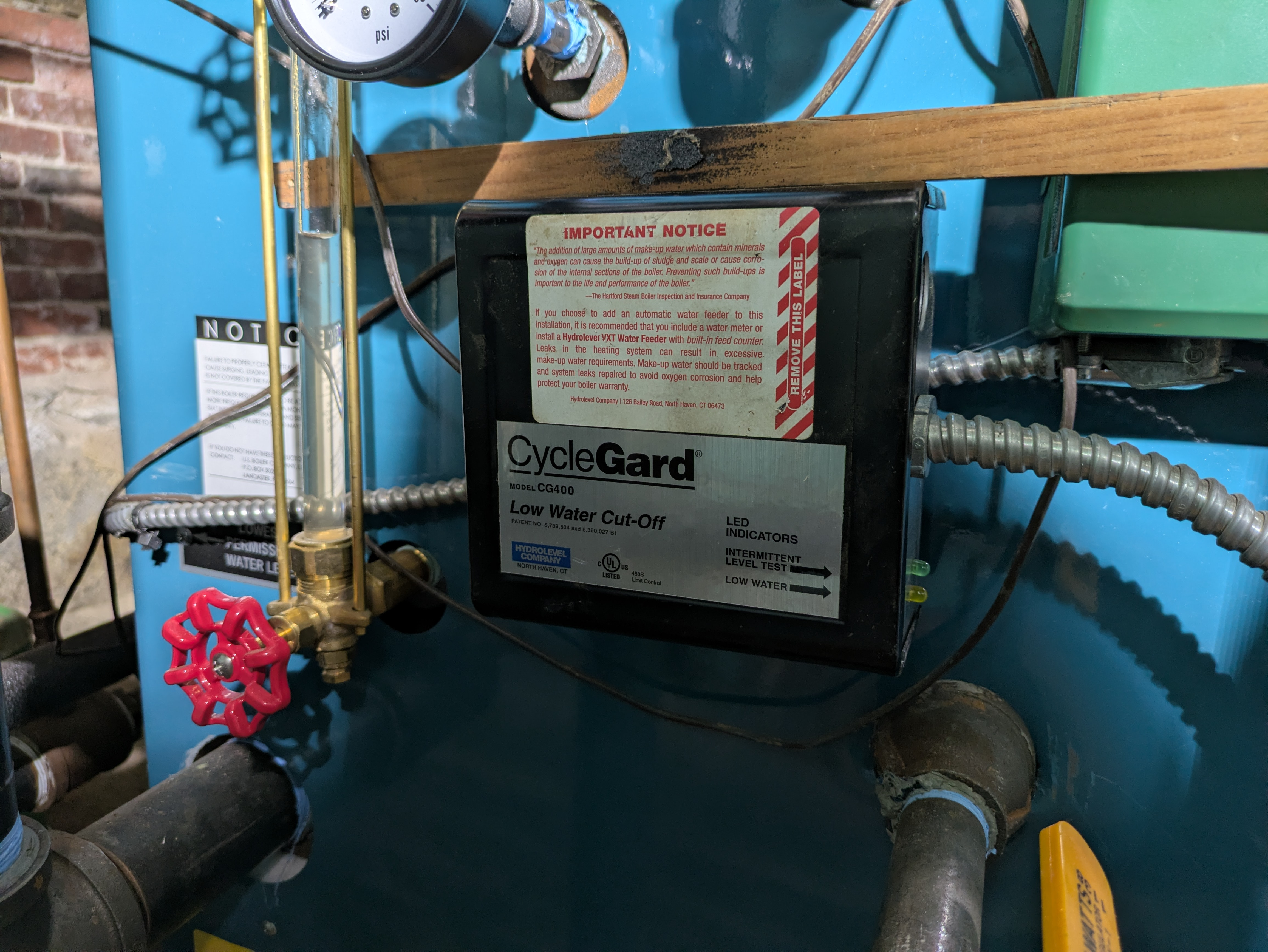

Still a mystery to me, I'm not cycling on pressure at all. I'm cycling on the intermediate low water cut off. There's tons of water when it turns off. Is there a slight adjustment I can make to the CG400?

No, you can't adjust the LWCO to fix this. It sounds like your boiler water is carrying over into your system. Is there oil in your water, or tons of rust, etc?

Pity on the LWCO. The old bellows units you could access the mechanism and make minor adjustments. I understand why one shouldn't change or defeat it, but this LWCO appears to be actuating when the sight glass water is 3/4" above the LWCO sensor location port.
For the record, the CG400 LWCO has two outputs. The real low water cut off, and a second "Intermediate water cut off". The boiler is cycling on the intermediate water cut off, not the true LWCO, nor the pressure trol. Since everything else is behaving well, I raised the water level a little. It is below the steam pressure sensors, about 2" below the top of the sight glass. We'll see how that does. I don't like the idea of cycling on a LWCO at all. That's supposed to be a safety device, not to regulate the normal operation of the boiler.
Hmm, I'm not sure what this means. There is a single probe, correct? What is the difference between cycling on this "intermediate water cut off" vs "true LWCO"? I don't understand what you mean so maybe I'm ignorant about some aspect of this LWCO

The LWCO has two LEDs on the side. One is labeled LWCO, the other is "Intermediate level cut off". I presume the LWCO is like bone dry low water sensor. That used to turn on before I did today's skimming. That's when the water disappeared from the sight glass. After flushing out the green stuff, and doing the TSP skim, the water goes to midway in the sight glass, and not to the bottom.
The intermediate level cut off is triggering when the water line is below 3/4" above the center of sensor port hole in the boiler. When that LED turns on, the boiler gas is cut and the boiler is disabled. A minute later, the LED goes off, and maybe 15 seconds later, the boiler fires again.
