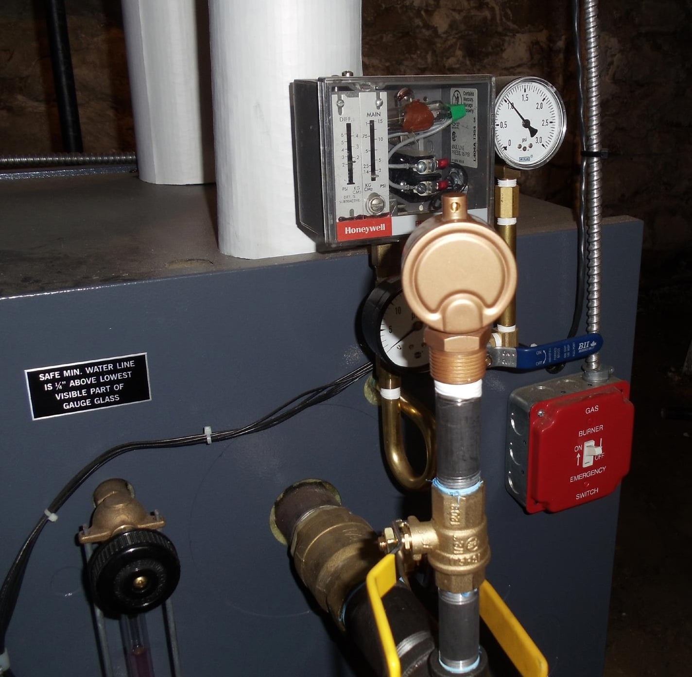

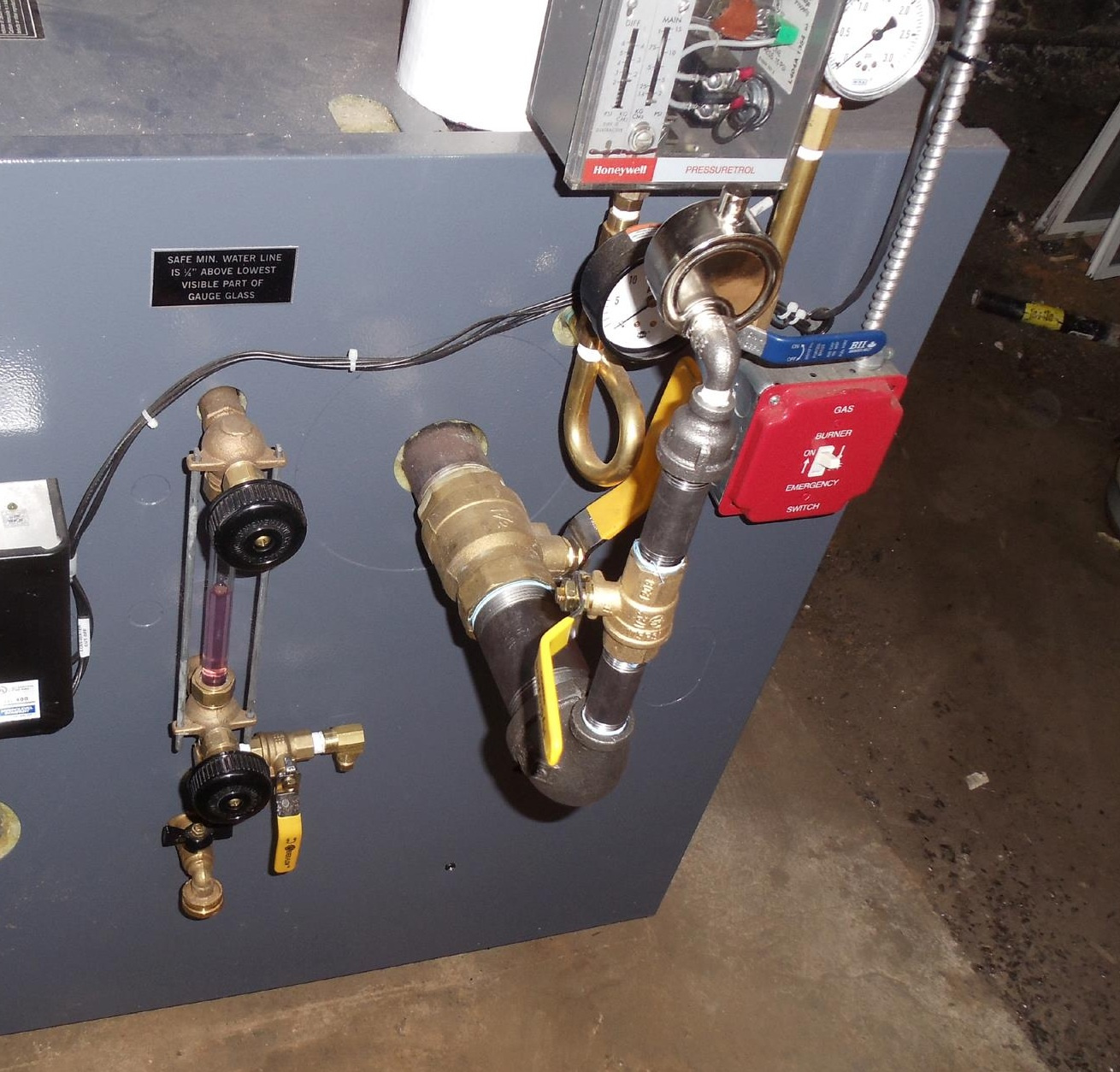

    The boiler is your non-recommended IN6-PV. It has a drop header. It reused all the old plumbing, that I showed in my earlier threads this year. (Last month and December.). Hartford loop looks ok. I don't want to use up this forum's storage, by reposting that. They didn't quite reinsulate the main boiler pipes the way I had it originally, but it's close. I probably need to redo that.

    you have a sag in your supply to that radiator, holding water, OR the boiler is carrying over all that water you are hearing (or both)

    A counterflow system with no drops at the boiler is absurdly sensitive to carryover If the boiler is running smoothly, it won't be a problem — but if the boiler is still surging and burping, that may be a major part of the problem. I know it's a bore, but make sure you are starting with clean boiler water — no chemicals or additives — and skim. And skim some more. And then some more. Collect some of the skimmed water in a bucket and let it stand — if there is even a trace of a sheen, it's not done.
