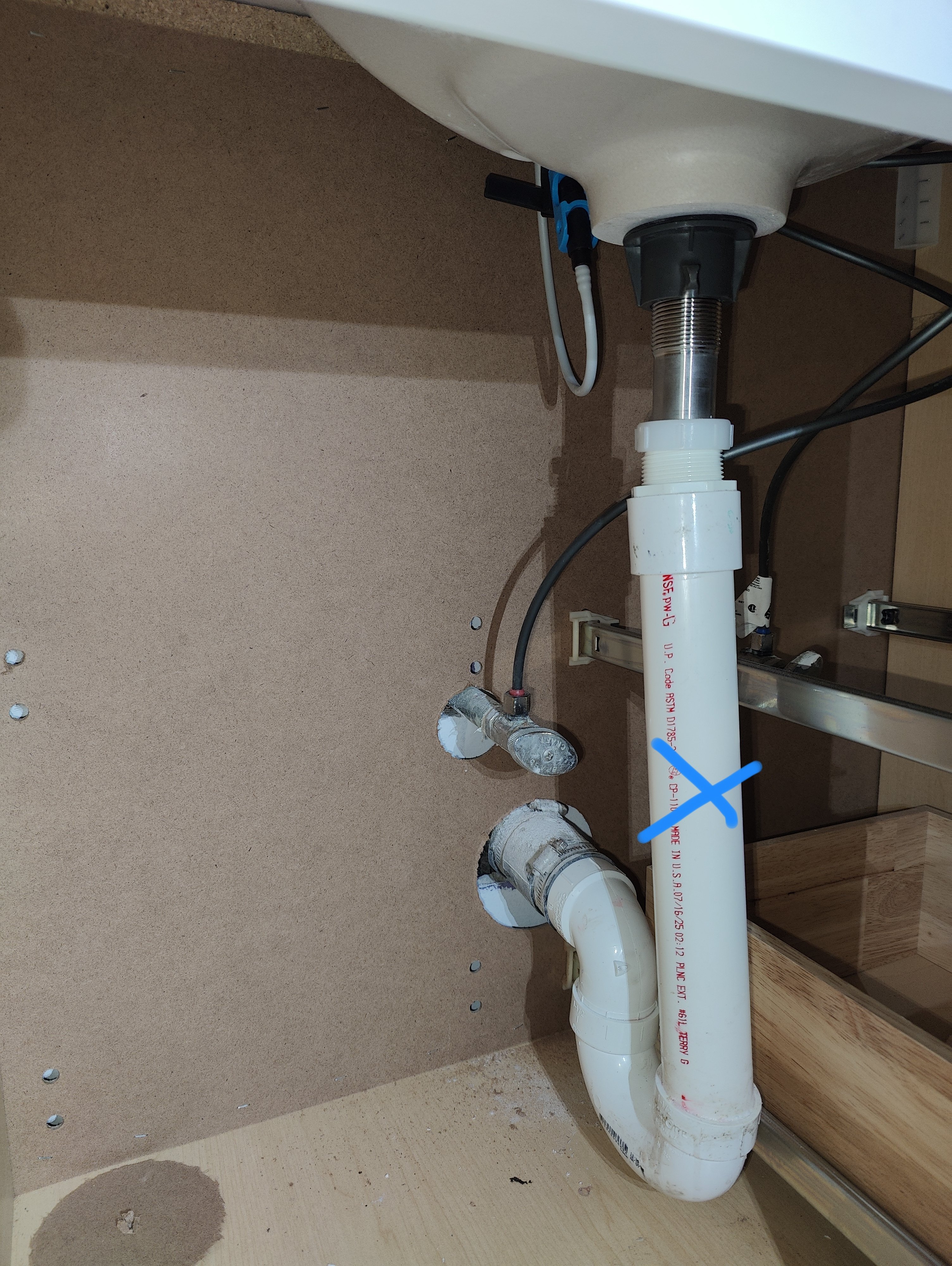

Washing machine drain solution
no. the drain is too small for a washing machine, at least without adding a laundry tub to buffer it
you'd have to add the washing machine to the stack that ties in to, assuming that has the capacity for it
I can upsize the PVC tube to 2" but the connection to the stack is fixed size

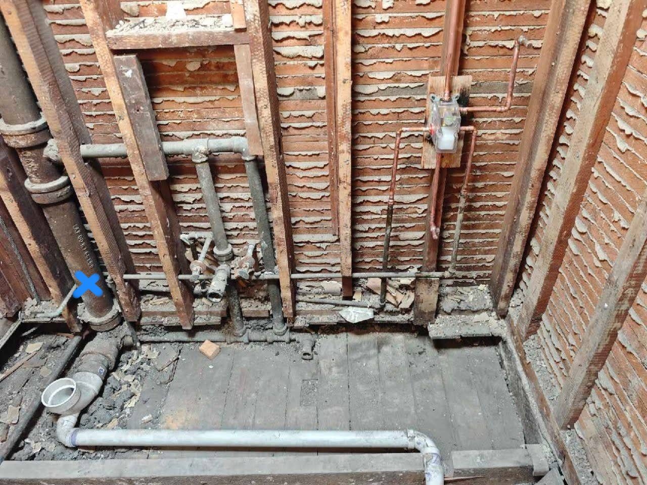

This is the ci stack behind the drywall. ~2" piping. How do you cut the pipe and insert a T?
Which pipe is galvanized?

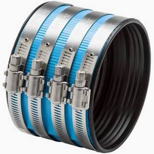

Cut a section off, or cut the entire galvanized grid away, then plug in assembled PVC piping, join to the existing stubs using Fernco no hub couplings, correct?

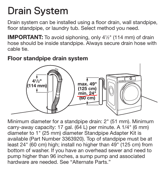

The washer is planned behind the wall. It will be a front loading 2.4 cu ft washer dryer combo that features water saving.
My understanding is you need 2" all the way to the main drain stack in the wall. If you are proposing adding a 2" stub outside the wall, that's not going to cut it.
In addition to that, will you be able to have the proper height requirements for the drain hose? I grabbed this from a whirlpool manual, but as far as I know they all have these requirements. 4" inserted into the pipe, Minimum 24" tall and straight down into a trap. I really don't see how you would accomplish any of this under a bathroom sink.

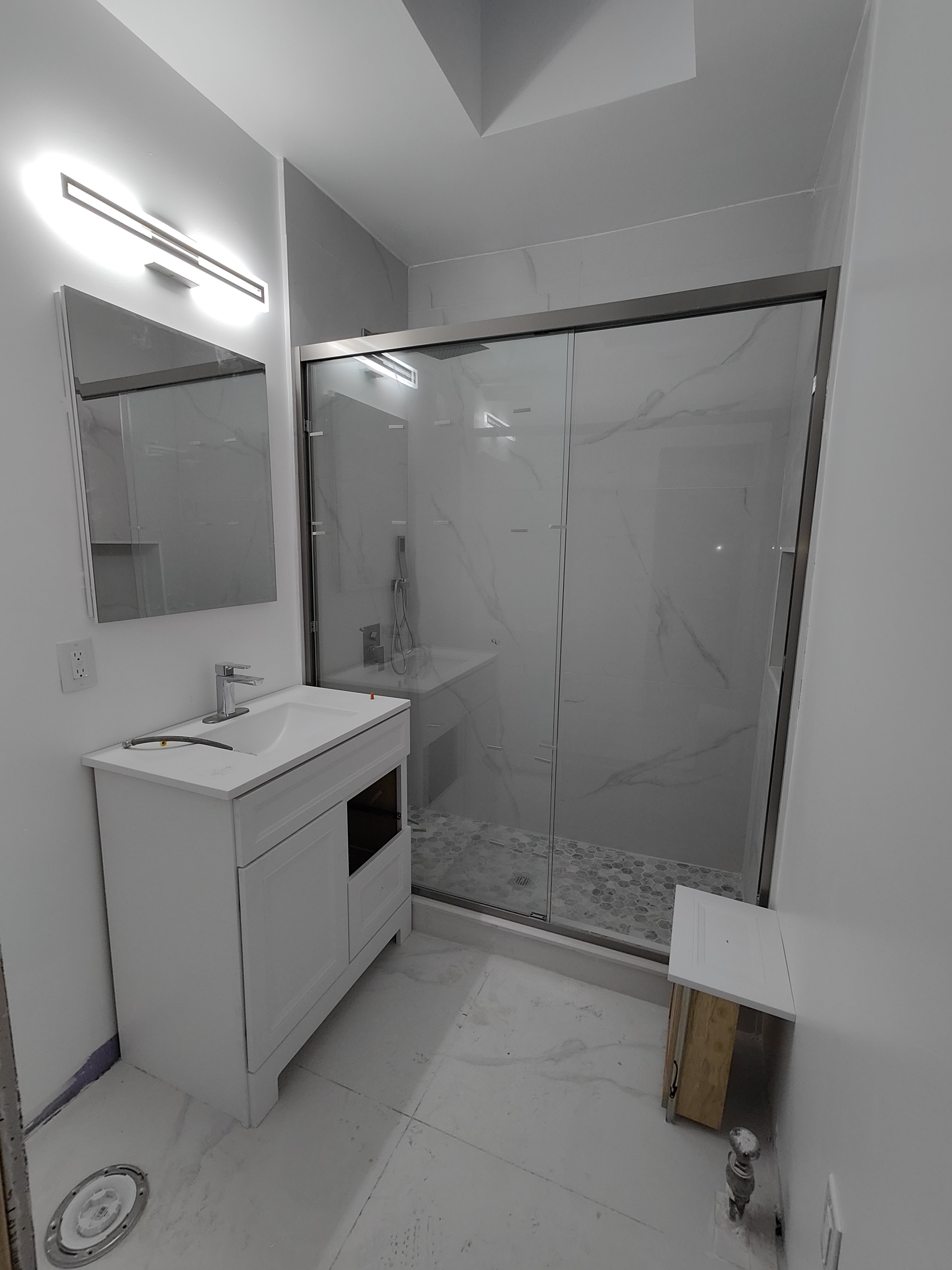

Shower drain
I was told the toilet flush might cause the shower drain p trap to lose seal, or it might work out ok. I have yet tested it out.
Hi, Two thoughts. It would be working with physics more than code, but you could add a valve to the washer drain outlet to slow it down. It would work, but's a bit of a hack…😈 The other thing is at the shower, copper pipe is attached directly to steel pipe. This will fail as the copper forces the steel to rust. It's another reason to redo the water lines… possibly in PEX.

does the connection b/t the copper and steel pipe look like propress?
Hi, The connections look like copper female adaptors screwed onto steel pipe and soldered to the copper… I'm not seeing press. How fast they fail will depend on water qualities like conductivity and acidity. In agressive water, those connections could leak in months. With nice water they could go for years. I do not think of connections like those as "workmanlike manner", which contractors are supposed to deliver.

No. It was like this
Ok. I used to think there does not exist a copper pipe with threaded connection.
He might have used Teflon or dielectric sealant b/t the steel and adapter, that may help as a buffer to slow down the rusting

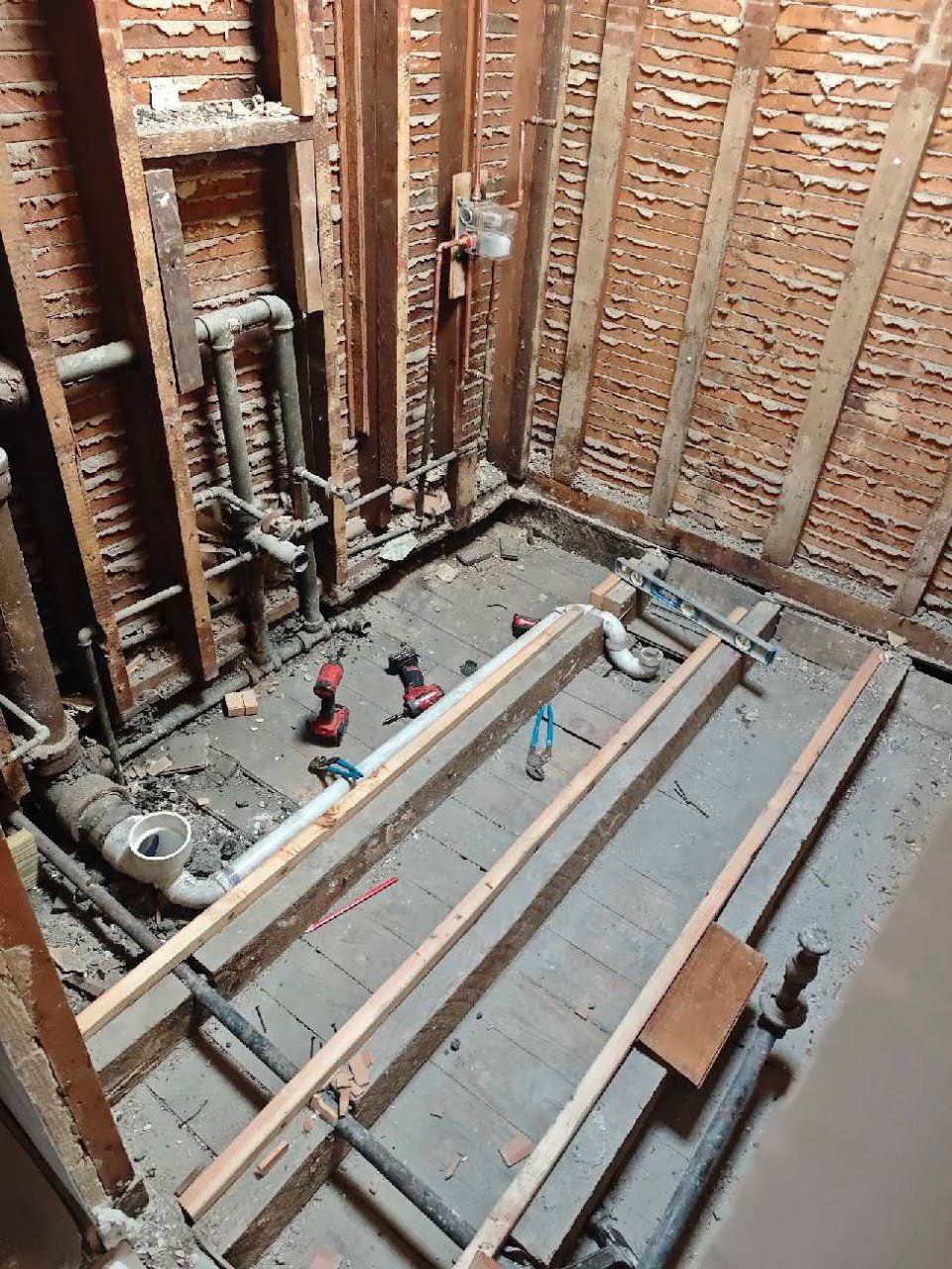

5' in two inches? Do you mean the pitch of that PVC pipe?
your joists are also essentially nonexistent, those should have been fixed before it was closed up unless there is another support system under the 1x wood.

Do you mean he opened a notch on the joist to channel the PVC pipe?
It's probably ok. You see the steam pipe also goes through notches on all the joists. These joists are secondary structural. The major beams are along their perpendicular direction. I would not do such compromise. Next time it opens, I would repair it with fiberglass and reinforcement.
the notches in the joists especially for the steam pipe means the span of the floor between the beams is essentially being held up by a couple pieces of strapping. the fix is to figure out how to route the plumbing and box out the joists to get the plumbing through or make it so the plumbing can run through a hole drilled in the middle of the joist preserving the top and bottom.

the steam pipe is as old as this prewar townhome. so ppl at that time didn't mind notching the joists for plumbing. you mean replacing those joists and reroute the steel pipe? the project is too large to justify for a prewar row house. This requires reducing the bathroom to its raw state, jack support the walls on both sides.
