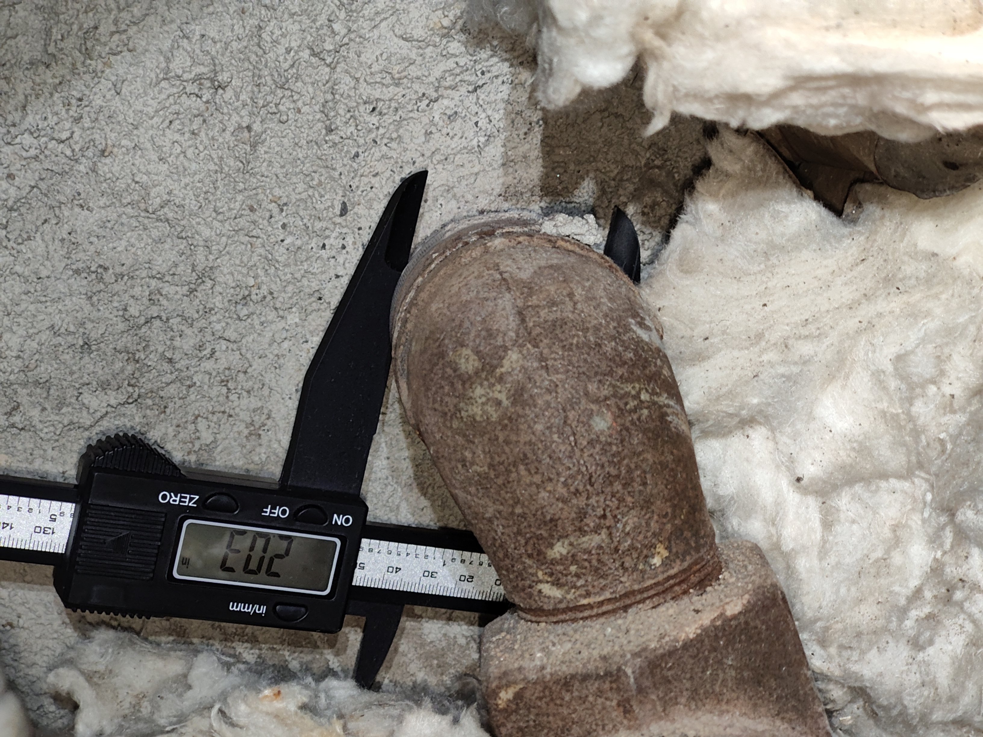

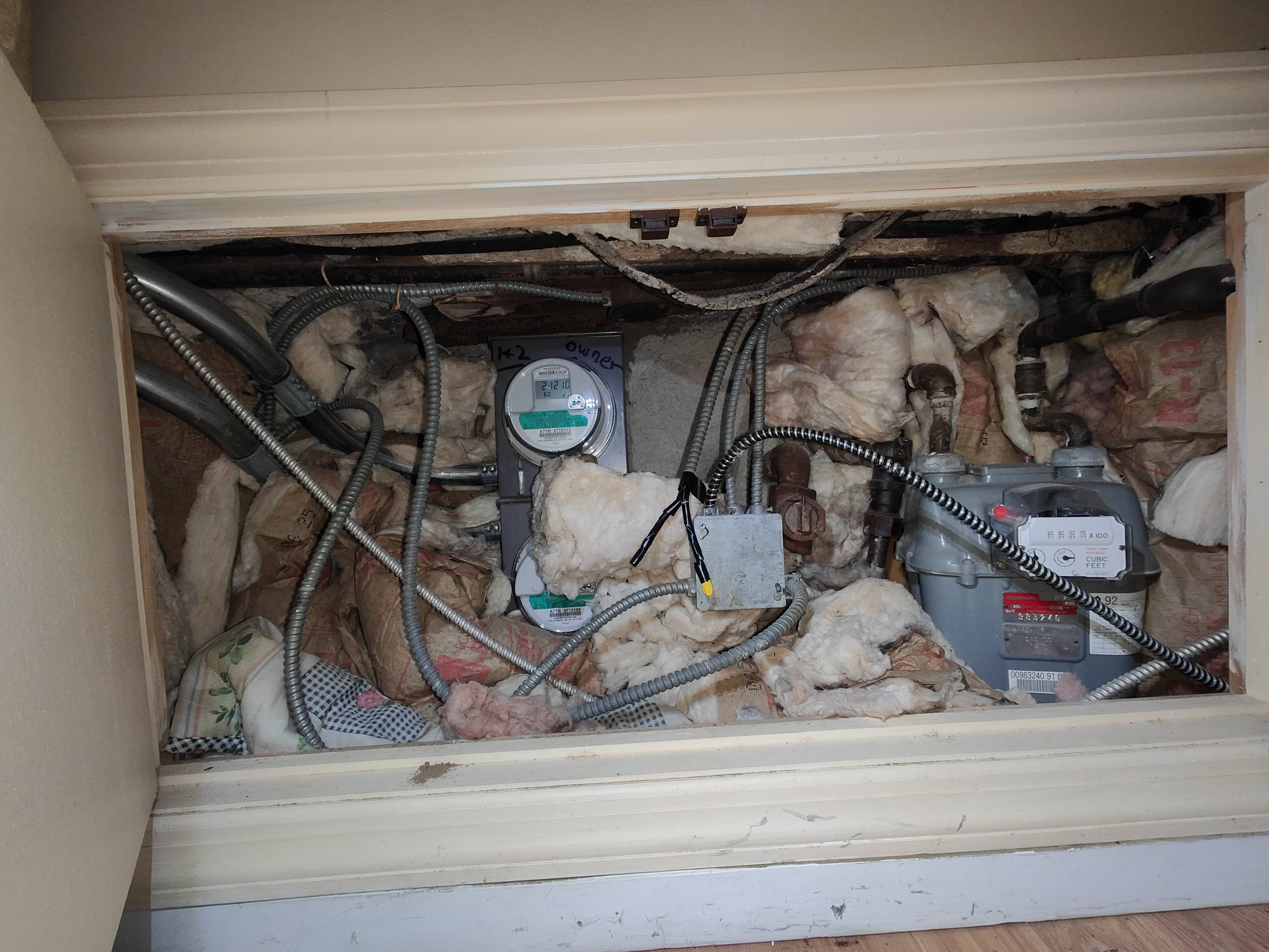

Hi, what does the material of the inlet piping look like?
The gas company told me it is cooper. so it's no longer in compliance, and therefore they need to replace it with a new plastic line

    I don't see any copper there, it all looks like black iron pipe. The one fitting with the knurling looks odd though.
    Are you sure they were talking about that piping specifically?

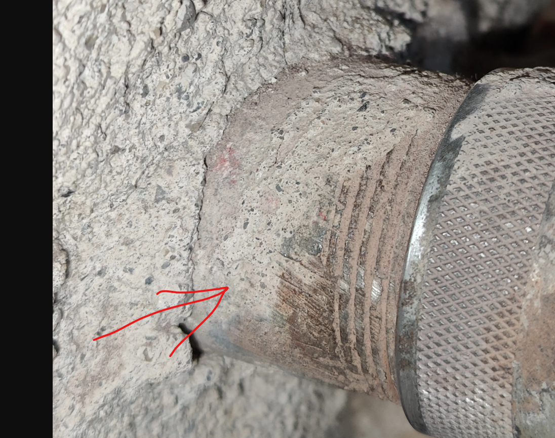

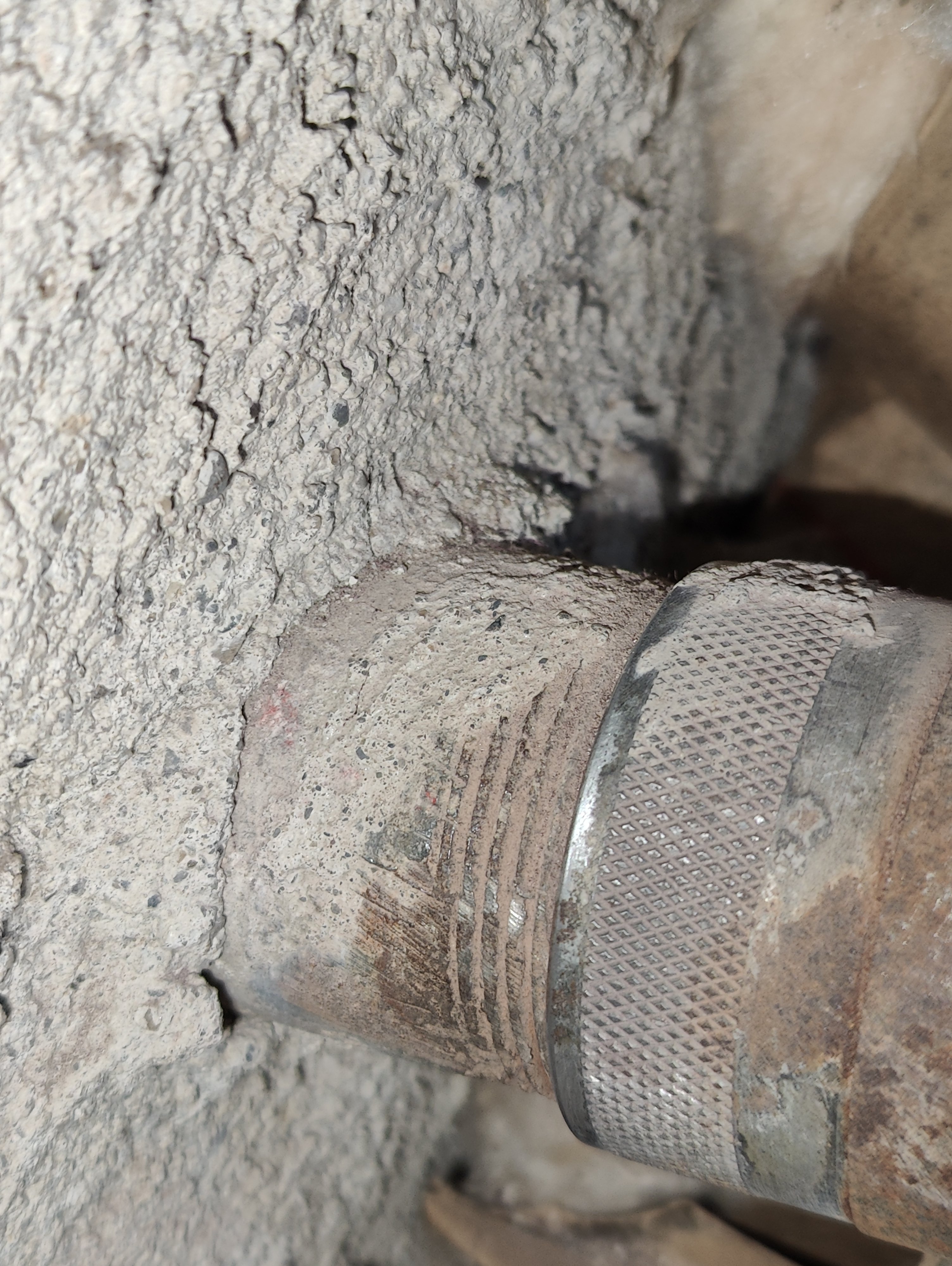

    Is that funky knurled fitting a dielectric coupling?
    Maybe that's a threaded copper pipe? Is there a such thing?
    @wayneb301
    Does a magnet stick to this pipe? Other's that know more than me will chime in, but maybe this will help them. Perhaps they know something about your incoming line on the other side of that wall that you don't.

    uncoated black iron is no longer allowed underground but it was used for decades. are they paying to renew the service or you? might ask for an explanation from their engineering if they want you to pay for it.
    @ChrisJ not sure what that fitting is but i've seen them a lot on gas services. might be a compression fitting.
  • wayneb301
    wayneb301 Member Posts: 28
    carbon steel or wrought iron is the permitted pipe material, as i checked the fuel gas code.
    does the pipe in my photo look like carbon steel?
    the gas company pays for all costs up to the point of entrance. Home owner pays for a plumber (for permit and new header installation). Not sure if the DOB inspector of the new header will bring about new headaches
    mattmia2 Member Posts: 17,226
    black is fine inside the building. black underground must be coated now. in the past bare black iron was allowed. your service should be grandfathered unless there is some weird local regulation.

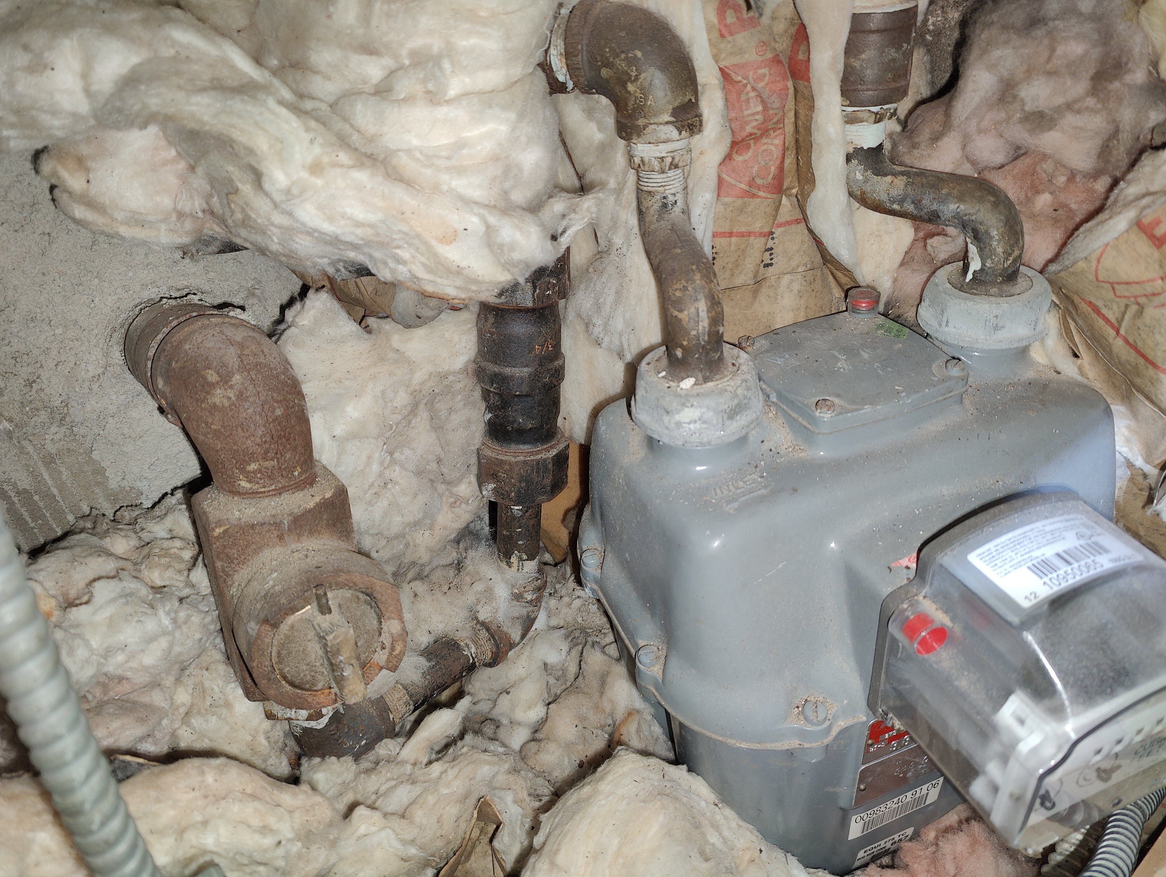

    is there a regulator buried in the insulation somewhere or does that meter have a built in regulator?
    1" iron pipe is about 1.25" od. 1.5" pipe is about 2" od.
  • wayneb301
    last time I didn't see a regulator before the meter. After the shutoff valve, the piping forms a loop then rises up and connects to the meter via a nipple and elbow

    EBEBRATT-Ed Member Posts: 20,397
    I see no copper only steel in you pictures.
    In most cases unless there is something unusual the Gas Co owns the pipe up to the meter and including the meter and the HO owns everything after the meter.
    Sounds like a snow job.
    Add up the btu load of all connected appliances and check the pipe size of the main coming out of the meter (not the meter connection size).

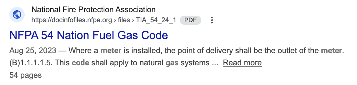

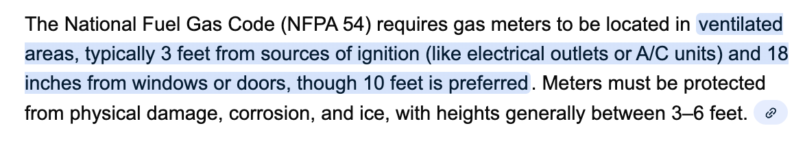

    Most all the plumbing/ mechanical code books refer to the NFPA 54 as their code, or a modification of it.
    I'm not sure a meter can be enclosed in a non vented enclosure, or the regulator typically below the meter?
    Check with the code official to see what code they use, what year version and download the section on gas meters.
    Screenshot 2026-01-29 at 9.07.28โ€ฏAM.png Screenshot 2026-01-29 at 9.07.36โ€ฏAM.png
    i don't think that meets the current working space requirements for electrical equipment that may be worked on while energized.

    That's the concern, the city inspector might add more on the list, rather than focus only on the new header
    Which is why I asked previously if the meter was to be relocated outdoors

    the inlet pipe goes under the ground of the front yard. The yellow line shows the inlet hole relative position to the window panes, the blue line showing its rough depth under the ground.
    If they are going to install a new meter, where could the new meter be located?

    I tried a magnet, that area did hold the magnet captive
    the electric meters couldn't be installed in that enclosure now. i'm not sure if the gas meter can't be there. they could pull the new poly pipe in with the old pipe or a cable through the old pipe if the meter doesn't have to be outside.
