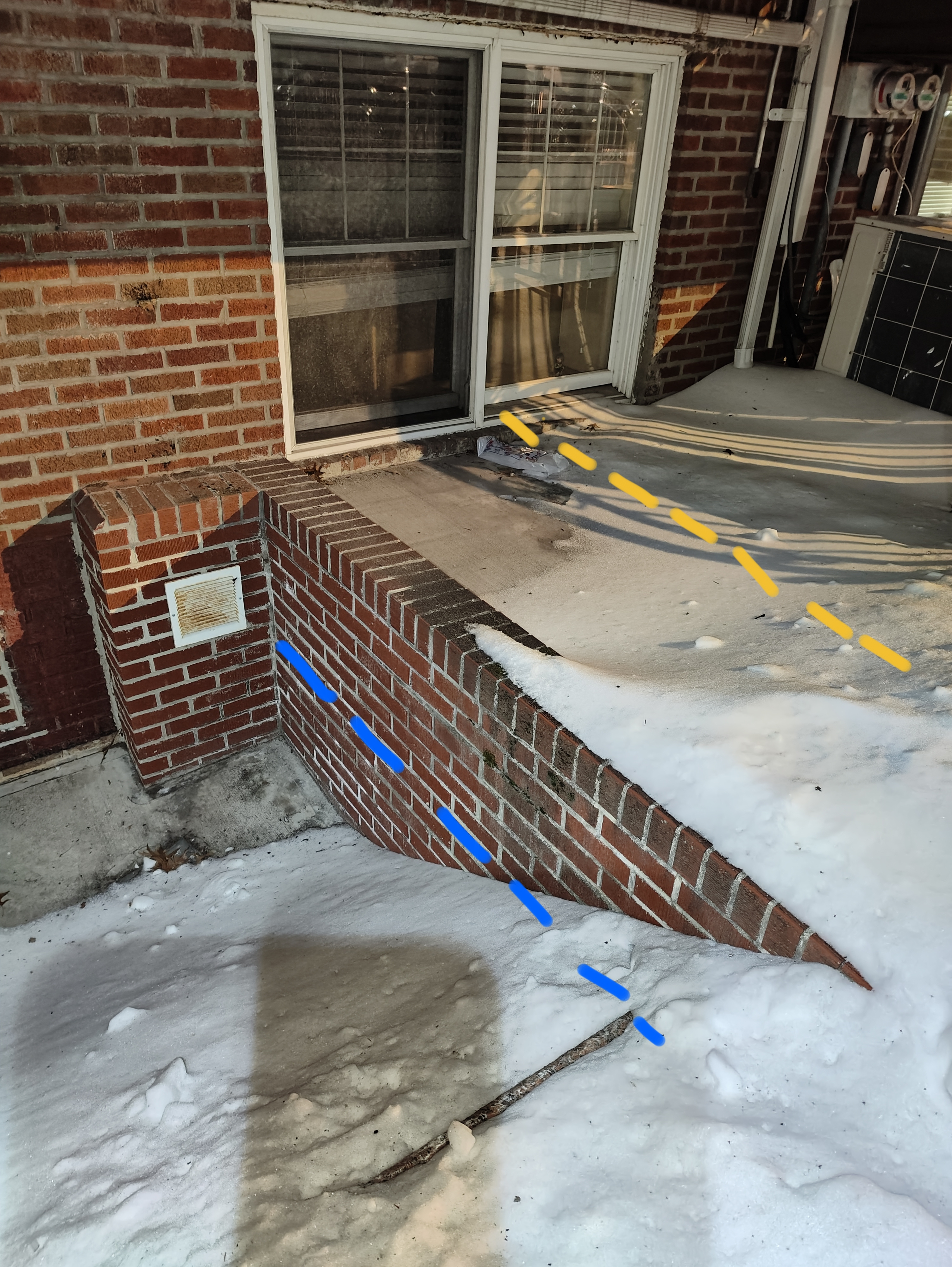

    the inlet pipe goes under the ground of the front yard. The yellow line shows the inlet hole relative position to the window panes, the blue line showing its rough depth under the ground.
    If they are going to install a new meter, where could the new meter be located?

    possible location of gas meter? left or right of that window.
