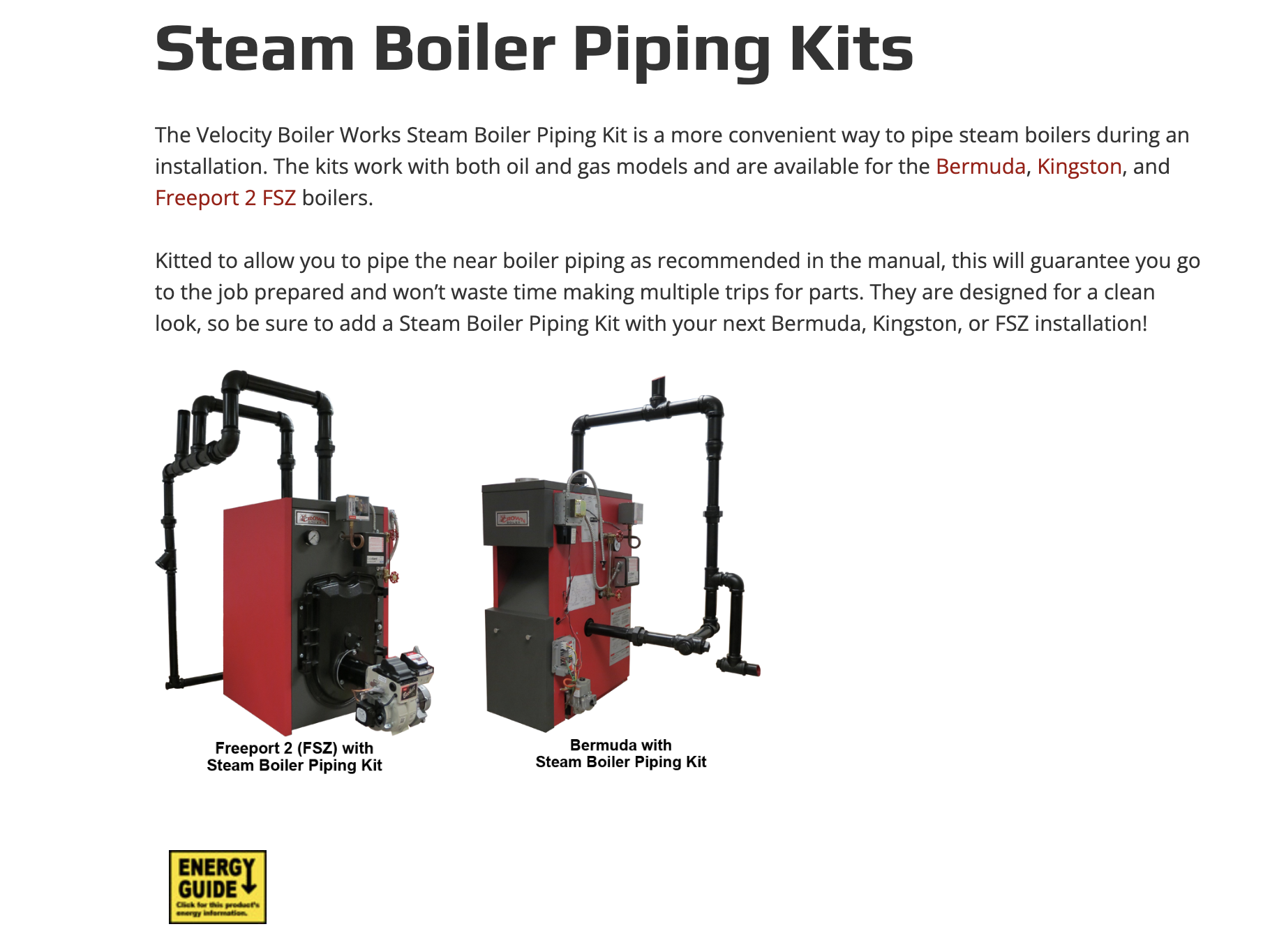

    EdTheHeaterMan Posts: 12,952
    edited January 27
    @ethicalpaul said: I installed my own boiler and I’m a wimpy computer programmer who had zero prior pipefitting experience.
    I have to agree with Paul on this. especially the WIMPY part. But all joking aside, Paul did a great job with his Beautiful Assistant (See profile Pic). Paul had made a study of his residential boiler and has ended up with some really informative videos.
    You may be able to handle your new boiler install with his help over video chat of some type.  You will need to get friendly with the local supply house and purchase the boiler from them in order to get someone there to help with all the fittings you will need for the install.
    I wouldn't mind helping you either.
    Sometimes if you want something done right , you got to do it yourself.
    EDIT:
    https://www.velocityboilerworks.com/product/steam-boiler-piping-kits/
    If you find a supplier that sells Crown Boiler (By Velocity Boiler Works in Philadelphia) they have a piping KIT that has all the pipe fittings and nipples you need to install that boiler properly. Just order the kit and put the pieces together like an Erector Set® or LEGO® project. Easier than you think.
