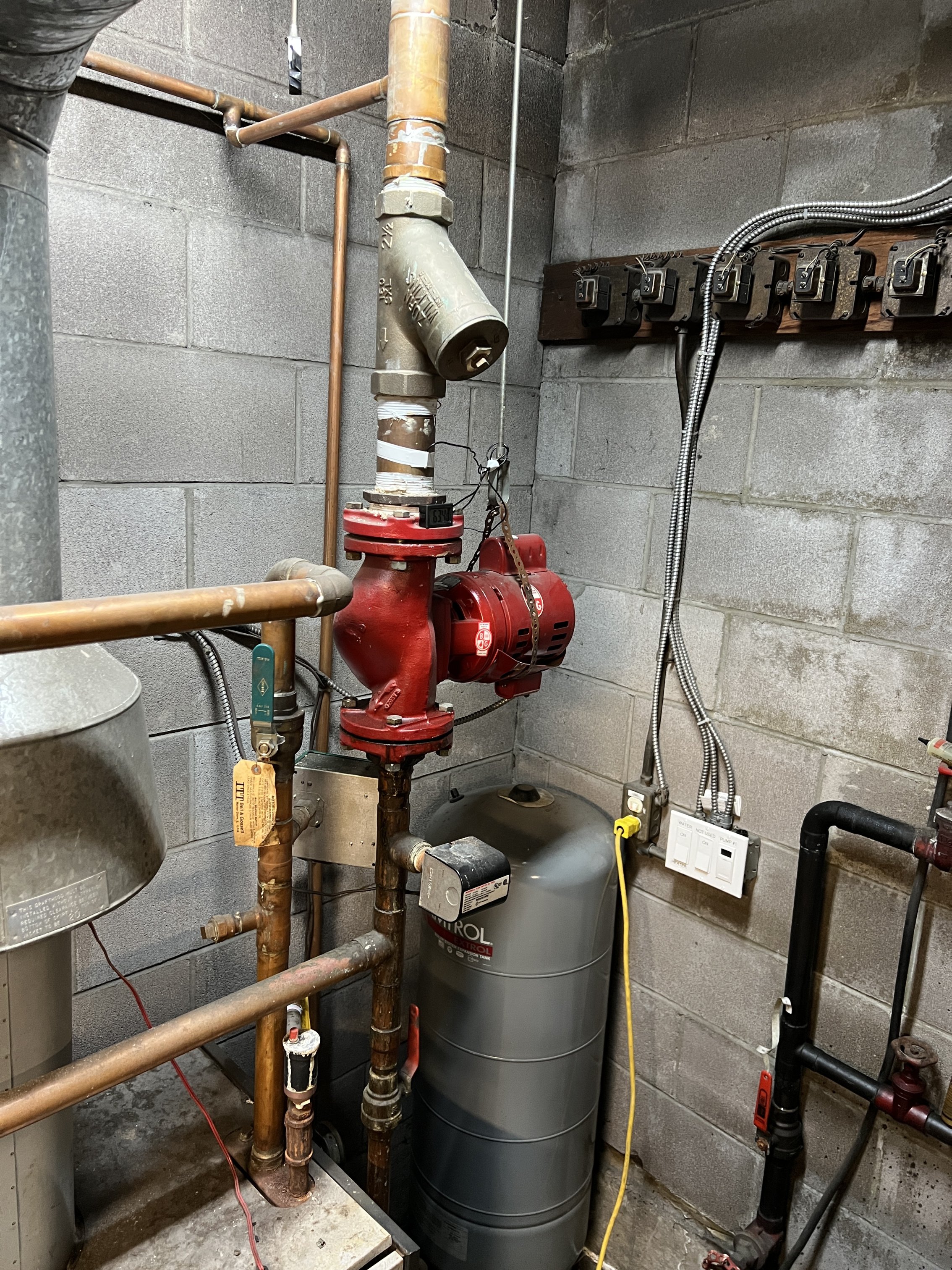

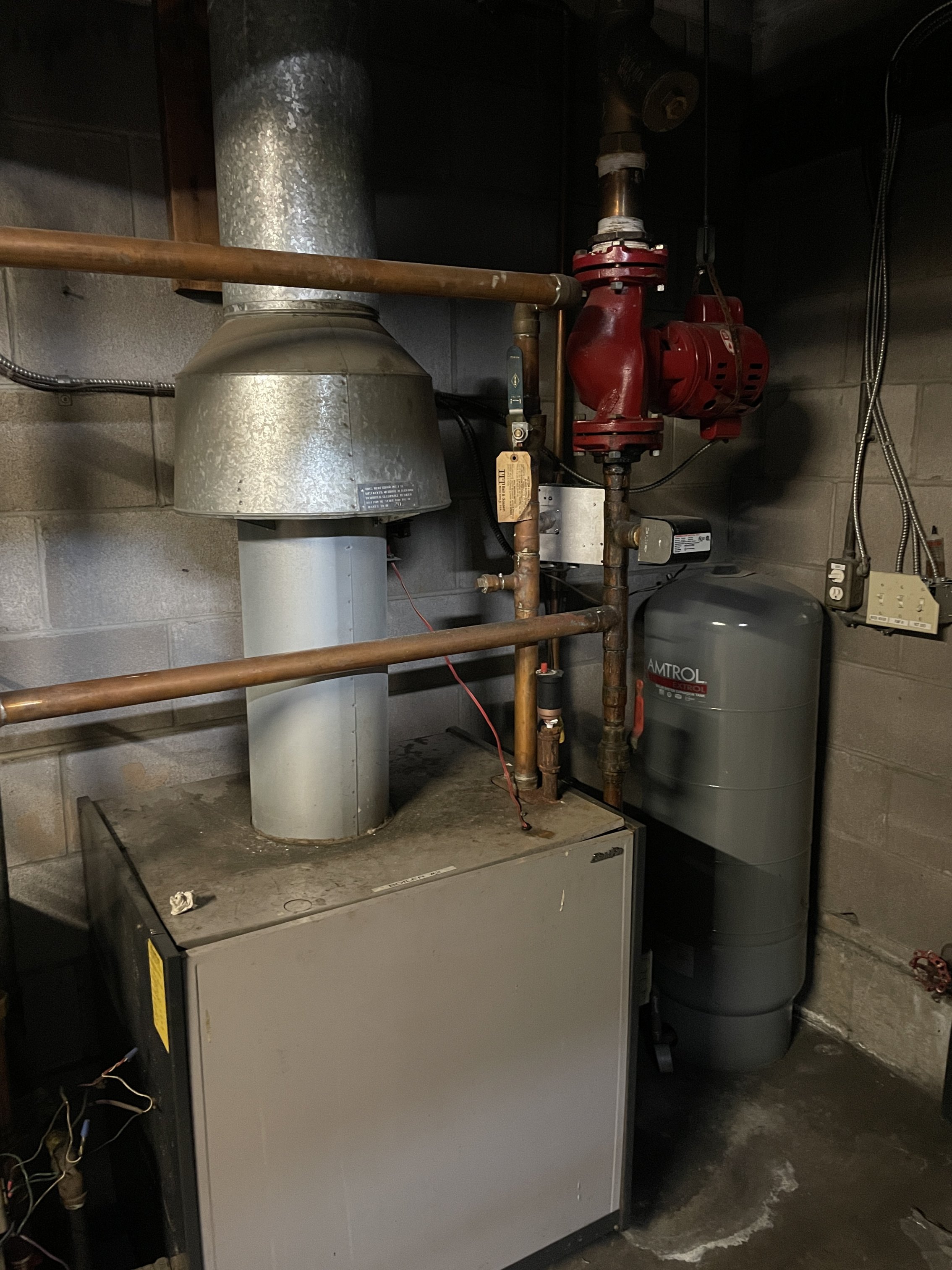

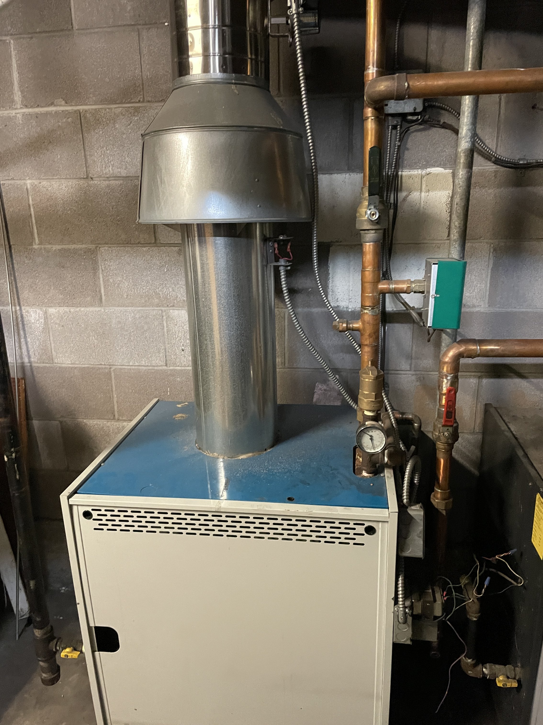

I think the install was somewhere in the early 1990s. There are two slant fin gas fired cast iron boilers each 280k output btu. The system is running at ~27psi on a 28 unit (mostly 1 bedroom) 4 story wood frame building from the late 60s. The controls just seem to be based on hi/low set points of 220/180.
Each unit has 3/4 copper pipe with radiant fin baseboard heaters.
Building seems to run hot. I put some surface mount temperature probes on the return pipe to the boilers and the output pipe from the boilers. The output shows as 155F ( 68.3C ) and the return shows as 150F ( 65.8C ) giving a delta T of 5F which doesn't seem good. Also note that since these are surface mount probes I'd guess the water temp to be at least 18F higher than measured.
I am thinking a better boiler controller maybe a tekmar would be the ideal option to get closer to a 15F delta T. In the meantime should I adjust the set points for the boilers such that the water can get colder before the boilers are firing up and is only heated to a lower temperature before being distributed to the hydronic supply piping? Maybe 200/160?

    A picture of the near boiler piping would show how the system is piped, where flow goes as zones close off.

    I'll grab some pictures of the piping to get a better sense of how it is piped.

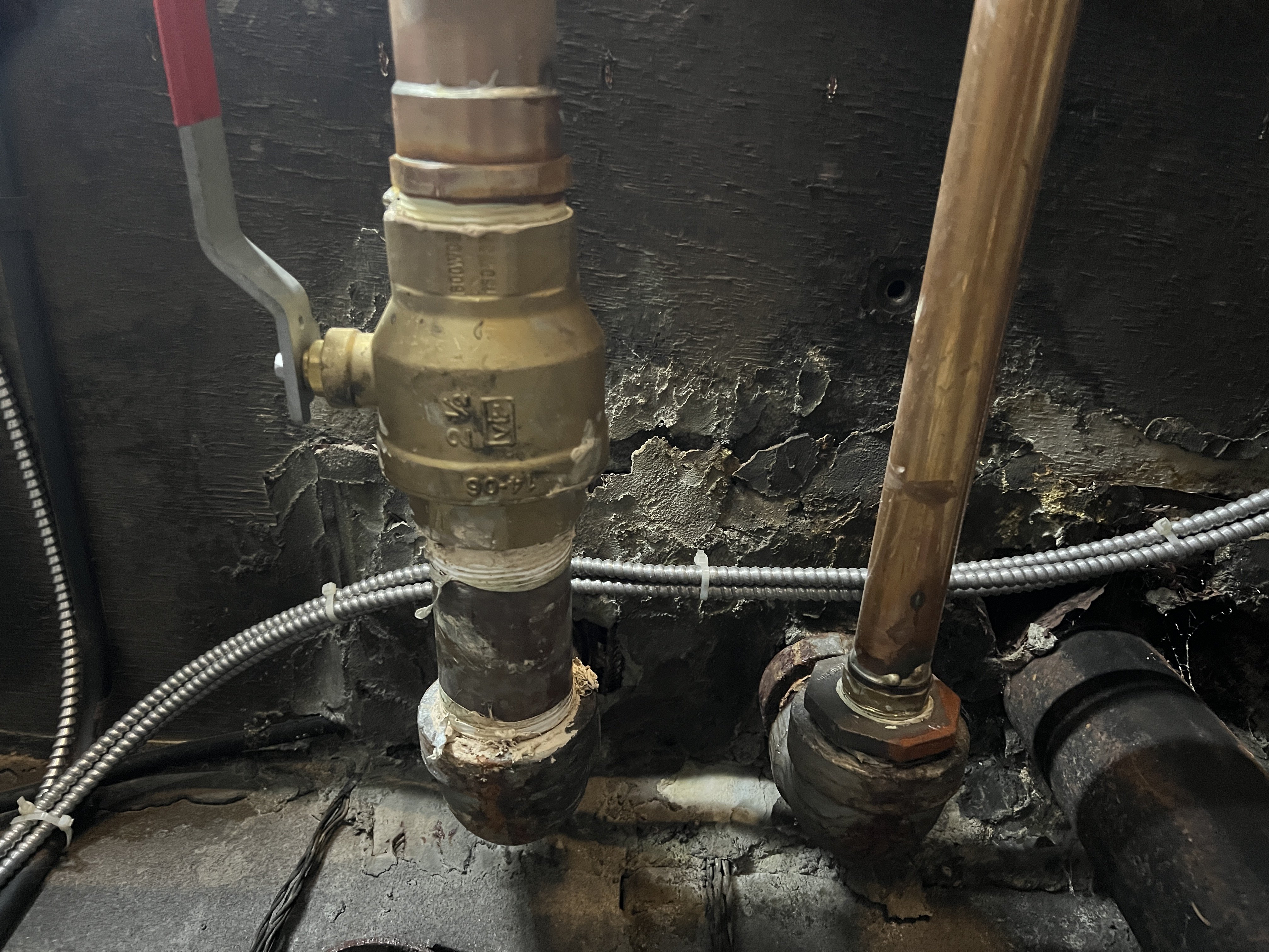

    PS @hot_rod as long as no snowmaggedon again this weekend maybe you can splain the pressure activated bypass for me or point one out in vegas. never seen one. used to have an early ODR style electric proportional bypass valve but with a bulb outdoor sensor on the system i mentioned above when i ninherited it with a million btu oil burner. that boiler was installed in 1969. i did take the DHW off it but the i'm doing it with two 140M munchkins and direct temp ODR these daze.
  • archibald tuttle
    archibald tuttle Member Posts: 1,191
    thats some pretty crazy near boiler piping. best i can tell the boilers are parallel on 1" for the near boiler except a 1 and 1/4 cross on the feed to the left hand boiler. i assume out of the picture on left hand boiler the pipe increase to 2" so this constriction is for short run but you'd have to have some serious velocity in that near boiler piping to handle 80% of the nameplate on those 2 boilers.
    can't see where the PRV and expansion are connected so hard to tell if it is pumping away and that might also explain high operating pressure. with 4 stories I would always operate mine up in the mid 20s although i had the pumps on the feed so it actually would show 30 leaving the pumps for the system but would return with pipe loss around 25. so i had to charge the expansion tank up to accomodate and because it was constant on i didn't blow off the relief virtually ever even though i was theorectically close.
    on the one hand parallel circ is going to cut down cold starts when calling the second boiler but usually i might see something like this as primary secondary. and you could cut down on your system pump while you would have to add boiler pumps. with modern pumps you'd spend some money but save electric.. doubt it would payback in electricity but if it contributed to better control and comfort for less energy could be worthwhile.
    in a way though, those pictures demonstrate how almost anything will work cause it seems like its been that way for some time and aside from the balancing problem it works. still don't see any pictures and don't know if you have any access to see how this main manifolds to the individual units or if this 2 inch main disappears and returns but these unit connects are all hidden (and presumably not active by way of zone valves, nevermind say manual isolation valves if you had to work on one unit).
    i doubt you're going into the unit by unit heat exchangers but if you want to use ODR with baseboard, you can't have enough fin. where I can i used the higher 'commercial' baseboard and put two runs of fin tube in it. but much of our hydronic insyallked base goes back to the days when they designed for 180 degree water to heat the place so they didn't even always put one full run of fin in each enclosure. when i started it was only my economic instinct that stopped me from doing that. it was almost the same price to buy enclosure and pipe as to buy enclosure and fin tube so i reckoned if a room was too warm they could just close the vents on some of the enclosure. in the end those places with lots of fin have proven much more resilient to ODR approach although the drop off in output is geometric not arithmetic. between that and having to guard return temps (something you could modestly ameliorate with a close loop primary secondary or storage tank) you don't get as much flexibility.
    but not inconceivable if you are short cycling in shoulder season even with only a single boiler running to two stage those boilers.

    Ok so a little more looking at the system.
    Boiler controls are set to 180/160.
    System pressure is 27psi, the expansion tank measured to 10psi (with shutoff enabled). Tried a bicycle pump to increase pressure but wasn't effective do you generally need to use a compressor for larger expansion tanks like this?
    The pump is pump away from the expansion tank but the expansion tank is connected via 1/2" or maybe 3/4" pipe from the 2.5" line.
    The return pipe is 2.5". The output pipe from each boiler is 1.25 but that doesn't enlarge until it hits the main pipe that is going to distribute to the building. I assume there is a perpendicular trunk that then branches to 3/4 lines that then feed vertical stacks of units. Assuming each 1 bedroom unit has 20' of baseboard would a 3/4 line be enough to feed 3 units? Possible there are only 2 units stacked.

    It looks to me like the expansion tank is piped into the 2.5" return above the pump, and the pump is pumping the 2.5" return down into both boilers. That is "pumping away" from the tank as you say, but it's pumping "towards" the boiler. That means that the pump is adding 17 psi to the 10 psi static pressure in the tank to get 27 psi in the boiler. So don't add any pressure to the tank, because whatever pressure you add there will reduce your already slim 3 psi margin on blowing the 30 psi relief valve.
    Also, beware that those boiler pressure gauges can be off by 5 psi or more. So you could be even closer to the 30 psi relief valve setting than you think…or farther. Best to put a known good pressure gauge on a drain fitting somewhere if possible to get an accurate reading.
    As for the 3/4" pipes, at max recommended GPM and 20 degree delta T, a 3/4" pipe will deliver 40,000 BTU/hr. So 20,000 BTU/hr for two units, or 13,000 BTU/hr for three units. You say each unit has 20 feet of baseboard, which is good for about 11,000 BTU/hr. So the 3/4" pipe should be OK. Proof of the pudding is if the units are warm enough in winter. If no one is complaining, the pipe sizes are OK.
