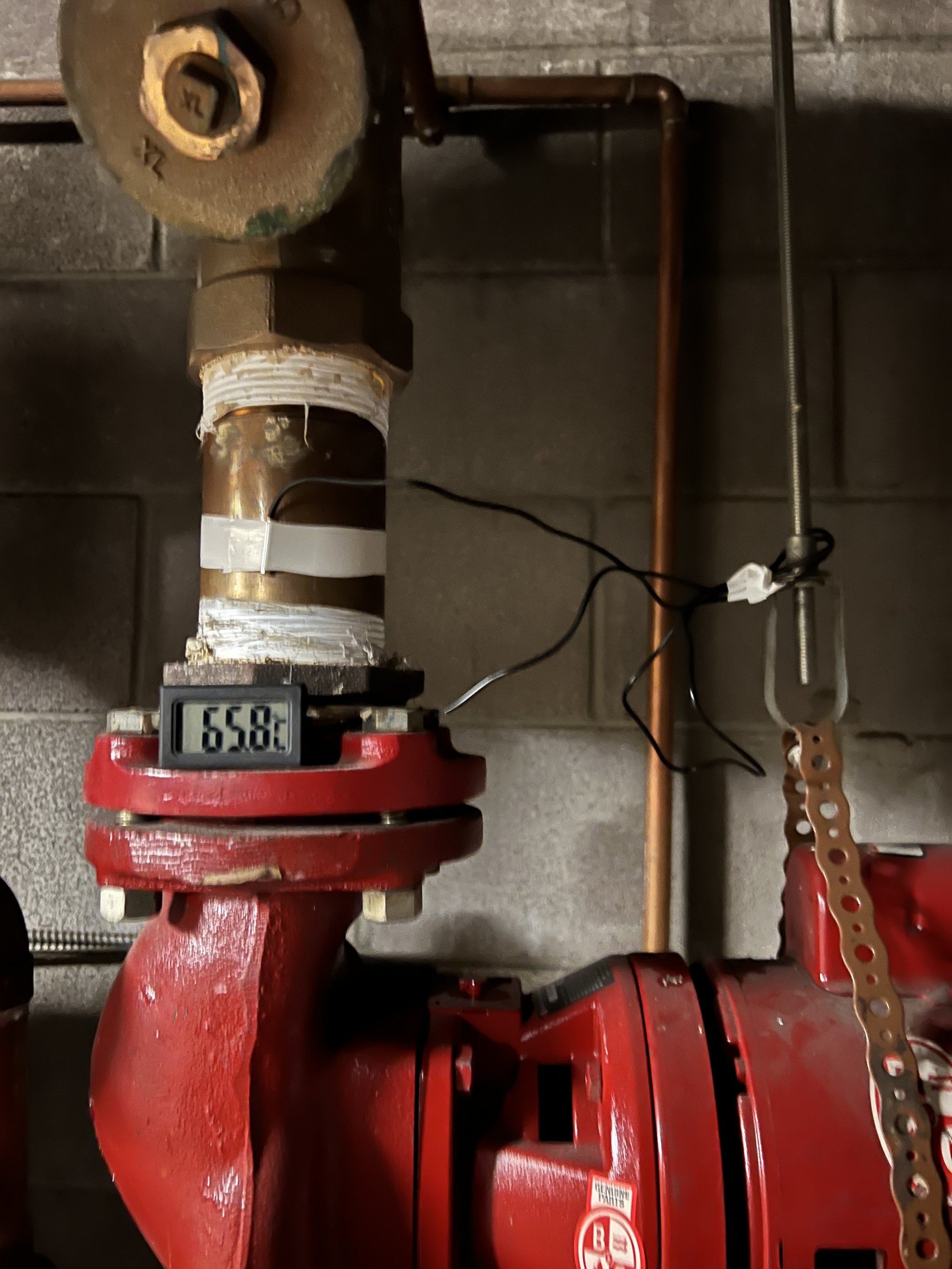

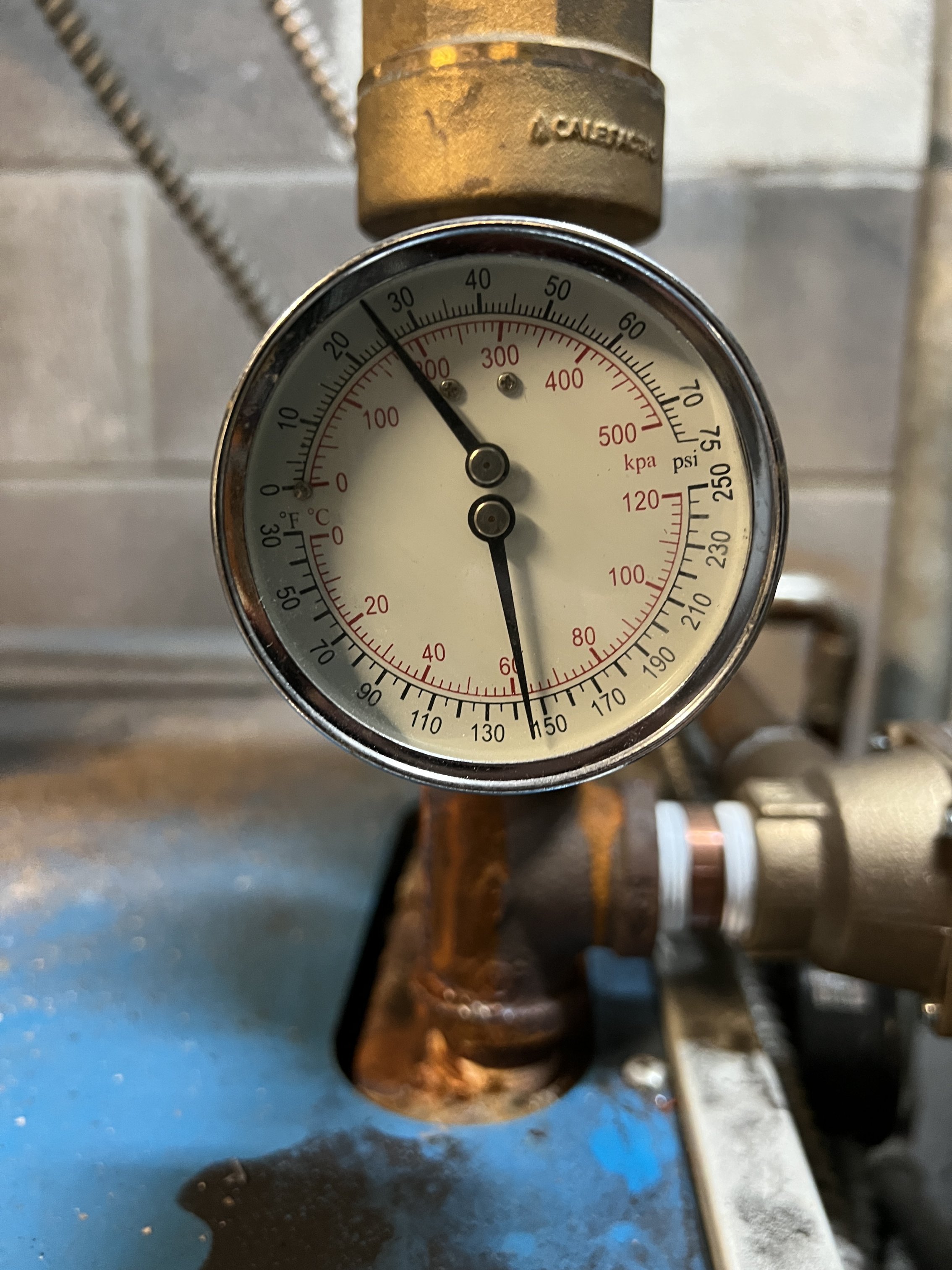

I think the install was somewhere in the early 1990s. There are two slant fin gas fired cast iron boilers each 280k output btu. The system is running at ~27psi on a 28 unit (mostly 1 bedroom) 4 story wood frame building from the late 60s. The controls just seem to be based on hi/low set points of 220/180.
Each unit has 3/4 copper pipe with radiant fin baseboard heaters.

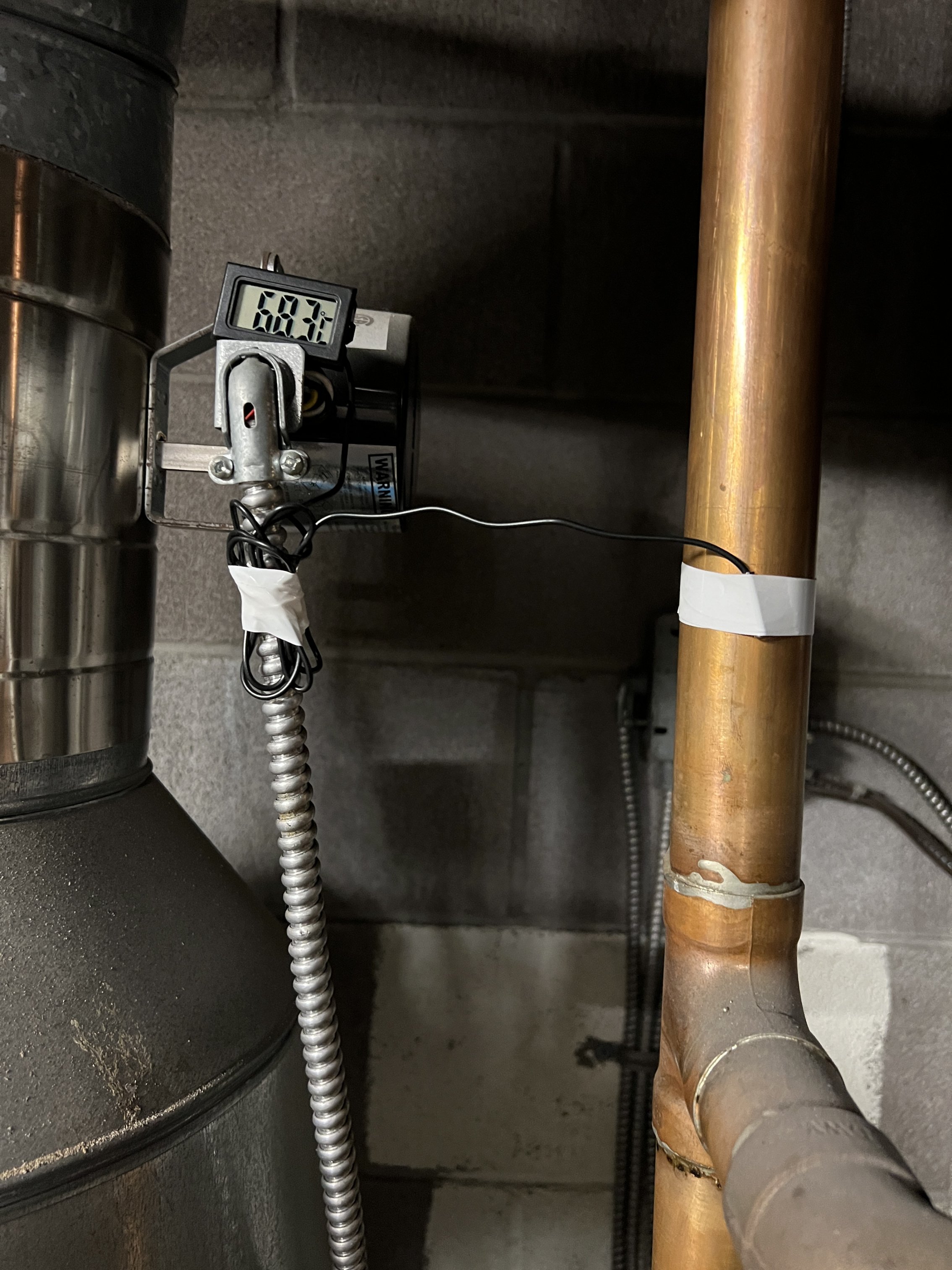

Building seems to run hot. I put some surface mount temperature probes on the return pipe to the boilers and the output pipe from the boilers. The output shows as 155F ( 68.3C ) and the return shows as 150F ( 65.8C ) giving a delta T of 5F which doesn't seem good. Also note that since these are surface mount probes I'd guess the water temp to be at least 18F higher than measured.
I am thinking a better boiler controller maybe a tekmar would be the ideal option to get closer to a 15F delta T. In the meantime should I adjust the set points for the boilers such that the water can get colder before the boilers are firing up and is only heated to a lower temperature before being distributed to the hydronic supply piping? Maybe 200/160?

    is that a 50psig boiler? your pressure is high for a 30psig boiler but the height of the building might need something close to that pressure. some math shows that even if the highest emitter is 40 ft above the boiler you only need a little over 20 psig to reliably fill the highest emitter.

    you need to get better temperature collection if you measure 150 but think it is 180?
    The surface probes work well if tightly fastened and covered with a piece of pipe insulation or foam.
    When the delta is measured is important, are both boilers running, how many zones are calling?

    That delta T…if it's really only 5 degrees on a 280,000 BTU output boiler, it implies a flow rate of over 100 gpm… ???
    You can get very accurate temperature readings by wrapping black electrical tape around the pipes and shooting the tape with a $15 IR thermometer. I've checked that method against a $300 thermal imager, and the $15 IR thermometer is within 1%.

    They are 30psig boilers. I could try lowering the pressure. The pipes are black iron for the most part from the 60s. Leaks have happened and portions replaced. No dirt mags on the system.

    I think the reading is accurate for the exterior surface temperature of the pipe. If you were to put a temp probe that is in the middle of the water flow from the boiler that is heating to 220 I'd expect a reading closer to 220F.
    I have one of these surface temp probes on the output of the domestic transfer tank and it reads 57.5C while the temp probe that is in the water column reads 65C.

    I'll have a better look at the delta T conditions when I measure it. They were both running some of the time but also when just one was running. I tried to wait for the boiler to have been running for a while so I can see the max temperature of the boiler output and I suppose also the maximum coming back into the return.
    Since there is only 1 zone in the system, there was one zone calling for heat. There are 22 thermostats but I am pretty sure they all just come down and pig tail into one give me heat call. I'll take a closer look when I am out there next.

    System pressure is 27psi, the expansion tank measured to 10psi (with shutoff enabled). Tried a bicycle pump to increase pressure but wasn't effective do you generally need to use a compressor for larger expansion tanks like this?

    It looks to me like the expansion tank is piped into the 2.5" return above the pump, and the pump is pumping the 2.5" return down into both boilers. That is "pumping away" from the tank as you say, but it's pumping "towards" the boiler. That means that the pump is adding 17 psi to the 10 psi static pressure in the tank to get 27 psi in the boiler. So don't add any pressure to the tank, because whatever pressure you add there will reduce your already slim 3 psi margin on blowing the 30 psi relief valve.
    Also, beware that those boiler pressure gauges can be off by 5 psi or more. So you could be even closer to the 30 psi relief valve setting than you think…or farther. Best to put a known good pressure gauge on a drain fitting somewhere if possible to get an accurate reading.

    Are you sure you're reading 27 psi and not 27 feet of head? Some gauges show both units. If it's 27 feet of head, that would make more sense, because that equals about 12 psi, which would be more consistent with the 10 psi in your tank.

    Seems like psi? This pic reads closer to 25. I'll check the pressure in the tank again and I'll bring out my hose bib pressure tester.

    Yes, that's 26 psi. Is that with the pump running? The pump is pumping away from the expansion tank down into the boilers, so the pump head is being added to the static pressure supplied by the air in the tank. If the pump is a Bell & Gossett 1/4 hp 2.5 pump, it can only add 6 psi max (at zero flow rate, which is not what you have), or more likely around 3 psi at reasonable flow rates. So if your 10 psi in the tank is accurate, even with the pump running you wouldn't have more than 16 psi in the boilers, and probably more like 13 psi.
    Before you break out the hose bib tester, check the pressure gauge on the other boiler. It's facing the expansion tank. If it's also reading 26-ish, I'd believe the gauges. Then the question is why your expansion tank only reads 10 psi. Are you sure your air pressure gauge is accurate?
