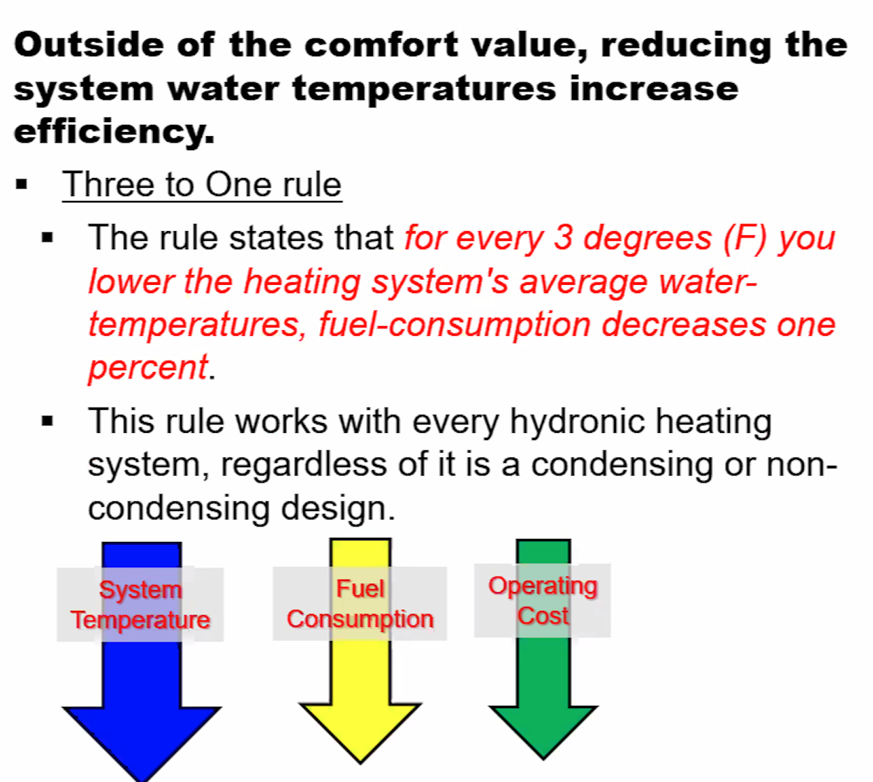

Building seems to run hot. I put some surface mount temperature probes on the return pipe to the boilers and the output pipe from the boilers. The output shows as 155F ( 68.3C ) and the return shows as 150F ( 65.8C ) giving a delta T of 5F which doesn't seem good. Also note that since these are surface mount probes I'd guess the water temp to be at least 18F higher than measured.
I am thinking a better boiler controller maybe a tekmar would be the ideal option to get closer to a 15F delta T. In the meantime should I adjust the set points for the boilers such that the water can get colder before the boilers are firing up and is only heated to a lower temperature before being distributed to the hydronic supply piping? Maybe 200/160?
180 is usually the design setpoint in small modern systems.

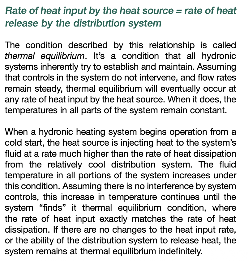

Ideally the system needs to run for a period of time to allow temperatures to stabilize to get system delta accuracy

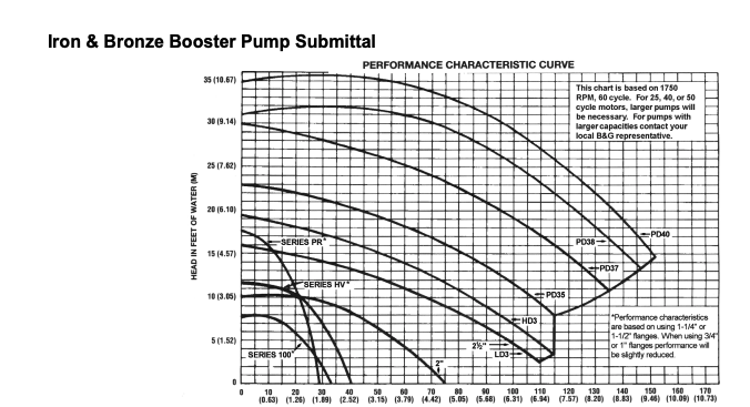

The pump is pretty massive on the 2" return line. 1/4 HP, 1725 RPM, AC. Not sure on what the flow would be.

On a 280,000 BTU/hr output boiler running a delta T of 5 F, that implies a flow rate of 112 gpm. In a 2-inch pipe, that's a flow speed of about 10 feet/sec. I'm not a pro, but a pro might say that's too high as above 6 ft/sec can erode copper.
So the low delta T and the high flow rate suggest you probably have a bigger pump than you need. Maybe not worth worrying about. On our smaller boilers we also had higher flow rates than necessary, so I reduced our flow rates by putting triac-based speed controls on the Taco 007 circulators. That slowed our flow rates from 17 gpm to 10 gpm, and raised delta T from 12 to 20.

I don’t know that 1/4 hp circ is moving 100 gpm, 25- 28 gpm flow through a 280k boiler would be typical

Ultimately it comes down to simple math. Heat loss of the building on a design day must be equal to the output of all the radiators at a given supply water temp. You should be able to gradually dial down the hi limit until you find that balance point. Then maybe go back up 10 degrees or so for margin.

Two pumps on this chart are the 1/4 hp model, either the 2-1/2 or the HD 3 theses are considered flat curve circulators ideal for zone valve systems.
Ideally a circ runs mid curve so you would be pumping 40- 60 gpm range. Those two boiler at 80% is 448,000 btu/hr available. So that 40- 50 gpm range seems about correct.

If you are looking to make the system more efficient I agree the ODR control could maybe run the boiler at lower temperature for some, maybe much of the season.

Don't get too hung up on delta T, it will be constantly moving in hydronic systems as the loads are constantly changing. This is an important condition to know. With 22 units that delta will vary quite a bit. The heat emitters driver the operating condition of the boiler, temperatures and ∆s

It makes sense that the delta T isn't going to be super helpful with 28 units and is going to very based on season.
ODR control and variable pumps are likely to be the easiest upgrade path. I'll mess with a lower set point. Fairly close to design temperature days atm. Do buffer tanks ever make sense to keep the boilers from short cycling? I'll watch the system for a bit and see if I can get a sense of the cycle time for each boiler. The boilers are in parallel - now that I look at the pictures closer.

ODR on a cast boiler will have some limitations, you may not go much below 155- 160 or so to assure the return temperature rises above 130F.
You might just crank down the current control to 170, 165 see how often the phone rings :)
