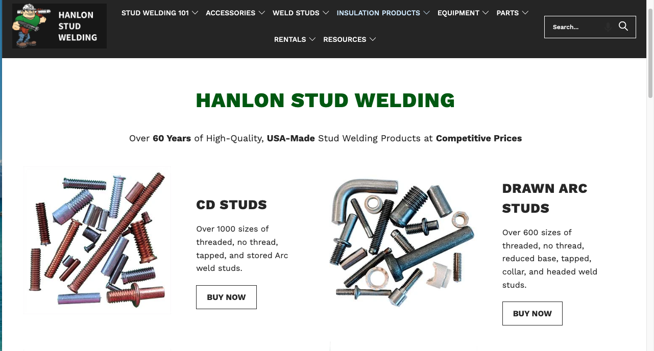

    hot_rod Member Posts: 28,011
    The only concern with overhead radiant tube is they are line of site, So you would not feel much heat sitting at a bench or desk, etc. Whereas the floor system would warm wherever you chose to place the tube.
    A Hilti gun could shoot pins into the steel or concrete and just condiut clip the tube to the bottom of the steel that the concrete is poured on.
    No need to add $$ transfer plates of you have the transfer plates already built in. You can also get a stud welder tool to attach threaded studs, to the metal decking.
    I'd use a Pex Al Pex for more rigidity between clips.
    The R-value of 8" concrete is about the same as 3/4 plywood with 5/8" hardwood flooring. The thermal mass "flywheel" effect could be mitigated with ODR.
