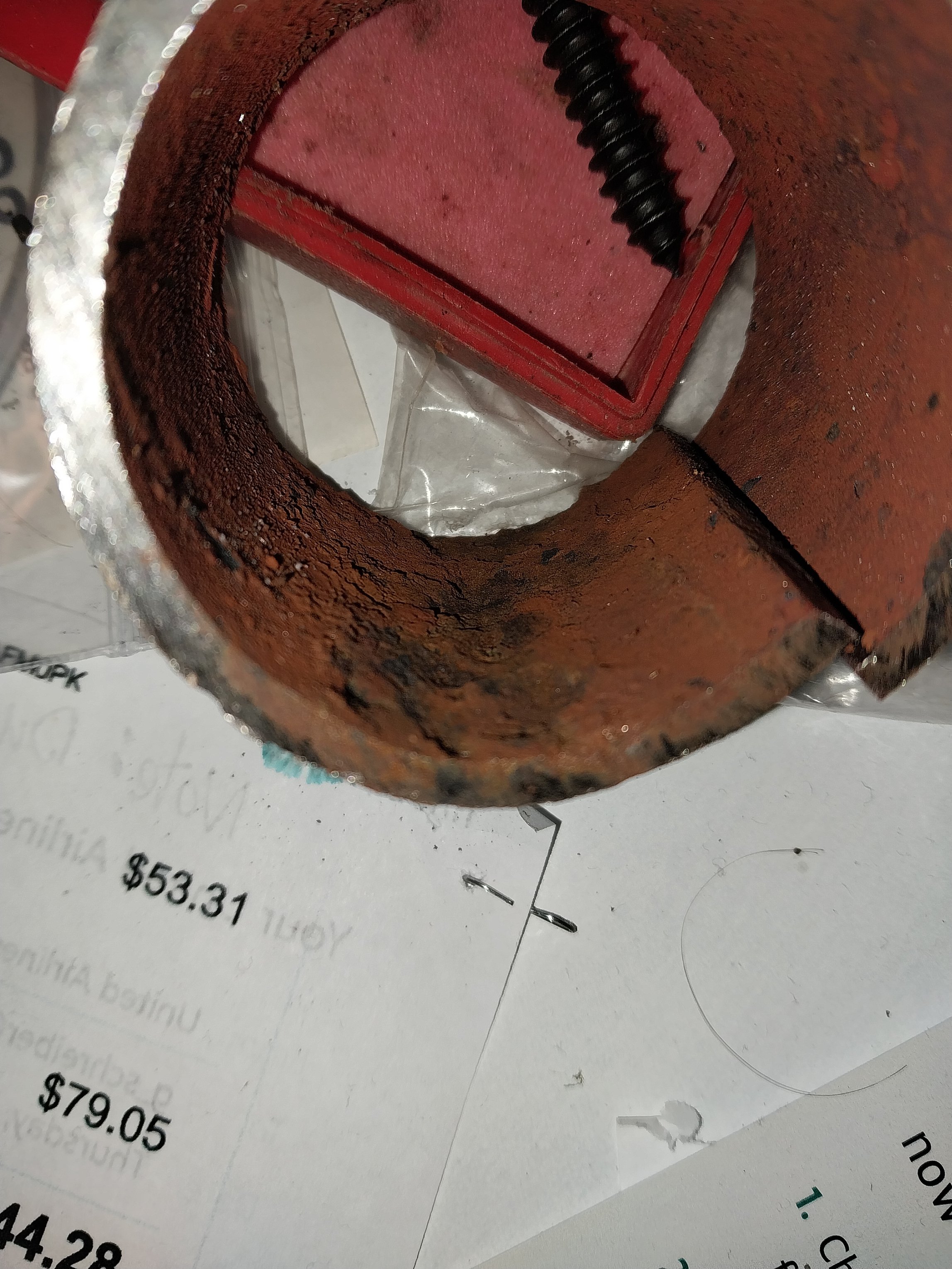

Do you think that Rectorseal 8-way can protect steam mains at all? They say it does but I'm skeptical unless there is a lot of carryover. Otherwise it should be distilled water I believe. Here's what 100 years of corrosion inside a steam main that is not pitched correctly looks like. This is the downstream end of a 16 ft. section that went into a Tee for the riser to an upstairs radiator and what it looked like after I cut through it and chiseled it out. Kept it as a souvenir. Even if it is basically distilled water I would think that it would absorb CO2 from the air in the main and create some carbonic acid. But it is obviously very hot and would limit absorption. In the off season I had cool distilled water pooled up in there and saturated with air containing CO2. Would be interesting to know what the pH was. Anyway, you can see that this main rotted out at and below the waterline and there is lots of meat still on the pipe in the upper areas.
No, I don’t think 8-way protects the mains. I have thought about carryover helping but given that even a sagging, rusting main lasts 100 years, it hardly seems worth it to consider.
These pictures show corrosion on upstream end better. I'd estimate 1/2 way through penetration at the worst spots. Uneven corrosion must be due to localized differences in alloy composition, and once the pitting corrosion starts a self perpetuating small pool of water exists. Definitely a different situation from boiler corrosion with treated water and mostly de-aerated water and "maybe" some protective effect from scale buildup.
