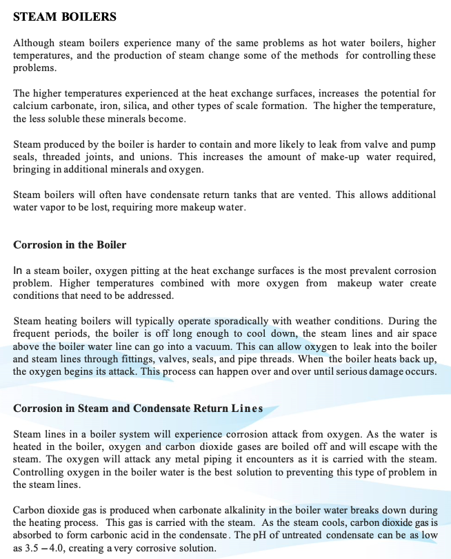

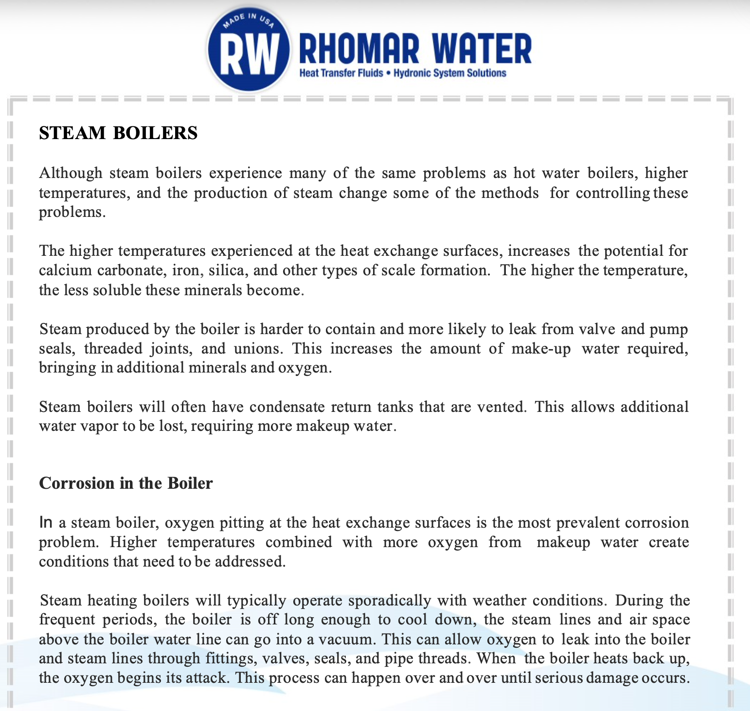

    Steam specific manufacturers refer to mechanical deareation ad chemicals with sodium sulfite O2 scavengers, and ph control. So as @ethicalpaul suggests treating the steam boiler is just as important, maybe more so, as treating a hydronic boiler.
    Some info from the Rhomar manual
    Screenshot 2026-01-16 at 12.09.23 PM.png Screenshot 2026-01-16 at 12.12.00 PM.png

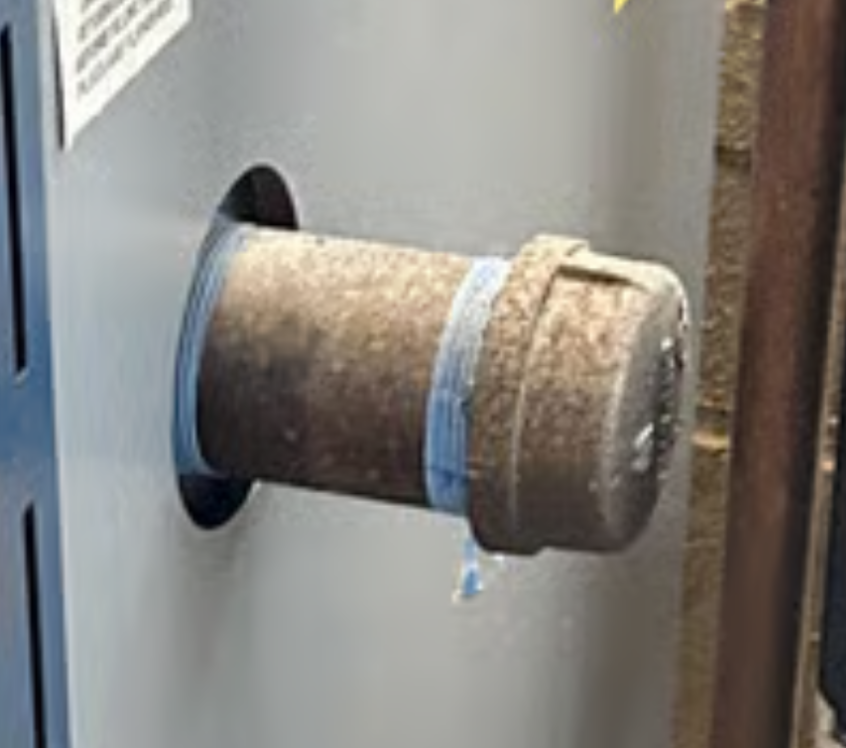

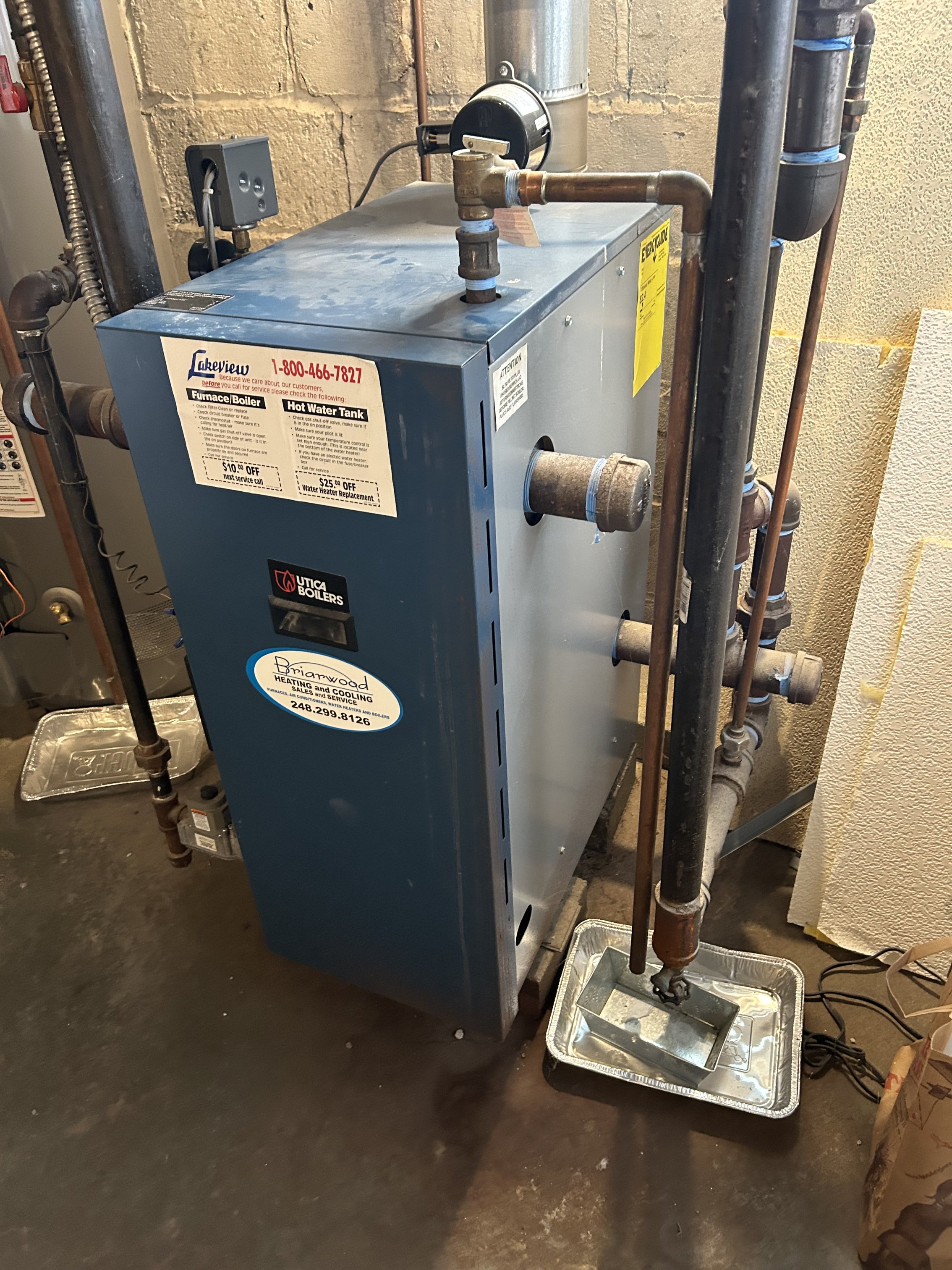

    you have it very easy. Your Utica has these side outlets to which you can attach an elbow and a nipple sloped toward the boiler with an optional reducer and ball valve
    With this setup you can add treatment or even all your makeup water (I add only heated distilled water because I’m a fanatic)
    I don’t recommend a separate water heater setup because it’s too easy to just pour it in yourself every few weeks (minimizing leaks is the first priority)
    PS I see from your contractor’s sticker you are in Michigan. Hello from a native Michigander

    @Day_Tripper that is a lot more water than I like to see being added. Look for leaks of steam or water, especially the vents. There is also the possibility that your boiler has a hole in it as seen in the above picture (but probably smaller). I want to see less than 1" of drop in the gauge glass every month or so during the heating season. Using as much water as you are using will reduce the lifespan of your boiler. Of course if it already has a hole in it that concern is in the past.
    Is your main concern with an external heater/bubbler that the potential for leaks increases with more connections?
    No, just that it's a lot of hassle for minimal benefit
    Day_Tripper
    ethicalpaul Member Posts: 8,928
    if your vents are letting steam out, that could be the whole leak.
    the easiest way to test the boiler is to overfill it to the header and see if water starts raining down to the floor under the boiler
    You are in a difficult situation with that removed radiation.
    But you are exacerbating it with that 5 degree setback at night. I recommend stop doing that and see if the downstairs is able to stay comfortable.
    If the upstairs gets too hot for your comfort at night, try covering one or more radiators with blankets until you are comfortable, but keep in mind doing so is similar to removing radiation and may make your system cycle more.

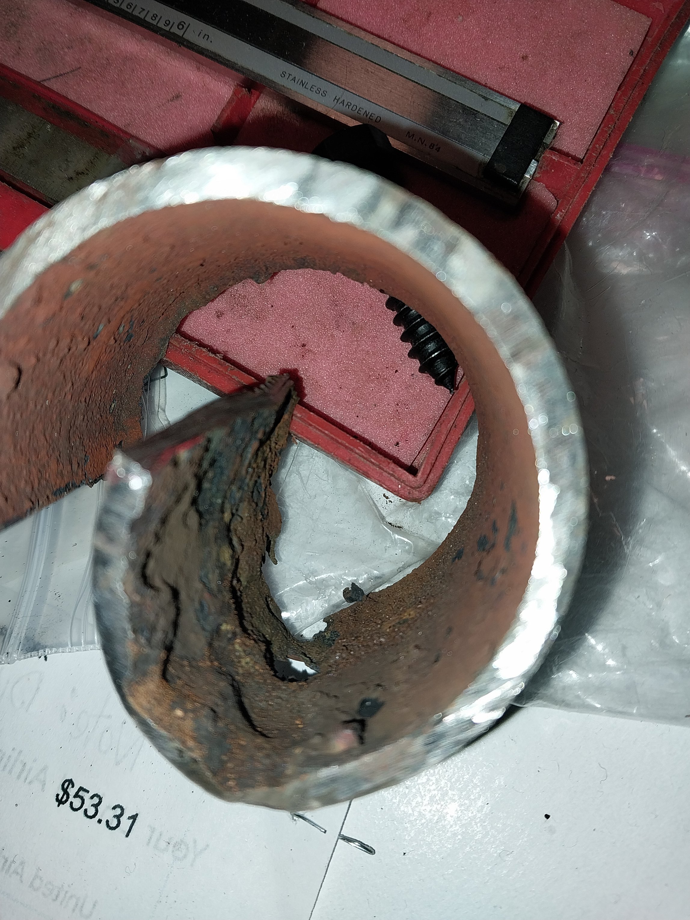

    Do you think that Rectorseal 8-way can protect steam mains at all? They say it does but I'm skeptical unless there is a lot of carryover. Otherwise it should be distilled water I believe. Here's what 100 years of corrosion inside a steam main that is not pitched correctly looks like. This is the downstream end of a 16 ft. section that went into a Tee for the riser to an upstairs radiator and what it looked like after I cut through it and chiseled it out. Kept it as a souvenir. Even if it is basically distilled water I would think that it would absorb CO2 from the air in the main and create some carbonic acid. But it is obviously very hot and would limit absorption. In the off season I had cool distilled water pooled up in there and saturated with air containing CO2. Would be interesting to know what the pH was. Anyway, you can see that this main rotted out at and below the waterline and there is lots of meat still on the pipe in the upper areas.
    No, I don’t think 8-way protects the mains. I have thought about carryover helping but given that even a sagging, rusting main lasts 100 years, it hardly seems worth it to consider.
  • Captain Who
    Captain Who Member Posts: 883
    For comparison, here is the upstream end of that 16 ft. main that did have a small amount of downward pitch (unlike being level at the other end), and 1/2 in. higher elevation. Much less corrosion and presumably no standing water situation.
  • Captain Who
    edited January 23
    These pictures show corrosion on upstream end better. I'd estimate 1/2 way through penetration at the worst spots. Uneven corrosion must be due to localized differences in alloy composition, and once the pitting corrosion starts a self perpetuating small pool of water exists. Definitely a different situation from boiler corrosion with treated water and mostly de-aerated water and "maybe" some protective effect from scale buildup.
