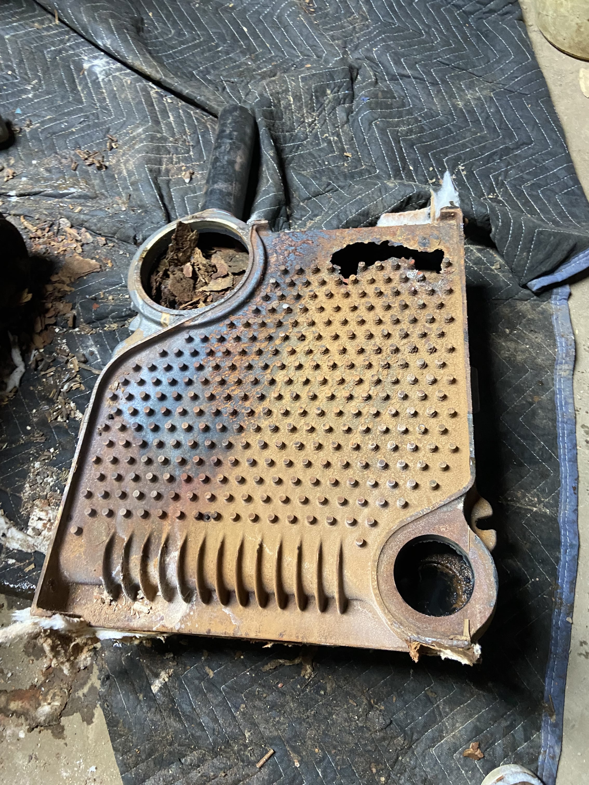

    An observation about where oxygen does its real damage:
    You are right that oxygen enters cold water and we do of course see returns (usually at the boiler) rot out pretty quick.
    However, where do the boilers always fail? At the top of the section, every single time. How is that possible? There's no water up there, there's only air and steam, right?
    You also said in your video correctly that the oxygen is forced out of the water as the water is heated. But I would ask "where does that oxygen go?" It is released into the steam chest, or the upper part of each section, where it is free to attack the cast iron. This is why I think it doesn't matter when you heat the water you add to the boiler—regardless that oxygen is going to be freed to attack the boiler.
    So in my mind, the best way to keep your boiler from seeing premature rotting death is to use makeup water that was recently boiled, and to use a product such as 8-Way that has oxygen scavenging capability as well as the known corrosion-reducing pH booster chemicals.

    I don't know physics or water chemistry or metal chemistry or anything like that. I have long assumed that there is not much corrosion below the water level, because that metal is totally submerged in water. The metal above the water line, tends to have water and moisture on it, without being submerged. Would assume that is more likely to corrode. And the more oxygen in that water, the higher the corrosion likelihood is. Can't remember ever seeing a boiler rust out at the actual water level itself.
    ethicalpaul Posts: 9,076
    edited January 22
    Yes I have noticed the same thing from a distance of this forum @STEAM DOCTOR that all holes seem to always be at the top of the sections.
    And yet the other major rot point always seems to be where the wet return hits the boiler, so something interesting happens there as well.
