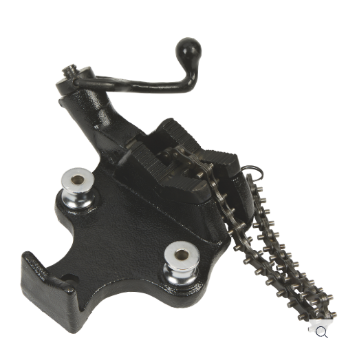

Just bought a new truck. It comes with everything except a slide-out pipe vise bracket like the one pictured, but I can’t find one for sale anywhere. Fabrication is a second choice if I can’t find one off the shelf.
Does anyone have a source?

    American Van has a floor mount telescoping bracket for vice mounting.
    I have gotten a lot of items from them and all was good.

    Hi, Like @JUGHNE , I used their van vice mount with great success. https://www.americanvan.com/slide-out-vise-mount-av-svm-11-1006.html

    That bumper is stout enough to mount the bottom 1/2 of a regular yoke type pipe vice.
    Or detachable receiver type, like this.
    Nice truck, beefy pipe rack. I like the colors

    A lot of guys and gals swear by this Bigfoot type of vise. You could rig a bumper mount, and use it as a portable with some clever bracketing

    A chain vise is handy if you want to hold "other" larger diameter or odd shaped stuff. I used one for cutting the smaller fire wood with my truck vise.

    Chain vises are the best. Cut a whole bundle of threaded rod, square tubing, angle, channel, Unistrut…..oh yeah and pipe and tubing too.

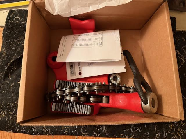

  • Guys: I got a new chain vise from Santa and all I need is the stand. I don't thread pipe anymore, so it's just tightening and loosening fittings from pipe, cutting PVC and galvanized flue pipe. And it looks cool, hanging off the back of my truck like I know what I'm doing.

    It will look better when it is covered in pipe dope, a few pipe chips and dirt

    I had a Ridgid bolt on chain vise. I mounted it on some steel c channel that I fashioned into an upside down L stand. I secured a c channel bracket to my bumper so I could drop the vise into it. This kept my vise in the truck, and allowed me flexibility in using it and transferring it to another truck. I go through trucks quicker than I go through through tools. It was my answer to a truck without a hitch. Smaller than a tripod vise, lighter too. till in use 40 years later. I like tools that are forever. ⚒️
