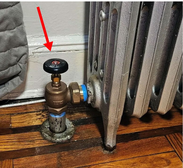

    @EdTheHeaterMan Here is a picture of the radiator. The valve on the left is the intake:
    Here is my situation. I have several radiators just like the one shown in the picture. One radiator on the third floor heats up end to end, but I don’t need heat in that room, so I am considering closing its valves. Meanwhile, a radiator on the first floor only heats about 1/4 of the way at best.
    Given this, my thought was to close the valves on the third-floor radiator because I don't use that room, in hopes of getting more steam on the first floor. However, I am not entirely sure what’s causing the first-floor radiator to heat only 1/4 of the way.
    Since this is a two-pipe system, should the vent on the radiator be fully open or completely closed? For clarity, all radiators in the house have both valves fully open.

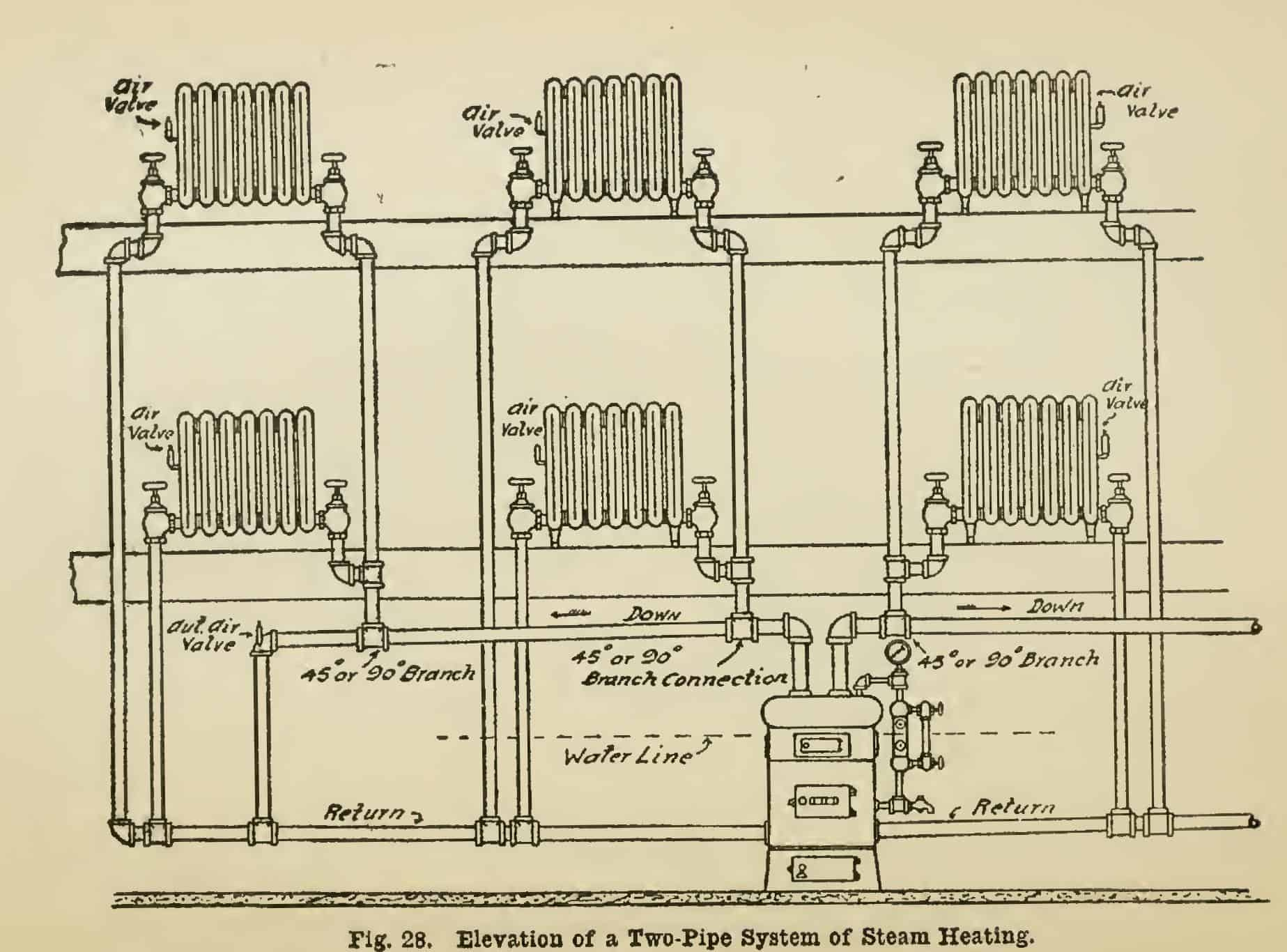

    A follow-up question: based on what I have, is the return on the opposite side (the pipe going down on the right side in the picture), or is it on the left side where the intake is? Also, why isn’t the entire radiator heating up?
    This happens even when I run the boiler for hours by intentionally setting the thermostat to 80. I have replaced the air vent and set it to fully open. I also checked both valves and they are fully open and free of debris. One thing I have not checked yet is the pitch of the radiator. However, the correct pitch depends on the answer above, specifically which side is the cold return.
    I found a picture that suggests the cold return is on the right side of my radiator, which means I need to make sure the left side is pitched higher. Do you agree?
    Jamie Hall Member Posts: 27,600
    The return is usually the side with the vent. Also, usually — but not always — the return pipe is smaller than the feed.
    But… in a two pipe air vent system, neither is always true!

    Tomorrow, I will check the level of the radiator. Based on the diagram above, it looks like the radiator need to pitch downward toward the dry return pipe.

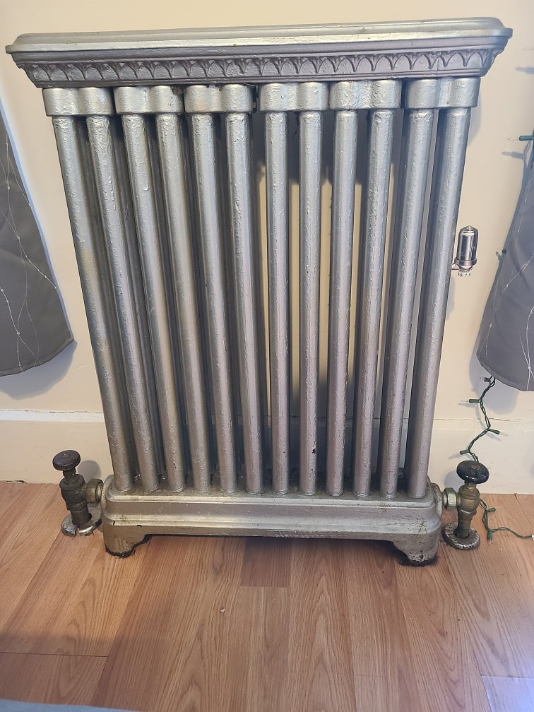

    To close this topic and for others' benefit, the issue was related to leveling. The radiator had settled and was tilted in the wrong direction. I placed shims under the left-side legs (see screenshot above), and it is now heating fully.
    Thanks to everyone for your suggestions and help.
