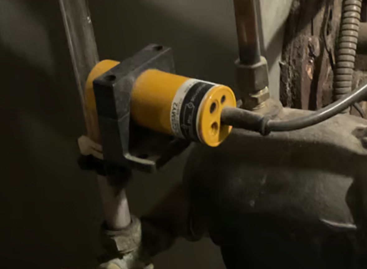

    109A_5 Member Posts: 3,482
    As far as the picture I posted above from another older thread of the sensor attached directly to the sight glass;
    Proximity Switch
    Omron E2K-C25MY2
    Capacitive Proximity Switch
    200mA Max
