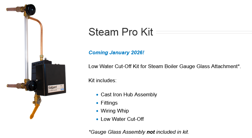

    Any steam boiler can use a MM #67 which comes with the fittings needed to put it on a gauge glass.
    Or you can add a probe type cutoff. Hydrolevel makes a probe type with fittings to mount on a gauge glass as well if no other tapping's are available

    They've had those components for some time now, but this is the first time they've sold them as a kit. Still need to blow it down though, but it does away with the 67's moving parts………………
    Edit- found the link, this is the two-probe version:
    Semi-retired
