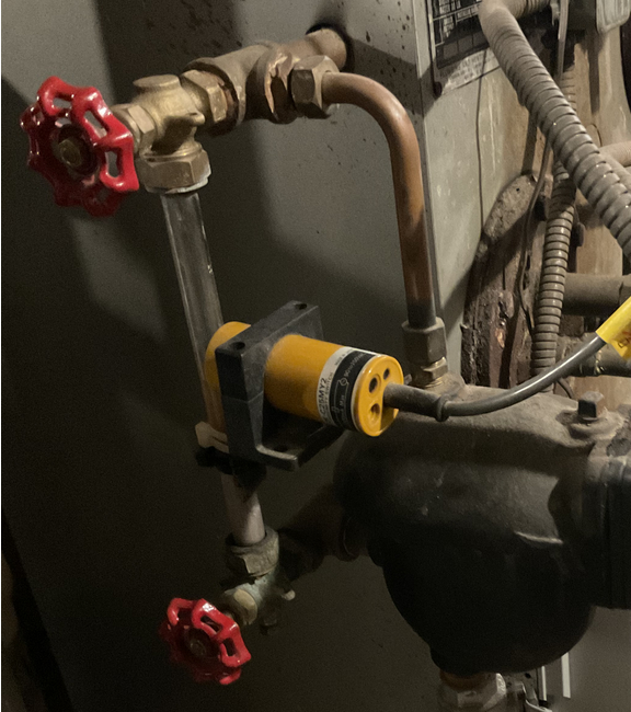

    HydronicMike Member Posts: 251
    Here’s 2
    Steamhead Member Posts: 18,211
    I would have used the tapping below the gauge/pressuretrol manifold for one of them. Less piping and you don't have to blow it down.

  • Waher
    Waher Member Posts: 365
    edited 1:23AM
    edited 1:34AM
    They've had those components for some time now, but this is the first time they've sold them as a kit. Still need to blow it down though, but it does away with the 67's moving parts………………
    Edit- found the link, this is the two-probe version:
    All Steamed Up, Inc.
    Towson, MD, USA
    Oil & Gas Burner Service
    Consulting
    109A_5 Member Posts: 3,470
    edited 1:53AM
    Looks like they probably ripped off this guys idea, he probably did not patent it.
    EDIT: Just looked at it, it does not connect to the gauge glass, it connects to the gauge glass pipes.
    https://forum.heatinghelp.com/discussion/190480/a-question-about-steam-heat
