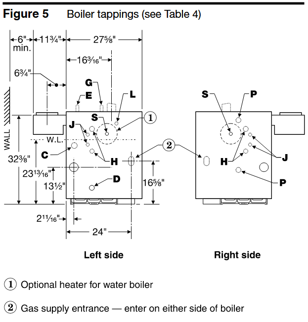

I have a Weil-McLain EG-40, which has one probe type LWCO.
Dan’s book recommends installing an extra LWCO.
How can an extra LWCO be installed if there’s only 1 hole on the side of the boiler for the probe ?
Am just a homeowner, and not sure if there are other probe holes available .

    Steamhead Member Posts: 18,319
    Many EG/EGH boilers have "try-cock" tappings next to the sight glass. We've used the lower try-cock tapping for the primary LWCO, and the "usual" tapping for the secondary.

    EBEBRATT-Ed Member Posts: 19,891
    Any steam boiler can use a MM #67 which comes with the fittings needed to put it on a gauge glass.
    Or you can add a probe type cutoff. Hydrolevel makes a probe type with fittings to mount on a gauge glass as well if no other tapping's are available

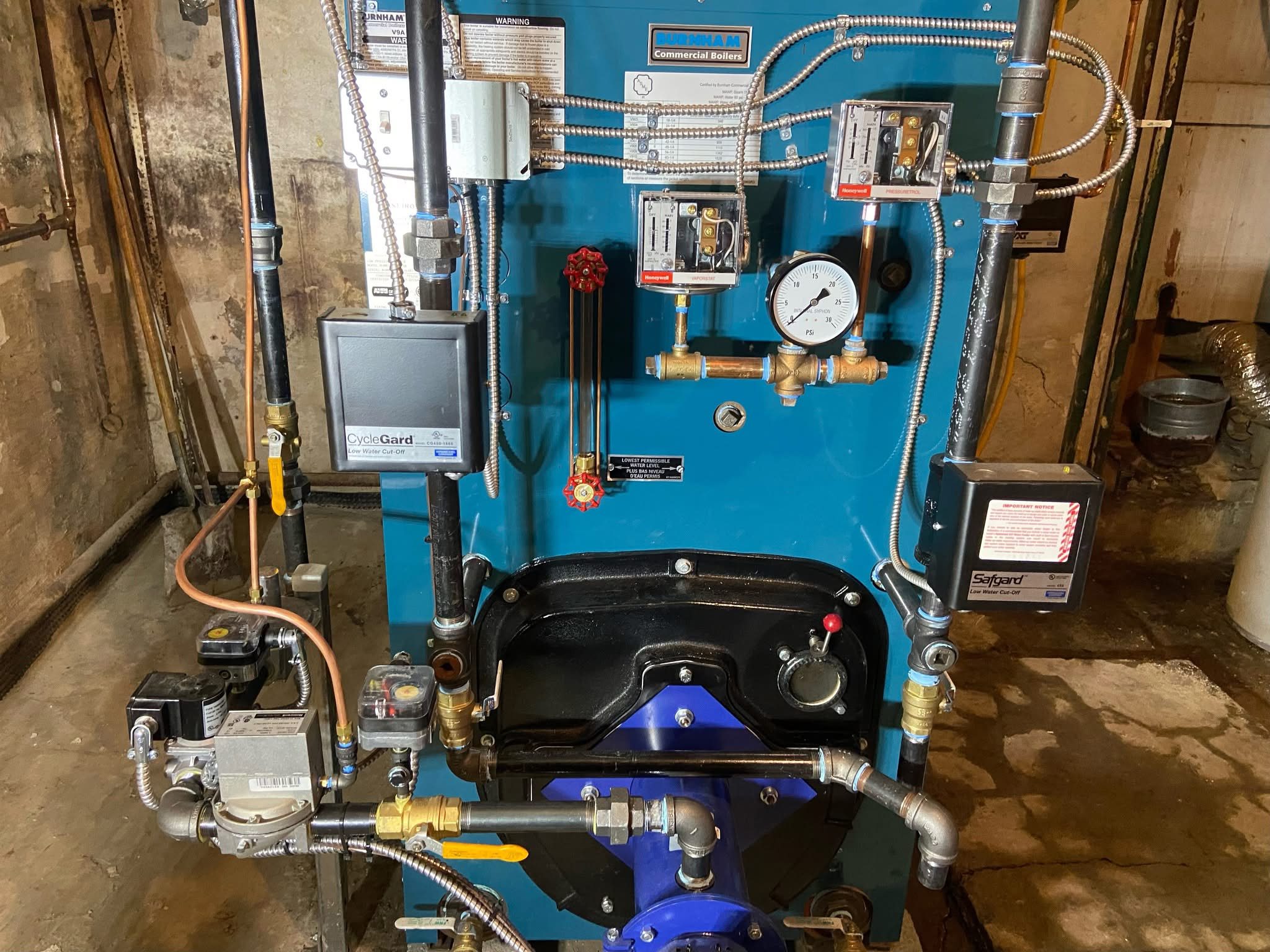

    HydronicMike Member Posts: 293
    Here’s 2
    I would have used the tapping below the gauge/pressuretrol manifold for one of them. Less piping and you don't have to blow it down.
