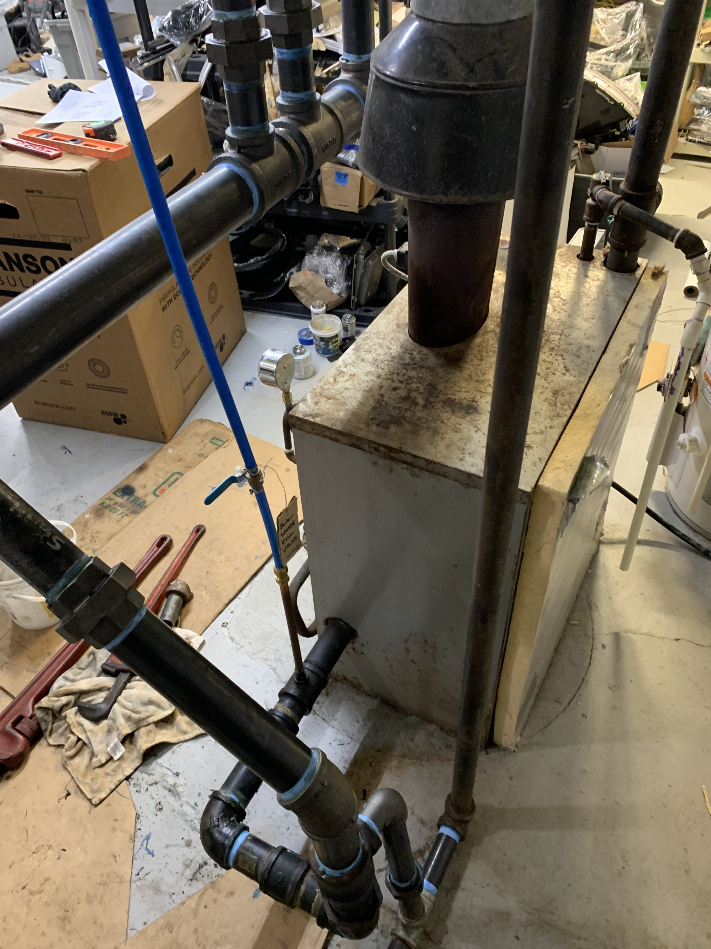

my system is two pipe COUNTERFLOW.
it was originally a coal fired system, and the mains are always warm with that system so when it called for heat there would be little to no steam condensate when the steam down through the mains
… now it’s gas fired and mains are cold between cycles. The water in my mains are just from the condensate from the beginning of the cycle . I know this because once I purge / drain out that water in the main heats as it should.
also there is no water hammer so I know it’s not pooling cold water . The water is the condensate from the cold main. Also why if I shut it down near the start of the mains heating up, let it set for a time and fire it back up problem is for the most part gone.
So this would mean I need to add the previously mentioned by some, DRIPS to the HL near the boiler header to both of my mains so that condensate in the mains at start up can drain back.
Thoughts ?

    Well you need the drips. It kind of sounds to me that when the boiler is heating (steaming) you are pooling water and when the boiler shuts off the pipes drain.
    The bottom line is this. Steam changes to water when it cools. If the water can't get out you going to have problems. The water can't be allowed to remain in the system. It can't wait for the end of the cycle. The water has to be drained as fast as condensate is formed.
    Never seen counterflow 2 pipe myself but that doesn't mean it won't work or doesn't exist.
    Pretend you are water inside the pipe how does the water drain out. It can't go up hill.
    Maybe someone raised some pipes or messed it up or knuckleheaded it before you bought it.

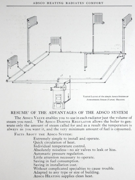

    https://archive.org/details/AmericanDistrictSteamCo/page/n7/mode/2up
  • JoshP
    JoshP Member Posts: 133
    I’ve read that and have that ADSCO brochure . My system has the ADSCO valves but it’s counter flow , no wet loop at the ends of the mains and the no connection / tie in of the mains to anything but take offs to the rads. Just two parallel counter flow mains to rads and dry returns back.
    Also no evidence of any pipes being modified or changed other than at the boiler when it was replaced 50+ years ago. All the asbestos insulation was still untouched when I moved in.

    The condensate is sitting and surging near the take off piping to the second floor causing those rads to heat half as fast . It’s not draining back to the boiler. No drips at the boiler.
    Both mains are pitched back to the boiler . Lowest point if the mains are at the boiler header . All rads tied into a Dry return all pitched back to the boiler with return venting at the point where both returns come together and drop to the HL.

    Where do you drain/purge the water from the main at??
    How about pictures…….the usual request…..floor to ceiling….all sides?

    there are no drains for the mains. Which is why I think drips need to be added .
    Mains have take offs for rads . The take off for the second floor rad is essentially the last take off and on the end of the main .
    Video of system. If you need to see something else let me know. Pics really don’t work well to see the big picture.

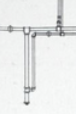

    that stub could be partly filled with water and be more mass to condense steam in the main too, exacerbating the lack of drip problem.
    oh, and it could have been a drip for the original boiler.
  • JoshP
    it was next on my list to get the cap off see if water is pooling in it and either cap it right at the tee or now possibly use it for a drip return for that east side main

    two pipe counterflow .. drip on main, which mine lacks. That’s the fix.
    EBEBRATT-Ed Member Posts: 19,602
    @JoshP
    If the pitch on everything out in the system is correct the drips should help.
