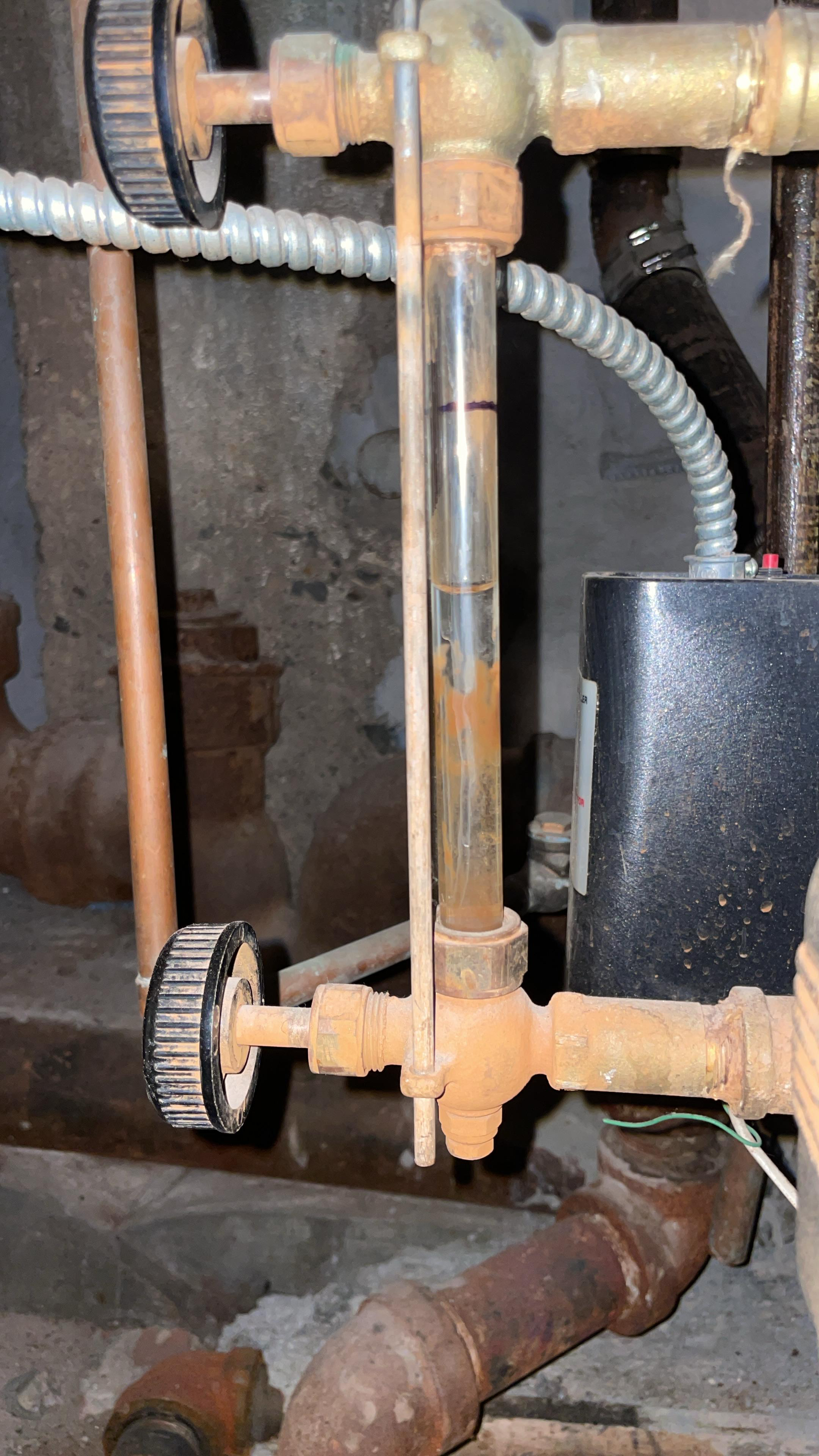

    The image below shows the water level now (after not firing for 30 minutes). Green marks the current water level with the boiler not firing but moderately hot. Water has not been manually added in at least 48 hours (maybe 72).
    Jamie Hall Member Posts: 27,005
    Thank you! The reason pressing on the lever in the pressuretrol is not really a good test is that while it does say that the switch works — which is nice to know! — is that it doesn't say, reliably, whether that is the control which is doing the cycling.
    Looking at the water levels, I do wonder now if it may not be the low water cutoff — or cutoffs. From the photo it looks as though there is also a float type LWCO. That green line is very close to where the control gets unhappy. Since you are not adding outrageous amounts of water, it doesn't seem that you have a serious leak (you may still have one, but let's worry about that down the road here). So… try adding water manually, with the system cool (it doesn't have to be cold) to that black mark on the sight glass. Some systems may have slow returns, but not so slow as to be a problem, and are just happier running with a higher cold water level. It won't hurt anything to try!
    I remain baffled by the pressure. If that valve is the boiler feed, it should raise the level in the sight glass — but that has almost no effect on the pressure. But… I notice that there is what almost looks like a compression tank hanging above the boiler. Is there, by any chance, a hot water heating loop connected to this thing as well as the steam?

    Pressuretrol: My thinking (obviously incorrect) was that by manually ensuring the microswitch is not tripped, the boiler will start to fire again immediately if and only if the reason it stopped was because of pressure exceeeded the threshold.
    Low water: More evidence that I know just enough to be problematic — I did not realize that I had 2 LWCO. I understand now that the there is rectangular box box which (I think) is a probe type as well as the big iron odd shaped one with a handle to drain drain water which (I think) is a float type. I assume both are wired in effect in series so that if either detects a low water condition then that one can shut down the boiler, correct?
    The black mark was made several days ago by my "handiman" at my instruction when I told him to fill the water 3/4 of the way up. So, I think I ran the test you suggest, but I certainly don't fully understand it. You can now see that the water level has dropped and stabilized at the current level just above the unhappiness level. But, as my memory loses in the fight yet another day to age, I believe that the raising of the water to the black level was done prior to finding 2 more spitting vents — so it is possible that the water loss is due to that.
    I can instruct him to raise the water to the black mark today and we can see if the water remains at that level of drops on it's own now to "just happy." Should I do that?
    Thank you!
    Do raise it and see what happens. As I say, it won't hurt at that level.
    The big iron odd contraption is a low water cutoff — and may also control an automatic feeder, if you have one. The joker in that deck is that in order to make sure it is operating properly it should be drained from the valve on the bottom of it once a week or at least twice a month, to make sure the float inside is free. Then, of course, refill the boiler to where it belongs…

  • josephny
    josephny Member Posts: 428
    boiler was not firing now and water level is as shown, which I think is a healthy level.

  • josephny
    Update: On Monday at 9:45am I had the water feeder valve shut off. The water level was as shown in the photo. The boiler was not running and hadn't been for at least 15 minutes. Nothing else was changed.
    At 2:00pm (4:15 later), the boiler not firing and was calling for water. The water level was as shown in the photo. I don't know with certainly how much the boiler ran in those 4 hours, but at 2pm the header pipes feel warm to hot.
    At 4:00pm (6:15 later), the boiler was firing for a while and then stopped to call for water (which it's not getting because valve is still off). Water is a 2 to 3" lower than when it's when boiler is or just has been firing.
    At 4:20(after about 20 minutes of not firing), the water level rose back to about 1 to 1.5" below the 9:45am level.
    Analysis?
