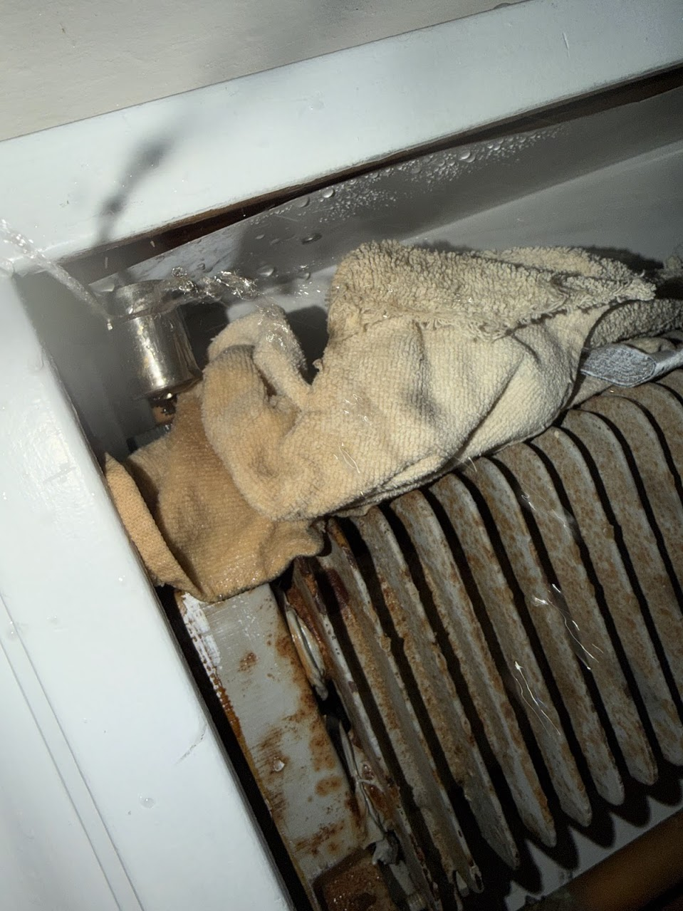

steam radiator leaking water from the vent
Hi all, we have a steam heater and turning it on for the first time this winter it started steadily leaking water from one of the radiators. The water is coming from the vent. Attached is a picture of it below. I replaced the vent and the valve pictured below with new ones and opened the valve all the way. When we turn on the water to increase the pressure in the system water starts leaking right away after some air/steams comes out of the vent. Not sure what to do at this point. Any ideas?

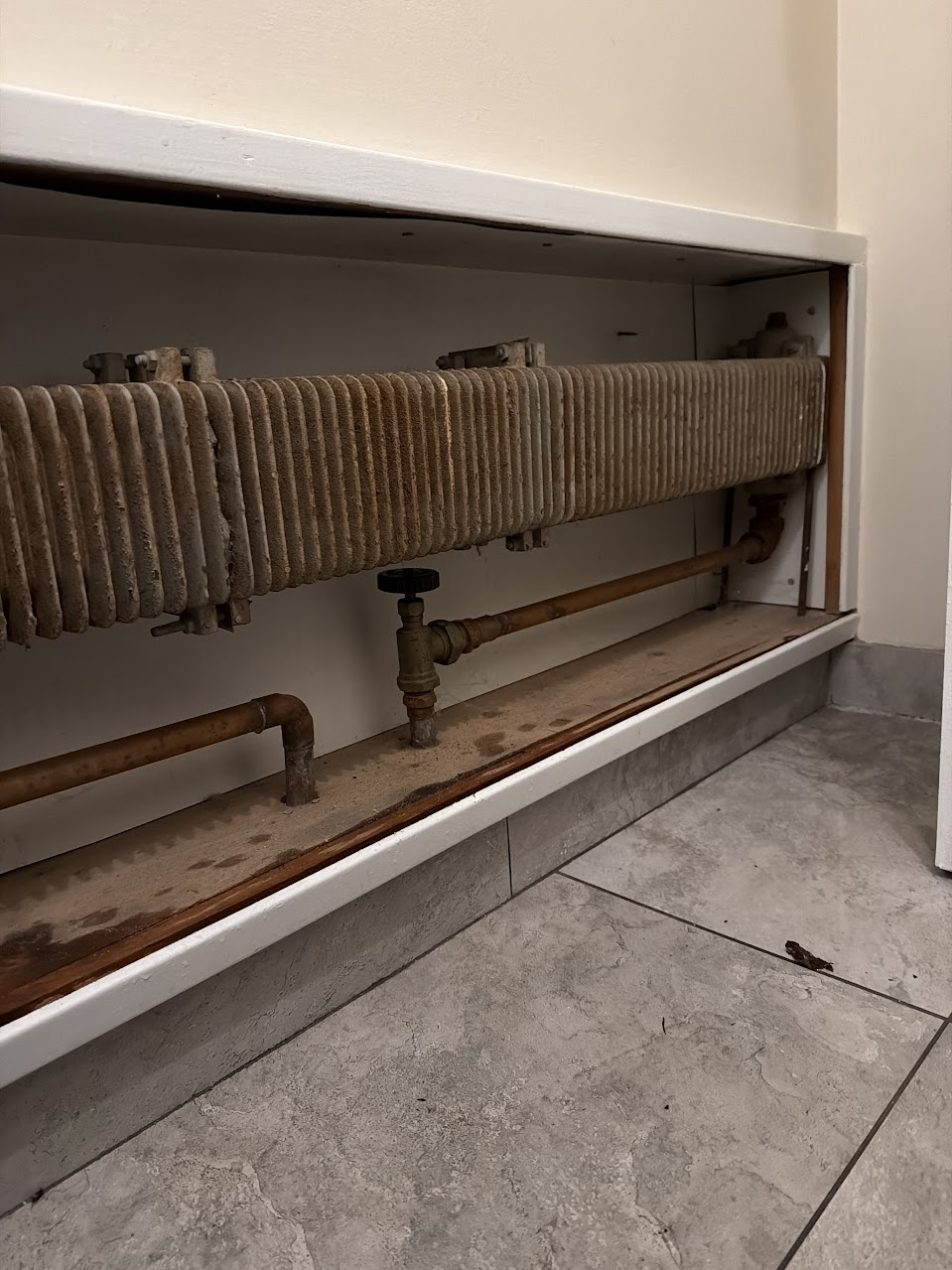

One Pipe System3 -
If you can turn on a valve somewhere and the pressure increases in the system — it's not a steam system, it's a hot water system.
The piping on the convector definitely looks like a hot water system, definitely a hot water valve to my eye.

Seems like you are way overfilling the system. The water line should be in the middle of the sight glass on the boiler, not with water spewing out of the radiator vents. You will probably have to drain the boiler / system down to the proper water level before there is any hope the system will work correctly.

the valve i'm opening which I think lets water into the system is right next to the boiler on the left side. As soon as I open it the pressure starts rising within a few seconds. I fully agree about the state of the system, we just bought the house last winter and the heat worked fine back then but now it's not. We don't know when it was last maintained or when it was put in but the house itself was built 70 years ago so i'd assume it's very old.
