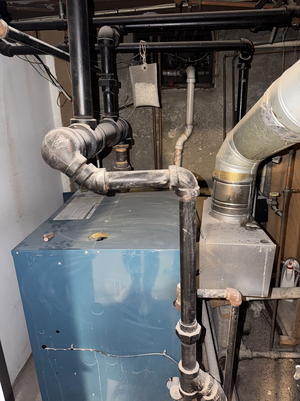

    Pictures of the boiler would help us help you.

    The piping on the convector definitely looks like a hot water system, definitely a hot water valve to my eye.
    Pictures of the boiler and piping in the basement would definitely help assess what you have.
    2014 Weil Mclain EG-40

    Sorry, I think you guys might be right about it being a water heater. Clearly I'm new to this stuff 😞
    ethicalpaul Posts: 9,076
    edited December 2025
    you didn’t show the controls side of the boiler so I can’t say for sure, but that is a steam header on there.
    And I see a Hartford loop trying to hide 😅
    Hmmm… certainly does look like steam boiler piping!
    Looks steamy to me. Lets have a picture of the sight glass.
    Although the supply way in the back feeding the header looks tiny to me.
    Don't know what they have but sure looks like a Hartford to me.

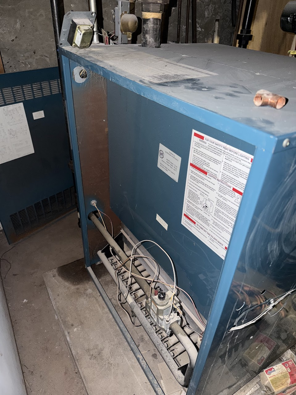

    Seems like you are way overfilling the system. The water line should be in the middle of the sight glass on the boiler, not with water spewing out of the radiator vents. You will probably have to drain the boiler / system down to the proper water level before there is any hope the system will work correctly.
    Does the boiler run at all? If it does, the pressure controls are almost certainly damaged or defective if you managed to get the pressure high enough to get water out of that vent…

    Thanks everyone! here's a couple more pictures of the controls, it seems like it's on and the flame under it is going. The pressure seems to be just a bit over 5. If i open the valve the pressure rises and that causes the radiator to leak water as I mentioned before.

  • What valve are you opening? And it looks like that steamer is in need of some love. What is the story behind this? How long has it been "yours"? When was the last time professional maintenance was done?
    Something just doesn't add up here. That is certainly a steamer, and what's more the water level is just about where it ought to be. It's even piped relatively decently.
    I doubt that the cute little built in pressure gauge is accurate — they usually aren't — but if it is, 5 psig is too much. But… I know of no valve on a steam system, other than king valves on the mains (which I don't see) which can affect the pressure.
    So what valve is being opened? How immediate is the pressure change?
    What I don't like. I really don't like. Is the rat's nest of line voltage wiring and the cover off the emergency switch. That's just asking for trouble.

    the valve i'm opening which I think lets water into the system is right next to the boiler on the left side. As soon as I open it the pressure starts rising within a few seconds. I fully agree about the state of the system, we just bought the house last winter and the heat worked fine back then but now it's not. We don't know when it was last maintained or when it was put in but the house itself was built 70 years ago so i'd assume it's very old.

    Could the whole system be flooded and the sight glass is just rust stained so it just looks like the water level is at an appropriate level ? Adding a small bit of water should not raise the pressure at all.
    I would shut it down, let it cool down, totally drain it and start over with the water level.
    What does the sideways gauge above the pigtail read ?
    the glass looks like it could be totally packed with mud.
    @tarek you do not open a valve to raise the pressure in a steam boiler. You are overfilling it. Call a heating contractor that knows steam. You are not in a position to be touching that boiler.
