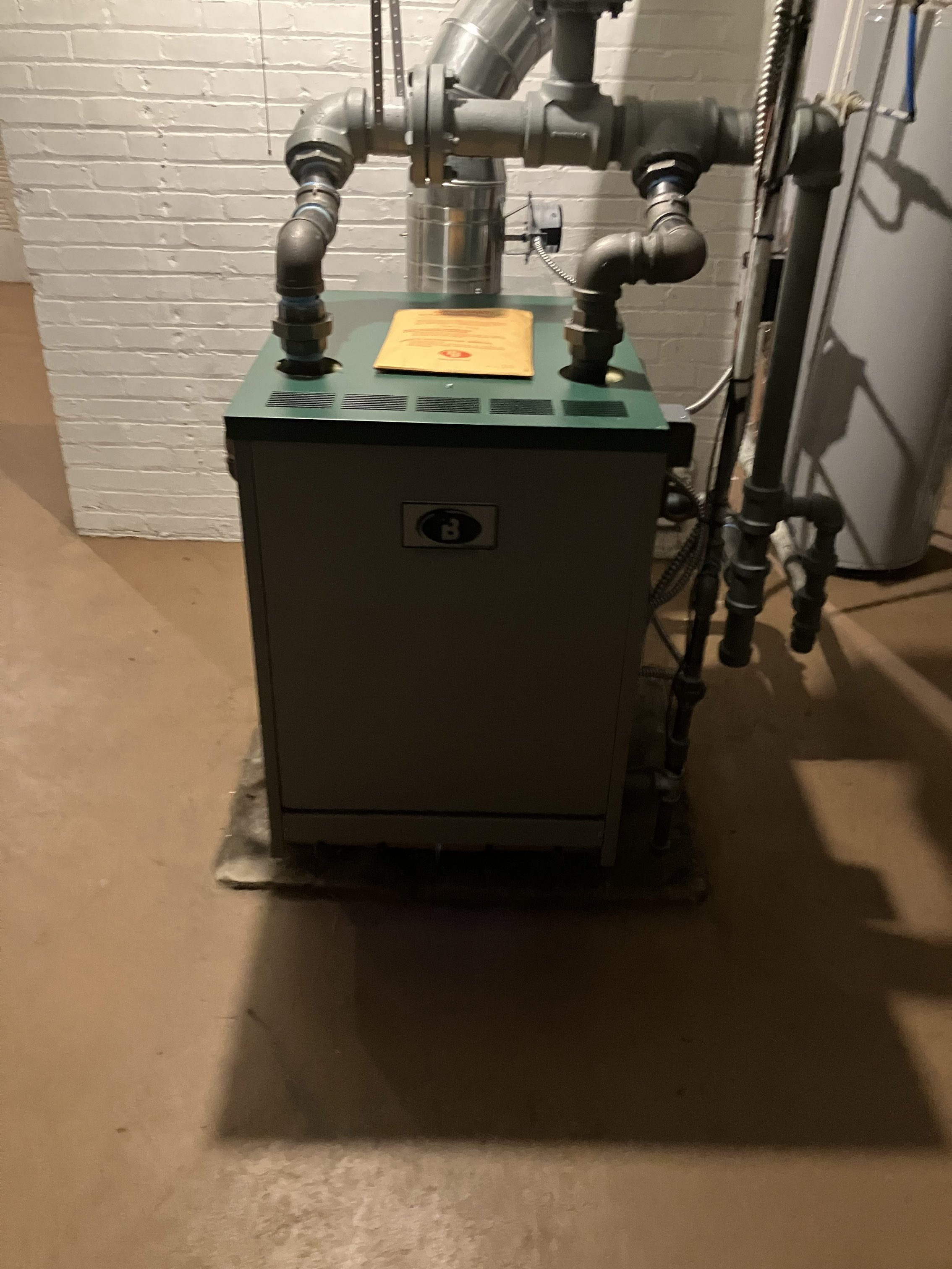

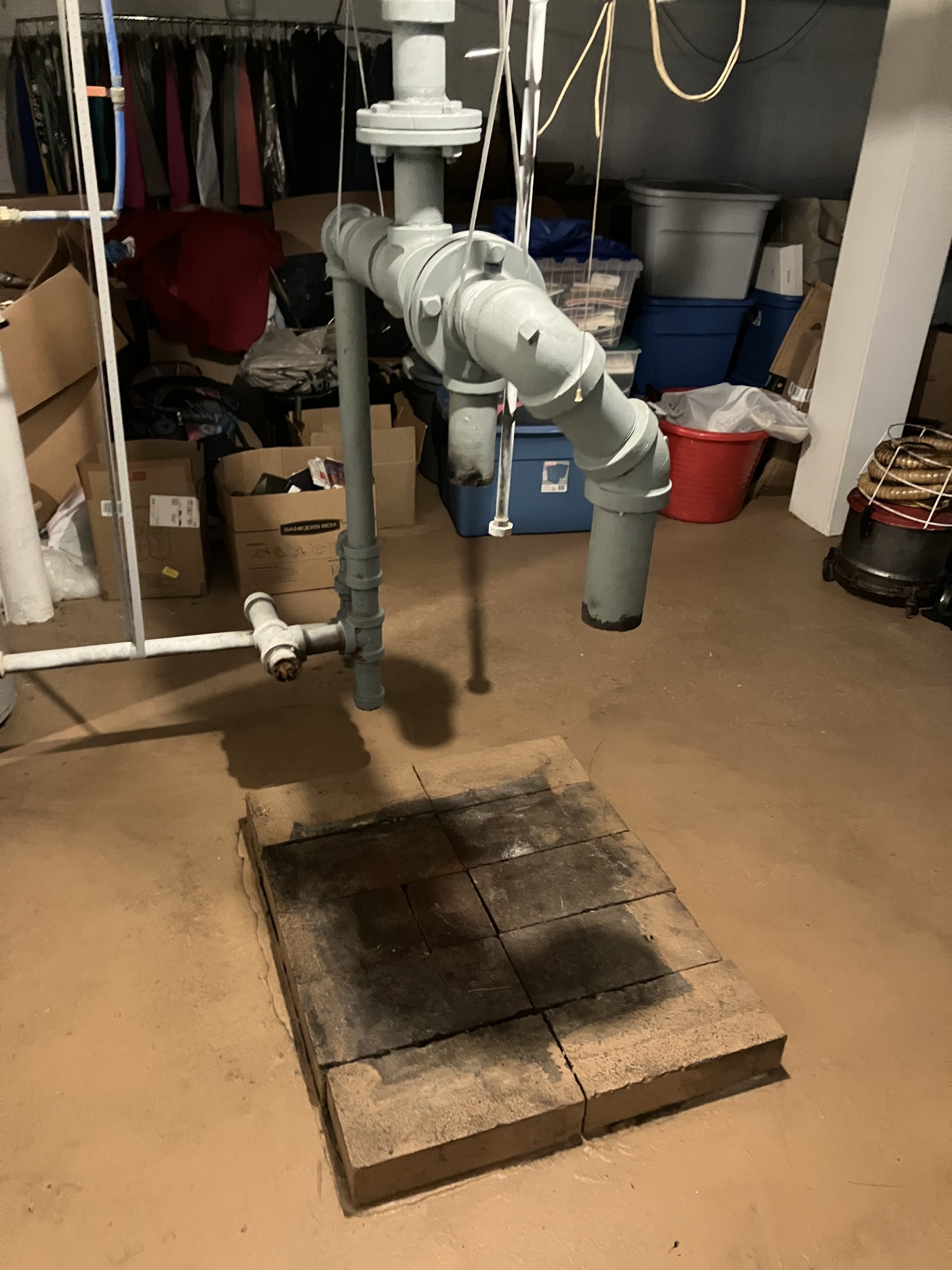

Can you please critique this boiler setup that was installed in my house two wks ago
RCooper
RCooper Member Posts: 14
Greetings please tell me what you think I will also add more pics.

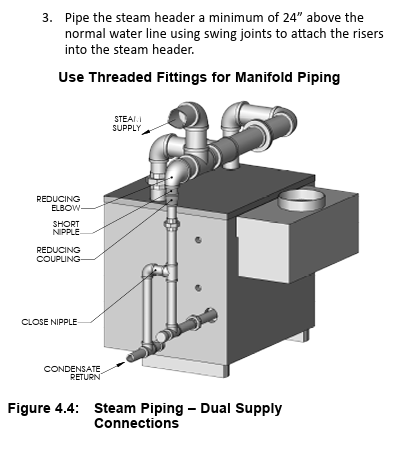

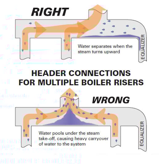

    From the Peerless manual. Note the takeoff from the header needs to be after the two riser connections to the header:
    IronmanMad Dog_2ethicalpaulRCooper

    It stinks (since you asked).
    Ironmanmattmia2WaherEdTheHeaterMan
    EBEBRATT-Ed Member Posts: 19,455

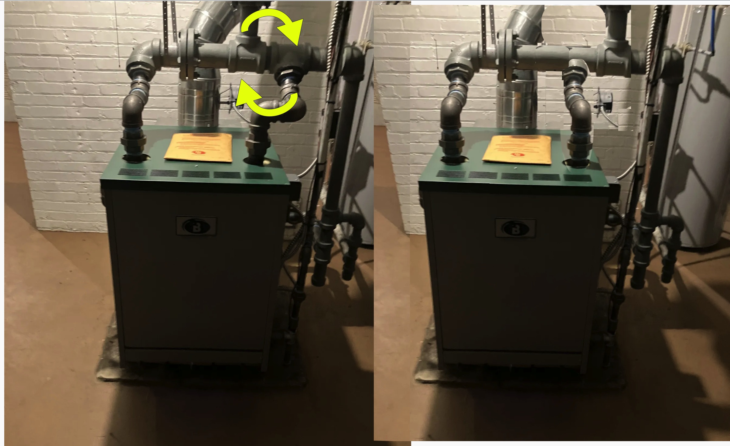

    5 section boiler calls for 2 2" risers or 1 3" riser. As others have mentioned its piped wrong but the fix is easy.
    Remove the 2" riser that is between the building supply and the equalizer and cap the boiler and the tee.
    Remove the other 2" riser and install a 3" riser. Easy to go back to the flange and make it a three elbow swing joint with 3 90s

    The Incorrect piping would likely void the warranty if you have any issues down the line..near and far. Mad Dog

    As it is a new install they should come back and remove their mistake, install the factory approved plumbing per the diagram and also install a double drop header to make dry steam for you ONLY after they take that wrong plumbing apart to fix it.
    You have the basement ceiling height and clearances to install and use a double drop header to your advantage to make drier steam that will heat your radiators faster and in the process they will hold the heat longer.
    I WOULD NOT FIRE THAT BOILER unless the plumbing is corrected AND the boiler is placed back on that single course of fire bricks to prevent water damage from a flooded basement ruining your new boilers base.
    Please provide us with more pictures of the install as I/We need to see where the low water cut off switch is or the water feeder/cut off switch is if used and where the mud leg drain tapping is as well as the boiler sump drain valve.
    Stick to your conviction as this must be corrected!!! You have already spent a great deal of money for a reliable heating boiler to make steam and the plumbing for it should be equally reliable for trouble free operation and the diagram shows how it should be done.
    You have the ceiling height to take advantage of a double drop header to make better dry steam for your home heating needs

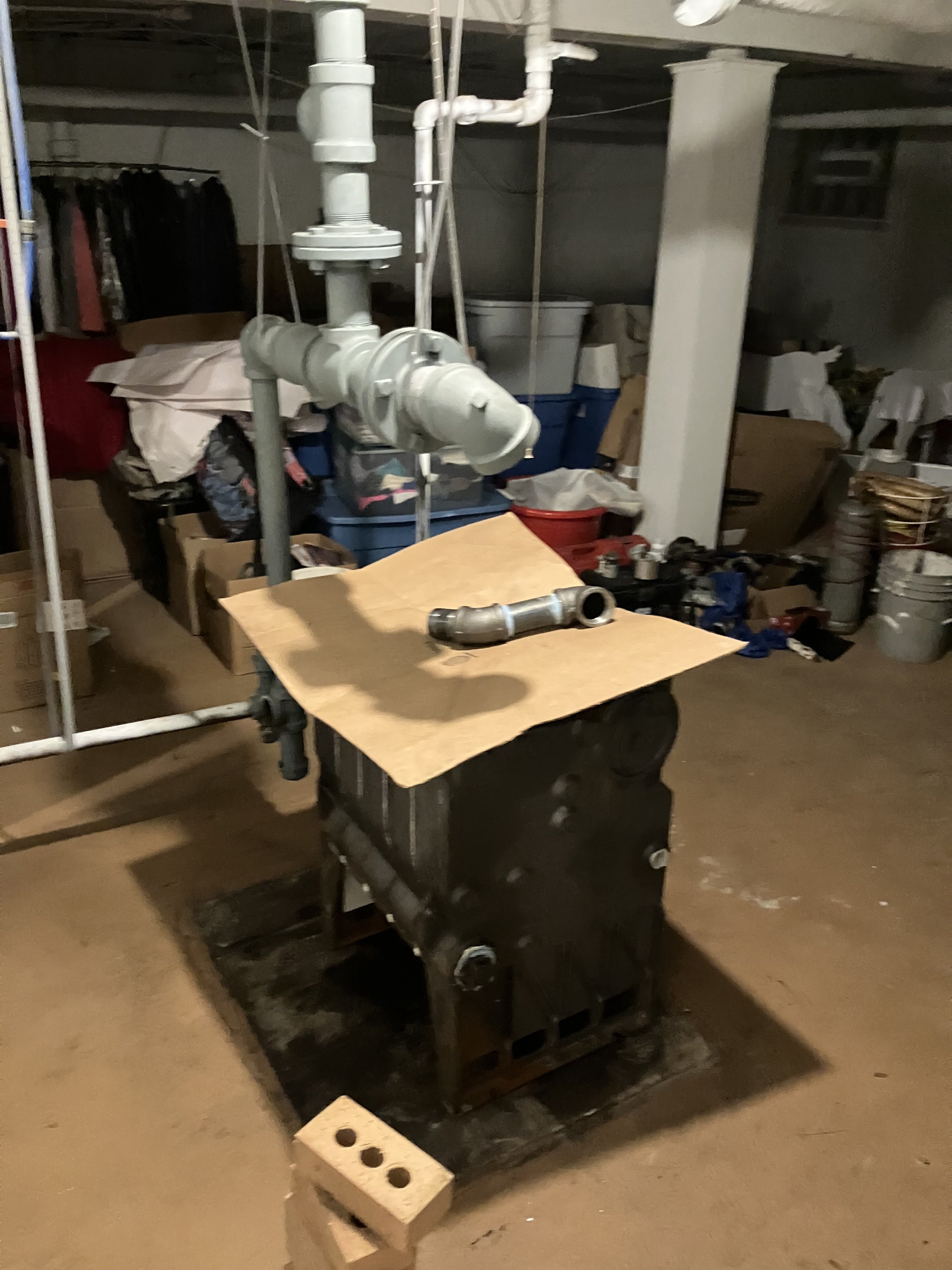

    In your previous post from almost 2 years ago it was clearly outlined that this piping was incorrect, and it's still incorrect. @EdTheHeaterMan took some time in that thread to photoshop your pictures to show how it should be piped, the installer needs to fix it as you paid for a proper install that they didn't give you. For anyone that knows even a little about steam, the piping you have is one of the most egregious errors that can be made. That is one reason Peerless has specific documentation (posted above) to address the problem.
    Given the improper piping and their inability to see that, I'd be very curious how they sized the new one, I'd guess they oversized it too.
    Was Mr. Gill not available to do the work or are you outside his service area?

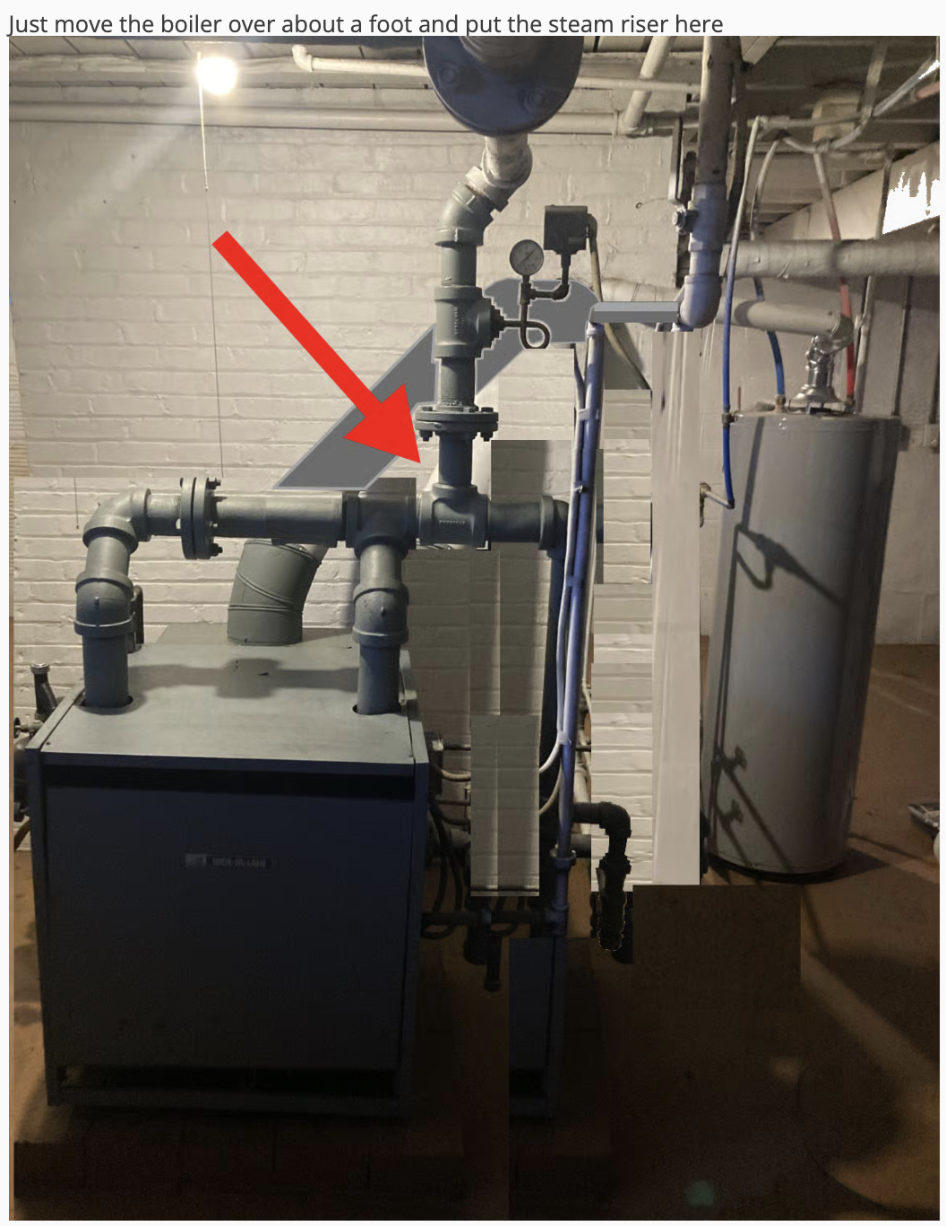

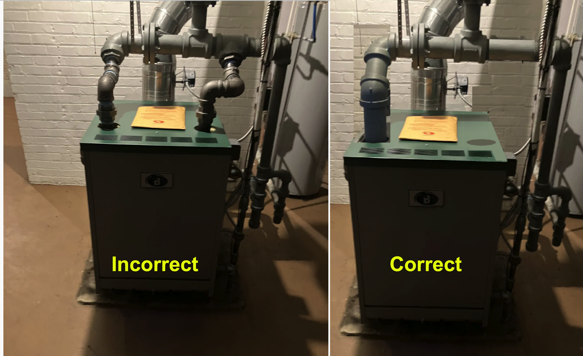

    @RCooper this is the adjusted photo from last year
    I hope that you did not pay in full yet
    this is what you have and how the installer should have done the job
    Your installer did not follow everyones suggestions from last year
    Untitled Image
    or even follow the instructions in the book that comes with the boiler you purchased.
    They even provicee the exact pipe fittings and pipe nipples you need to do the job. You realy need to be an ****** to get this wrong. You hired an *******. I hope this ******* wants to be reputable and come back and do it right.

    It looks like they disconnected and jacked up the original piping, slipped out the old boiler, and slid the new one in its place using a few fittings.

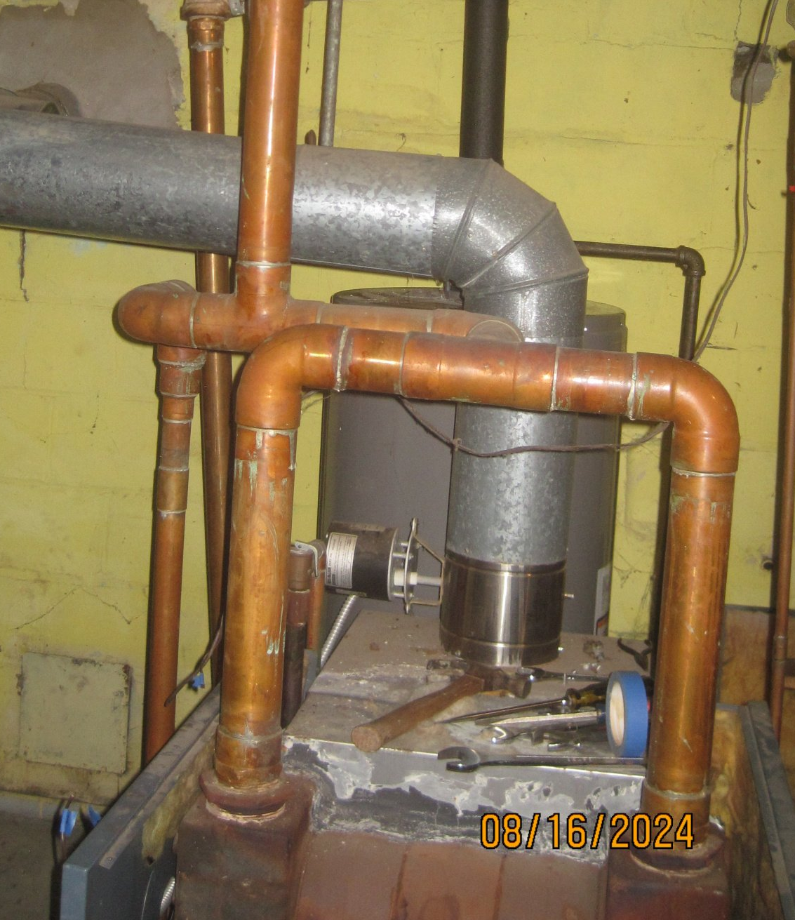

    Below is a picture of my old boiler, a 175 MBTU/hour Weil McLain.
    The piping is even worse, with no swing joints and a colliding header, but it worked fine for 30+ years. The 2.5" risers were probably the saving grace; yours might be the oversized header pipes… they're humongous — four inches?
    There are many threads on this site with terrible intallations that actually worked OK in the field.

    After reading @EBEBRATT-Ed's earliest post, I have this doctored photo that is be the easiest fix for you @RCooper.
    ChrisJMaxMercyGGrossRCooper
    and @EdTheHeaterMan even patched the hole in the boiler jacket!!
    GGrossEdTheHeaterManRCooperCanucker
    EdTheHeaterMan Member Posts: 11,542
    I only has some gray sheetmetal from an old Honeywell Aquastat cover laying around to put under the hole. I used epoxy but you can use screws

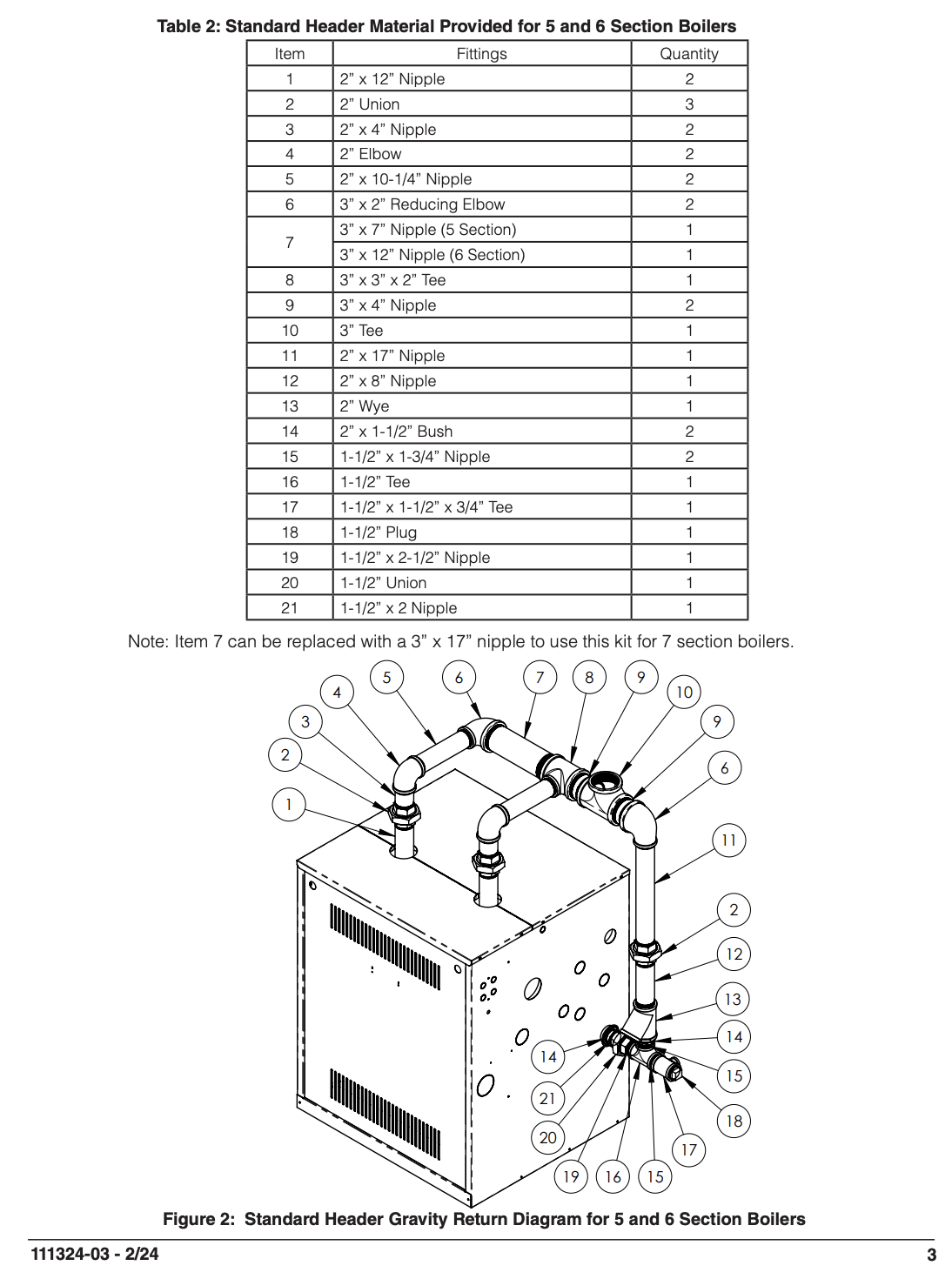

    I would demand that they come back and fix this per the manual using either one of the two "correct" configurations @EdTheHeaterMan provided. Here is the manual including for a 63-05. Use it in your argument.
