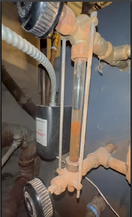

    109A_5 Member Posts: 3,684
    What LWCO do you have ? Some intentionally periodically shut the burner off to test the water level.
  • josephny
    josephny Member Posts: 428
    It's a mcdonnell and miller, but I'm not sure which model number.
    OK I believe that LWCO does not periodically shut the burner off to test the water level.

    Update/clarification:
    I replaced the tstast with a new CK87. It has dip switch settings (both ON) for steam.
    I found 2 more stuck open vents and replaced them.
    I added water until the sight glass is 3/4 high.
    The system has 4 main vents consisting of three #2 and one #1.
    After 48 hours, the sight glass shows 1/4 high, when boiler is very hot. I don't know if this is significant. That is, maybe all the water is in the form of steam throughout the building, or maybe it is solid evidence of a leak.
    The ON portion of the cycles have lasted up to 20 minutes. But the OFF portion of the cycle is often as short as 1 minute.
    I've been searching the entire building for leaks and have not found any. There is no white smoke from the chimney.
    Is it just wishful thinking that the water feeder is simply not staying on long enough to feed enough water in to keep it at an acceptable level?
    Is it okay to add cold water to a hot boiler when the sight glass shows 1/4 of the way up from the bottom?

  • josephny
    when the boiler stops firing, the water level rises to about 1/2 way up the sight glass.
    This morning the pattern is ~20 minutes running, 1 minute off, ~20 minutes running, repeat.
    Now I’m not sure if there’s a leak.

    mattmia2 Member Posts: 15,988
    is the water level at 1/4 of the sight glass after the boiler has been off for say 10 minutes or so or is it just low while steaming?

  • josephny
    I’m totally baffled: the water feeder adds water often, which points to a leak.
    But then why is the boiler running nearly all the time?
    when the boiler starts from cold. feel the mains and the returns as it heats. if the returns get hot before the mains the boiler is throwing liquid water up in to the mains. the returns really shouldn't get hot until the mains and emitters start heating and condensate starts flowing back to the boiler.
    if the boiler is throwing liquid water in to the mains with/instead of the steam the boiler will heat that loop of water to steam hot before the boiler can start steaming

    Jamie Hall Member Posts: 26,998
    May I as a silly question? What's turning off the boiler for that 1 minute chut down? That almost sounds like a pretty well sized boiler cycling on pressure, which is just fine. Not a problem at all.
    On the possible leak — the quickest and simplest test is does the water level recover when the boiler is off and allowed to cool down some? That is, you set it at some level — note what — and then come back later after it as cooled down again, where is the water? About the same? If it, no leak. Slow returns maybe, and quite possible — they can be flushed if needed — but no leak. You only have a leak if you have to add water to maintain level — more than a gallon or two a week.
    With the boiler running that much 24 / 7 is it below zero degrees Fahrenheit outside where you are ? I would think the building would be quite hot unless the system as a whole it quite undersized for the building. How has the system preformed in past seasons ?
    Where is the heat going ? If my boiler ran that much and it was 10 degrees outside it would easily be over 80 degrees in the house.
    With a controlled test if you simply remove the thermostat and touch the R and W wires does the boiler still shut down for that short time then restart ?
    You could use a multimeter to find what is actually interrupting the burner.
    As far as a leak in the return piping somewhere, maybe do some inspecting with a thermal camera.
    Also to test the heat exchanger for leaks, turn off the boiler, let the boiler cool a bit then intentionally over fill it just over the top of the boiler, see if any water leaks out of it.
    Then restore the water to the normal water level to return it to service.

    Do you have an automatic water feeder? And, if so, does it have a counter? If it does, it will tell you how much water, more or less, it's feeding. If there is no counter, you may have to find out what's happening by simply turning off the water supply to the boiler and watching it over several cycles. Or longer. If it's leaking the water will not return to the original level in the sight glass.
    As to when you check the sight glass. So long as you are looking at it at some consistent time after the end of a cycle, you can get a good idea of the trend in water level over time, from cycle to cycle.
