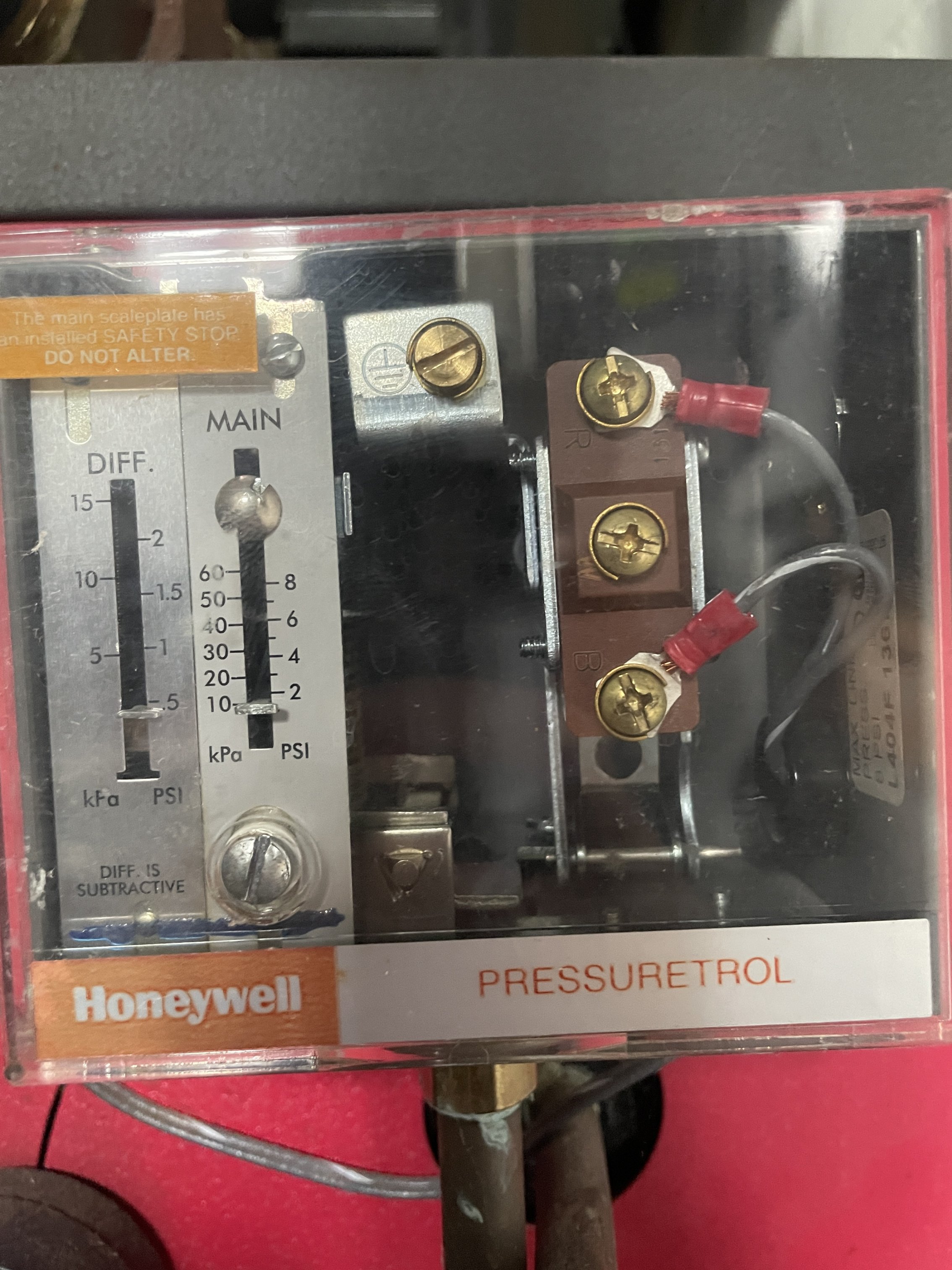

    dabrakeman Member Posts: 1,020
    What is your pressuretrol set at? Attach a picture.
    If you have been able to pitch your radiators then you are handy enough to try raising them if you suspect the hammer is coming from somewhere very near or under a radiator. Often the horizontal takeoffs going to the radiators that are suppose to pitch back toward the boiler lose their pitch and collect water that leads to hammer. Sometimes raising the entire radiator 3/4" or so (while maintaining its proper pitch) can make a difference.

    palmerfriend Member Posts: 4
    Interesting! I don't think I can figure out the pitch of the takeoffs necessarily, right? So maybe I would just try the lift anyway and see if it works?
    I suspect the pressuretrol is set too high - what do you think? Thank you!
    Pressure control looks ok. I would investigate the pipe pitch. It doesn't necessarly mean re-piping. Just trying to find the issue will help even if you have to call someone in to fix it..
    Sometimes just a little tweak will fix things.
