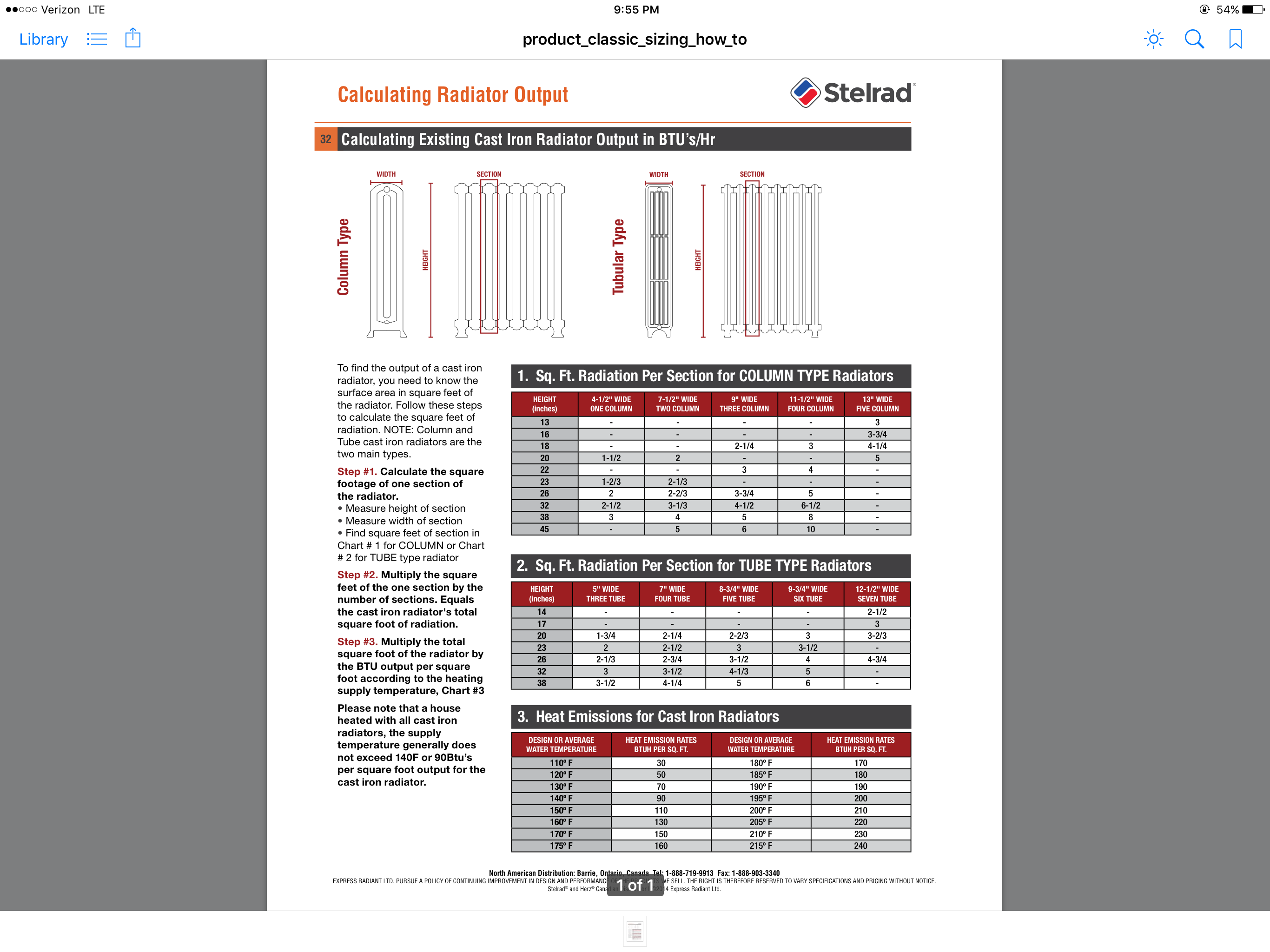

    Attached is a chart for determining the EDR (surface area) of your radiators. That will determine their btu output.
    Once you determine the square footage of your radiators, compare that to the “square footage” rating on the boiler tag to see how closely they match and let us know.
    As mentioned, there’s really no excuse for that piping mess when the manual clearly shows how to do it and the manufacturer offers the header kit with all the necessary pieces pre-cut and threaded.

    The charts shown in the other thread should get you close enough to determine the output of your connectors.
    A steam boiler (unlike a hot water) must be sized to match the connected radiation, not the estimated heat loss of the structure. However, the estimated heat loss can give some degree of guidance in determining how the original sizing was done.
    I’ve been doing heat loss calculations for 45 years and my guess would have been that the original heat loss for your house would have been around 35 btus per square foot. Your boiler is sized at 38 btus per square foot. Again, that’s an experienced guess, but probably not far off.
    Again, please calculate the EDR of your radiation based on the charts in the other thread and let us know what you come up with.

    Based on that other thread, I think I am supposed to measure the enclosures? Then those numbers need to be slightly adjusted? I am likely wearing out people's patience but below are the raw numbers for the convector enclosures along with some associated info. If you could let me know if these are the required values (and if they need adjustments), I will take a stab at the EDR calculation.
    Everything listed as Height x Length x Depth in inches. Depth is distance from the wall. Most are partially recessed unless noted.

    Please convert those to EDR using the charts in the other thread as a guide.
    It doesn’t have to be perfect.

    I don't have a ton of confidence that I did it correctly but if I use the Dunham chart and account for "semi-recessed," "free standing," and "wall hung" and then select the closest dimensions in the table, my total EDR is 380. Does that seem reasonable?

    mattmia2 Member Posts: 17,906
    Unless i missed something, the dunham chart only has 4" deep cabinets and most of yours are at least twice that deep so they will have significantly more output than that chart. The t&b chart has 7.5" deep cabinets which is closer but if most of yours are 9" deep they will be more output than you'd get from that chart.
