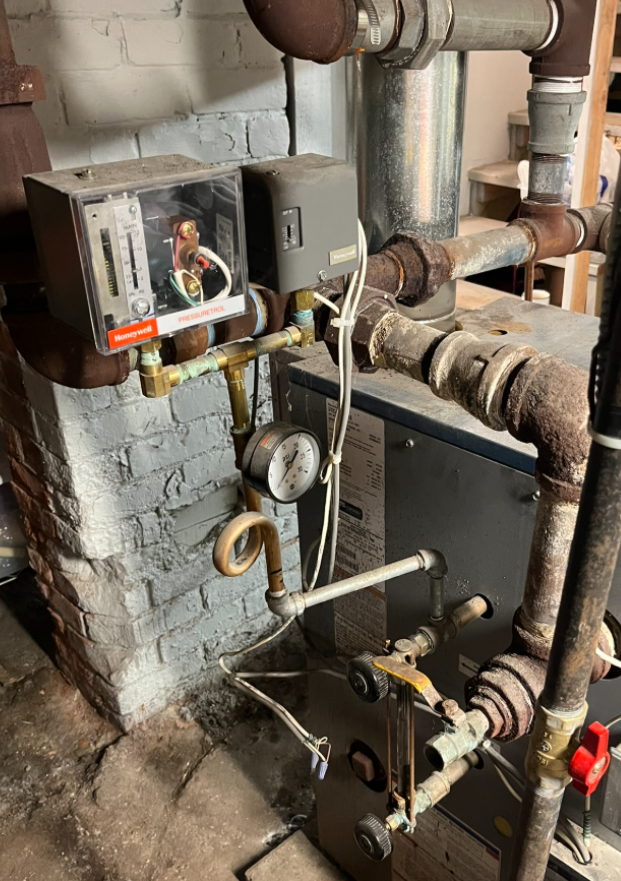

Good evening,
Below is a photo of my old boiler pressuretrol assembly. The boiler has since been replaced and all of the near boiler piping has been redone. As I am working through getting the new boiler up and running I have a couple of questions about the pressuretrol and gauge:
My old boiler had a Honeywell pressuretrol for cut in and cut out and another high limit pressuretrol with a manual reset. My new boiler has a Resideo that is identical to the Honeywell on the right for cut in and cut out. There is no second pressuretrol.
  • Do I need/want to add the second pressuretrol high limit switch?
  • If the answer is yes, is it advisable to use the one that came off of my old boiler?
For context, the old boiler was not installed correctly, maintained at all and our water is terrible. In fact, the entire assembly fell off one day when I bumped my head on a steam pipe. It was rusted through at the point of contact with the sight glass piping. That was a lot of weight on that one little connection.
For the gauge my question is sensitivity. The gauge that came with the unit is the same that was on the old one, 0-30 PSI. Since I have had my boiler up and running the gauge has not moved even a little bit. Should I get a lower pressure gauge? Is there a recommended brand/range? Part of me feels that I need to see something happening here to know that it is all working. Not very scientific, I know.
    Jamie Hall Member Posts: 27,319
    On the pressuretrols. On larger boilers two are required — one for control and one for safety — the latter having a manual reset. It does no harm to have two on any boiler.
    On the pressure gauges. Code — and your insurance people — want one gauge which reads to twice the setting of the pressure relief valve. Not optional. However, also not of much use to seeing how the boiler is actually operating — so many people put another gauge, typically 0 to 3 or 0 to 5 psig — on. Very often smply teed off the pigtail carrying the control pressuretrol.

    mattmia2 Member Posts: 16,673
    that red button is the manual reset on that secondary pressuretrol
    EBEBRATT-Ed Member Posts: 20,145
    Usually, manual reset pressure control is installed on commercial jobs. In MA where I am they are required over 200,000btu.
    If in doubt put it on the new boiler. It should be on its own pigtail not doubled up like on the old boiler.
    No pressure on the gauge is a good thing not a bad thing. Put a LP gauge on if you want. You have to keep the 0-30 gauge and I would put a petcock on the LP gauge only. Keep it off when not checking pressure.

    Are the pressuretrols pretty durable? Given that the system was not in great operating order would re-using the old one be a problem?
    109A_5 Member Posts: 3,959

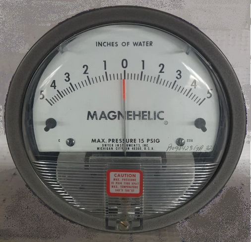

    I too like to see the actual working pressure. I like this type of gauge (Dwyer Magnehelic), many on eBay, but you really need to know what pressure your system runs at since that would determine the type of gauge you purchase. They come in many pressure varieties.
    SMRTKRobert_H
    Yes the pressure controls are durable. Just make sure the pipe connection is clean.

    I will build a rail and add the high limit pressure control on a separate pigtail. I will put a lower pressure (0-5 psi) gauge on the rail with a valve to close it off when not checking pressure. Am I worried about damaging that gauge that I should put it on a pigtail as well? I will put it on a petcock as mentioned by Ed.
