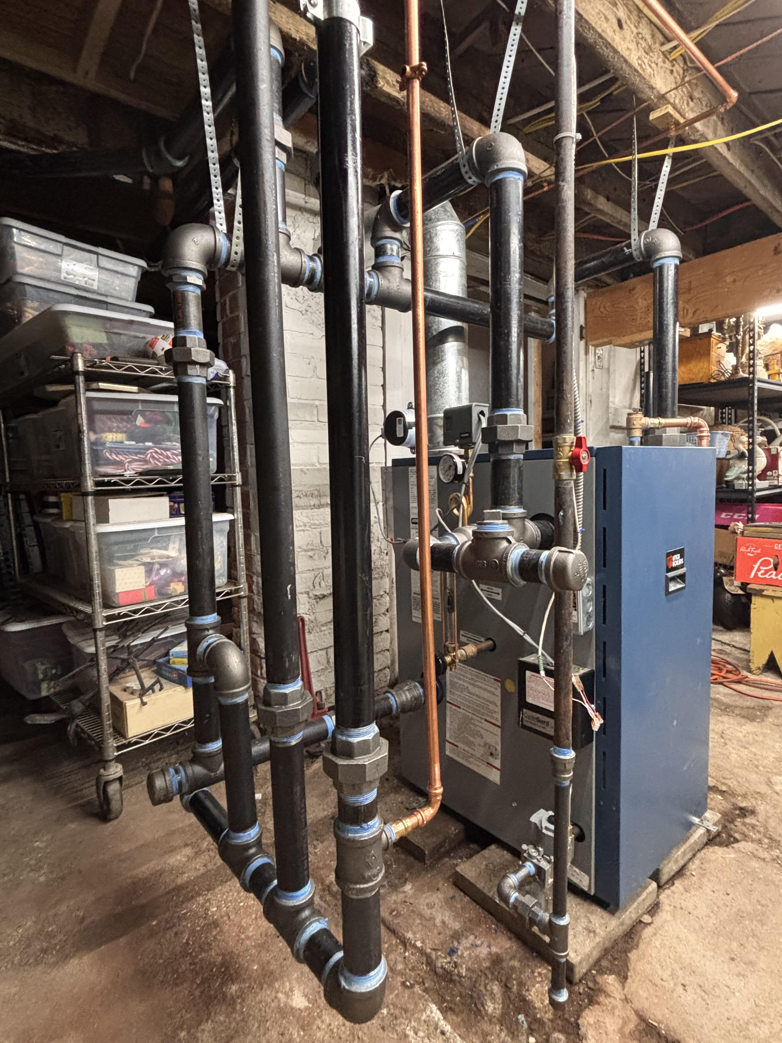

    Unrelated, and likely amateur, question: My boiler turns on and off frequently (I can count and time the frequency if that matters). But it does not stay on long enough to actually produce steam. My assumption is that it is keeping the water warm? If that is the case, what regulates that? Looking through the wiring diagram I do not see anything that appears to be monitoring temperature of the water in the boiler.
    Is it cycling on and off when there is not call for heat? Is there a tankless coil in it for domestic hot water?
  • SMRTK
    SMRTK Posts: 49
    No tankless coil. Utica PEG150 EID is the boiler model. That would make sense if it had it, but it does not.
    does it cycle on and off without a call for heat to keep the boiler hot(which is called "warm start")?

    If it is set up as warm start, there is probably an aquastat on it that keeps it at a minimum temp. You can turn that all the way down. Did it at one time provide dhw or heat a hot water heating loop? The aquastat would have been field installed so it won't be on the boiler's schematic. Can you show us pictures of the other sides and the piping above?

    There is no field installed aquastat since I did not install one. This is the same project as the near boiler piping with the charred floor joists. I started a new thread assuming that is preferred when the topic changes. If that is not the case let me know.
    Picture below. It is a brand new boiler install and has never provided DHW.

    That is an older (@week) photo. It has a valve on the copper water supply near the boiler now and the sight glass is a lot cleaner. It is still in need of skimming but much better than in the photo here
    edited November 2025
    the psycho…er cycle gard will shut the boiler down every x minutes and verify the water level. the period depends on the model. what is under the front cover? i wouldn't expect it to be set up warm start from the factory.

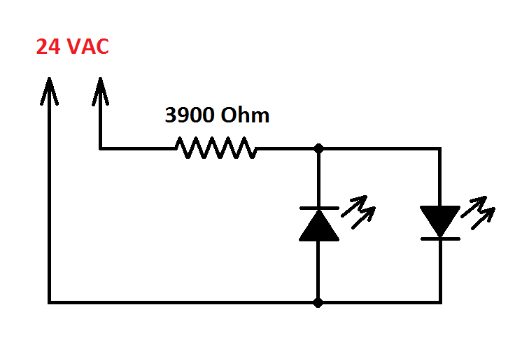

    measure t-t or r-g or whatever the t-stat connection is with an ac voltmeter and see if it is 0 or not, if it is 0 the t-stat is calling. could put an led with the resistor for 12v there too so it lights when there is no call.
    109A_5 Posts: 4,759
    12v ?
    For a 24 VAC circuit two LEDs wired as shown below works well. If you only use one LED you still need a diode to protect the single LED from excessive PRV. With two LEDs they protect each other.

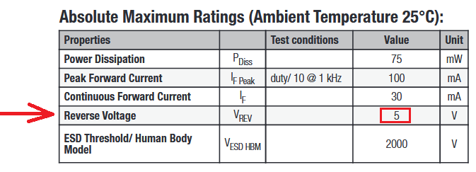

    it is only half wave rectified so you only get 12 vrms. technically it is 12 / ((2^.5)/2) volts. you should have a reverse biased diode but at 12 v it is less of a concern.
    109A_5 Posts: 4,759
    @mattmia2, you better think about that for a bit. With only one LED when it is in conduction (forward biased), say the positive alternation you have the forward voltage drop across the LED (a few volts depending on the LED) the rest of the alternation's voltage is dropped across the current limiting resistor. With the negative alternation there is no current flow so all the voltage of the negative alternation is applied across the reverse biased LED. V peak is almost 34 volts with 24 VAC RMS.
