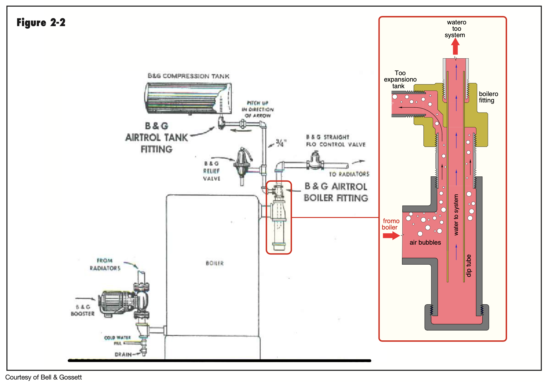

    Often we see mis-applied compression tank systems that do not have the Airtrol™ fittings or equivalent installed. As such they are not doing a good job of air management and allow air in and out of solution.

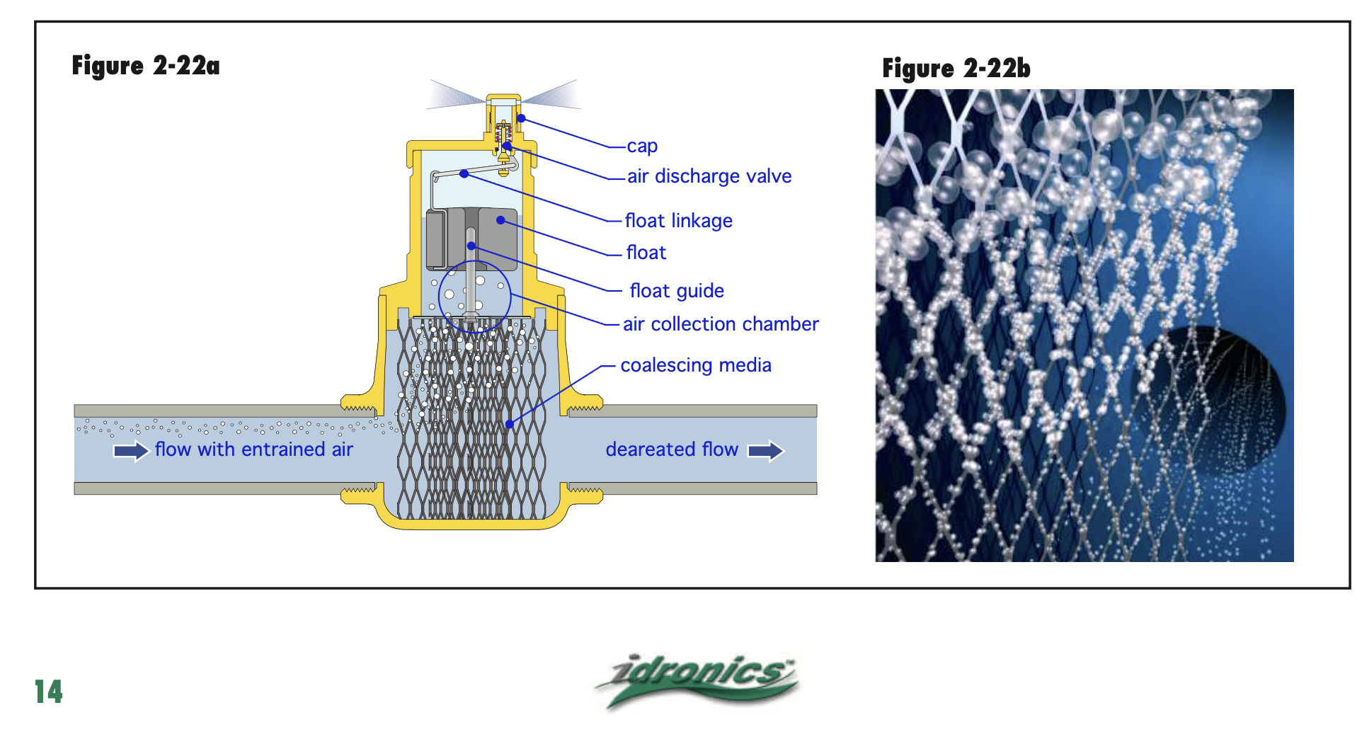

    Not all cast boilers have section designed to aid in air removal, certainly not the new "mini" cast boilers with 3 gallon volume. Those, probably all hydronic systems, IMO greatly benefit from a microbubble resorber type air separator.

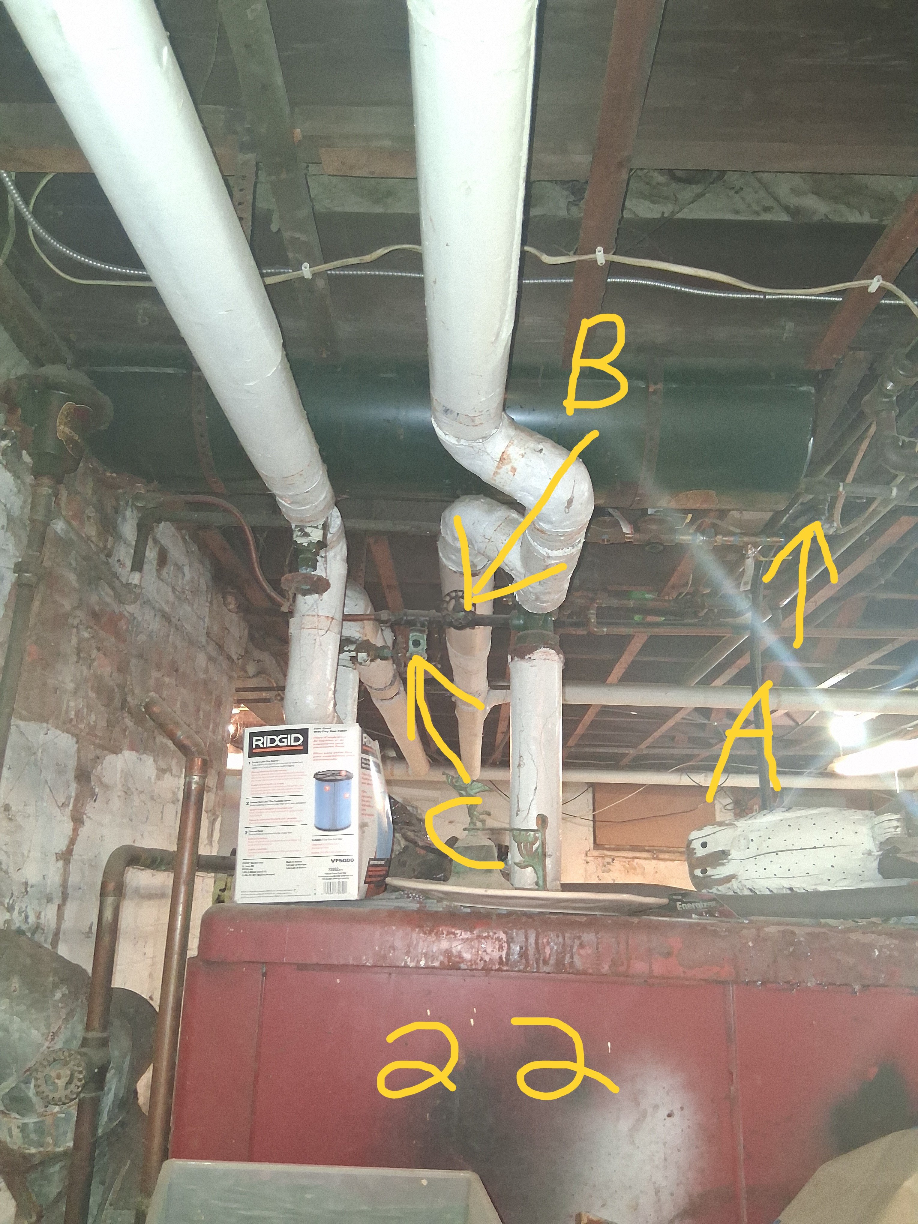

    OK lets start with problem number one. Last winter i had to lower my aquastat to 170 because at 180 some scary things would happen like the pressure relief valve would open. My guess is the expansion tank is waterlogged. As you can see in the picture valve B will isolate the furnace water from the tank. If I open valves C and A I can drain any water in the tank. Now once all water is removed from the tank am i supposed to recharge the tank with air?

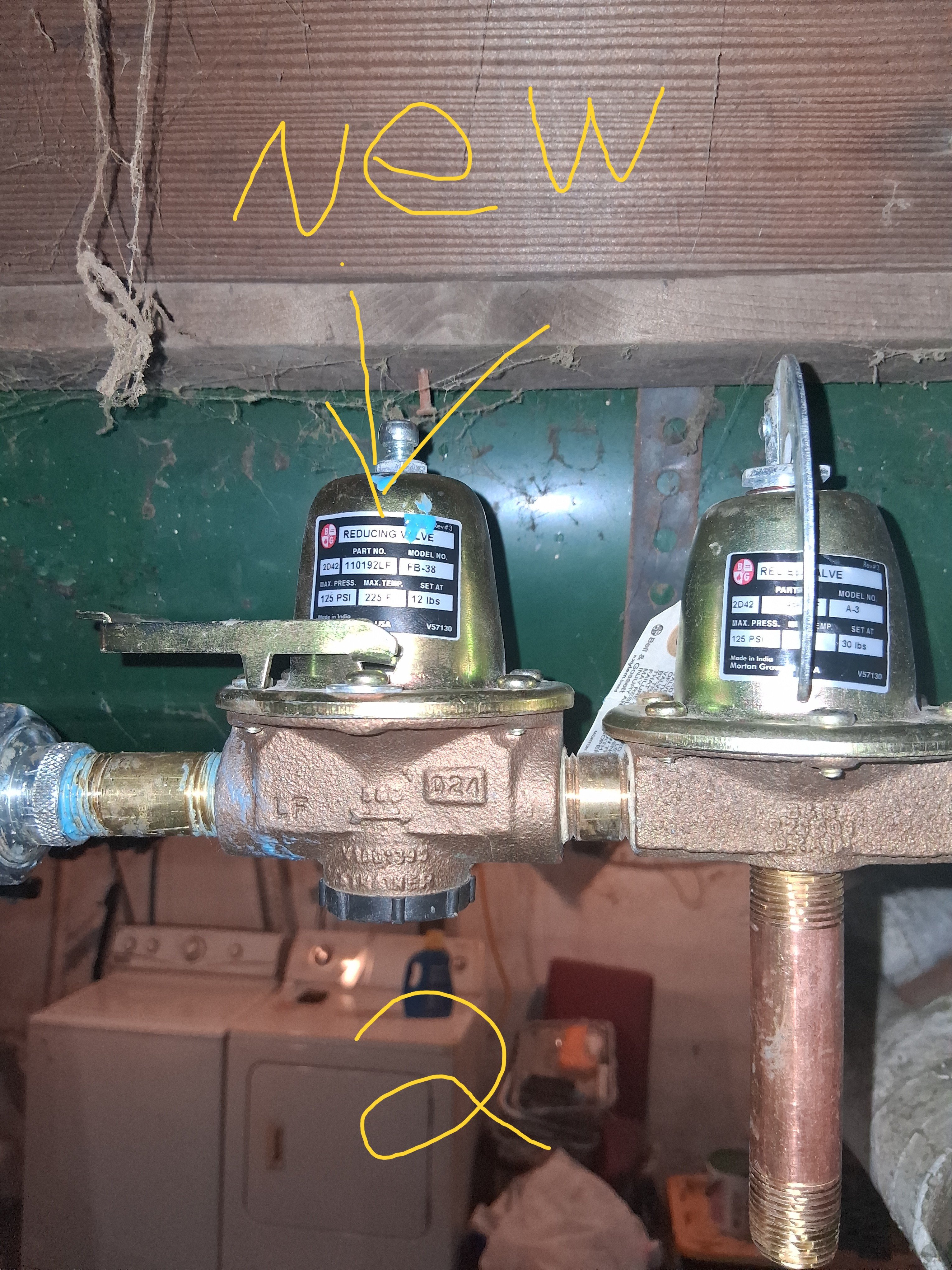

    Problem number 2 is i always one radiator in my attic that would always need to be bleed and would not last the winter. That may be because my old pressure reducing was 100% plugged with rust because the strainer was never replaced in the 50 years I live in this house. I just replaced it. That may solve that problem but I am not going to know until I bleed the system. But I woul like to get past the expansion tank issue first.

    Those "expansion" tanks (technically a compression tank) are incredibly simple and reliable. But it may well be waterlogged.
    Which is easy to fix. As you say, close valve B. Open valves C and A and drain all the water out of the tank. Close them. Reopen valve B. Use you feed valve to bring the system pressure back to where you want it.
    End of story. No need to add air to the tank….
    Now it probably waterlogged as the connection to the rest of the system isn't really quite right. Ideally there would be a direct connection with an Airtrol fitting at the tank, but it is what it is. You just may have to drain the tank from time to time. Try to avid removing air by bleeding or whatever anywhere else — you want all the stray air in the system to end up in that tank if possible.

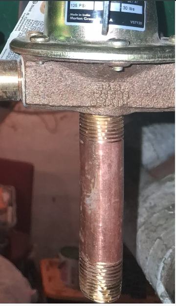

    hot_rod Member Posts: 28,079

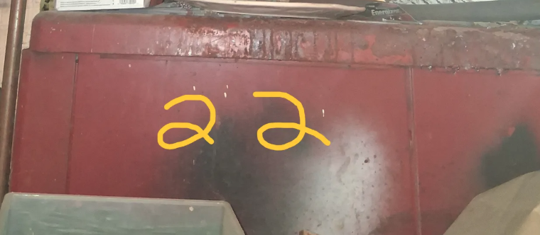

    This brass pipe on the relief valve should reach down to the floor. Very hot, boiler temperature water could discharge from this opening.
    If you have a waterlogged expansion vessel, the odds of that happening increase.
    Any metallic tube or pipe is fine, copper, black steel, galvanized pipe for example.
    I'm wondering about the scorched jacketing on that boiler? Something overheated along the years.
    You might start saving for a boiler replacement.

    Now, the ball valve that is after the feed valve and the pressure regulator MUST BE SHUT OFF after the draining of the tank to eliminate the waterlogged condition.
    Once you have drained the tank to eliminate the water logged condition you can open the feed valve slightly and add water back to the system BUT "only so much water/about half" as a water logged tank eliminates the point of no pressure change.
    I cannot emphasize this strongly enough to you: "The ball valve must be shut off after you refill the steel compression tank to half full". YOU CAN ALSO shut the water feed valve off AND LEAVE IT OFF and drain ten gallons of water from the tank.
    The reason your heating system is not working well is because it has no air charge in the steel compression tank which is required to allow the hot water in the system to (1) expand and (2) rise by convection and allow the heat generated by your boiler to rise naturally by convection.
    If the ideal brand tank which I believe is a 30 gallon tank is drained of 10 gallons water it will eliminate the water logged condition and the heat in your home will start working more efficiently to provide you with low even heating again.
    If you have a garden hose you can attach it to the valve labeled "C" and open the drain valve and fill a 5 gallon bucket twice and your heat will start working again BUT ONLY OF YOU SHUT THE FED VALVE OFF FIRST!!!!

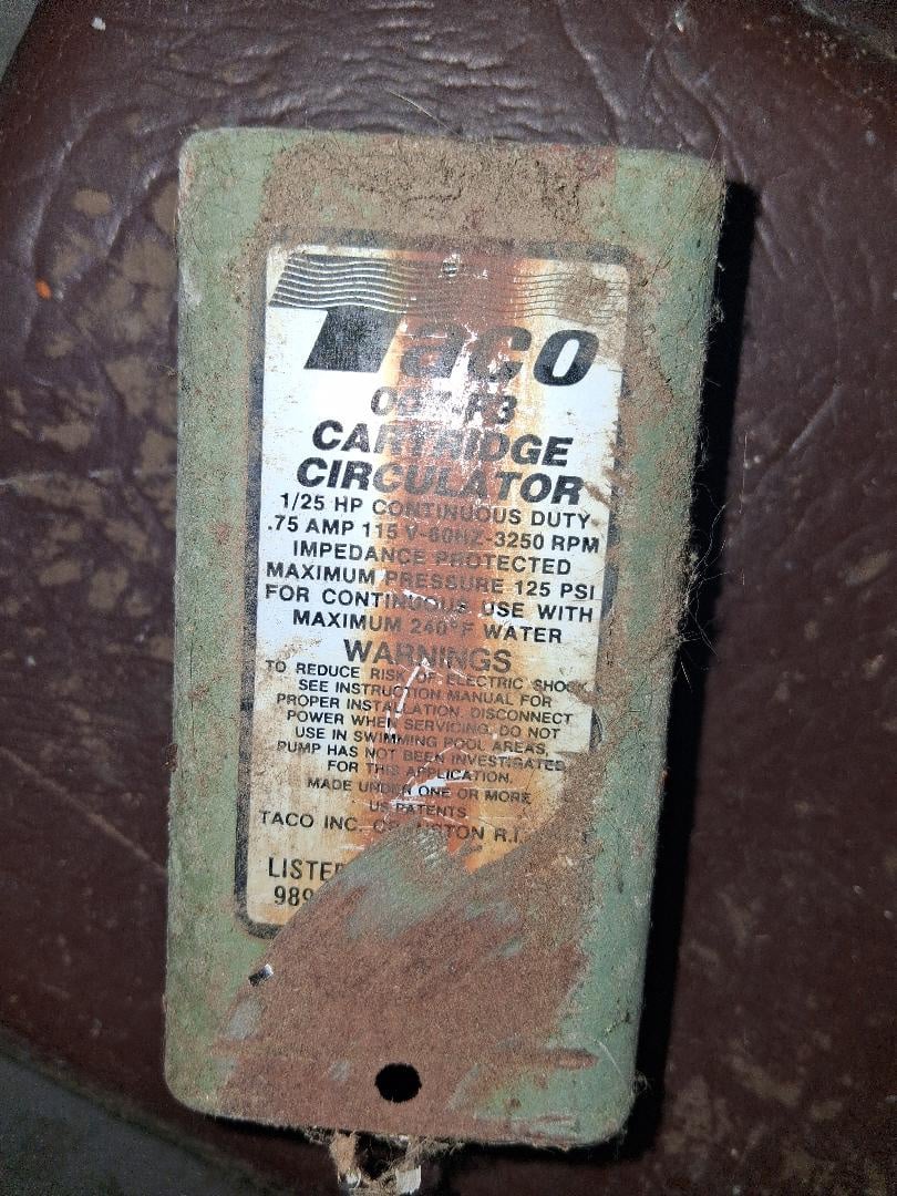

    FYI. The green thing i was asked about it a circulator pump. I replaced the old one about 40 years ago. I would say my system was never gravity feed. Just a hunch.

    It has a pipe connected to it at the bottom and it has a pipe coming out of the right side that is connected to the pressure regulator and fill valve; please take a high quality picture of the label on this valve that is painted green.
