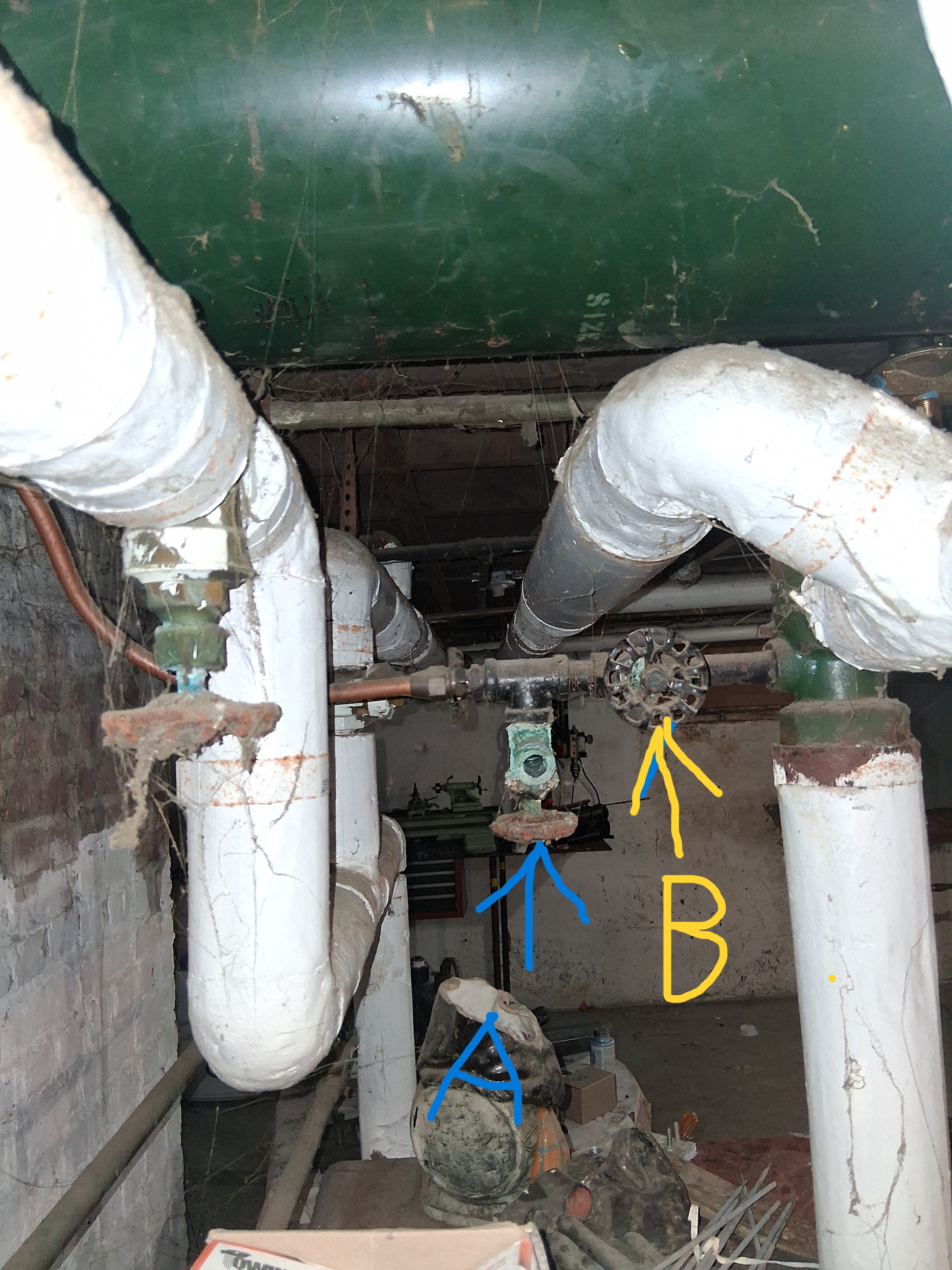

    OK lets start with problem number one. Last winter i had to lower my aquastat to 170 because at 180 some scary things would happen like the pressure relief valve would open. My guess is the expansion tank is waterlogged. As you can see in the picture valve B will isolate the furnace water from the tank. If I open valves C and A I can drain any water in the tank. Now once all water is removed from the tank am i supposed to recharge the tank with air?

    Those "expansion" tanks (technically a compression tank) are incredibly simple and reliable. But it may well be waterlogged.
    Which is easy to fix. As you say, close valve B. Open valves C and A and drain all the water out of the tank. Close them. Reopen valve B. Use you feed valve to bring the system pressure back to where you want it.
    End of story. No need to add air to the tank….
    Now it probably waterlogged as the connection to the rest of the system isn't really quite right. Ideally there would be a direct connection with an Airtrol fitting at the tank, but it is what it is. You just may have to drain the tank from time to time. Try to avid removing air by bleeding or whatever anywhere else — you want all the stray air in the system to end up in that tank if possible.

    Please take more pictures of the near boiler plumbing as I need to know what the green colored device is near the foundation wall, please take a clear picture of the label on this device.
    Now, the ball valve that is after the feed valve and the pressure regulator MUST BE SHUT OFF after the draining of the tank to eliminate the waterlogged condition.
    Once you have drained the tank to eliminate the water logged condition you can open the feed valve slightly and add water back to the system BUT "only so much water/about half" as a water logged tank eliminates the point of no pressure change.
    I cannot emphasize this strongly enough to you: "The ball valve must be shut off after you refill the steel compression tank to half full". YOU CAN ALSO shut the water feed valve off AND LEAVE IT OFF and drain ten gallons of water from the tank.
    The reason your heating system is not working well is because it has no air charge in the steel compression tank which is required to allow the hot water in the system to (1) expand and (2) rise by convection and allow the heat generated by your boiler to rise naturally by convection.
    If the ideal brand tank which I believe is a 30 gallon tank is drained of 10 gallons water it will eliminate the water logged condition and the heat in your home will start working more efficiently to provide you with low even heating again.
    If you have a garden hose you can attach it to the valve labeled "C" and open the drain valve and fill a 5 gallon bucket twice and your heat will start working again BUT ONLY OF YOU SHUT THE FED VALVE OFF FIRST!!!!

    Thanks. Should I drain the tank at normal operating temperature? I know I have two radiators that need to be bleed. I am thinking to leave valve b closed while bleeding the radiators and once full bring the system up to about 15 PSI. then open b after bleeding. Sound Good?

    Please shut the ball valve off with the white handle before you do anything; by shutting it off you guarantee the steel compression tank will not become waterlogged.
    Please read brother Jamies comment from Nov. 2nd again.
    Once you have the steel compression tank isolated drain 10 gallons of water from it and then shut the boiler drain off, the system will start working again AS LONG AS YOU KEEP THE WHITE HANDLED BALL VALVE SHUT OFF TO KEEP WATER FROM BEING FED BACK INTO THE SYSTEM.
    Once the excess water is drained the air charge will create the point of no pressure change.
